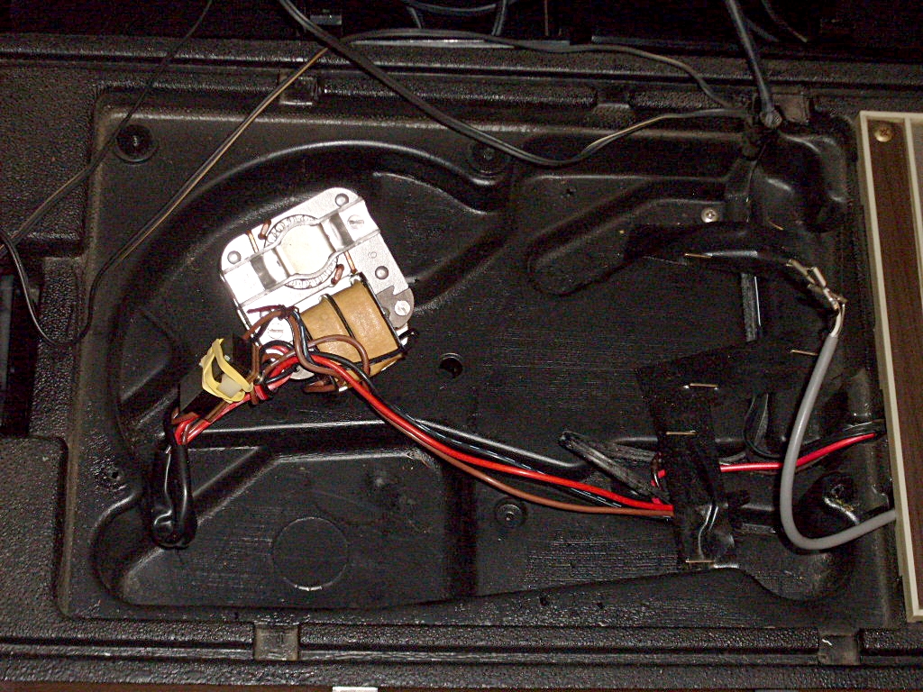

I have finished up this 1971 Arvin SS stereo.
Except for the audio leads off the amp, all connections
are soldered on.

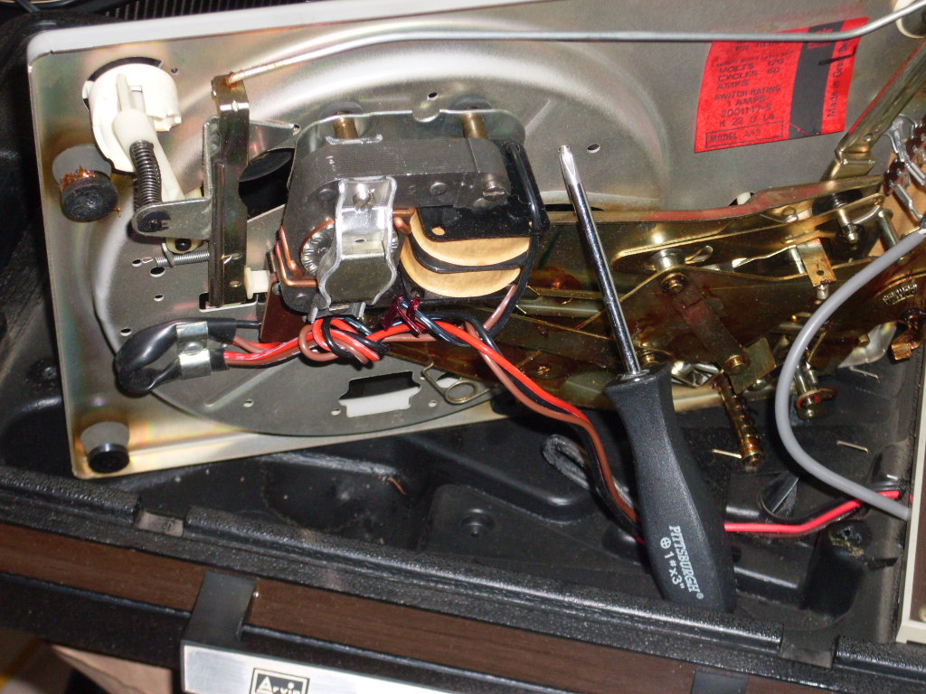

So I had to remove the motor from the BSR AA50
changer, to service the changer.
Motor was dis-assembled and cleaned sitting in the
cabinet bottom. Not that difficult.

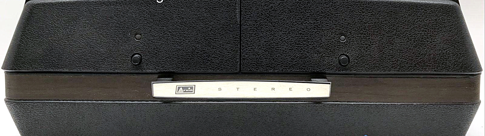

This Arvin is kinda neato in that the speakers mount onto
the cabinet for transport.
There are 2 plastic clips on each speaker,
and 2 catch areas molded onto each side of
the cabinet to accept the clips.
