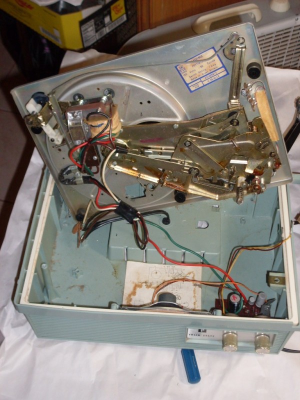

I grabbed another one of these little SS amp portables
with the mini BSR changer.
I was attracted by the two tone case with removable cover.
After cleaning and a new stylus, it had a curious bit of
feedback when the stylus tracked on the silent lead in and
lead out grooves.
Feedback was volume dependent.
The changer base is attached to the plastic cabinet using
rubber pads.
I had removed the mount screws for the cleaning
When I played records to try it out, I did not replace those
screws.
Motor and mounts were good.
So, when I pressed down on the base, while testing another
record, the feedback disappeared.
I added a small rubber washer to the four mounting posts,
tightened down the mount screws and all seems good.
I would never have expected a feedback problem with this
little set-up, but there it was.

Would that have a ceramic cartridge? And, how easy on records would you say it would be? I'm assuming a sapphire needle would be used. It's probably eons better than a modern Crosley player would be.
- Posts: 1344
Re: 1968 JC Penney PennCrest Player
Greg,electra225 wrote: ↑Fri May 19, 2023 7:59 pm Would that have a ceramic cartridge? And, how easy on records would you say it would be? I'm assuming a sapphire needle would be used. It's probably eons better than a modern Crosley player would be.
The original stylus was a 0.7 mil sapphire/3 mil sapphire flip over.
I put in a 0.7/0.7 DS, and set the ceramic cart's tracking force
to specs.
From all I've read, if the records are clean, and the stylus good,
with tracking set close, should be no problems.
I've never had all those terrible "problems" of the audio-phools
who think these carts are the worst thing ever.
If they were so bad, there would have been millions of records
damaged.
And I always check a test record for any gross signs of
damage when I'm finished with the repairs.
