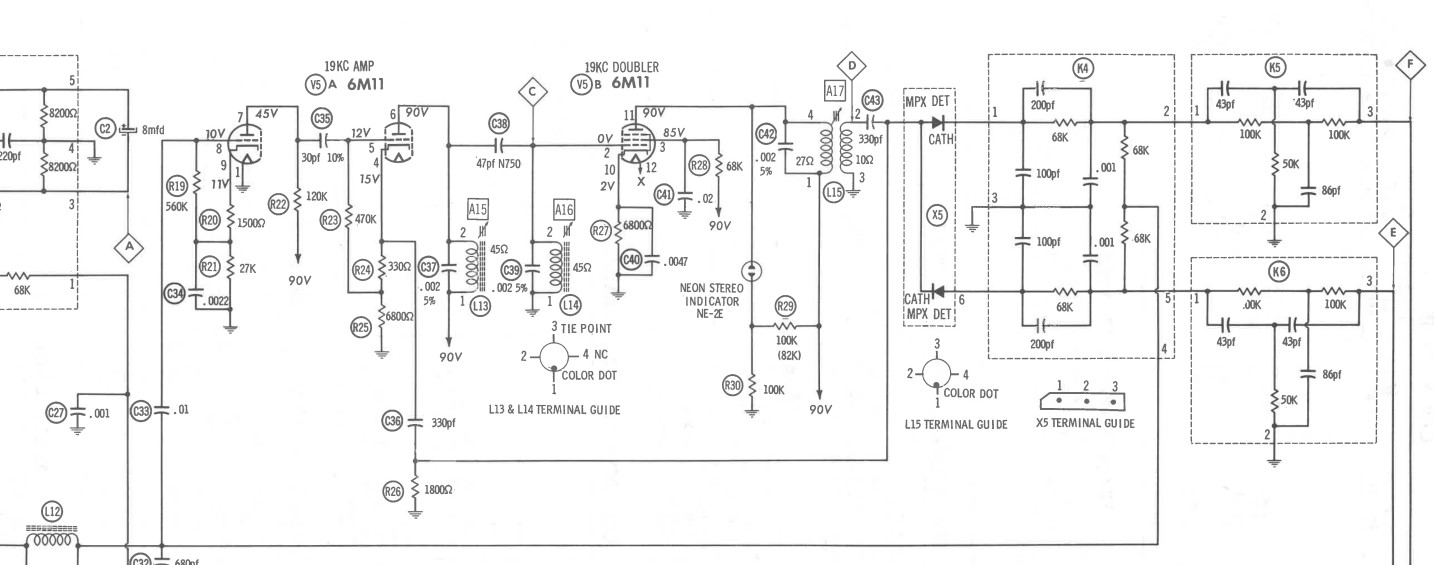

Well I am back working on the phonola... it works great except the FM stereo light does what it wants ... when you first turn the set on and the tubes are warming up the FM indicator will light up... then as the set warms up the light goes out never to light again...the voltages seem to be correct , this all operates off of a 6M11 compactron tube , which my tube tester will not accept. The stereo is working as you can hear the separation when you switch from regular FM to Stereo FM... I have no clue what voltages are required to light a NE-2 bulb ... when it is warming up the voltages on the indicator are around 150 volts , but drops to the working voltage of 90 volts where it does nothing... could the NE2 just be worn out?... can they wear out? I would share a schematic if I could ....

hermitcrab wrote: Wed May 03, 2023 6:33 pm Well I am back working on the phonola... it works great except the FM stereo light does what it wants ... when you first turn the set on and the tubes are warming up the FM indicator will light up... then as the set warms up the light goes out never to light again...the voltages seem to be correct , this all operates off of a 6M11 compactron tube , which my tube tester will not accept. The stereo is working as you can hear the separation when you switch from regular FM to Stereo FM... I have no clue what voltages are required to light a NE-2 bulb ... when it is warming up the voltages on the indicator are around 150 volts , but drops to the working voltage of 90 volts where it does nothing... could the NE2 just be worn out?... can they wear out? I would share a schematic if I could ....
Didn't you post this same question on the Antique Radio Forum?
If you did, post a link. I'll nab the schematic you posted and post it here.
If that wasn't you, my apologies. Just seemed very familiar.

I found your post, and "snipped" the section of the circuit in question from your .pdf. Click on it to enlarge/clarify it....

As I stated on the ARF when I shut off the shop light , and scroll through the dial the FM stereo light will flicker but nothing more, the antenna is about is good as it can be , the front end is hot , as I am picking up stations I usually don't get... I am beginning to think someone twiddled with the coils , everything is correct on voltages, the resistors all checked for drift , My only conclusion is either the coils need tweaked or the 6M11 is weak...
