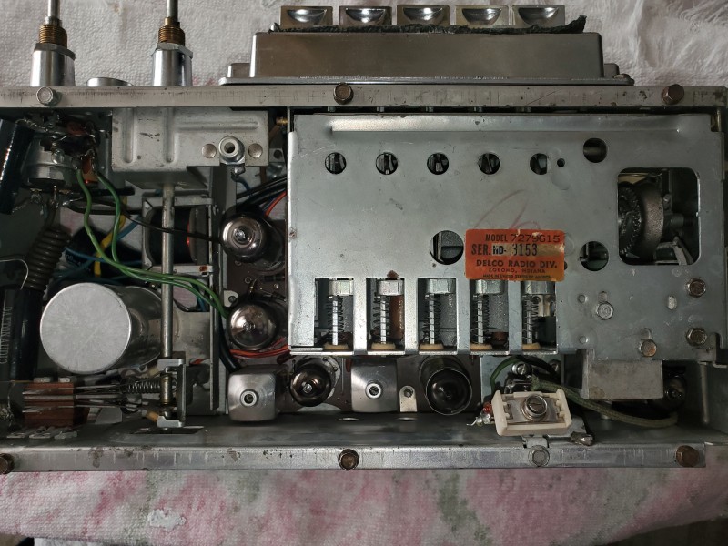

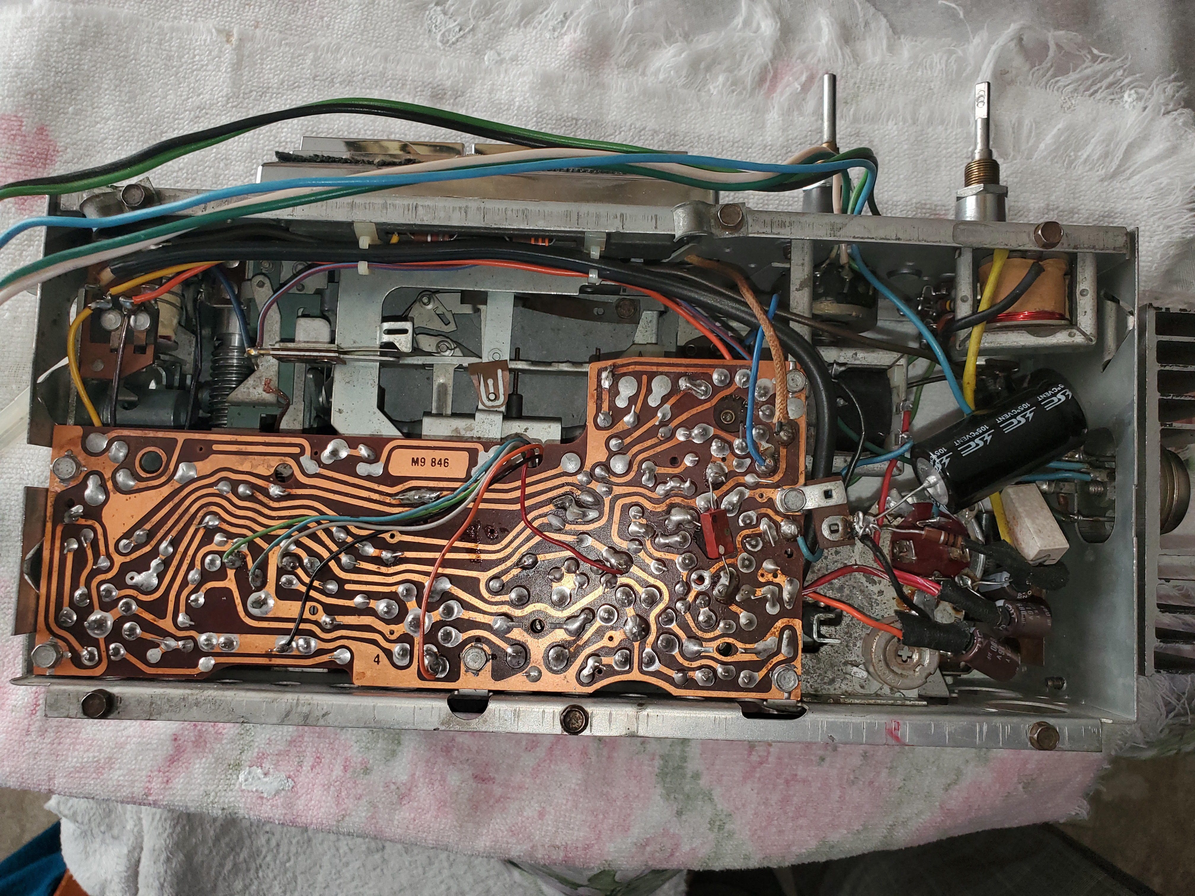

I fully recapped the radio in the 62 cadillac. I had done the electrolytic before but now did the coupling caps as well.
Before doing the coupling caps, it would intermittently stop on a station, usually below 900. It'd scan and scan and shutting it off and on would stop it until the bar was pushed again.
Now, it scans constantly, even as soon as I turn it on. If I turn it off around 700 on the dial, it'll unwind all the way to 1600. It's driving me nuts.

Is your Cadillac Wonderbar tube or SS/hybrid? It makes a difference in how the trigger works. If tube, there might be a 12AT7 or a 12BL8(?) used as a trigger. Sounds like the Wonderbar switch is shorted/warped/ dirty/stuck. If you watch the Wonderbar when you push it in, you will see the switch it contacts. There is a guy on ARF who does car radios, Tayman is his name, I think. He likes to do FM conversions, but I think he will do standard radios as well. Would you care to share the model number? I might have a schematic for it. We might be able to talk you thru the repair. If the radio work well otherwise, that's more than half the battle. Good luck.
Re: Wonderbar repair
Hybrid, I d say. Transistorized amp with tubes in the set. The 12AL8 closest to the front is the trigger.

No clue what that cap is for. I'm THINKING static reduction? It was there so I replaced it.
I didn't go over the resistors. I'm not so adept at that. Only other anomaly is the can caps are 750v and closest I could find were 680 BUTthe radio runs and ran before. It's the search circuit and tone that are off. It seems like the search has been dying which could indicate a resistor...

Wonderbar radios can be a pain to get working right. Part of the trouble is not the radio, but the silly digital stations we have now. I don't have a diagram for that radio. Closest I have left is for a '59 Buick Wonderbar. I'd go over your work, since it works "worse" now than it did before you recapped it. Then check resistors, particularly in the IF and trigger circuits. I 'm not sure about that black cap. That doesn't look like it belongs there. I still believe part of the issue is that the switch is sticking. My Buick Wonderbar doesn't work right anymore. Sometimes it will, sometimes it won't. The issue with mine is the antenna.
Another suggestion would be to check the alignment, particularly the antenna trimmer alignment. You replaced caps, which may have altered the tuned circuits enough it weakened the IF section. Do a good alignment on the chassis. Also there should be a local/distant switch. Make sure it's good, not dirty. Anything that cuts down on the signal will affect Wonderbar operation.

So I got the radio back a few weeks ago with a list of what was wrong with it. A cap and 3 resistors and a weak tube. He also realigned it and cleaned the relay several times.
I installed it and trimmed the antenna. It worked for about 5 cycles and the relay locked again. And I mean LOCKED. Shutting off the radio didn't release it.
Option was to send it back or have him walk me through the relay circuit. I removed it and cleaned the contacts with 1500 grit paper and deox. There's a window on the side of the case where you can see the relay contacts. I had to slightly tweak the gap in the contact stops and it works perfectly. Apparently they lose tension and cant kick the contacts off. I pick up 9 stations on max, 5 on mid and 2 on min sensitivity so I'm happy.
