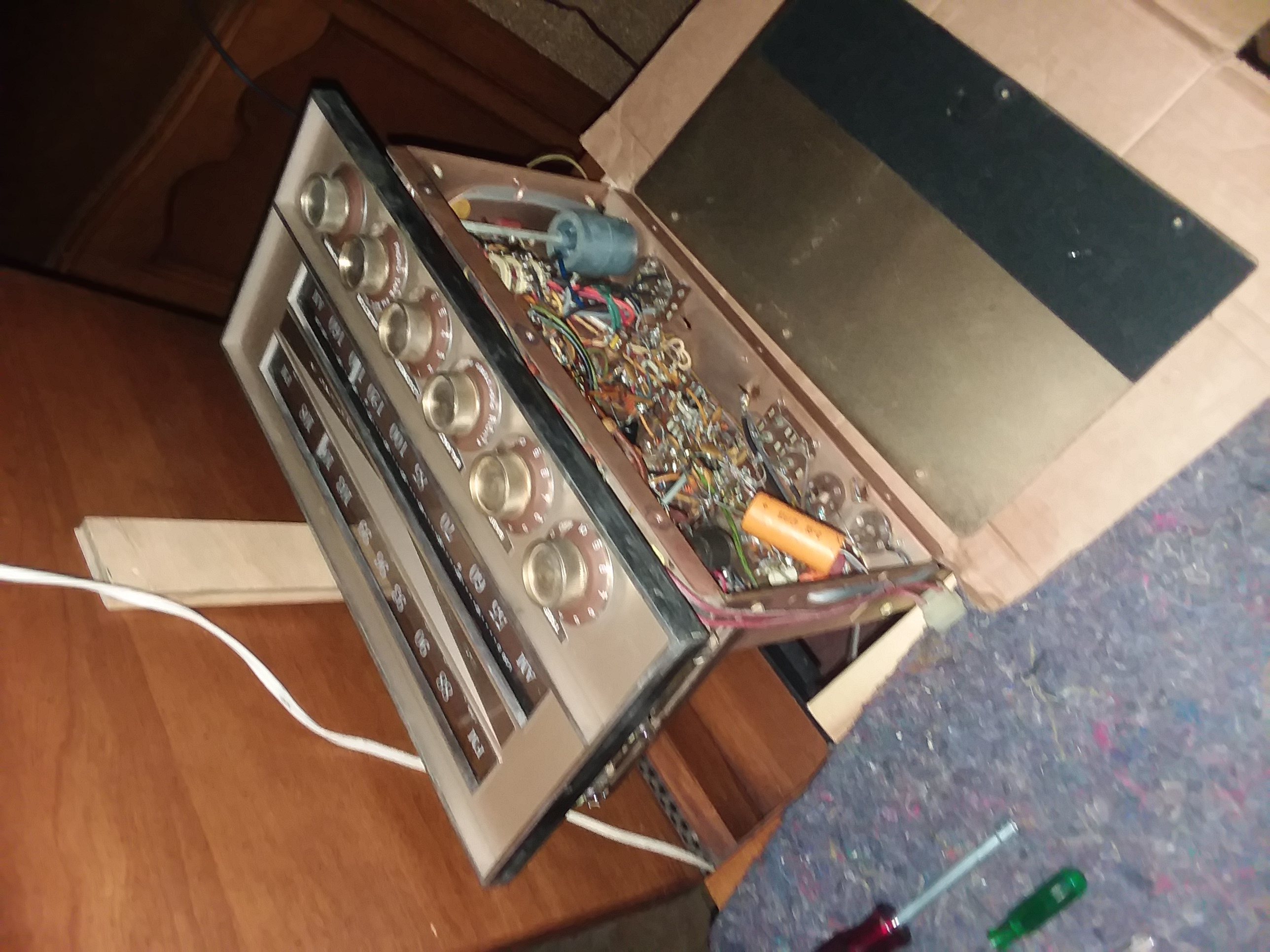

Here are some pictures of a very routine repair in my garage simply because Its been tolerable this "winter".
This SK80 has a single preamp-tuner chassis (lighted knobs :D )and I have seen other 1962s where the preamp chassis is separate. Anyhow, I had to get inventive here to clean the pots without pulling out all the cables to the HS-968 3-ch 6V6 amp and reverb.

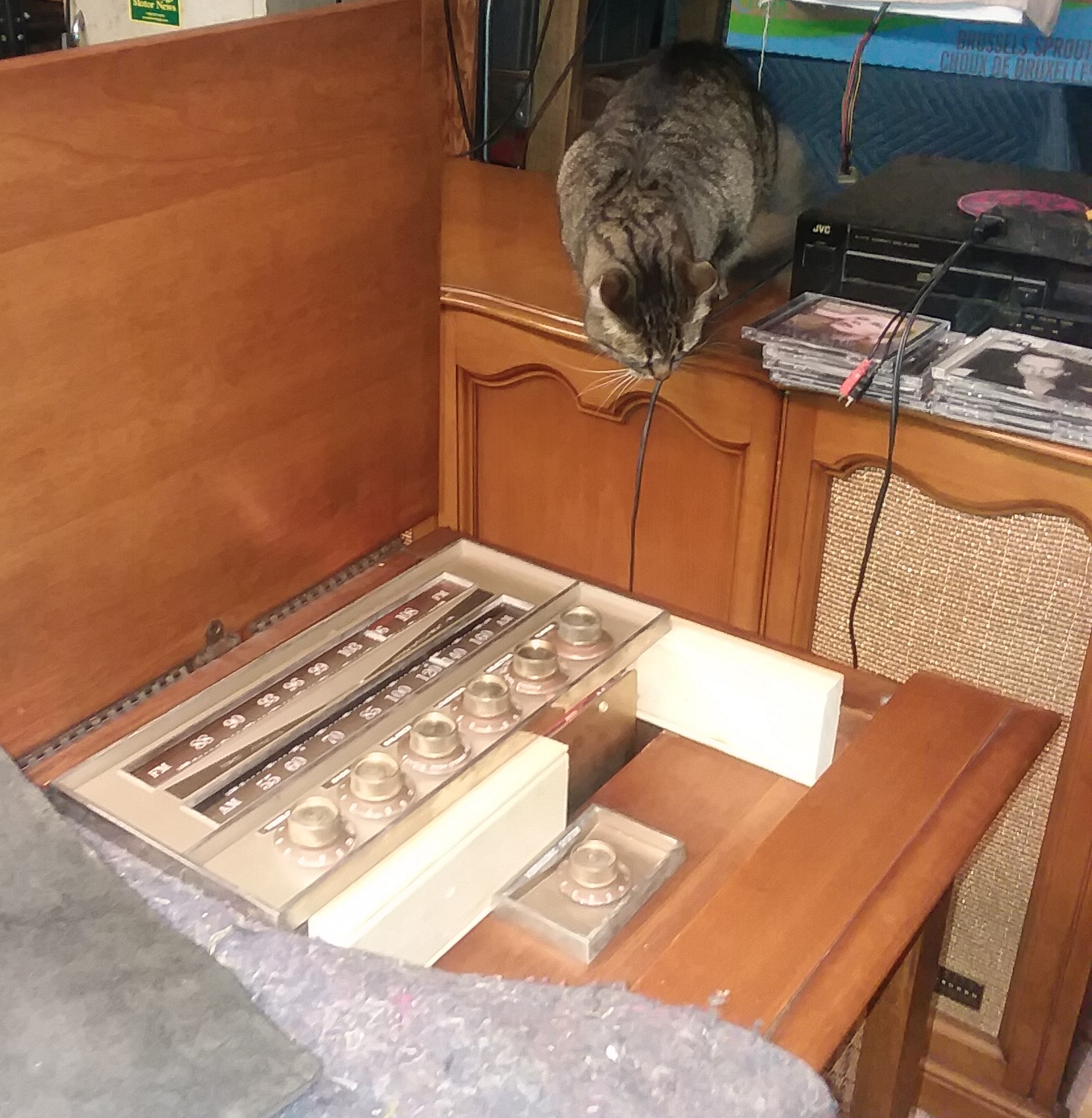

Sorry no mpx adapter in this one. :| but many dont care about radio if there is a "media desert" - places with no decent original programming. Too bad, this FM receiver is as good as a Zenith and separates the strong adjacent from weak very well. AFC will tend to pull onto teh stronger station unless you tune away from the adjacent strong station and then switch on the AFC, then it locks in the weak one. I was getting wonderful jazz from PHL on 90.1 using a 10 element roof antenna with a much stronger station local on 90.3.

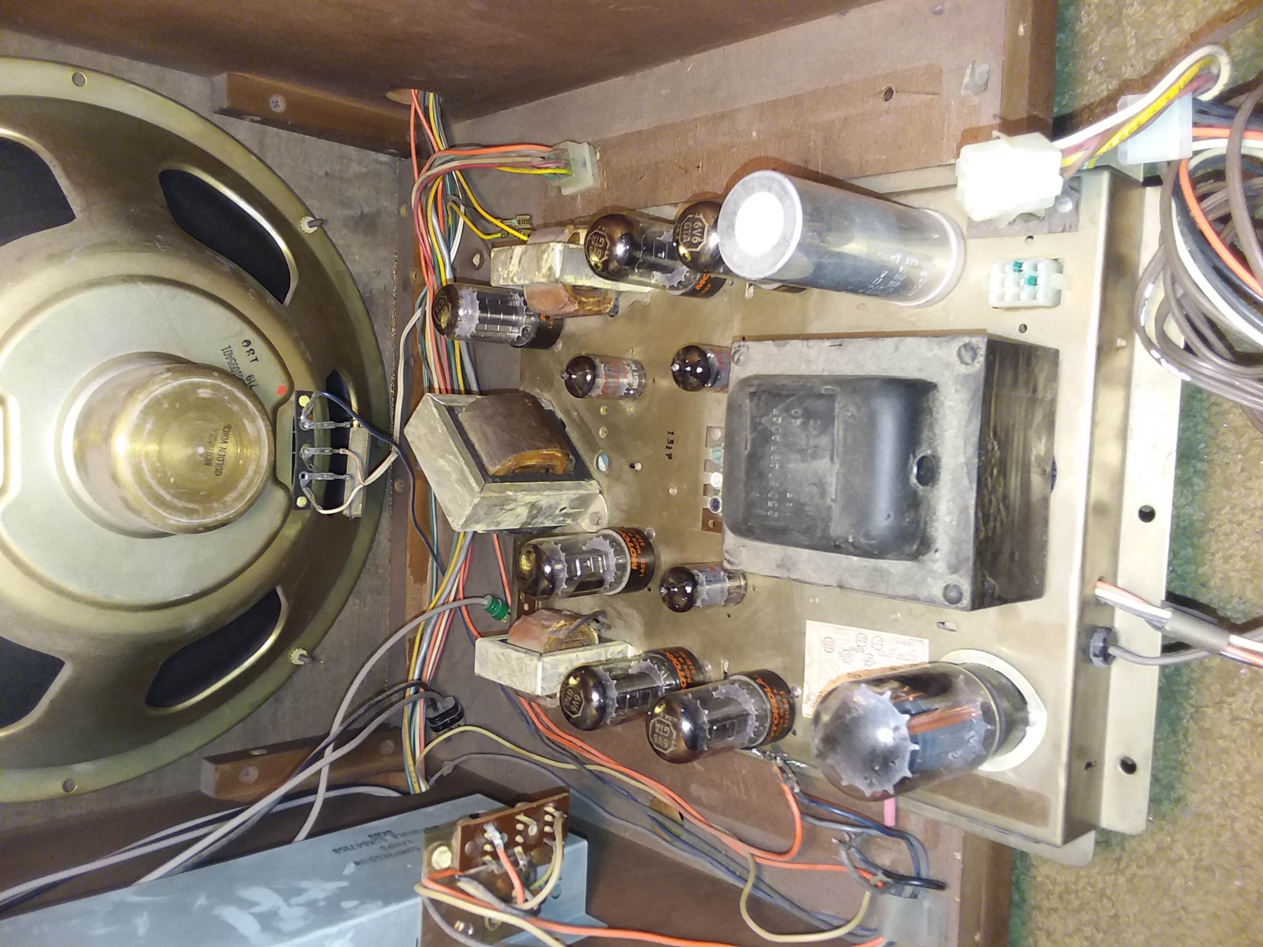

Post: # 12784Post Motorola minion »
This console was pretty hard to test when my wife was home, even in the garage.
The volume at 5, bass at 5, treble at 5 - I had the garage door closed, walked about 100 feet away toward the mailbox and had to go back and turn it back to 3, bass-6, treble-6. It was heard so clearly, anyone driving by would hear it :D .
The loudness compensation is fair, so you need to re-adjust tone controls as volume increases. It has a slightly different personality than my '63 SK112, which uses the same tubes but has a 12" woof.
As always, when it was time for it to be picked up as done, it developed a new symptom that sounded like an output tube failing. After swapping tubes around, a gentle tap on one would cause this pop. After some poking around, I found the RCA plug into the reverb spring was not making good ground contact WHEW!!
