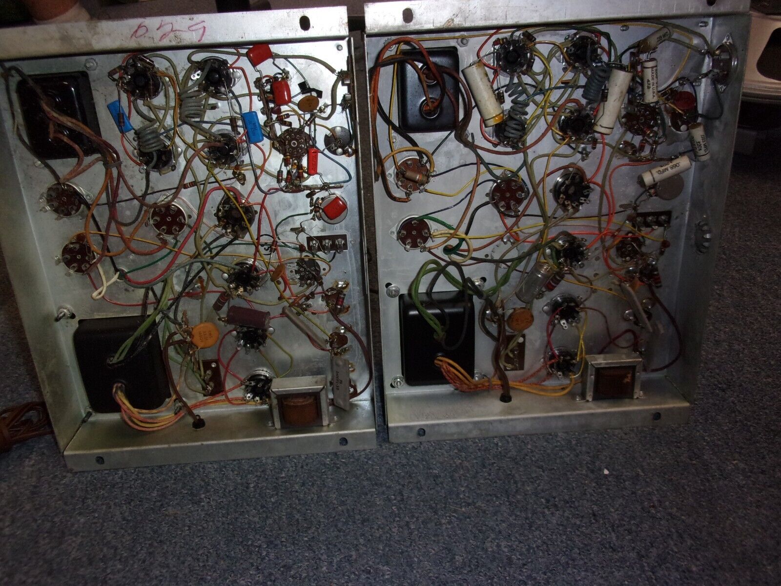

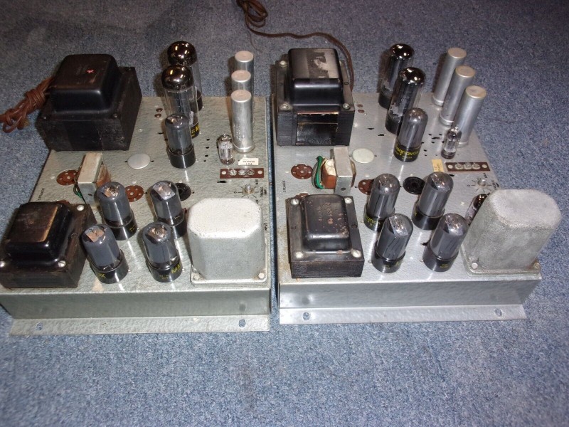

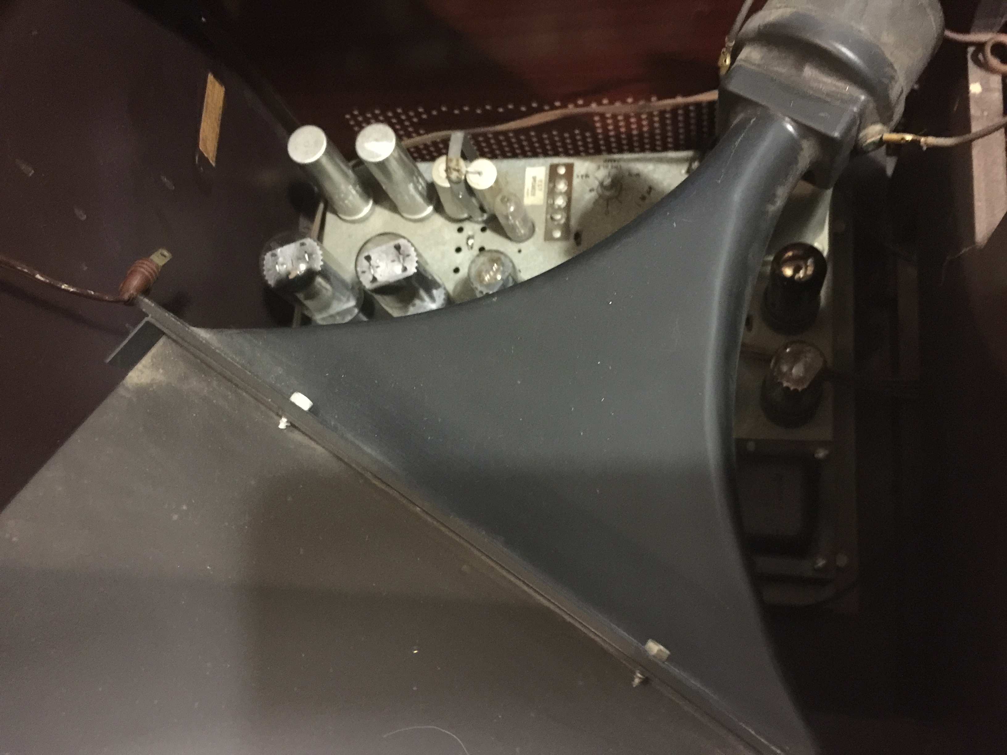

Hello Guys. This is my favorite of all the consoles! I got it from Charles here. It doesn't run it needs a recap and a very thorough going through. I am saving it for when I am better at doing restorations I am starting this thread but it will be very long term prolly 5 years from now.I did get it going once but it sounded very strange and I was really worried about a fire or some kind of damage. On Ebay I had been looking at a set of amps that I am pretty sure are a match for it. So I purchased them. It was a lot but I have not seen a set before and I know I will need parts for mine. They arrived today, amp179 it said but I am pretty sure its a Amp 148 and its mate an Amp 150. But I need to make sure so take a look and see if you recognize them. They look identical to the ones I have.

I can see that one of your amps--the left one in the photo--has been recapped already (can't tell about the filter electrolytics).

Hello guys. I think I will try and see the Amp numbers today to verify what they are. There is evidence that the console has had problems in the past. the (electrolytics ?) have a weird thing, some kind of repair.

Looks like it was a dual-section electrolytic that the repair person could not find an exact replacement for, so they used part of the original can to hold the two replacements--ones that were larger than the current options, so the can could not be "re-stuffed."

Using Nichicon PZ series caps will allow you to restuff a four-section cap commonly found on Magnavox chassis. These caps utilize 5MM bodies, so they are skinnier than your normal caps. Buy radial lead PZ's and you are all set. I also like using at least 500 volt electrolytics in Magnavox power supplies. Magnavox chassis with that gray hammertone finish were distinctive in apprearance.
