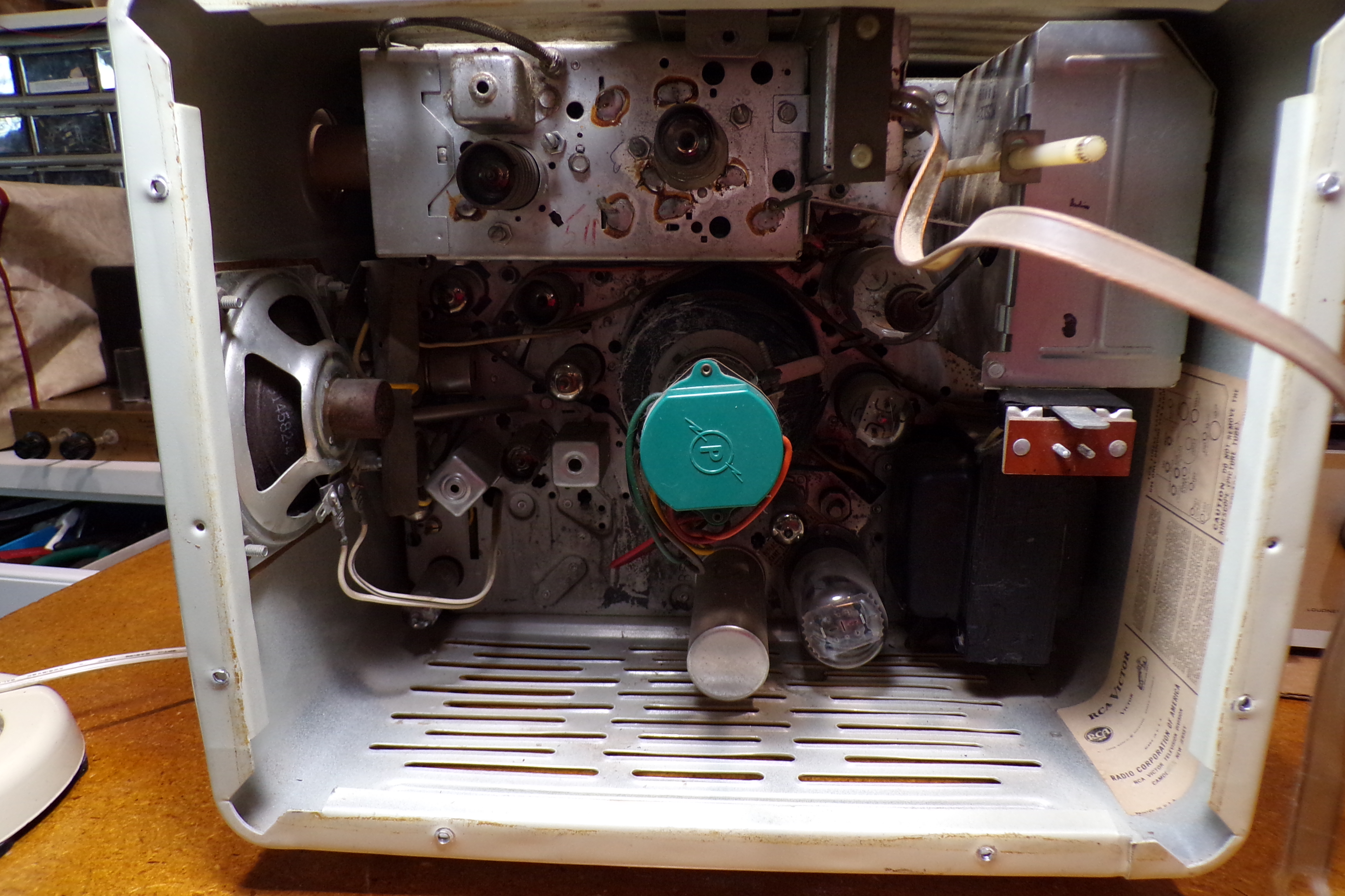

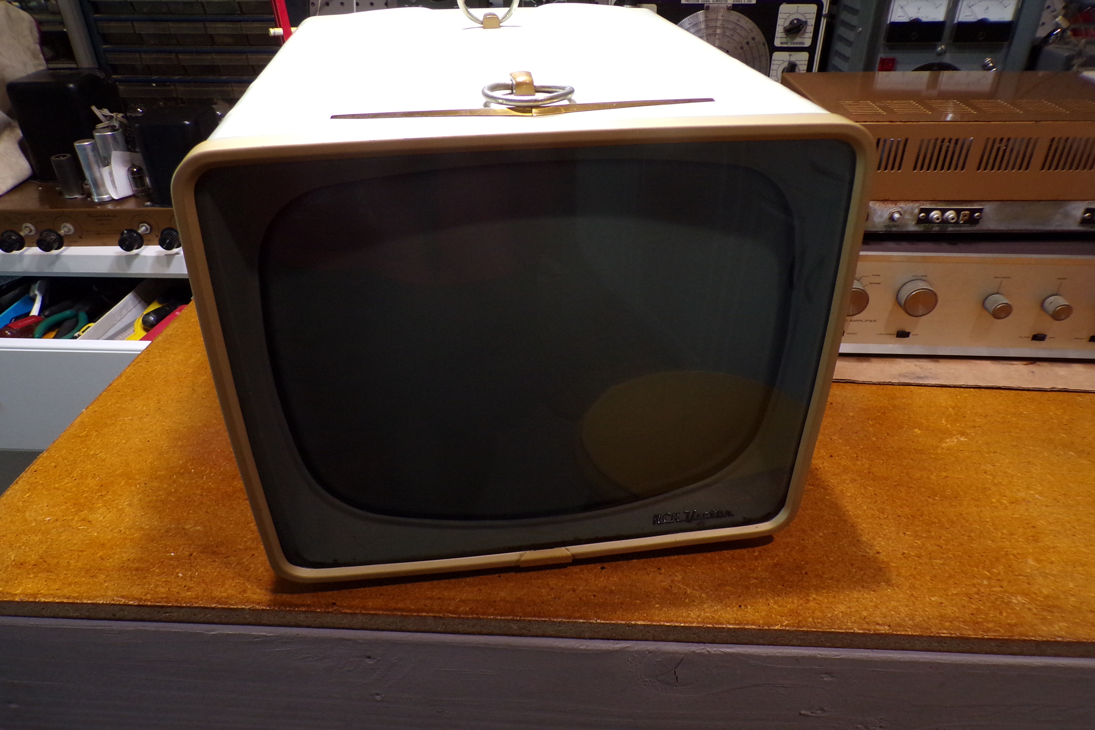

This is my parent's first TV. We have watched many a "Gunsmoke" episode on this TV. My grandparents got their first TV in 1950. This one is a 14" so it had a bigger screen than the grandparents' 10 inch RCA. The last time I played this TV, it exhibited some vertical height/linearity issues until it warmed up. As I remember, it took a few minutes to fill the screen vertically. It has a 14BP4 picture tube (I think). I wonder if this is one of those sets you have to pull the picture tube out the front in order to get the chassis out. If so, how would one troubleshoot the thing? Is this model picture tube metal? The yoke appears to be not falling apart, and the set is in fair physical condition. The numbers are all worn off the channel knob, but it was like that when I was a kid. By what I see, you would release the gold band at the front of the cabinet, then slide out the picture tube after disconnecting the yoke and picture tube plugs. I'm not sure my TV repair skills are up to one of these, reputed to be not for the faint of heart as far as working on one is concerned. This one may need a new home as well. I should probably add a question mark behind the model number. The sticker is gone, but there is a strip of masking tape on the inside of the back cover that gives that model number. This thing has 14 tubes if I counted right and uses a 6AQ5 for the audio ouput and for the vertical output. It has a power transformer and a 5U4 rectifier.

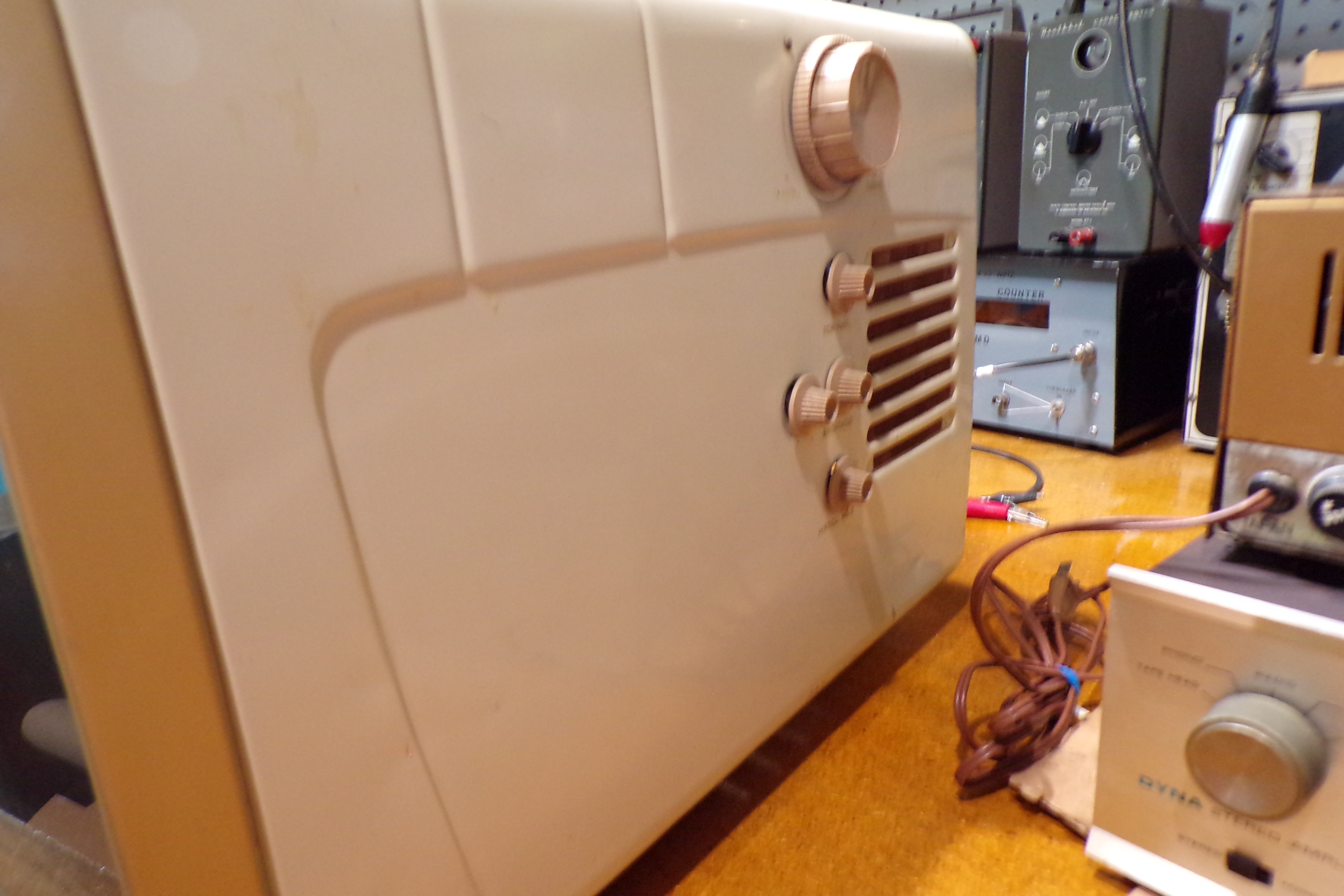

Can't help with that, sorry (Dave...?) but what's sitting on top of that Dyanco, and what's the amp L of the TV (Heathkit maybe?)
Posts: 8767
Re: 1957-ish RCA 14T-4074 14" B&W TV set
Post: # 11844Post electra225 »
Heathkit. I use it for a bench amplifier.
