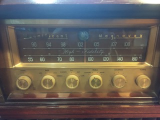

Hello, The 1958 SR205H is not able to be turned on ( it will be recapped sometime soon ). But looking at it a few questions come to mind. I see the selector switch has stereo, phono, FM, AM, tape. Only the stereo(phono) and tape are stereo. what i am wondering is do they divert or shut down one amp to get mono? Also why did they not just make a bigger stereo amp like the 9300 series in the imperial. Then if they are doing all this from scratch, why didn't they do a balance knob? Finally why two different woofers what does this do to the sound?

So you have a '58 stereo Concert Grand? Generally speaking, when you have a mono source feeding into the two bi-amps, the mono signal is branched off and fed to the two amplifiers. They don't cut one amp out. Look forward to pictures of the entire instrument. The Magnavox bi-amps are a different kettle of fish entirely compared to the 93 series Magnavox amplifier. The bomb would have been to make a Concert Grand with two 93 series amps wired for mono. ;) :) :shock:

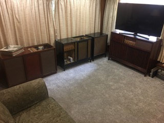

Hello, Yes its the little CG but still it is a CG. I forget that this is a new board and i did post for a while at ARF and audio karma. The collection here is up to 5 now 6 if you include the two to make one imperial. I originally bought it from Charles here on the board so we can say there are at least two of us that have met each other! The SR205H is really nice not beat up at all. I carefully put the glass tops away and my dad made a formica top for it so we could put a TV on top of it. I actually can't wait to get it up and fully operational. It should be good. Here is another shot of the family room with the Stereorama, Continental and the CG. Upstairs there is the ST208 concert hall and the garage has another st208 with the concert grand speakers in it! Hydro

The '58 Concert Grand has two Amp-150 amps in it. I built my '58 Continental to the '58 CG specs, I call it the FrankenGrand, Incredibly powerful and sounds amazing.
What happens in mono Phono mode, FM, and AM is it just splits one channel to both amps. Stereo phono, and stereo Tape are true stereo, the only difference is that there is a Phono preamp circuit to boost the Phono stage a little.

That's a nice collection Hydro, and it looks like you have room for more? ;) :) :roll:
