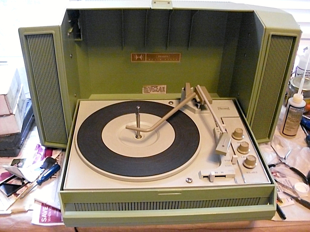

I was the only bidder on this pull down stereo for a great price,
I think, because it lacked a spindle.
I saw it had a BSR changer, so I knew it would be a breeze
to service. I liked the green color, also, because it will attract
a buyer.
The color is like in photo two, more blue-green than olive.

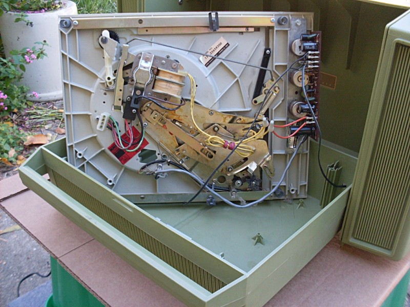

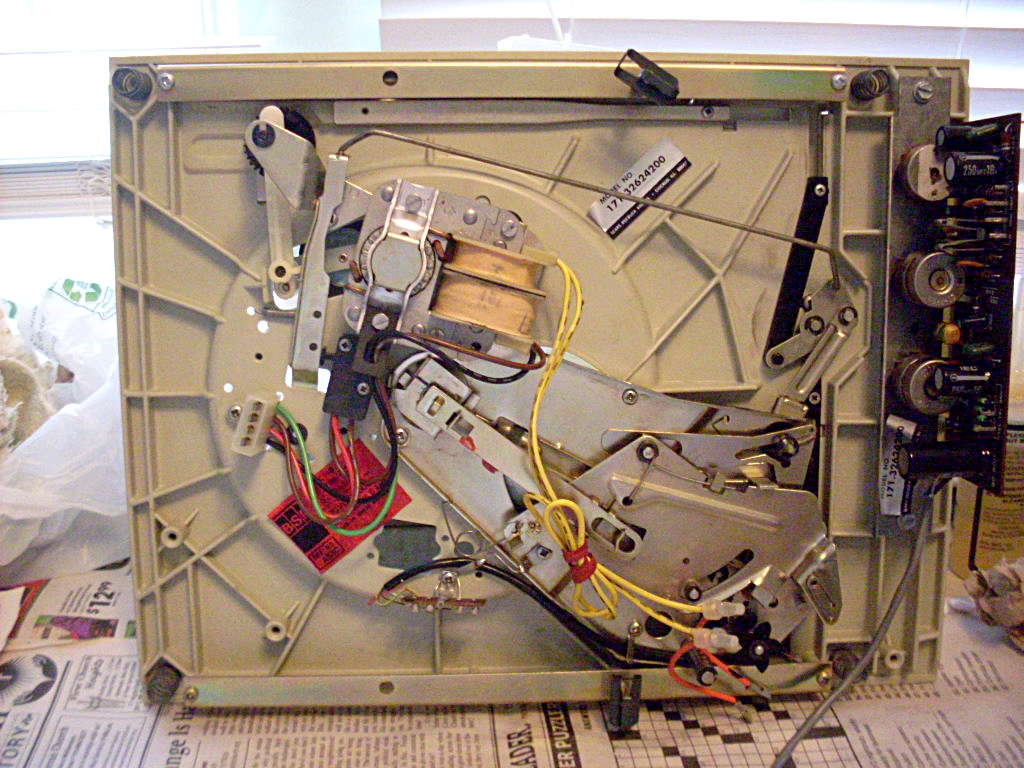

I found on dis-assembly, that the SS amplifier is mounted to
the all plastic BSR changer base. A bit unusual.

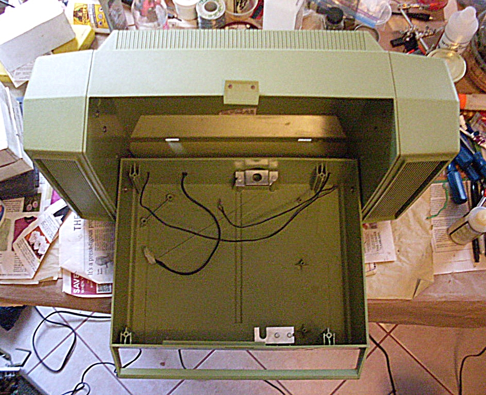

There is an access hole in the rear of the plastic cabinet,
so you can flip up one of the retaining clips on a shipping
bolt.
Then lifting the rear of the changer, you just slip out the
changer from the cabinet.
I had some BSR spindles, and found the right one for the
C148 changer.
The Pfanstiehl P-182 equivalent cartridge got a new
Pfanstiehl 274 stylus.
After a good cleaning of cabinet, changer mech and motor,
I gave it a try. The amp is quiet and the idler still pulls good.
The sound is pretty darn good, and plenty of volume.
I'm glad I took a chance on this cutie.
