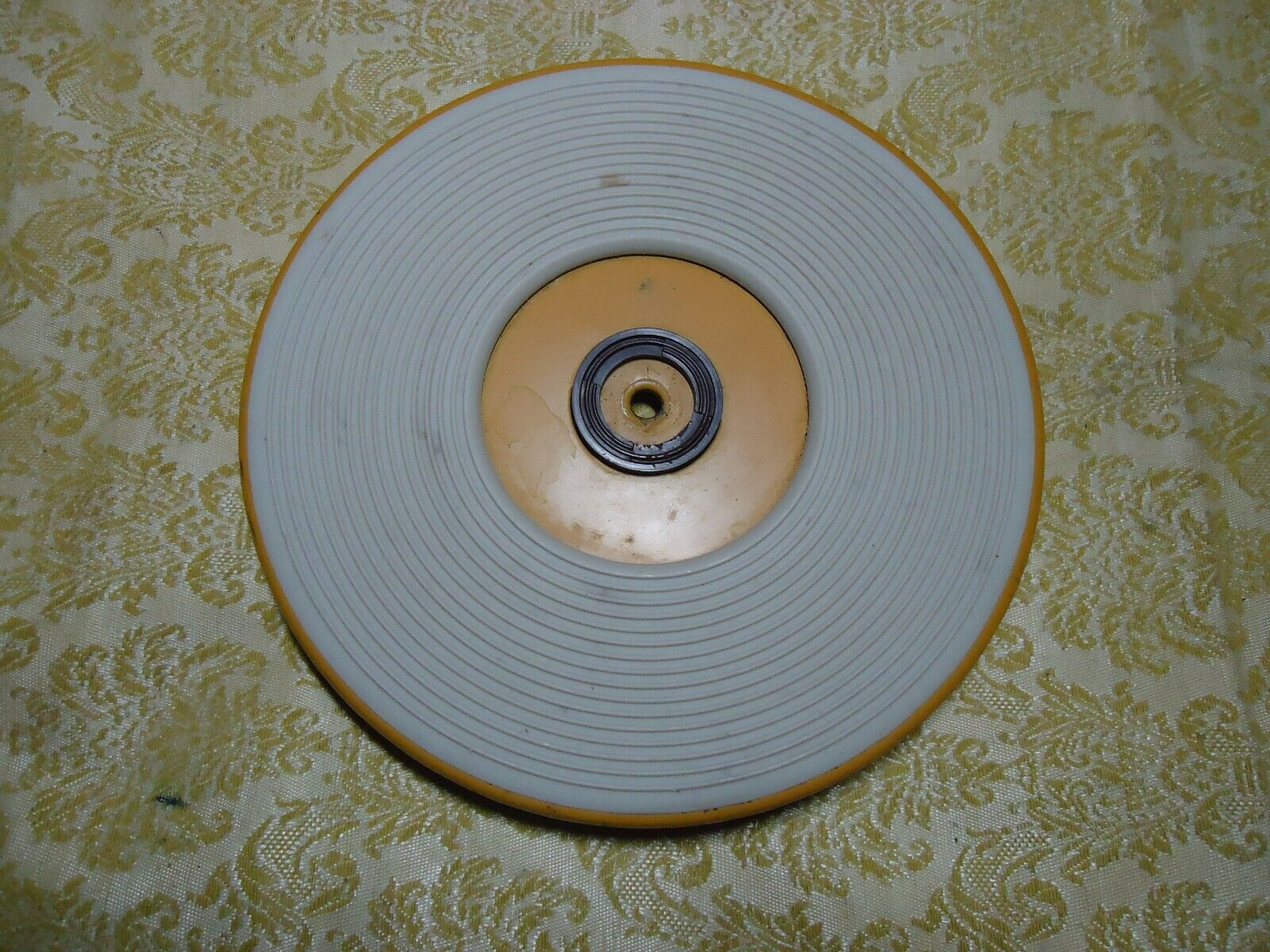

I need a new platter for this record player. I found this one on ebay. Reckon it would work? This one is not identical to the original, but if it will work, I can fix the rest.

**&^%$@!!!! I forgot to hit "submit." Try again. It's all a matter of dimensions--can you get them from the seller? The center spindle size/shape (tapered?) has to fit. The height has to be right, although that can be adjusted. The inside diameter has to be right for speed accuracy unless you can turn a new motor spindle.
