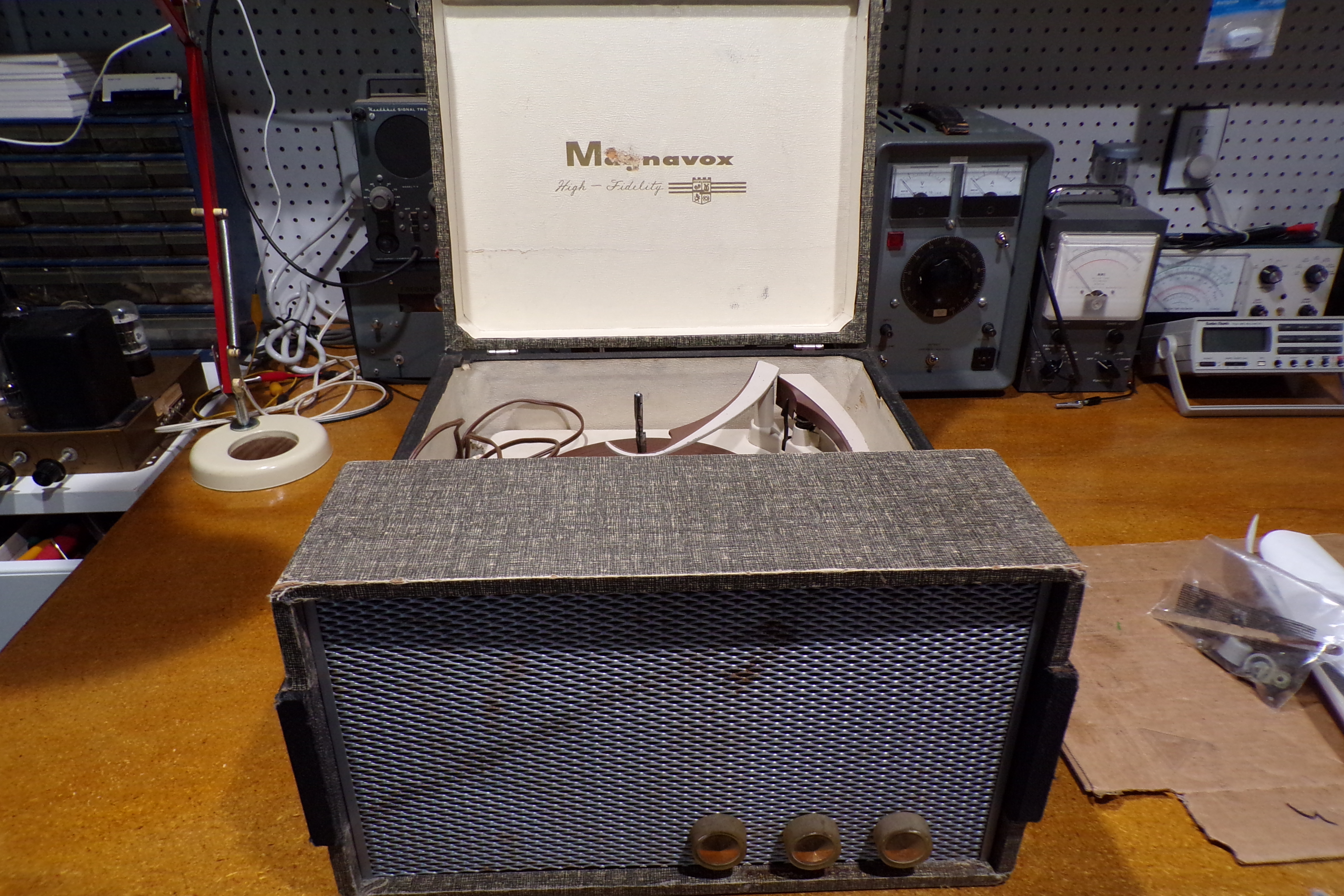

This record player will be my next restoration project. It came from here in the Valley and I've had it for three or four years. I got it about the time we started packing up to move, so I've never done anything with it. The VM changer has been serviced by Mr. VM, so all it may need is a drive tire, mounts and a needle. The hard part is done. I'll go thru the electronics then see what we have. My purpose for this instrument is to play 45's. Nothing better ever invented to play 45's than a VM changer. I forget what cartridge this has. There is a unique procedure for pulling the chassis. You have to do that before you can remove the changer. I may even have the cabinet of this one recovered. I've thought about doing it myself. This thing should be a dandy when I get it done. I've been looking forward to this project for a couple years now.

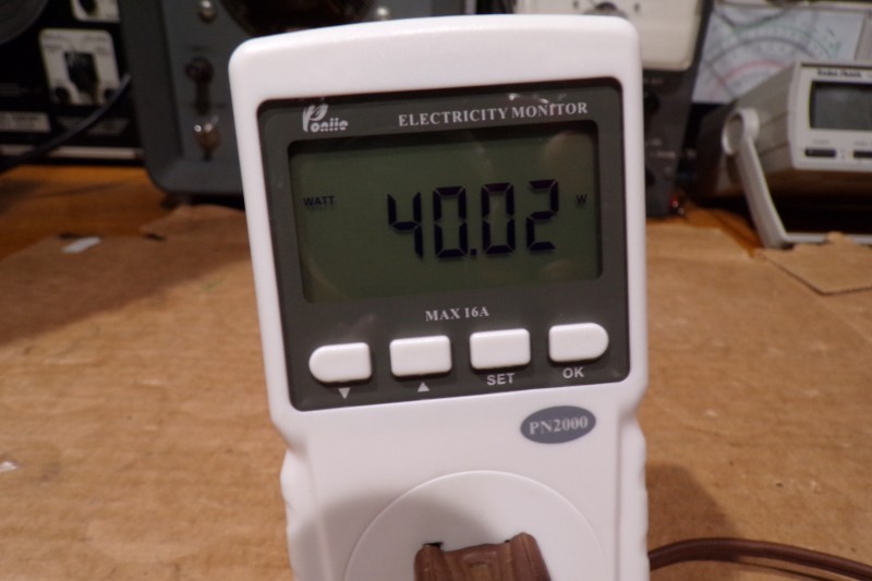

I've done a preliminary inspection and established a baseline of performance. Since the LP side of the needle is gone, I played a Fats Domino 45 with the worn-out 78 needle. This instrument sounds amazing! Even though it needs the touch, it still sounds like a Magnavox!
It pulls 40 watts running. All the tubes are Magnavox branded and the codes are: 35C5 output tubes, 2 ea., made by RCA in the 50th week of 1957. 12AX7 audio amp built by Sylvania in the 2nd week of 1958. 35W4 rectifier built by RCA, no date code readable. The 8" speaker has a 232 code, Magnavox, dated the 42nd week of 1957. The 4" speaker has a 575 code, Heppner, built the 45th week 1957. It has AMP 168-A, coded the 39th week of 1957, so it is a fair bet this is a 1958 instrument. This record player amp has the healthiest crossover cap I think I've ever seen. 2uf@50 volts. The external speaker connection arrangement is awkward and hard to remove the amp chassis without the potential of damaging the wiring. I am going to make plug-in connections for that so I can remove the amp if I ever need to. And, I'll admit that, although I have had this apart before, I had to study a bit before I remembered the secret screw. If you don't remove that ONE screw, you will destroy the front mesh grille and still won't ever get it apart.
I believe the cartridge is a Sonotone 2-T now unobtanium new, replaced by a Pfanstiel P-228 stereo cartridge, perhaps a good idea in any case. This record player combines the best of both worlds. A Magnavox instrument with a VM changer. Why Magnavox didn't use VM across the board instead of the vastly more complicated Collaro changer is beyond me.
There is a big old bumblebee/black beauty cap from the output tubes to the RCA connector for the cartridge input. I believe it to be an .047 at 600 volts. Deciphering bumblebees without a drawing is not my strong suite. I don't believe I'll need a drawing for this, since everything works now. If anyone has a value for that cap different from what I think it is, I'd be grateful if they were to correct me. Thank you all for your interest and input.
I'm beginning to wonder whether the white Tolex in the changer compartment has been replaced at some point. It's not very well done, and it doesn't match that on the inside of the lid. I don't believe Magnavox would put out such sloppy work.

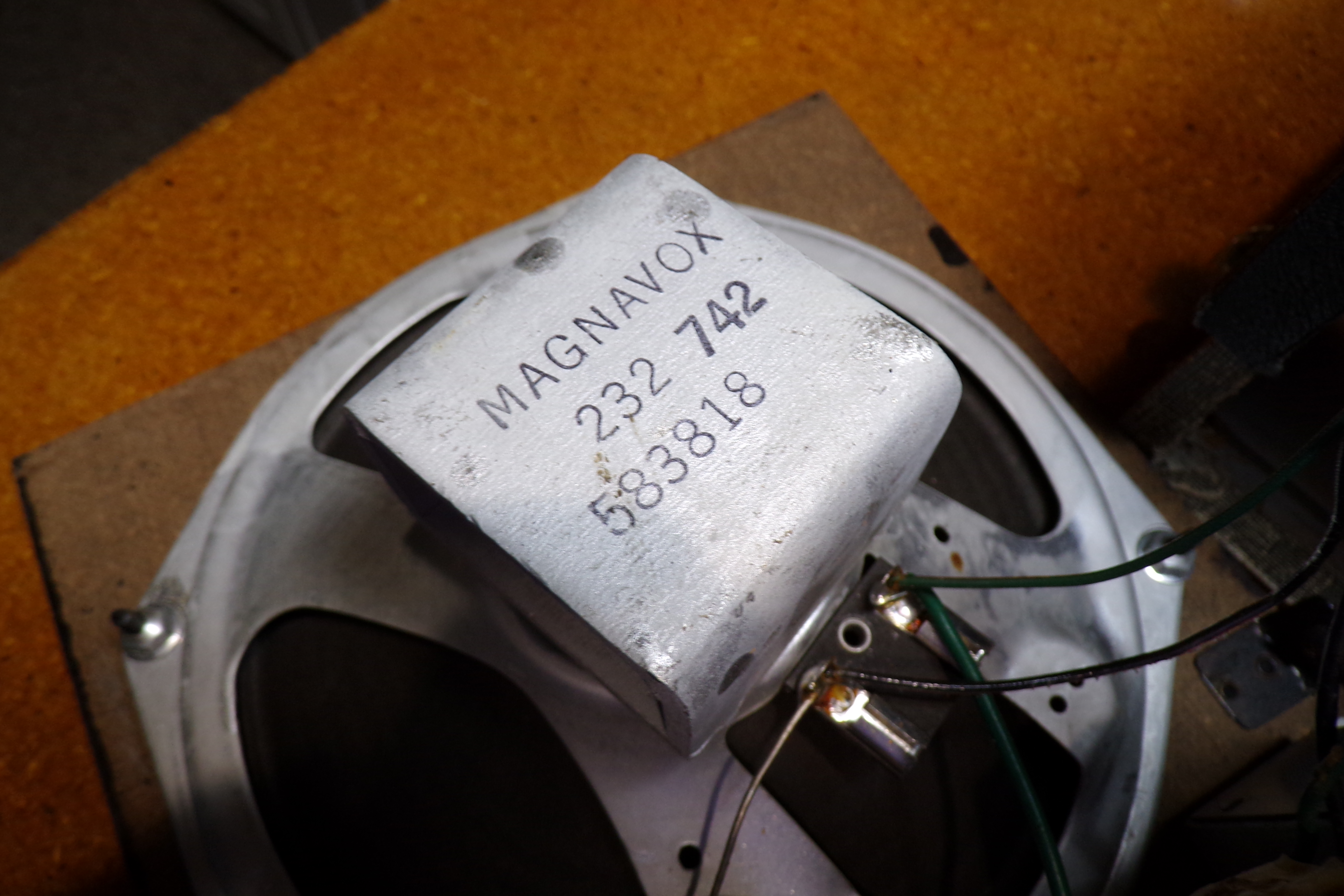

I have sometimes cured a rubbing voice coil by twisting the speaker frame slightly via shims under a couple of the corners. You might try this to see if it would work on yours. If you can flex the frame by hand and the rubbing stops, this is a cheap fix.
I have a TP-235, a slightly earlier version, and it is troubled by (1) too much bass, and (2) rattling expanded-metal grille. I have replaced the filter caps but not other caps, nor resistors, so that might explain the excess bass. Not sure what to do about that grille. I tried gluing it down. Didn't work.
- Posts: 9026
Re: Magnavox TP-241 record player
I'll try your speaker tweak idea, Chris. Thanks for that suggestion.

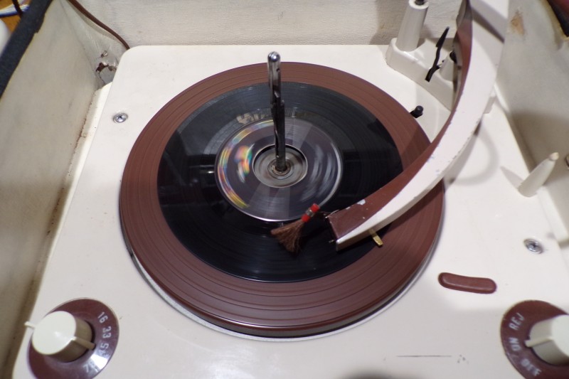

On my TP-235, the mat had rotted from sitting vertically during long storage. It's on a Collaro changer and was brown. I bought a new brown mat from the V-M guy and haven't figured out how to secure it. I'm resisting glue or double-sided tape, and so I've been storing the player horizontally. On the kitchen floor. Yeah, my house is not a showplace, unless you like old electronics, books, and recordings.electra225 wrote: ↑Mon Oct 10, 2022 12:01 am And, does anybody have a good picture of what the center of the platter mat looked like. I'm sure this had one, typical of Magnavox, likely gold in color. Mine is missing if it existed.
- Posts: 5461
Since the changer is VM, the mat is also VM with no additional trim. Remembering the mat and again seeing it again in your photos, I do not believe there was any additional trim added by Magnavox.

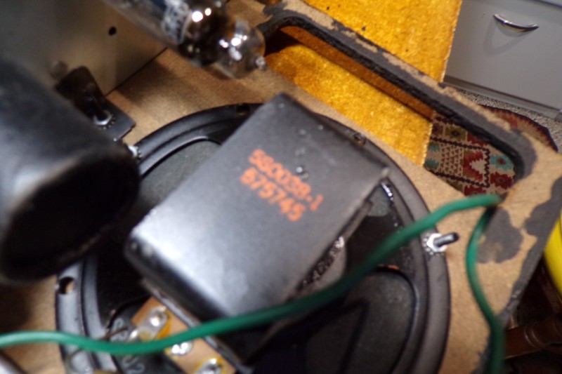

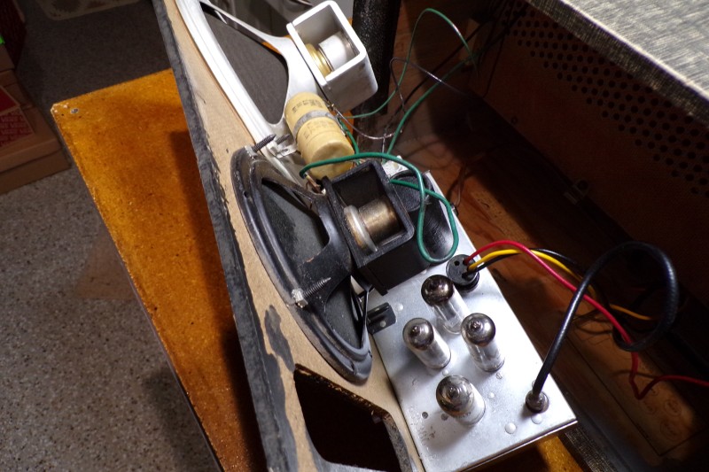

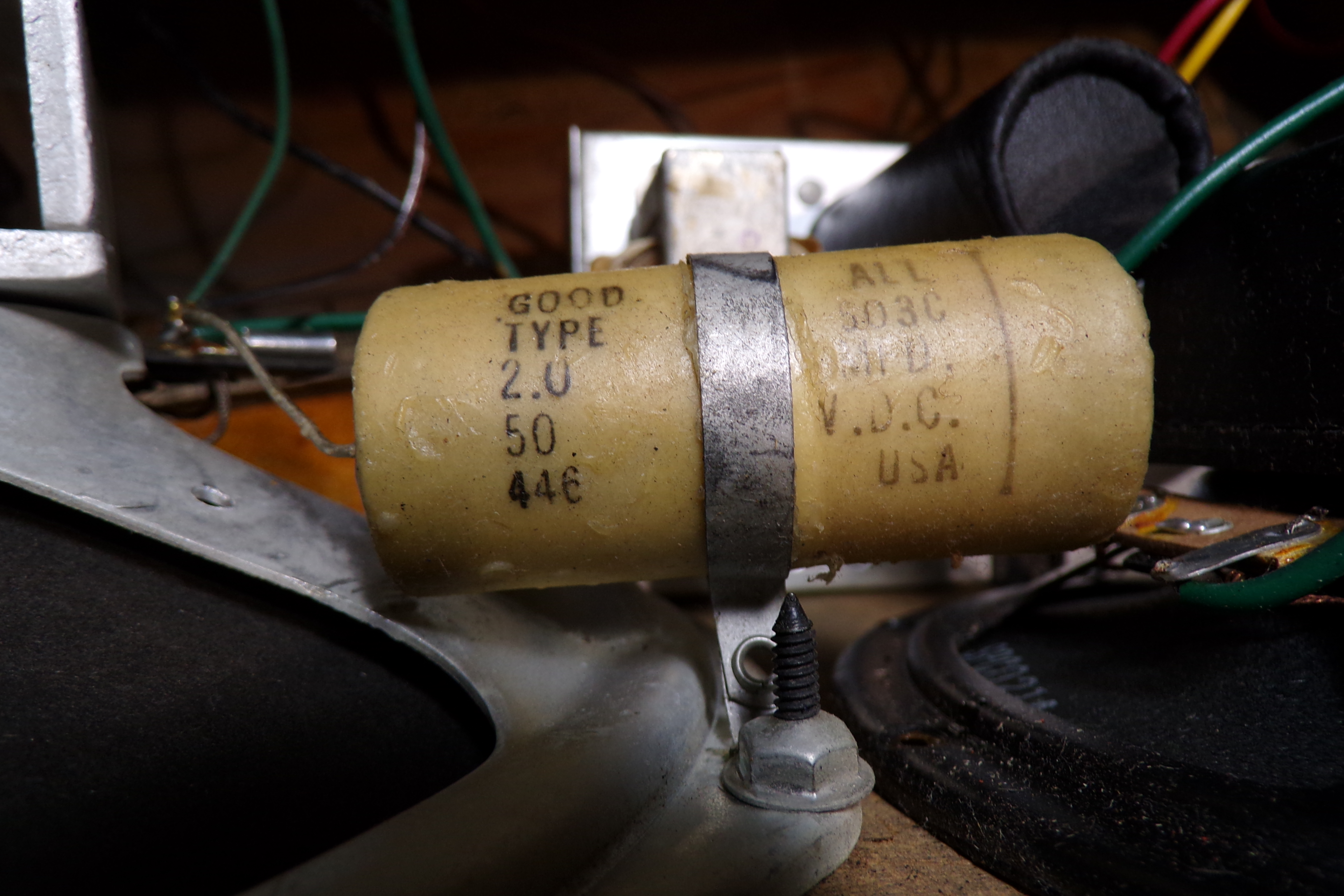

I noticed when I did my evaluation that the little speaker didn't do much. I changed the crossover cap and found that procedure brought the 4" speaker to life. I have been enjoying this record player, playing some of my old 78's. I have found that the big speaker is going to have to be repaired. The more I tinkered, the worse it got. I put the chassis/speaker assembly back into the cabinet. The little speaker quit working. I have had the chassis out of this thing a dozen times. I have soldered connections, checked everything I know to check. The little speaker refuses to work with the chassis in the cabinet. I can have it working fine, but when it get it almost back in the cabinet, the little speaker cuts out. None of the wires are in a bind that I can see. I even removed the panel in front of the changer so I could watch the wires. The little speaker refuses to work in the cabinet. The 8" big speaker will have to be repaired, since the spare speakers I have are completely round and won't clear the chassis. The one in there is probably called a square basket. The metal basket is not perfectly round.
Edit......
I just had an "ah-ha" moment. Methinks the problem with the little speaker lies in the external speaker connections. I was tinkering around with those speaker connections with a jumper lead. I touched a terminal and the little speaker started working. Fiddling with that connection would cause the little speaker to cut in and out. I need to remove the board it's mounted on and investigate further. I may eliminate the external speaker connection. I'll never use it and if it's causing an issue, I don't need it. Stand by.
- Posts: 9026
Yeah, BUT......
I was SUPPOSED to be fixing it. Why did it cut out the little speaker and not both of them? Part of the explanation is that the big speaker is wired directly to the output transformer, the little speaker positive terminal is wired thru the external speaker switch, then thru the crossover cap. There are two terminals on the external speaker switch that are internally shorted together. The ONLY theory I can come up with is that there is corrosion in that shorting lug that is somehow killing the little speaker. Who knows how long it's been since this record player was used on a regular basis. Freaky things happen to stuff when it sets, unused. You think you have it fixed until you run it for a bit. Then other things break. You keep going until nothing else breaks in a given amount of time. If and when I refinish this cabinet, there will be an extended test period before I assemble the amp chassis back into the cabinet. Knowing me, I'll forget something major, then have to take a restored record player apart to lick my calf over. Been there, done that, still have the T-shirt........
