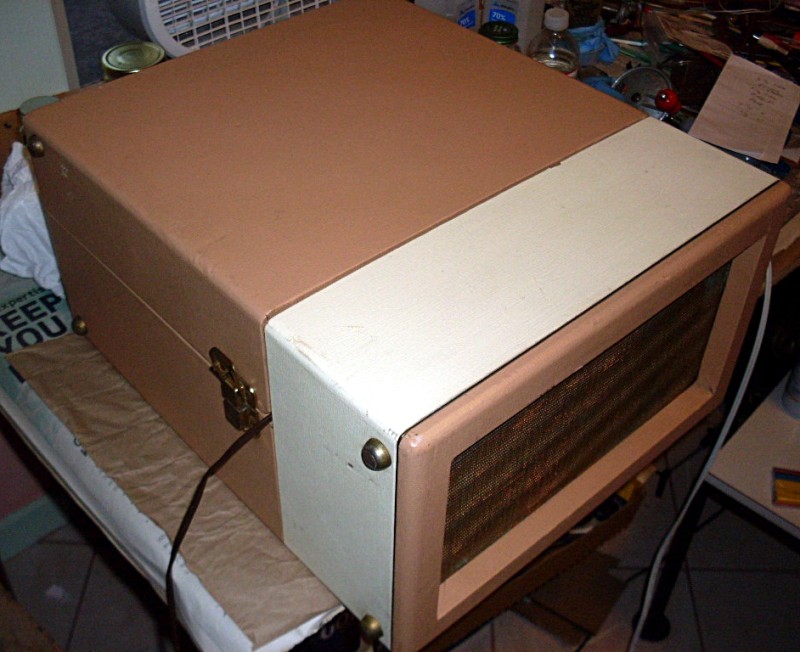

Hello all,
This is another 3 tube mono amp that had excessive
hum after complete re-cap.
I applied Motorola Minion's advice again on this one,
and I added an electrolytic cap from B- to chassis.
In this case, I decided to try a smaller value e-lytic.
I used a 10 mF 160V cap, and it worked as well
as a larger value in dropping the hum to almost zero.
I'll add a polarized plug to the AC cord, and done.
I'm glad to continue this technique after first using it on the
1959 Zenith stereo.
1959 Zenith stereo.

Another great job, Mr. Mogul! Is the tip about adding a cap from B-to chassis in the Getting Started board? If not, it should be. Thanks for sharing.

That Wards record player looks very similar to a VM model in Gary's site. My guess, VM built it for Wards.

I did a post on "getting started", with the link to the
topic page concerning the hum solution.
Today, I will try putting a 10mF e-lytic cap on a Columbia 617,
that has the same type of hum problem,
post capacitor replacements.
