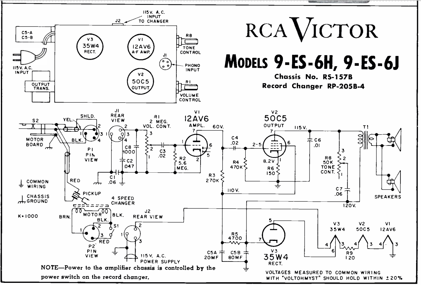

I bought this little 3 tube RCA, because I had not had an RP-205
changer to work on for some time.
When I pulled the Sams and the Beitman's schematics,
they each had different tube complements.
Sams: 12SQ7, 35Z5, and 50L6.
Beitman's: 12AV6, 35W4, and 50C5.
I found a production change of the audio tube from a 12SQ7 to
a 12AV6, but that was the only tube mentioned being changed.
Sams had a line to chassis capacitor. Beitman's did not.
My chassis had the 12AV6 lineup (Beitmans), but also the
Sams line to chassis cap.
I finally realized that no matter which tube was in my
chassis, that I should look to how the circuit connected
to the discreet parts of the tube.
So, e.g. both schematics used the plate
of the output tube in the same design.
Then it was very simple to review the circuit.
Every now and then I this little boost in
observation and learning. It's great.

Re: 1957 RCA 9-ES-6J Schematic Epiphany
Mr. Mogul, you have either chassis RS 157 or RS-157B. Sams 351-15 shows one version with the octal tubes, 12SQ7, 35Z5, 50L6. Beitmans shows RS 157B with the miniature tubes, 35W4, 12AV6, 50C5. There is an update in Sams 365-1 that shows Production Change Bulletin 188-D. That's the one you need to shed some light on your question. I'm sorry, but I don't have that. Good luck.
Thanks Greg.electra225 wrote: ↑Thu Aug 05, 2021 8:00 pm Mr. Mogul, you have either chassis RS 157 or RS-157B. Sams 351-15 shows one version with the octal tubes, 12SQ7, 35Z5, 50L6. Beitmans shows RS 157B with the miniature tubes, 35W4, 12AV6, 50C5. There is an update in Sams 365-1 that shows Production Change Bulletin 188-D. That's the one you need to shed some light on your question. I'm sorry, but I don't have that. Good luck.
I have both schematics, and another forum's nice
member found the Bulletin 188-D.
It had one sentence saying the 12SQ7 was changed to the 12AV6.
And a diagram with a 5.6 Meg resistor as a change.
Very odd no mention of the rectifier and output tube changes.
I've got the caps together, and will try to saw off the
multi-value e-lytic can, so I can stuff the 2 new ones in it.

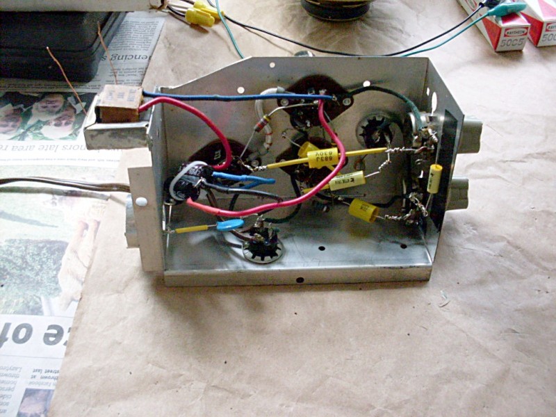

Recap is all done and I have sound.
There is some distortion at the 3/4 vol control point.
The original Sonotone 2-T is good. Speaker tested OK.
I checked the 12AV6, and it is in the Replace/Weak zone
on my Precision 10-12 tube tester.
A friend down the street says he has the tube for me.
Questions please:
Is the distortion likely due to the bad tube ?
And, if so, what component in this tube is failing ?
Questions please:
Thanks for the reply, Greg.
For this, single 50C5 output tube amp,
3/4 on the Vol pot only gets the volume
to listenable level.
I checked the speaker, no rub.
Subbed another speaker to confirm.
Speaker is on work table out of cabinet.
I replaced the 50C5, known for issues,
with a tested NOS, no change.
35W4 rectifier tests OK.
Will run voltage checks tomorrow with the
new 12AV6 installed.
I know it's a rarity that a problem is actually
caused by a "bad tube", ha ha !
Okay guys, here's more data.
(BTW, I still cannot load a pdf file, so I
made a .png of the schematic)
1. The new 12AV6 made no difference in the
distortion.
If I had to characterize it, I would say its most pronounced
in the lower frequencies of the songs.
2. Voltages measured with DMM
12AV6
Plate Pin 7: 48 V
Grid Pin 1: (-) 0.74 V
Cathode Pin 2 : 0 V
35W4
Plate Pin 5: 0.23 V
Cathode Pin 7 : 105 V
50C5
Plate Pin 7: 96 V
Grid Pin 2: 1.16 V
Cathode Pin 1: 10.4 V
Grid Pin 6: 90 V
distortion.
12AV6
Plate Pin 7: 48 V
Cathode Pin 2 : 0 V
35W4
Plate Pin 5: 0.23 V
50C5
Plate Pin 7: 96 V
Grid Pin 2: 1.16 V
Grid Pin 6: 90 V
- Posts: 9026
The schematic says all voltages should be + or - 20% from those given, at 115 volts line voltage. If your line voltage is 115 volts, then the voltages are within tolerance. If it is higher than 115, they are a tad low. My suggestion would be to sub the rectifier if you have a new one. See if the voltages change. I really don't think they are that far off. The cathode voltage on the 50C5 is high, the rest are low. You might measure R6 to see if it has drifted. It should be real close to value, 150 ohms. Cathode voltage is still within the 20% tolerance.
Thanks for the check out on those voltages.
I think my VAC is around 120 here, if I remember.
I do have several 35W4 tubes to try.
I will disconnect one side of R6 out of circuit and test it.
I did try another cartridge, with the same distortion.
But, I think things are getting close now for a solution.

- Posts: 9026
You might check C6 and R4 as well. I assume C6 was replaced. Make sure R4 hasn't drifted.
C6 and all other caps replaced.electra225 wrote: ↑Sun Aug 08, 2021 12:09 am You might check C6 and R4 as well. I assume C6 was replaced. Make sure R4 hasn't drifted.
R4 (470K reads 500K ohms)
R6 (150 reads 200 ohms)
I have both values and will replace the old
ones.
R6 certainly is off, and I hope that will
rectify the problem.
Ix-Nay on the new resistors solving the distortion.
I'm going to spray the audio tube pins w/deoxit and
put tube in/out of socket to clean it.
Then I'm going to re-flow the audio
tube pins' solder points.
Everything's been replaced, except R5, R9 & R3 resistors, which
check OK.
Now a bit perplexing....
check OK.
