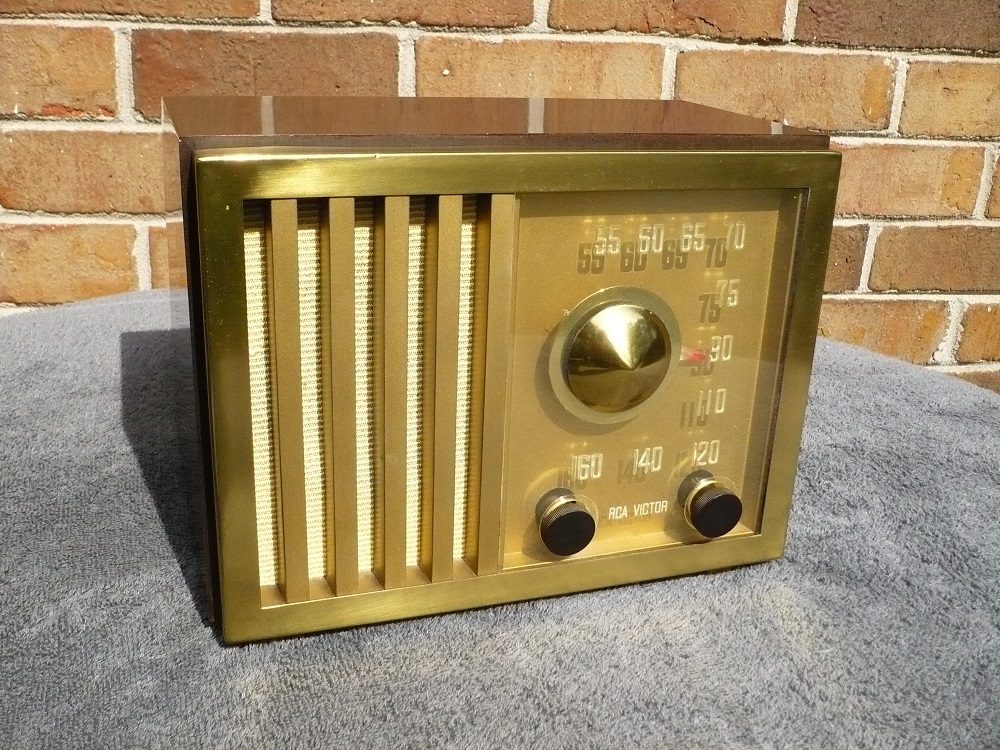

The natural bakelite cabinet model. they also came in a white woodgrain, dark woodgrain and a Chinese lacqureware applique finish in black or cinnibar. A nice entry level radio given a moderne treatment. I had to sand about an 8th of an inch off the dials surfaces to get through the hazed layers. It's a nice little performer.

That's a good-looking radio, Rex. Thanks for sharing both posts.

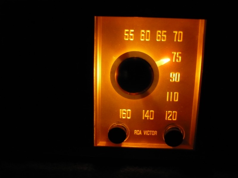

I wondered if you still had that radio. I like the way RCA lit the dial on that radio. The red on the tip of the pointer lights up. That is one of those cabinets that getting the chassis out of can be a challenge. Not bad once you get the hang of it.

It's an AA5. It has a curved and slanted back. They can get pretty bad looking in some cases. I have one in the attic in unrestored shape. I've always liked the edge lit acrylic dials, signs and such.
