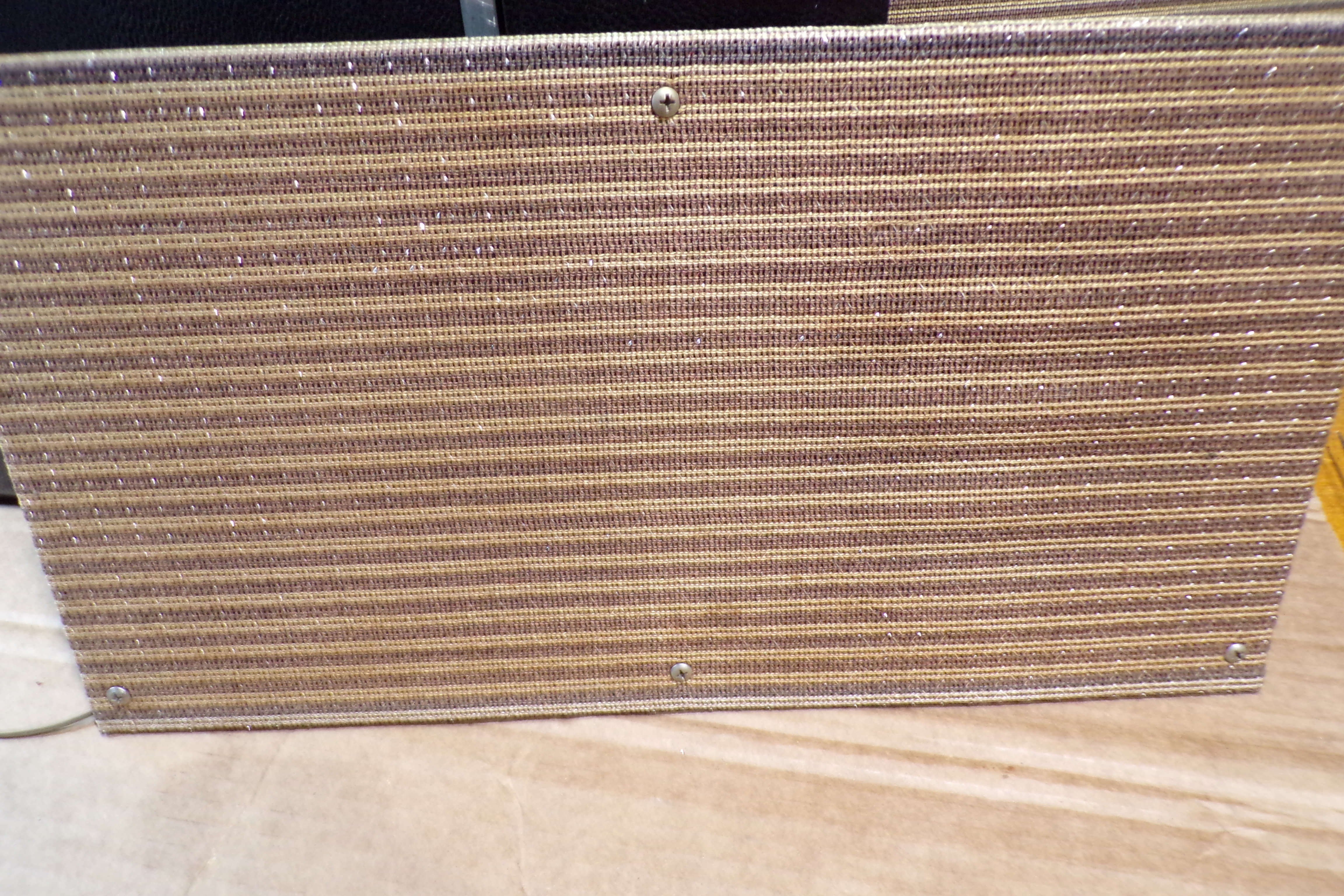

I got the Tolex and grille cloth I needed to finish this job this morning. I really like how the grille cloth looks. It is stiff and rather hard to work with, but it is stable and nice and flat when you get it on. I used Elmer's glue in the case something oozed thru the cloth, which is a good thing I did. Before and after on the right hand speaker board. Colors are black, red, white, silver, and gold. GE used both gold and silver trim on this thing, rather an odd arrangement. All red grille cloth was going to be way too gawdy. This is plenty bright in real life, and includes all the colors I used in the cabinet.

Attractive choice.
- Posts: 5462
Re: General Electric RP-1590 stereo cabinet restoration
I like that and it would go great on my little SC that I never found grille cloth that I liked. At least not yet!
Thanks, Greg.
- Posts: 9028
I may have some left over from this project. Or I could link the grille cloth I got and you can order some. I'm glad you like it. I believe it to be an acceptable compromise.

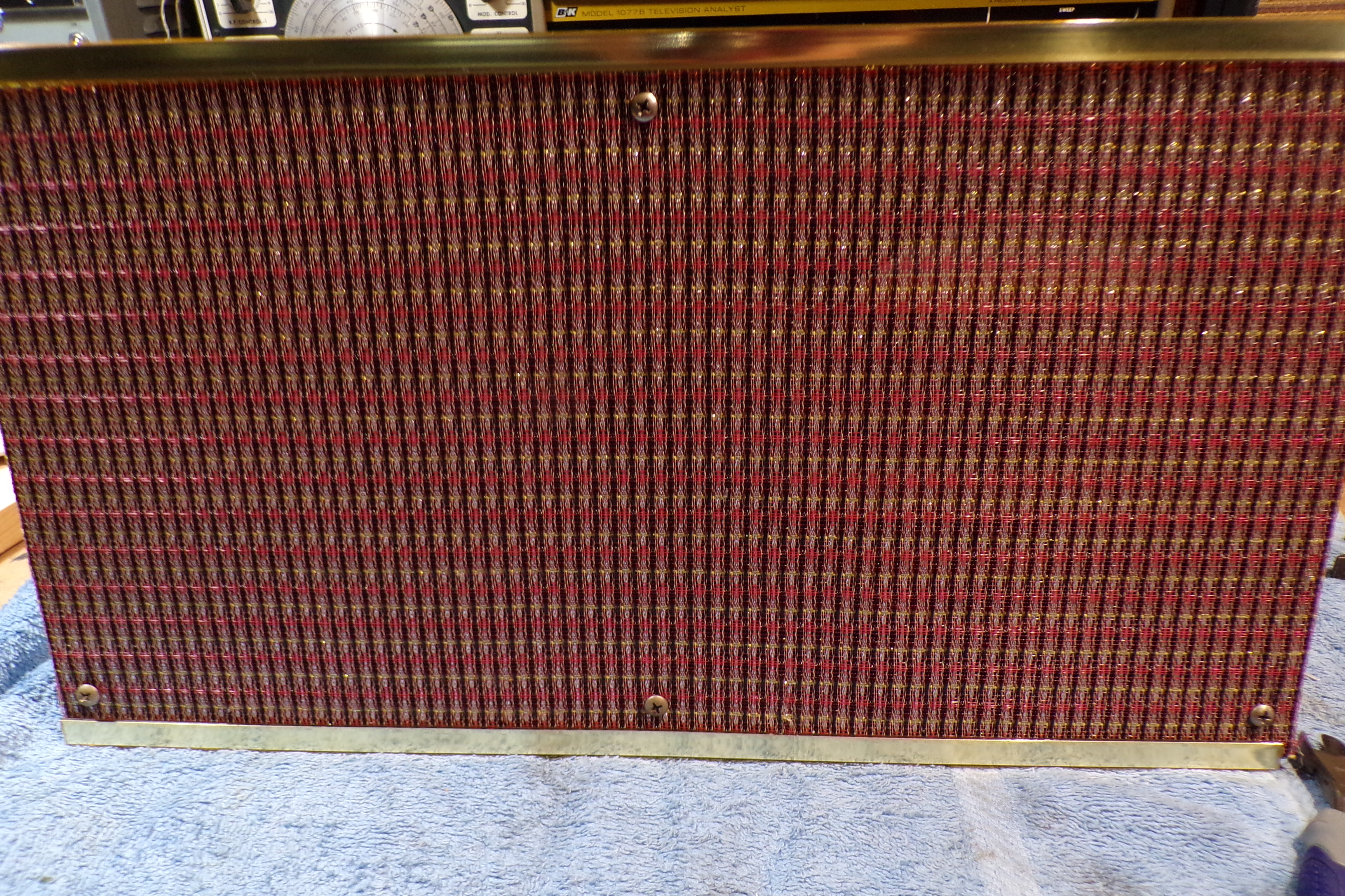

Gawd, cloth is expensive, but I can use it on several
projects.
It will be great on the 1957 RCA that the roaches ate most
of its grille cloth off. [ : )
Thanks, Greg.
p.s. I found an oxblood pattern there for almost
1/2 price of the other pattern, and it will work
great on the RCA !!!

I almost use the oxblood pattern myself, but it didn't have enough bright red in it for my "color scheme". Yeah, everything for this cheap stereo has been pretty spendy.

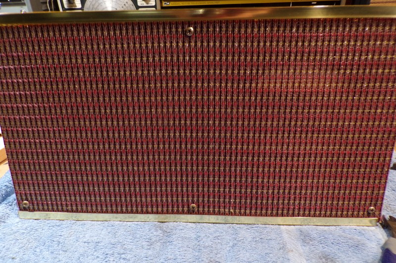

The grille cloth installation on the main cabinet is a pain. Installing the piping pulls the cloth so it isn't straight. I finally got smart, cut the piece a tad large each way, installed it dry with the piping so I could get a "set" on the cloth, then removed it and glued it down. I worked two hours getting a piece 3" X 18" on and straight. The speaker boxes are done as far as grilled cloth is concerned.

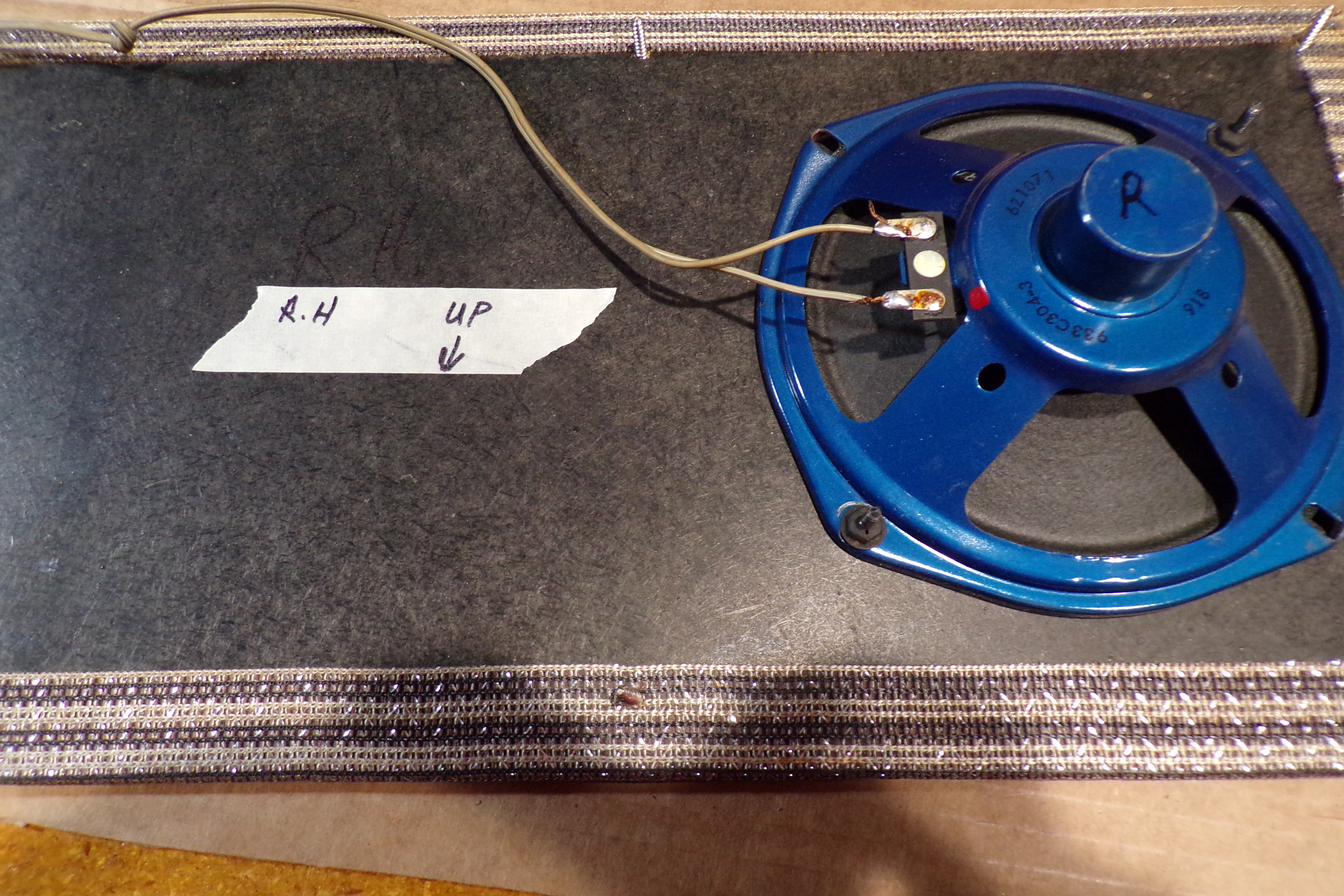

"One step forward and two steps back" seems to fit how this project went today. First, I spilled a Pepsi on the LH external speaker grille cloth, so I had to do it again. I got the rest of the grille cloth on the main cabinet, a project I had been putting off since I had so much hassle with the other half. It couldn't have gone better. Go figure.

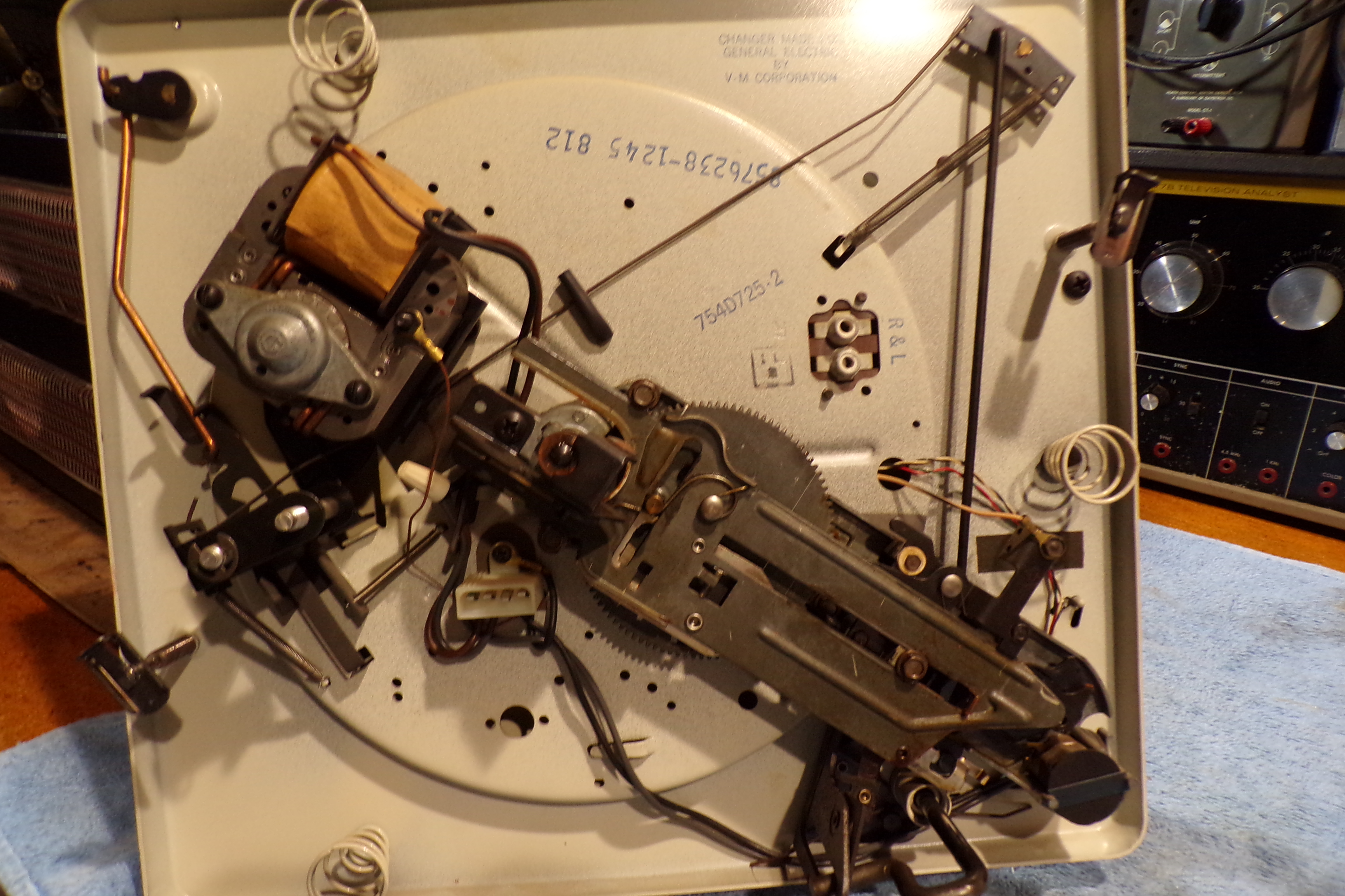

I decided to run a little maintenance on the changer, which, if you recall, was working PERFECTLY. But no.......Greg had to "fix" it. I fixed it alright. Now it stalls when the changer cycles. I did all the right stuff. I used alcohol on the platter rim and the drive tire. I made sure I got all the washers back right. Now the silly thing is a door stop. Like usual, I "fixed" a perfectly good changer, just because I didn't want to be such a chicken working on changers. Of course, I killed it.....

This is a VM changer, right? Tell me exactly what you did please?

It is a VM 1200 series, the best changer ever built by mankind, but I killed a perfectly good VM changer....
I swear what I'm telling you is the truth. All I did while I had the changer out was to use 99% rubbing alcohol on the inner rim of the platter and on the drive tire. I didn't oil anything, didn't have any oil out. All I wanted to do was just a little cleaning. Probably my next step will be to remove the platter again, then wash the motor shaft and drive tire with lacquer thinner. Then maybe a bit of sanding on the rim of the drive tire. It seems pliable, so I did nothing more. How can that simple procedure make it stall? It still cycles and drops records okay, it just stalls when the changer cycles. Jeez....

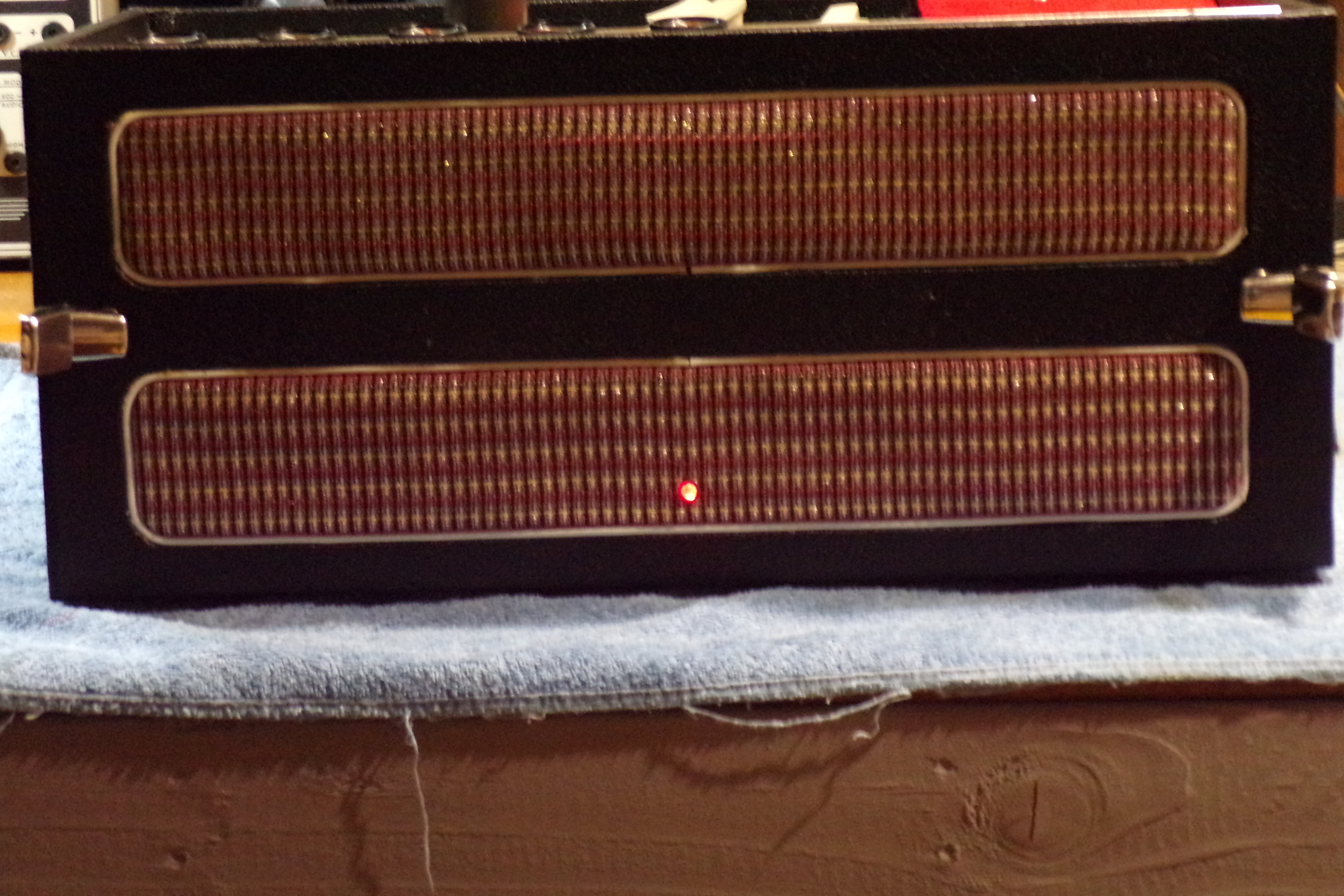

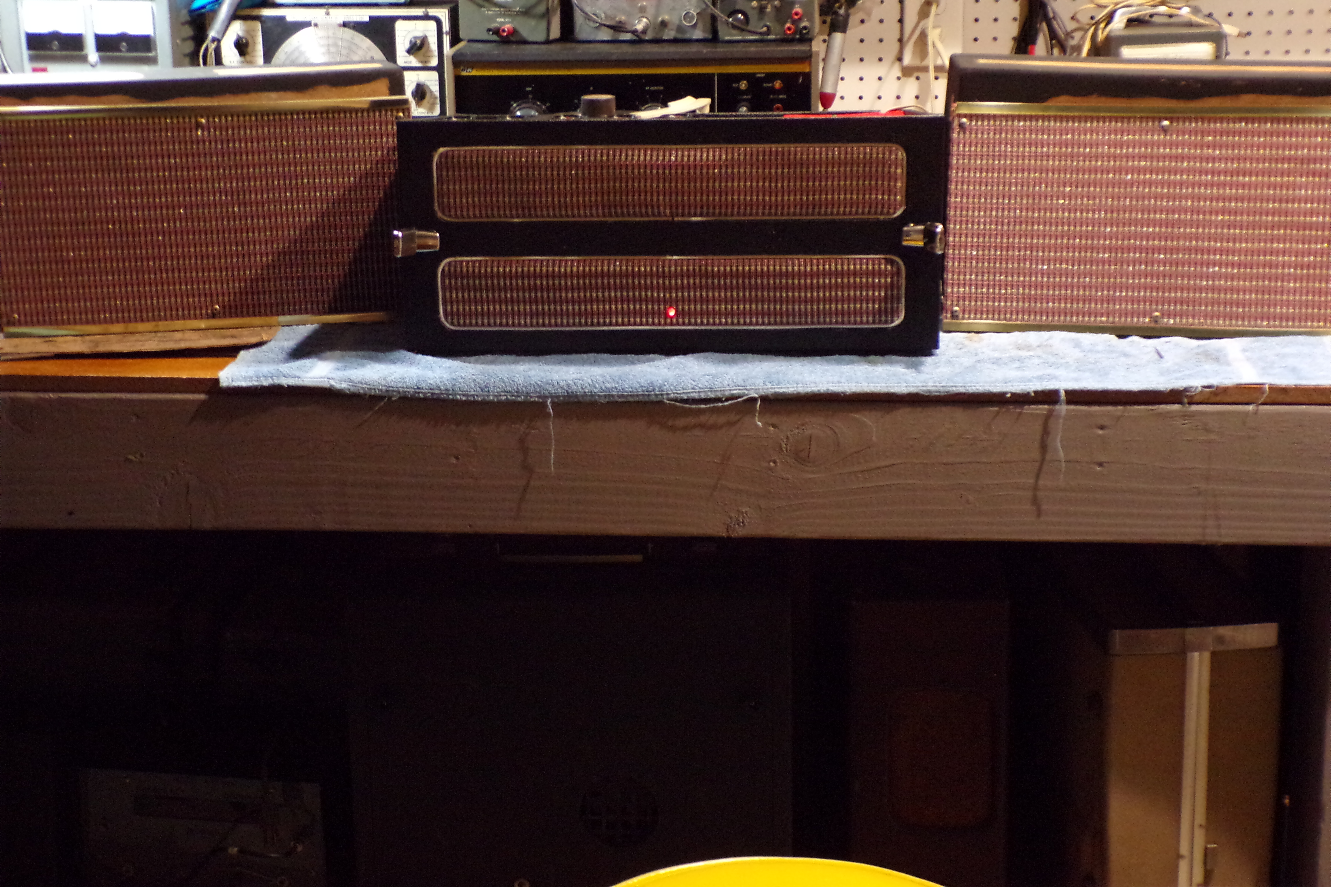

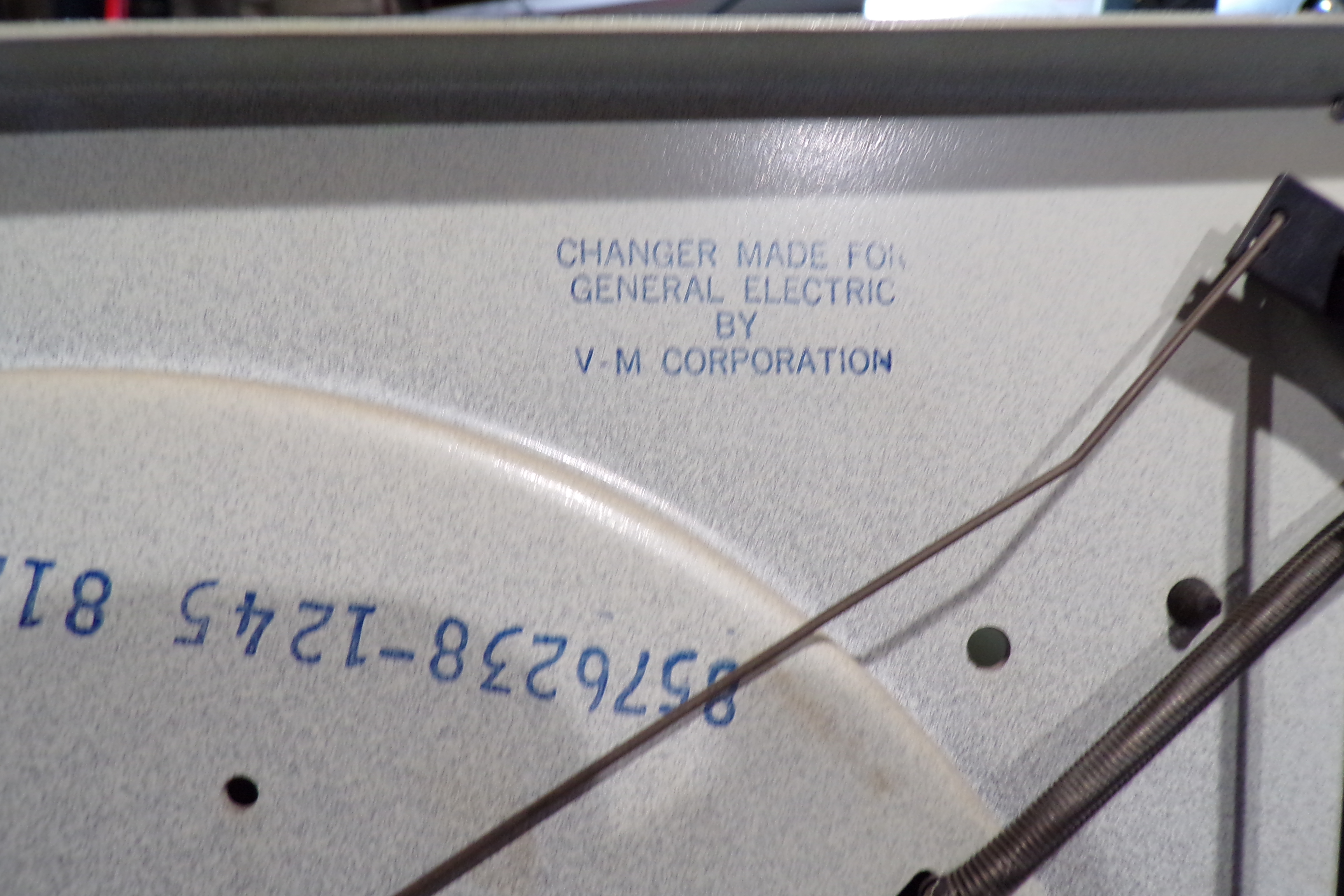

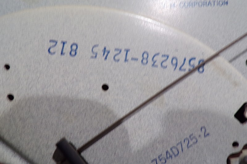

Pictures. This is the bottom of the changer. I wouldn't know an aluminum changing, cycling doodad you guys were asking about if it bit me. Does it have an aluminum thingy?
Grille cloth. Even the little red pilot light survived and it works....

I agree that it sounds like the idler is slipping.
Do the cleaning as you stated on the platter and idler
and let us know.
It it was the motor, the changer mech would be slow or non-working at
all points of the cycle.
But, include cleaning of the stepped motor rotor spindle.

I agree with Mr. Mogul, and lightly sand the drive tire. When you cleaned it with alcohol that may have taken any remaining bit away. After sanding just wipe it with a clean piece of paper towel and try not to touch the rubber part when installing.
The doodad we are always talking about is not visible in your photo, it is hidden under the slide mechanism and is attached to the cycling gear. Looking at your photo, this VM 1200 is a newer series, and although I have seen worse, it could stand to be serviced. Hopefully, for now, what Mr. Mogul and I have suggested will get it working again. Please keep us posted and good thoughts go your way.

My intention was/is to go thru a parts changer I have that has the Custom tone arm. If I mess it up, it won't be the end of the world. You guys can talk me thru it, then, if that is successful, I'll dig this one back out and go thru it. I haven't had a lot of experience with changer servicing, but this one looks really nice, in good shape. If I read the codes right on the underside of the changer, it was built in the 38th week of 1962. I have no idea how or why such a beat-up old stereo had such a nice changer. The amp in this thing is nice too. It is not all fried like they typically are found. And it has the original needle, or a factory replacement, so that might account for why the amp is so nice. Maybe fairly low hours? This old stereo still has the factory plugs on the wing speaker wires. Most have been replaced because they go wonky and don't work dependably. These are still good.
I'll follow your instructions and see what I can do to fix my screw-up. Thanks for your patience and for your input.
Just for the record, the grille cloth looks better in person than it does in those pictures. My photography skills match my changer repair skills in some cases.....

Your Tolex and grille cloth skills are very good, not that I would know since I probably would never tackle such a project. That would scare me like changers scare you. I like the little red indicator light on the front, it adds class.
