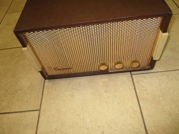

I see I may be missing a trim piece that goes on the upper part of the cabinet and holds the speaker grill in place. There are three holes there with nothing in them. I found a picture of a similar model on ebay that shows what I need. I believe if I find a piece of aluminum angle it should work.

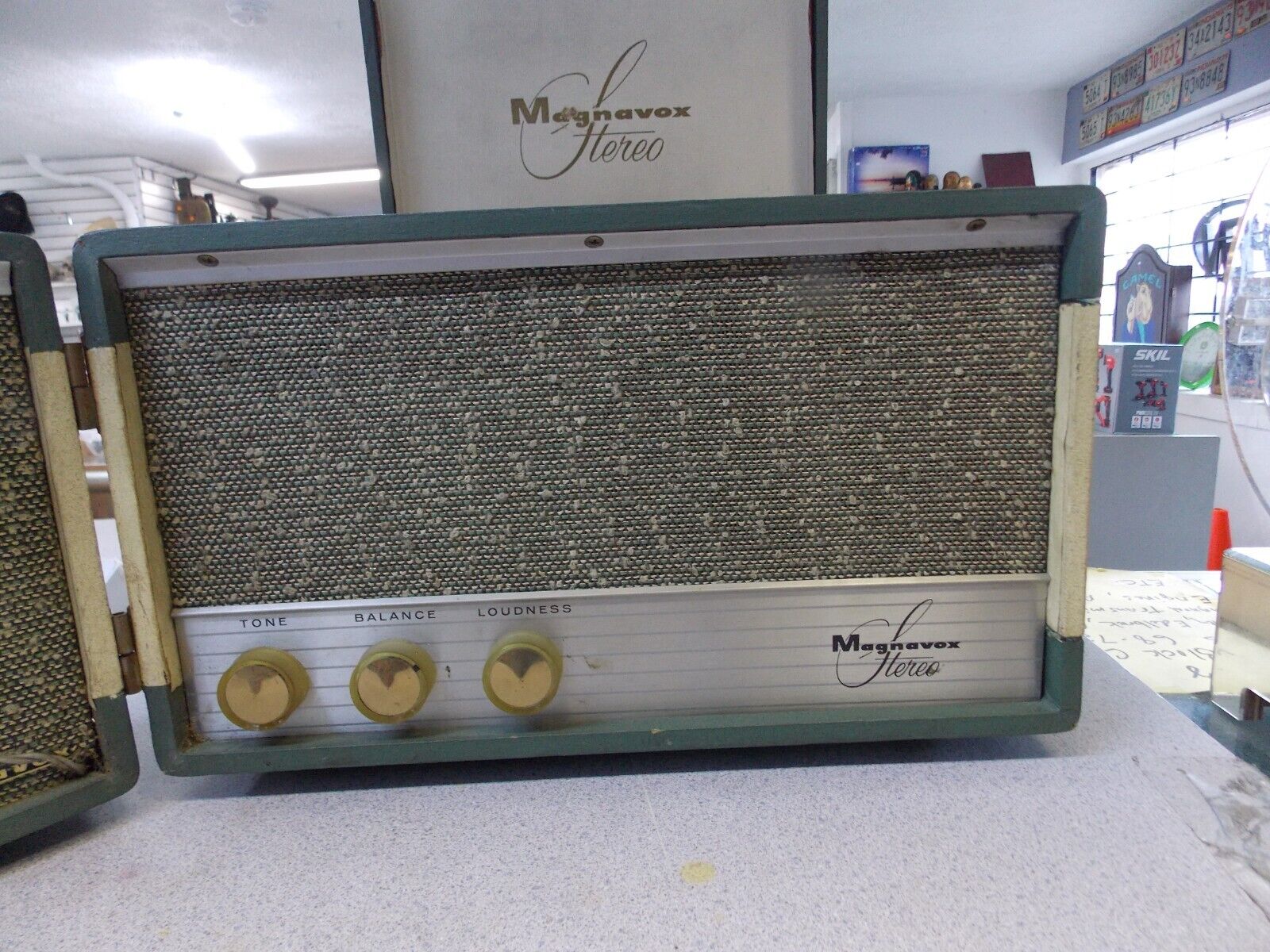

I believe I am missing a piece of trim, but maybe not like the one posted above. My model is not easy to find on the internet. I found this one, two-tone brown. It appears there is a channel of aluminum that runs along the top like on the sides and is held in with the three screws I found holes for. If you look real close at this one I found, you may see what I'm referring to. If anybody has a clearer picture of the front of a TP 241, I'd like to look at it.
