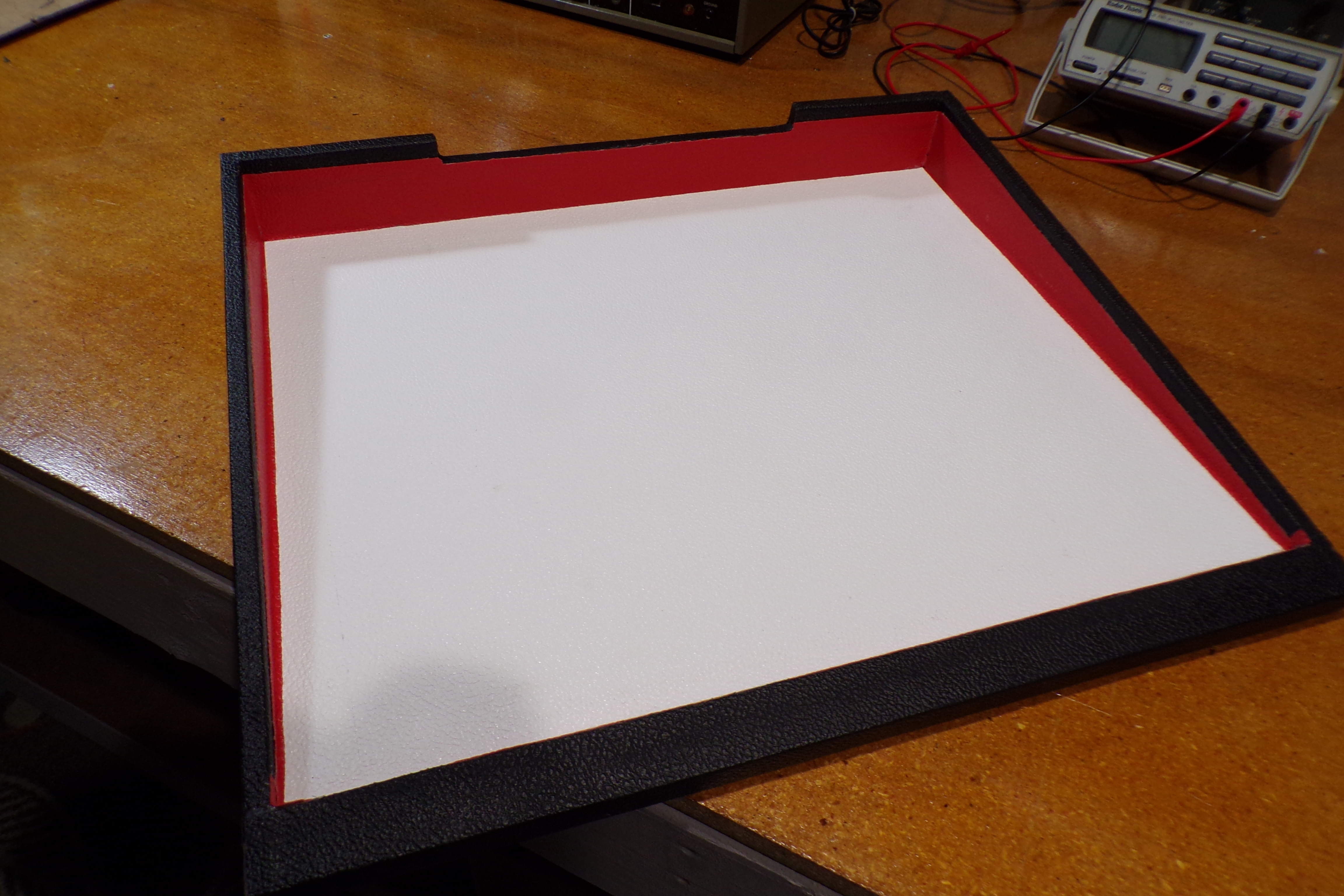

Sometimes, the plan doesn't come together. This afternoon, I made my first major faux pas in the installation of Tolex. I cut a panel backwards, that is I drew it backwards. It fits absolutely perfectly only the big end is on the little end and vise versa. I worked four hours and got four panels on the lid and got another one cut ready to glue. I need to have enough Tolex glue for two more panels, than I can use Elmer's on the rest. It is in the 70's here today and the glue is drying slowly, even using a hair dryer. If I get it warm enough to really dry the glue, the panels curl then they are hard to get on straight. I know I"m being too picky. I measure three or four times before I cut. Then I fit before I glue. Fortunately, the "backwards panel" was red, and I have plenty of that. I still need to get more black Tolex to finish the speakers. I figure another month of work at the pace I'm going now is what it will take to finish. All the black is on except the speaker boxes. I am working on red now. Next will be the white in the lid. After that will be grille cloth and piping. Then decals. Then fasteners. Final assembly, then whatever I'm going to do with the changer.

I have the Tolex all done on the lid. The lid was harder to get done right than the bottom of the cabinet. I finally figured out how to cut the main piece of white in the lid. I measure the best I can, but always get them too large. This time, I carefully measured, then cut the width from 1/8" to a short 3/16" inch narrower, then cut the length from 3/16" to a short 1/4" shorter. This allowed that piece to fit better. I had curled the red under the white in case I got the white a tad brief. I reckon the reason it "grows" when you put the Tolex on is that you can't get the Tolex perfectly flat when you measure it for cutting. When you put it on the cabinet, you get it perfectly flat, so it grows. I had an air bubble captured that I couldn't get to move, right in the middle where the decals go. I cheated. I cut a small slit in the Tolex and let the air escape. When I rolled it back down, you can't see the slit in the Tolex. I'm satisfied with how this has turned out so far. While I'm waiting on more black Tolex for the speaker boxes, I have some work yet to do on the chassis and I need to find all the holes that hold on the hardware. I have pictures, but I was too lazy this afternoon to download them to the computer.
