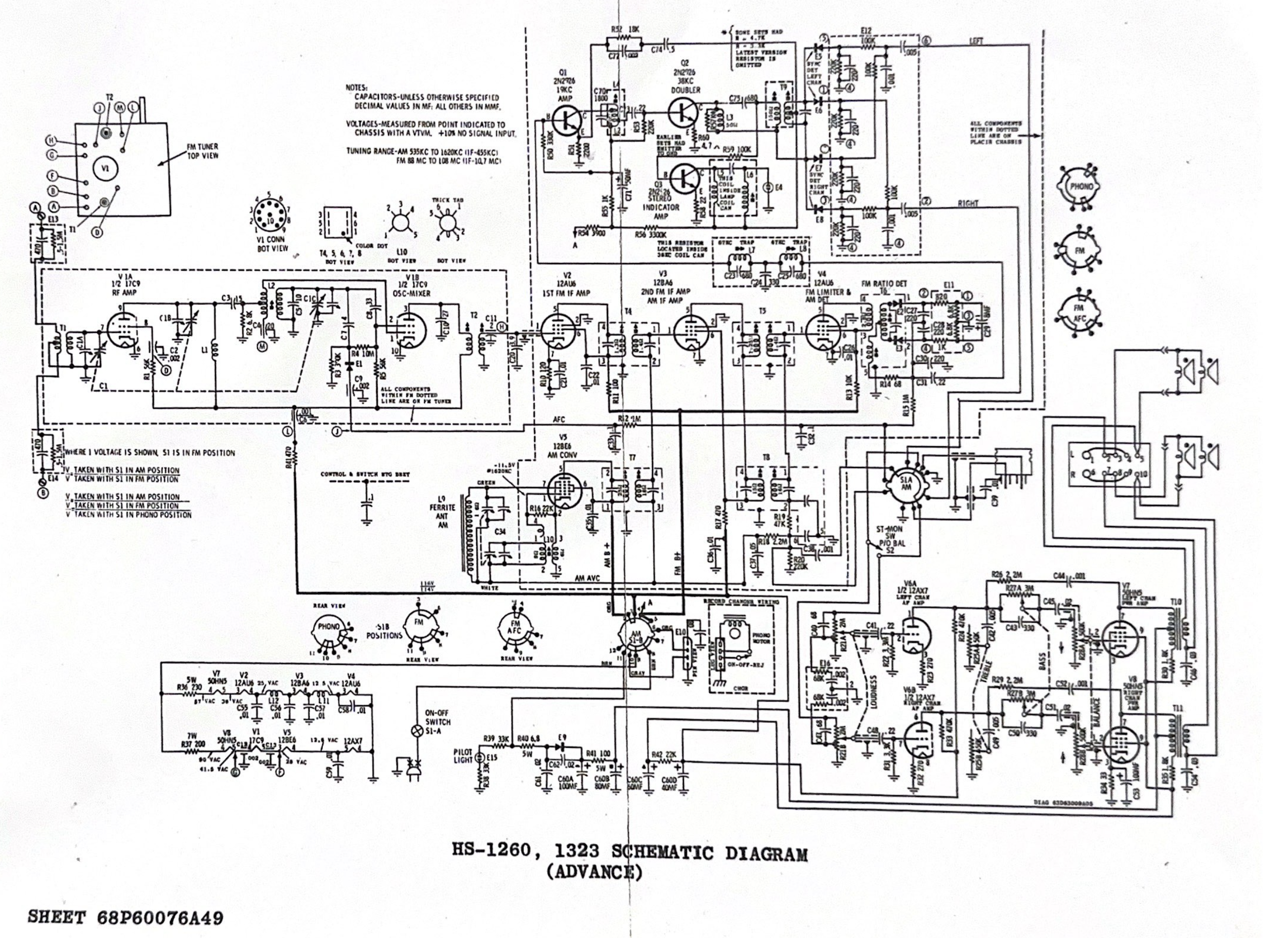

Hopefully this schematics I found with a recently bought st82a is helpful

- Posts: 3690
How about posting a scan of the schematic to the downloads section? I copied it and pasted it into Word so I could enlarge it (fuzzily) but having it in downloads would make it more useful.
I will make a higher resolution scan/picture and try to post it there soon. I've got the original sales packet and schematic

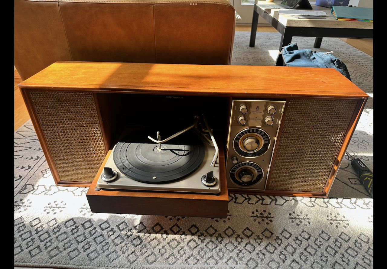

I'm new to classic hifi. A few months ago, I bought a 1959 Motorola Sk33 from a great guy and electric engineer who refurbishes them. Since then I've been keeping an eye out for nice looking and repairable stereos. I saw a wall mounted stereo cabinet for the first time at an estate sale (ST-82A) and bought it despite it only being able to play the radio since the cartridge was missing (Gary helped with that).
Like the SK33 (Drexel built), it's a beautiful piece of MCM cabinetry. I've taken it to an engineer to install a transformer to address the always-hot AA5 issue and BT adapter (I've been advised to upgrade to a Wi-Fi adapter for better sound file quality and will probably try that). I'm hoping to use the rear external speaker connections on the ST82A to connect a wireless subwoofer and give it a fuller range of audio playback. The end use of it will be in a MCM-styled 1964 condo tower to be a pseudo-tv console stand, record player, streamable stereo system, and front speaker system for the tv. I will be wall mounting a tv above the stereo cabinet and maybe place a center channel on top of the stereo so the tv has a 3.1 output.

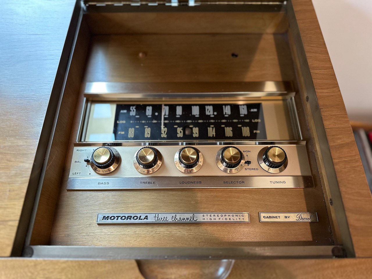

SK33 photos attached. Tube sound is nicer than the modern HT amps I use. Nice to have a 15" sub in the cabinet. I'm considering trying to try to frame-in the speakers and sub in the sk33 and add some foam sound mats so they perform more like a sealed speaker. Not sure if that'll help make a tighter sound and/or cause issues with heat buildup.
Speakers don't perform as well as the Martin Logan ESLs I use. Have a small tube amp coming so I can try tabletop vinyl on the ESLs soon.

ST82A photos attached, it'll be interesting to hear how it plays when I get it back. I'll try to copy the specs and paperwork I have for both models and upload it soon.
