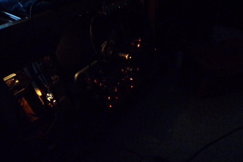

Mostly, yet partial, success! I have high voltage with a nice, full raster. I have no audio at all. I believe I may have video, since I have snow on the screen. When I change channels, I get a flash on the screen, so may I assume the tuner is working? The audio detector tube is fed B+ from the boost line. I need to verify B+ on the audio board. From what I can tell at this point, the horizontal and vertical deflection appears to be stable. I can see the lines on the top of the screen are wider than in the middle of the screen, so vertical height or linearity may be off a bit. I can connect the Analyzer to the antenna terminals, then see if I can get an image on the screen. Fine tuning may still be off, since I have no idea where it is.

I need to get an image on the screen, then determine why I have no audio. I forgot to mention it pulls 315 watts with the TV powered up now. It only pulled 250 watts with no high voltage. This thing will heat the shop almost as well as the Concert Grand does. ;) ;) I was sure glad to see the picture tube light, I can tell you that. The shield wire that was disconnected made a difference, I think. I just can't tell what difference it made until I get sound.

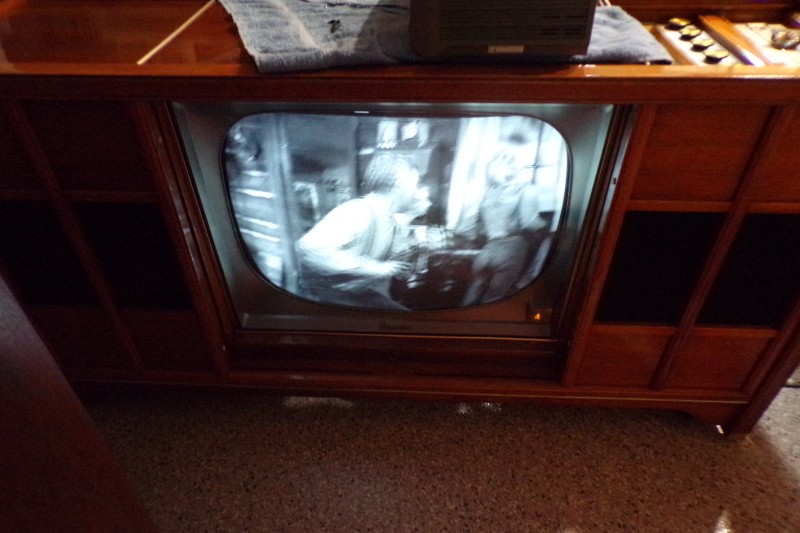

More success! I'm getting closer to actually watching TV! Well, to be honest, I can now WATCH, what I meant to say was I am getting closer to watching AND listening to TV. This image is the most beautiful image I have seen on a TV screen in a LONGGGGGG time. Egg-shaped and out of focus though it may be, it is still beautiful. I have absolutely NO sound. The good news besides having an image, is that I fed the output of the Analyzer into the antenna terminals. This proves the tuner is working, so I don't have to remove it. YEA!!!!! :D :D :D :D :D
I'm not going to do any tuning up of the image until I get sound. Vertical height is off, maybe linearity as well. Width may be a bit fat as well. Still draws 315 watts. Seems like it takes a long time for the picture tube to light, but it's been awhile since I messed with an old tube B&W set. The image is stable, the vertical and horizontal lock in approximately the middle of their range. I can hear the vertical running. The horizontal makes a little squeal, but not all that much. I'll run some voltage checks on the sound board, then report back. I am beyond thrilled so far.... ;) ;) :D :D :D :D

I connected an old VCR to this set today. I was watching a cut rate version of the Beverly Hillbillies. I say cut rate because it doesn't use the original theme song, which I wanted so I could check the audio. The audio on this CD is really chintzy, I can tell you that. I don't get any hum or buzz between scenes, the vertical and horizontal are rock solid. I may have a tad of horizontal pulling on the right side of the picture, but that may be due to the "not the best" CD I was playing. The picture is beautiful. The TV guys say a "Maggotbox" is not worth working with, but this thing is impressive. I could use a 1/4" more vertical deflection, but I'm not going to mess with it. The picture tube tested weak when I started, but it produces a beautiful picture with good contrast and no ghosting. The picture does not bloom when I crank up the brightness, so I think the picture tube is just fine. This thing pulls 320 watts, all 36 tubes are hot when the TV is on, even the Multiplex adapter. This TV may not be in the Zenith category as to performance, but it is at least the equal of RCA. I'm happy with it. I ran it for about an hour. We'll let it cool down, then start it again. If it starts and runs again, I'd say we are home free. The fine tuning was one channel off. When it was tuned to channel 4 you get picture on channel 3. I adjusted that and it seems fine. The tuner doesn't appear to be dirty, nor the fine tuning control. I person, the picture is lots better than in these photos.
