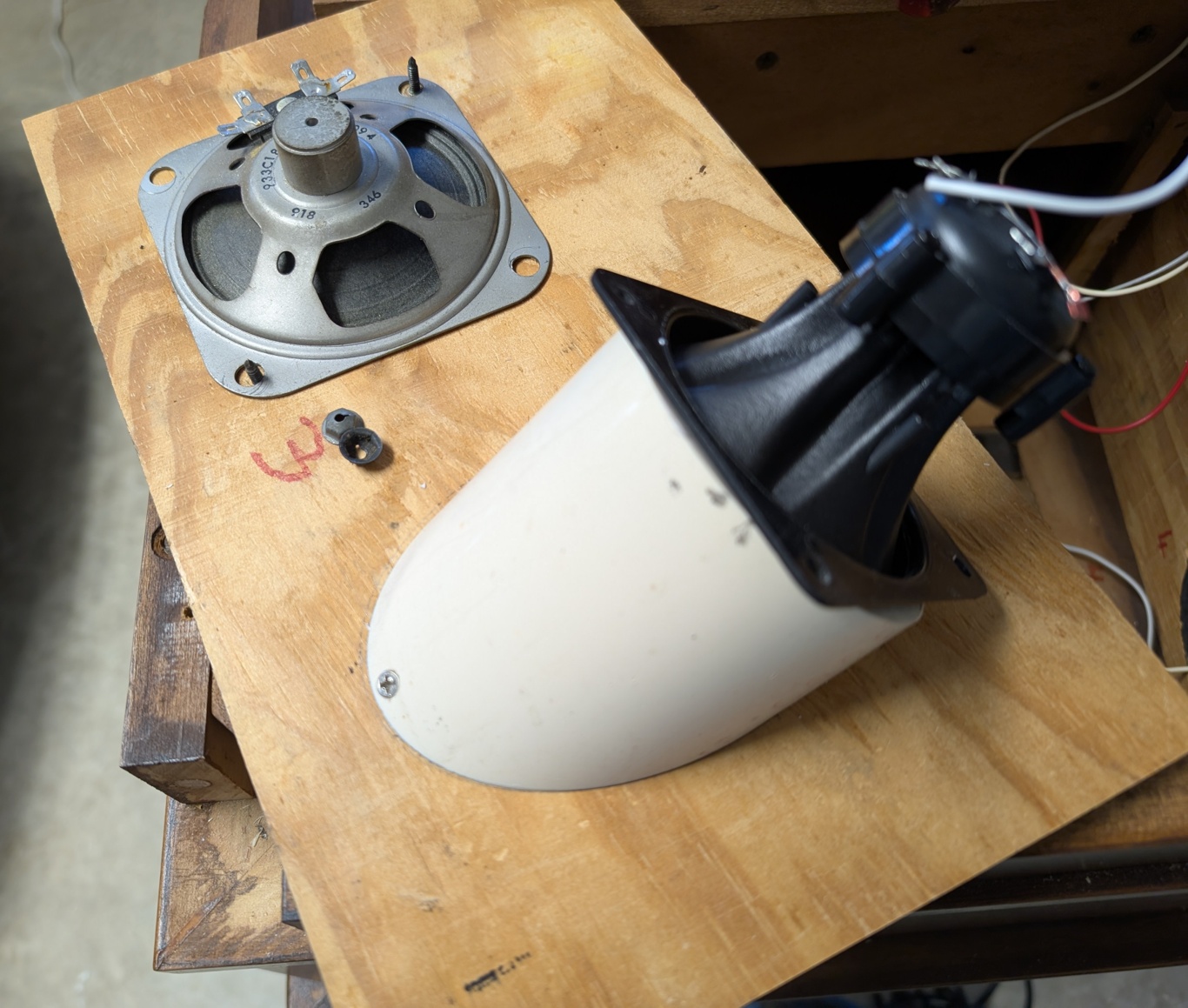

Greg, I did see that thread, thankfully my PCB was in great condition compared to that one! Regarding the sound, I'm adding two piezo tweeters to mine, angled upward at 45 degrees, on the front, since the speakers are below the knees! Preliminary test was promising, added a nice brightness which I will tweak later with the crossover. That's a 3" PVC pipe, the tweeter flange fits perfectly into the end!

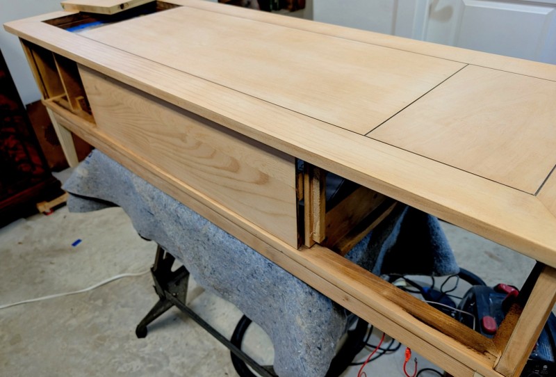

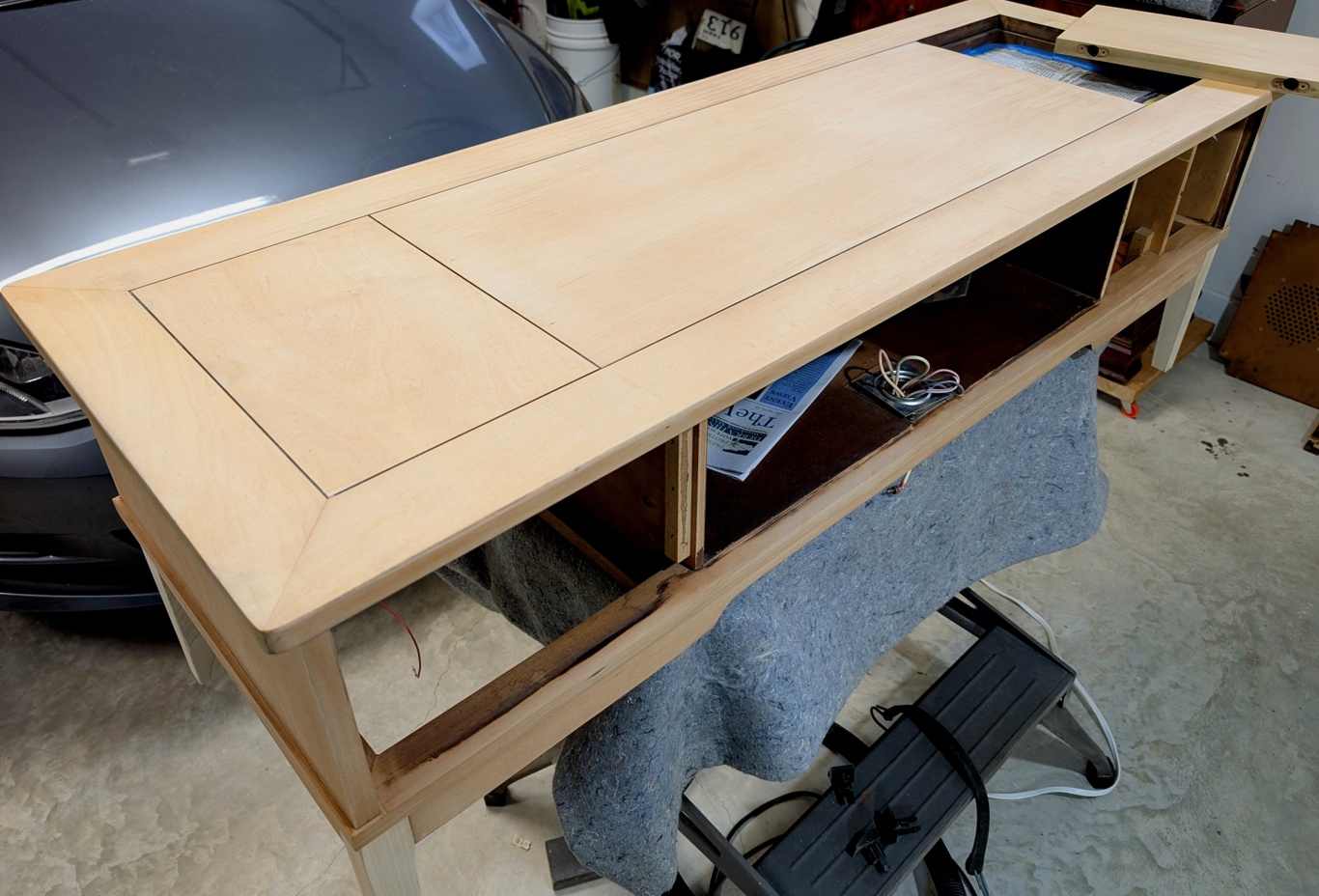

After many days of sanding, I'm pretty much ready for staining with walnut stain. Not sure what kind of wood this actually is...
The changer's rotating enclosure is a walnut finish inside, not maple like its front and the rest of the cabinet, so I'm leaving that as-is with just some cleaning (it has been removed in the photos).
Those panels in the top are veneered inserts, in several areas they weren't flush with the adjacent wood, and sanding went through the veneer in a few small places on the edges. Should be able to blend those in when I stain. I think the factory had to do some heavy sanding when the cabinet was made, so the veneer was already thinner in those places. I always vacillate between sanding vs stripping, but stripping is so incredibly messy --I guess it's less likely to damage veneer, but you still have to sand!

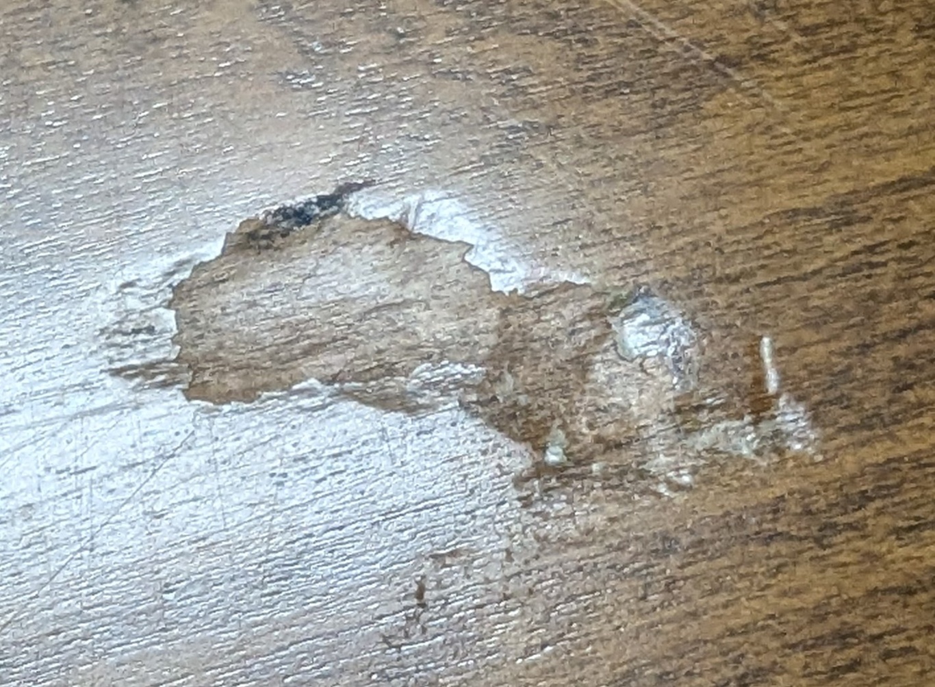

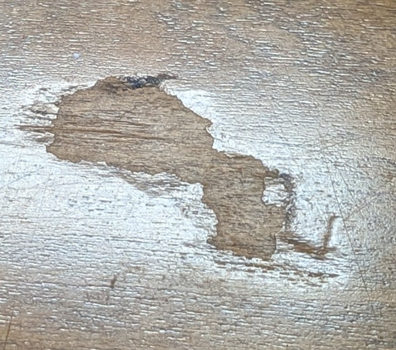

There were a couple of places on the top that were dented, probably by other furniture being placed on it during a move. I thought it would be of interest to show how I addressed that. I read in several places online that you could remove dents by placing a wet paper towel over the dent and applying heat with an iron to force steam into the wood. That expands the crushed wood fibers and raises the dent, and amazingly, it worked pretty well. Before and after photos of one of the dents (prior to sanding), its about 1.5" long. After sanding, that dent was still present, though not as deep, so I steamed it again and after drying and another pass with the sander, it was completely gone! I'm going to use 100% Tung oil for the final finish. My wife and I refinished an old upright piano (we used stripper on it) and after staining, finished it with Tung oil. That was over 30 years ago, and it still looks great!

That cabinet is not a typical GE cabinet. Most of the ones I've seen were made from "mystery wood", a combination of Masonite and sawdust. Your cabinet appears to be made of ash. It's kinda hard to tell with it sanded, but that would be my guess. I don't know what GE used for a finish, but, again a guess, I'd bet it was something sprayed on in one pass. With the care you are using on refinishing, it should look fantastic. Properly applied tung oil makes a very attractive finish. "Putting some of yourself" into the project makes it very special when it's done. Great job!......

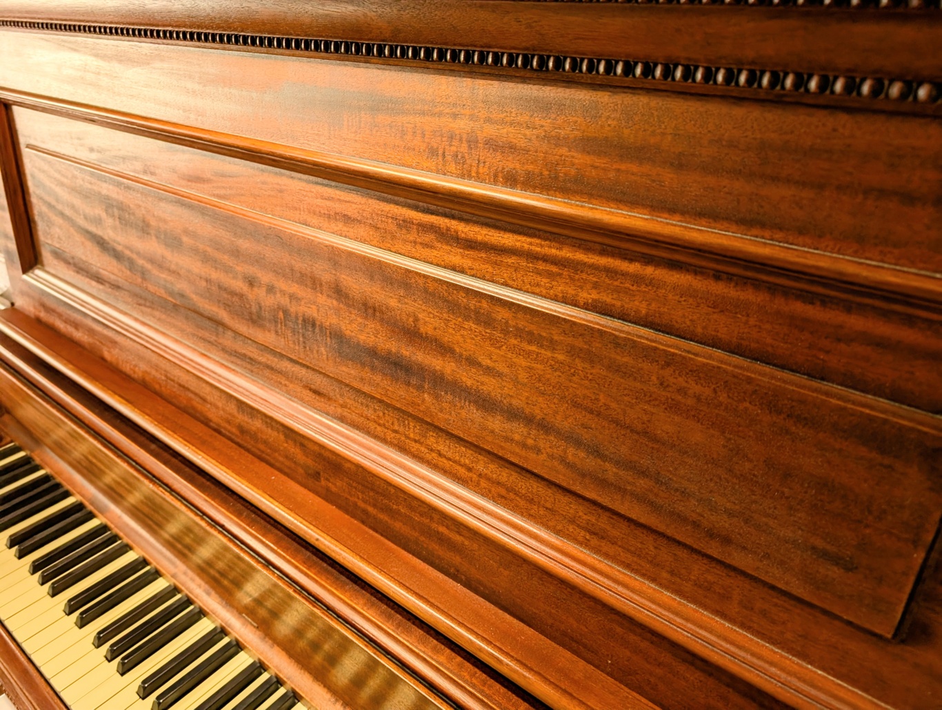

Well, I just realized that I can't put tung oil over an oil stain.
I think that old piano is mahogany and we just stripped it, then put on tung oil. The light wood on this cabinet won't turn out dark enough without staining first, so I'll stain and then finish with laquer or poly, I guess.

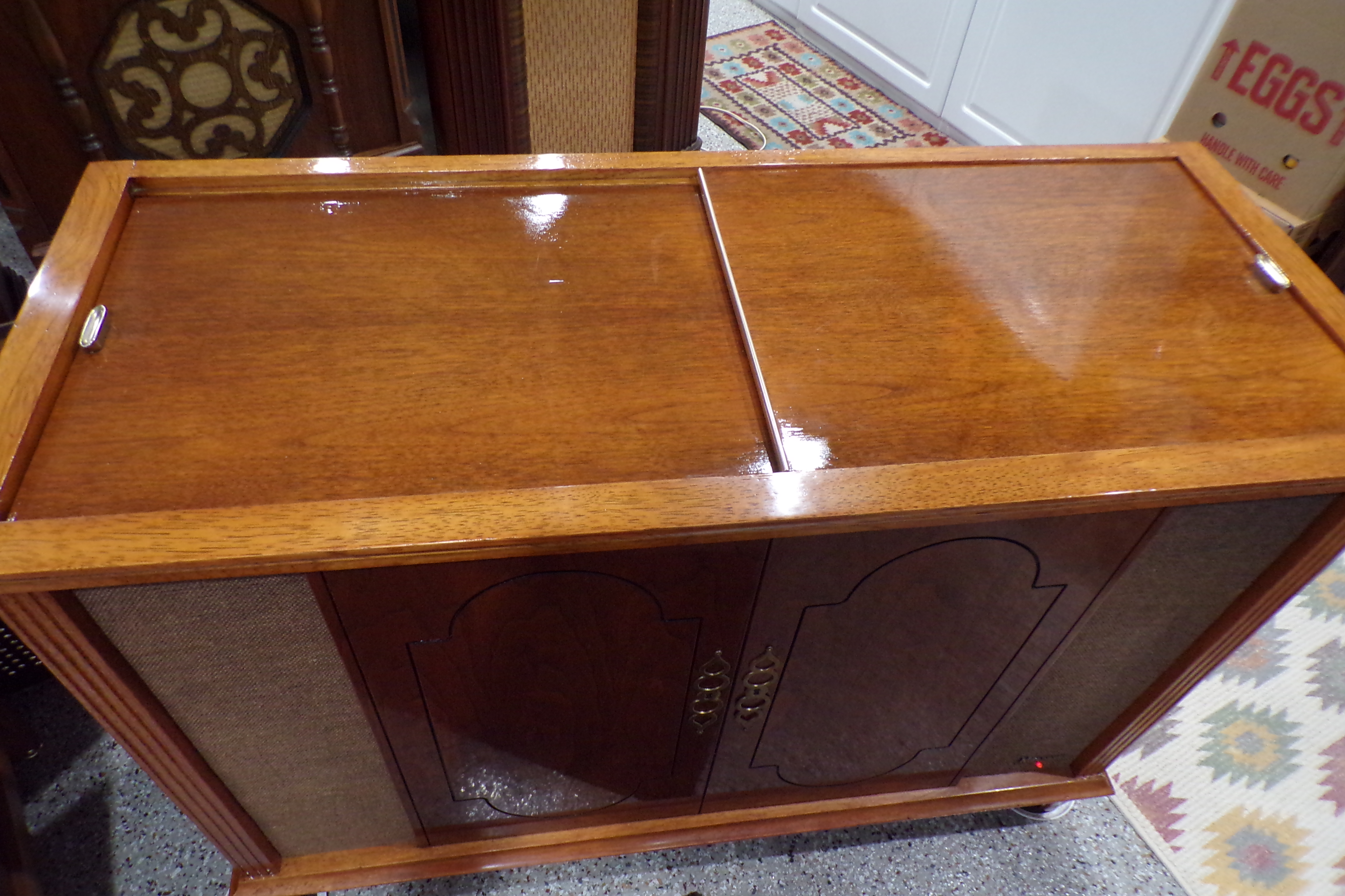

Magnavox 1ST616 with poly finish...

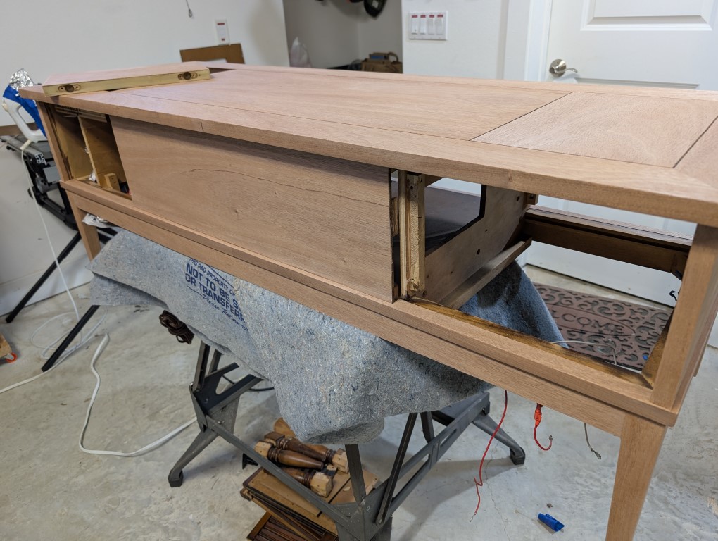

Haven't posted on this project in a while, because the cabinet didn't like being sanded! That exposed some very thin veneer on the top, and some pretty ugly grain elsewhere. I just wasn't happy with the result, even though it looks okay in the photos
So, I'm in the process of veneering the whole thing with mahogany, it's a fun learning experience! I'll post some pictures after I'm a little further along.

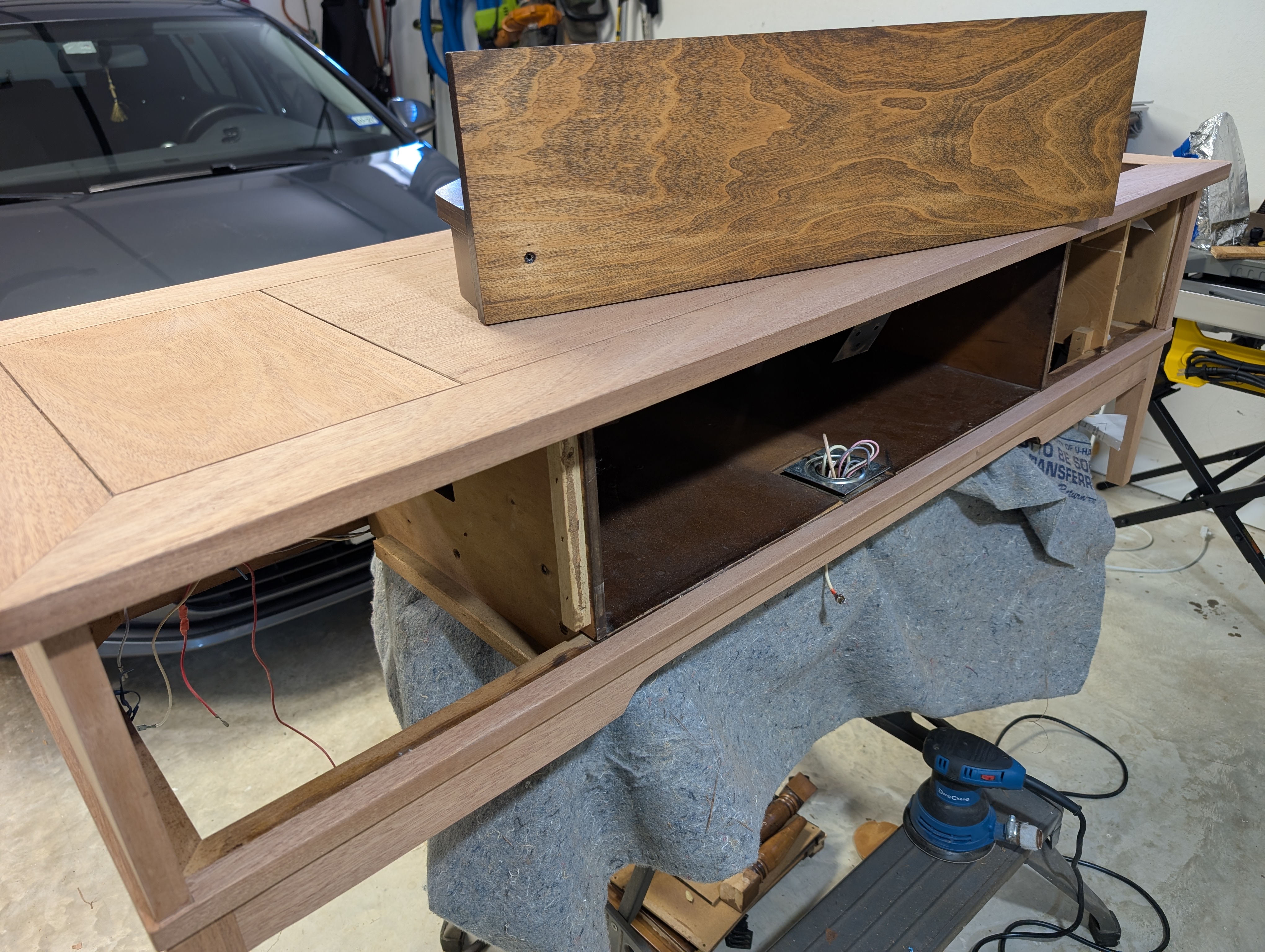

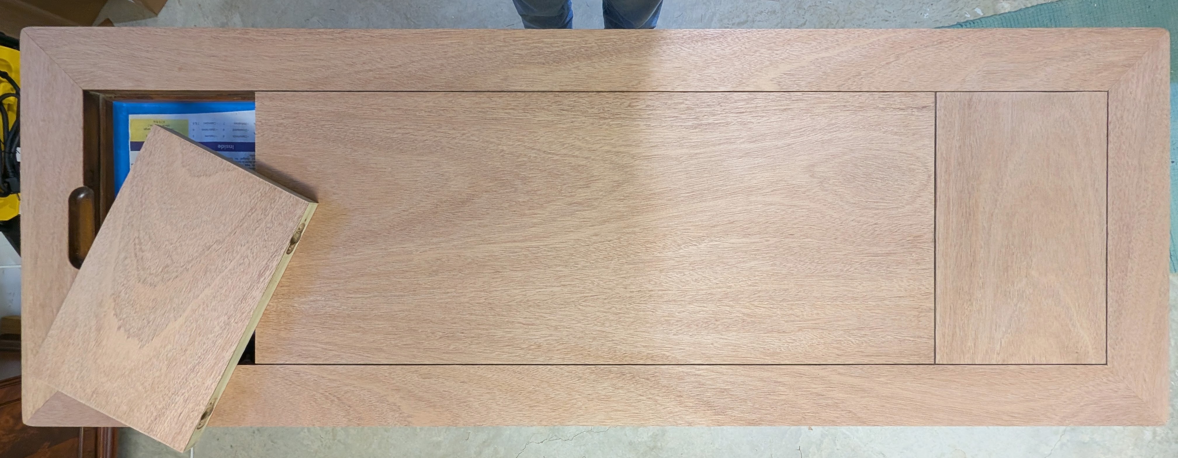

Veneer is complete! All the ugly stuff is covered with nice mahogany, took several weeks of off and on work. I should have laid out all the necessary pieces on my 2' x 8' veneer sheet first, but that's a consequence of my learning curve. So I didn't have quite enough to cover the front of the rotating changer compartment. But it just so happened that it's original veneer has a really interesting grain, so I'm going to keep that, it has a stained finish in the photo, which I'll hopefully work on to match the color of the rest of the cabinet after it's finished.
If I had it to do over again, I would be more selective of the positioning of grain pattern of the center top piece. Of course, that means better planning of the veneer layout prior to cutting--that learning curve again!

Nice job! Is the picture frame hardwood edge on the top the original or did you veneer that too? If it is original you did an excellent job of matching the grain to your new veneer.

The top is all new mahogany veneer, I really liked the original frame-like design, so I veneered over it and cut the same gaps as the original. The chemical stain I plan to use is potassium dichromate, influenced by this video:

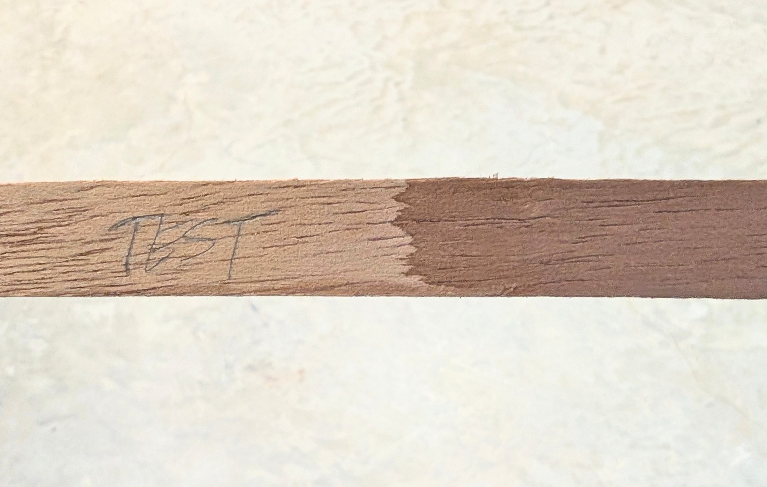

Here's a sample of 3/4" strip of the veneer with single PD application of concentration of 1/2 tsp per 16oz water, after drying. May be a little too dark. Not as pretty as in the video, but then it's not an interesting grain either.
