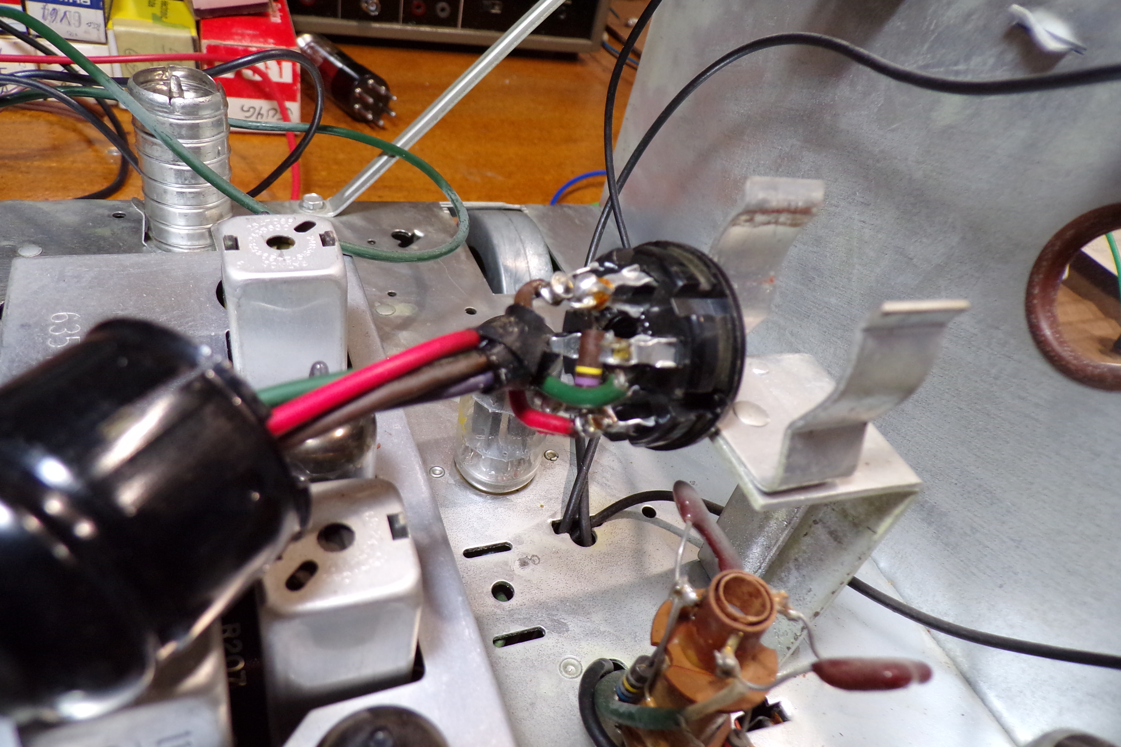

There is a 480K ohm resistor in the eye tube circuit, between pins 2 and 4 that measures more than 800K ohms. In old radios, the resistor that is in the eye tube socket usually goes pretty much open, to infinity. How far can that resistor drift high before it affects the operation of the eye tube? This eye tube is almost dead, but never had much, if any, deflection. The resistance measurements on the tuner circuits, per the drawing, are all over the place. There are a lot of "problem areas" in the tuner, more than I found in the amp.

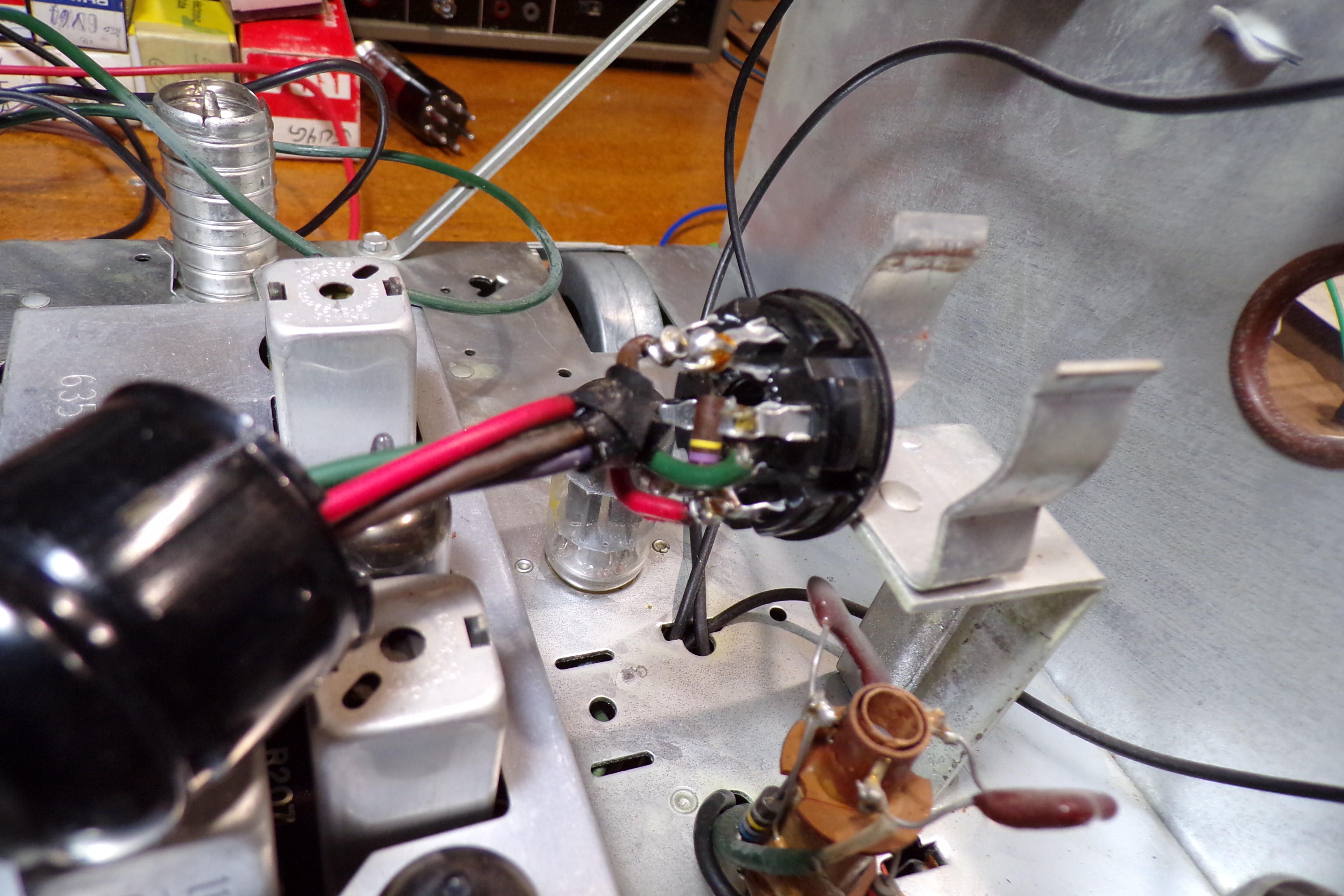

I've been digging into the eye tube circuit this afternoon. There is a 470K ohm resistor in the eye tube socket that has drifted to 652K ohms, an increase of 38.29%. There is a 1.5 Megohm resistor in the AGC line that has reduced in value to 562K ohms. The AGC line in the tuner is rather more complicated than I typically find, but there are two other high-value resistors in the AGC line that have drifted in value as well, one higher, one lower. Out of the 45 resistors in the tuner, not counting those in couplets, which all test good, only 9 are still within spec. Most are out over 15%. The eye tube socket's construction has renewed my faith in the quality construction I have always associated with Magnavox tube stereos. It is made to come apart easily and be put back together easily for service. You don't have to drill out a rivet, then create some method of holding the socket together again. Changing the dreaded high-value resistor in the eye tube socket will be a lot easier. I've done some cleaning and polishing and am now getting ready to make charts for the final resistance readings on the amp and tuner, and a chart for biasing. I have quite the bundle of documentation on this project. I have some pictures as well. Now I need to figure out how to save screen shots so I can share those.

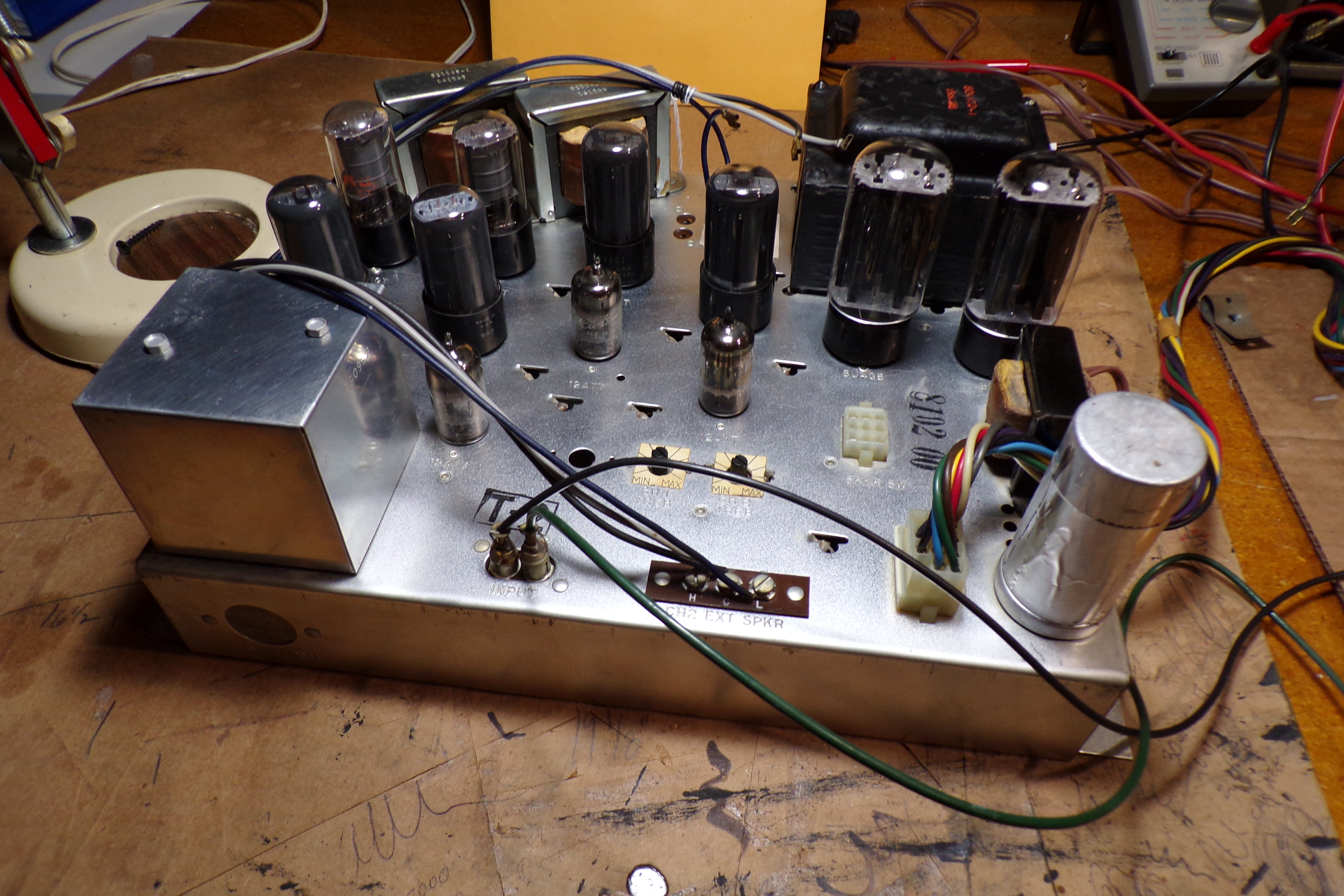

At least 80%, maybe more of the resistors in the amp and tuner are out of tolerance. The 1.5 Megohm resistor in the eye tube circuit is on the "printed wiring" board on top of the tuner chassis. I'll replace the resistors, then check voltage, after I replace the 6E5 eye tube. I'll wager the CG has the same issue with the eye tube. It moves a little, but not near like it should.

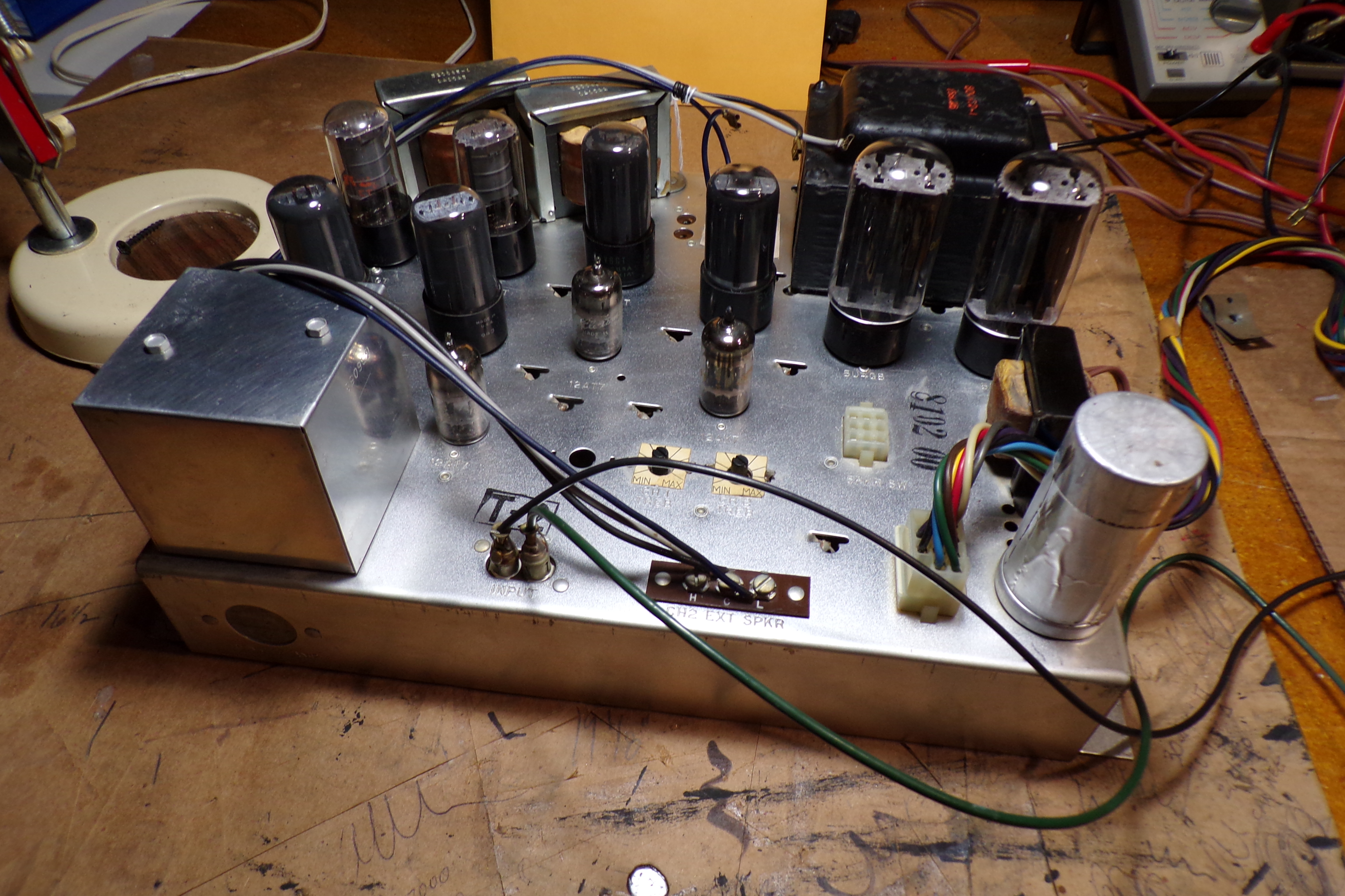

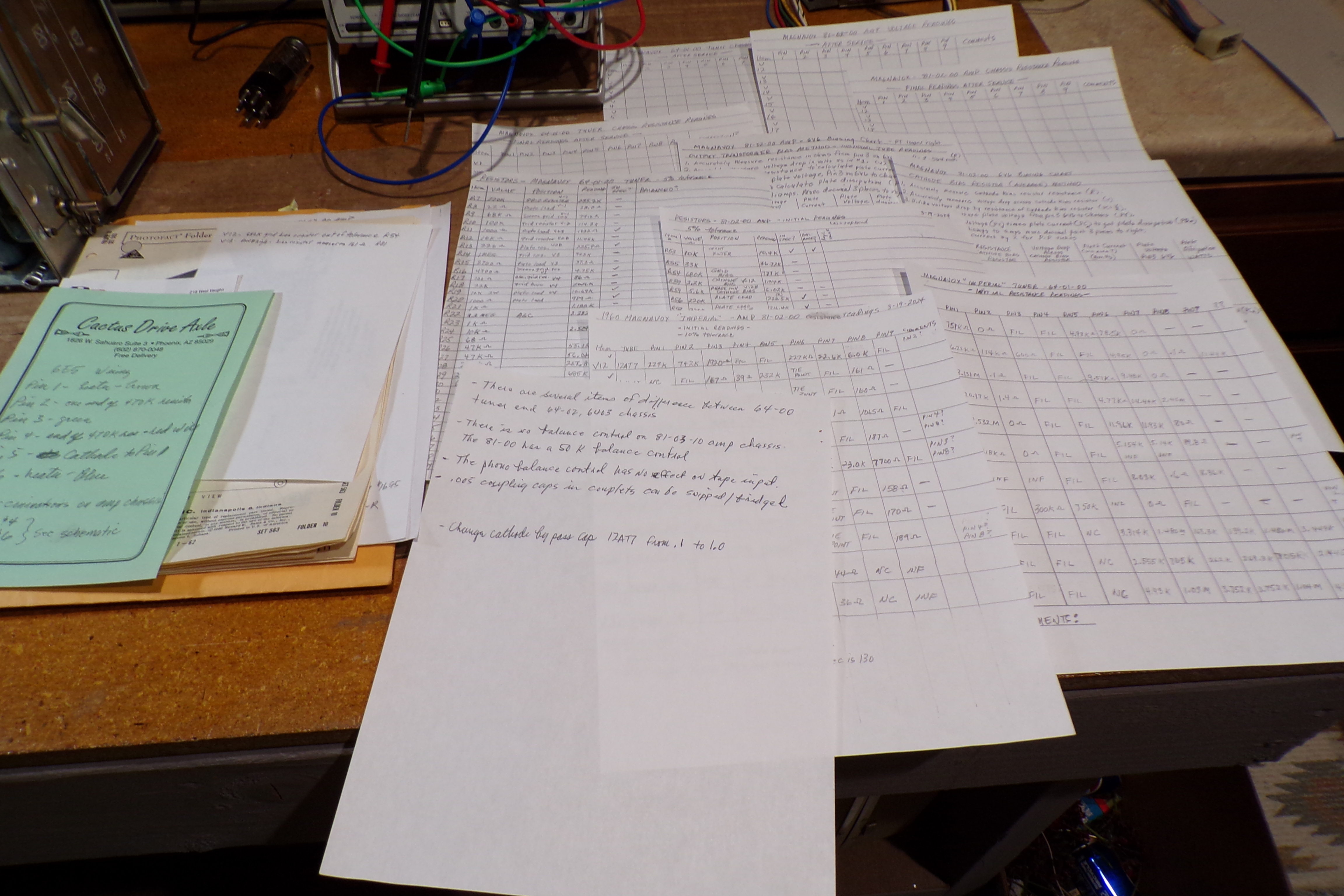

This is part of the documentation I'm recording for this project. Hopefully this will bail me out if I still have an issue after I go to all the work I've done....

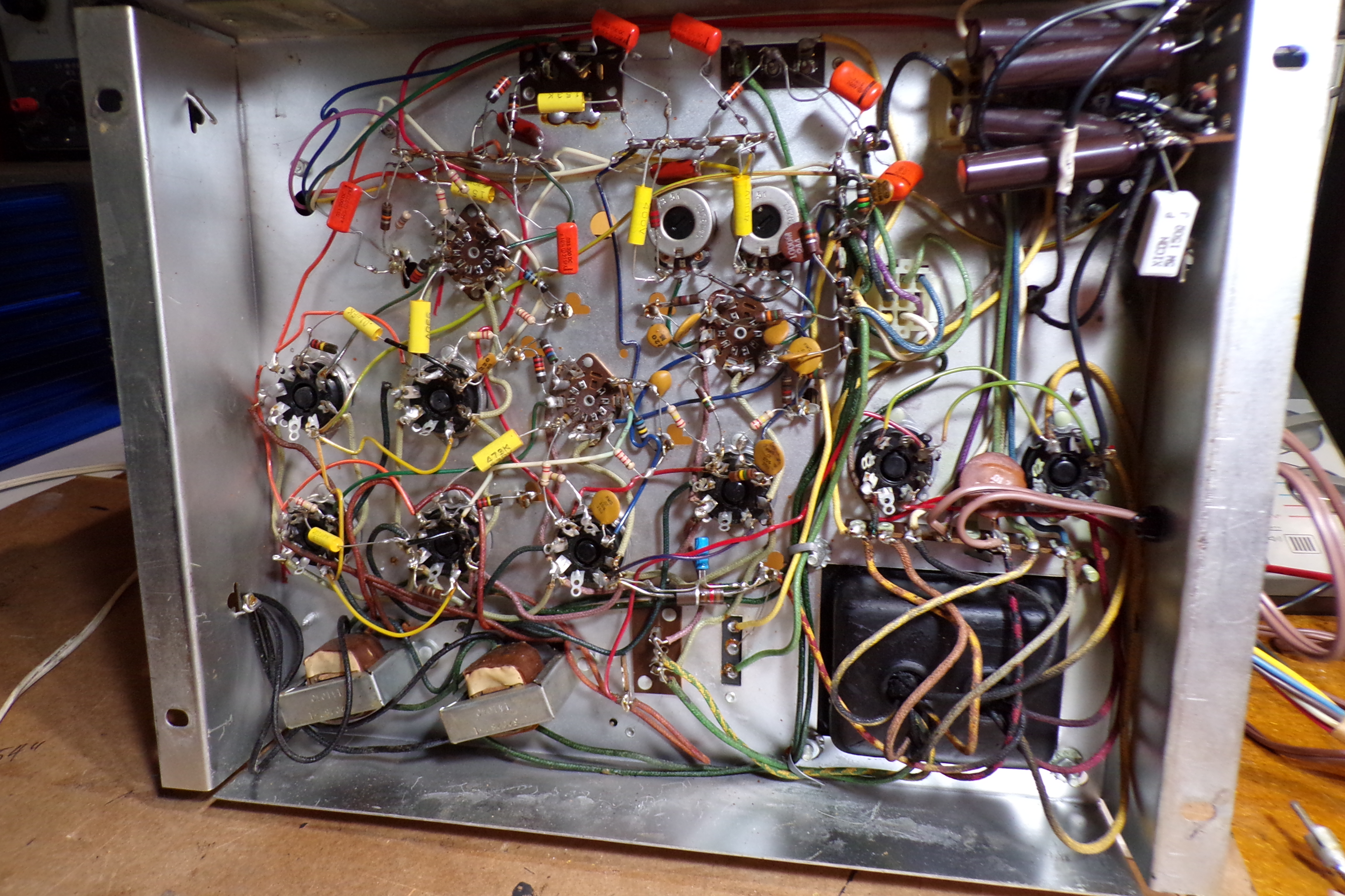

I have shotgunned this project, so that is why I make all these charts. If you look at the picture of the bottom of the amp chassis, you'll see the two orange drop caps, located at the upper right hand corner, that are the cathode bypass caps for the 12AT7 amplifier on the left side above the output tubes. These are the caps that may hold the secret to bass response in this amplifier....

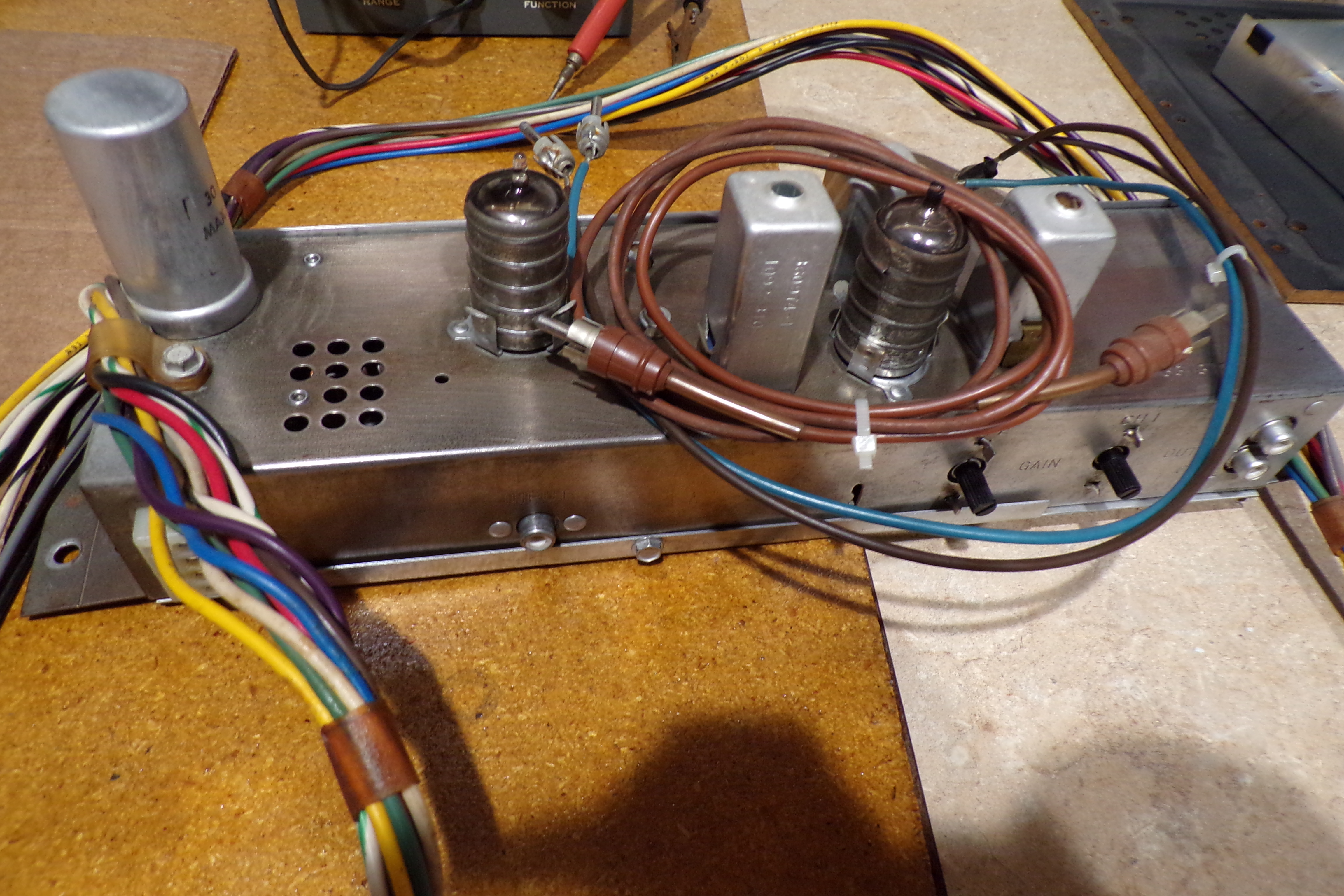

Just some general pictures of the project. The baked, long-suffering Multiplex adapter that is housed in the warmest part of the cabinet.

- Posts: 5495
Re: Magnavox Imperial model 1ST233
What are the brownish looking things in the upper right-hand corner of the amp? Are they caps?
