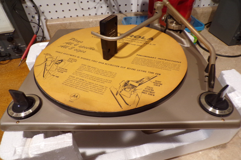

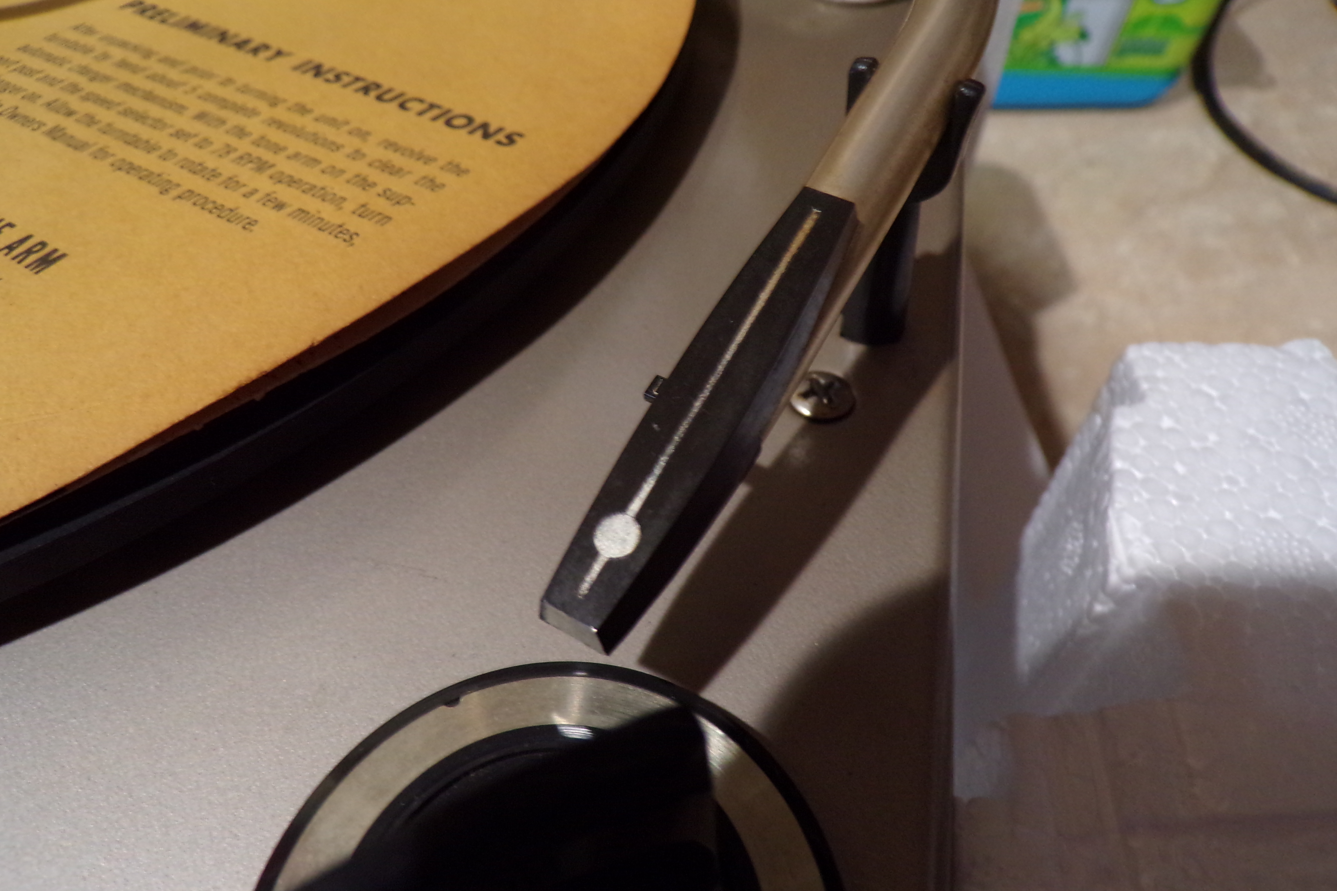

That's good you found an easy answer to the tonearm problem.electra225 wrote: ↑Wed Oct 05, 2022 3:22 am There is a little plastic bolt/screw under the tone arm that apparently adjusts how high the tone arm lifts. I gave it a quarter turn. It doesn't take much to make a lot of difference. It seems better the more records that get stacked on the spindle. I don't know how many the limit is, but I stacked six and didn't have any trouble. I have the service instructions for VM changers that I consulted to see what I needed to do. Taking the mechanism apart is out of my wheelhouse at this point. Maybe sometime down the road. I'm learning in baby steps how to work on changers. There was a time in the not-too-distant past I wouldn't have attempted even this much. I appreciate everybody giving me the benefit of their knowledge on changers.![]()
I gave the mechanism a "shower with your socks on" kind of clean and re-lube.
The service lit says 1/2 inch high stack of albums is
load limit for these V-M models with the short record spindle.
I adjusted the contrast on the photo, and I see your
V-M is a B1267. If you post the numbers after "857",
we can tell you the date it was made.
It's in Sams 748-11 from 4/65.
I've got that file if you want it later.

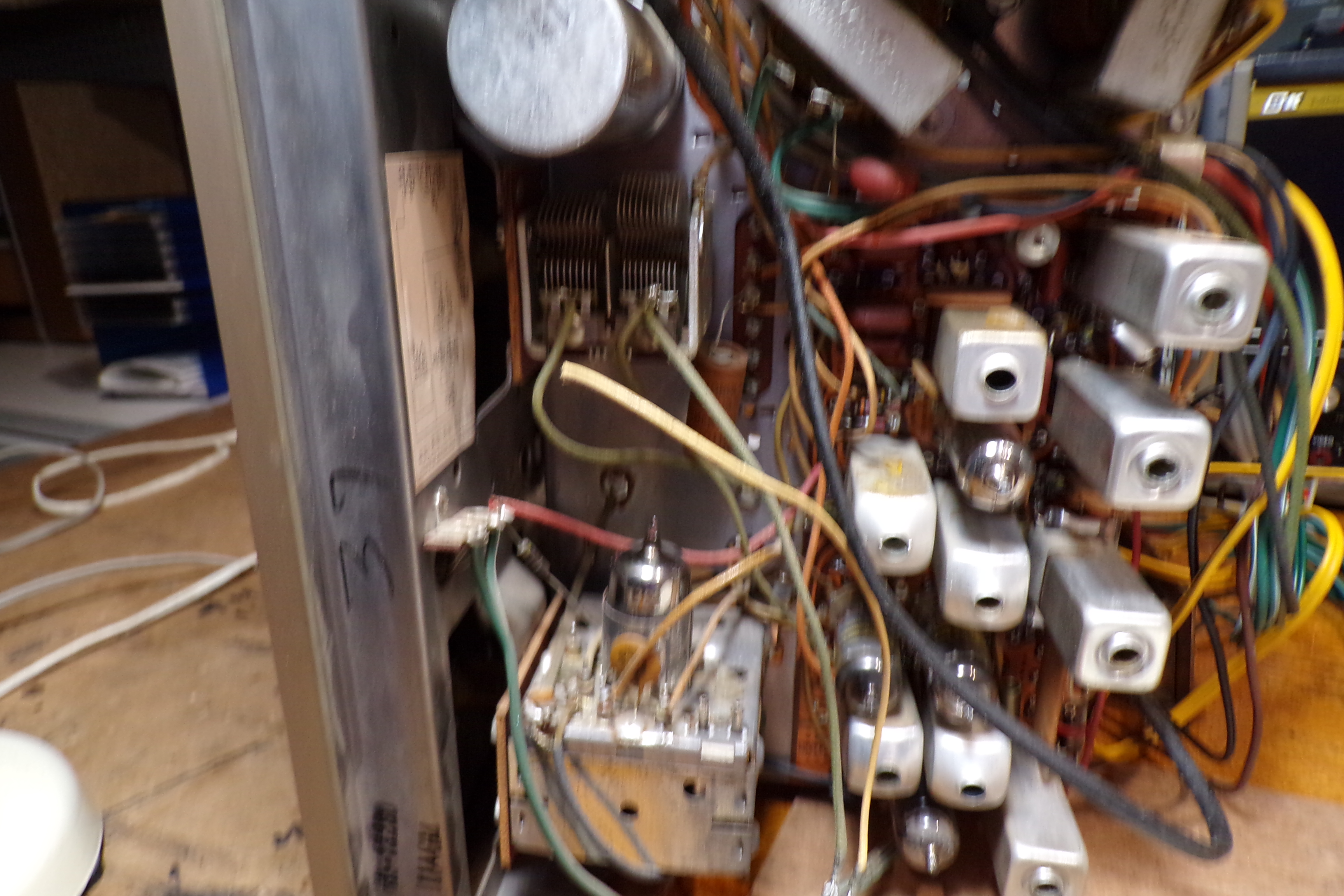

When it is cold, I have no AM at all, FM is all drifty and comes in and out, with very little volume. After it runs for five minutes or so, AM may work and may not, FM works okay, but no stereo. Another couple minutes, stereo starts working. I suspect a tube, but which one?

The FM side of the tuner will run sometimes all day without quitting. "The Ride" comes in strongly at 94.1, the stereo light comes on, fidelity seems good. AM is another story. It will play from 15 minutes to two hours, then it just fades away over a period of about two minutes. I don't have the chassis out yet, but I had subbed all the tubes from a Motorola table radio with no change. The tubes from the stereo work well in the table radio, so I think I can eliminate tubes as an issue. I was under the assumption that perhaps a tube filament was opening when it got really warm, but apparently that is not the case. The record player will work seemingly forever with no issue.
I believe the first avenue of investigation will be to determine whether the AM oscillator is quitting after a time. I also want to check B+ to see if it's going away for some reason. I think it's fair to say the issue is in the front end somewhere. The function switch is not above suspicion, either. I'll get the chassis out, sub in some test speakers, then connect two or three VTVM's and see what they tell me.

First, nothing I did helped it one iota. It has a two-part function switch. One part is mounted tight to the front with a shield around it. Makes it very hard to get a good cleaning job on the switch. I found a broken AVC wire off the antenna, which makes no difference connected or disconnected. It will play better on FM than AM. When it quits completely on AM, FM is really weak, but you can still hear it. I don't have the changer connected, but I need to so I can see if the audio section is affected. I thought at first it wasn't, but now I won't swear to that. When AM quits, if you move the function switch to FM then back to AM, usually that will get AM working again. After the set runs for a couple hours, nothing will make AM work. You have to shut the set off and let it cool. After cooling for about an hour, the process starts over again. It acts like something is getting warm. I'm supposed to have minus 11.5 volts on the oscillator. IT has been running about 12 to 14 volts negative, this measured by an analog VTVM. If I touch one end of the loopstick antenna, the volume will get higher, which leads me to wonder if it is just out of alignment. I'm going to have to find a more-complete drawing. This thing is full of Carbonneau-built speakers. The tone arm weight is set at 2.8 grams.

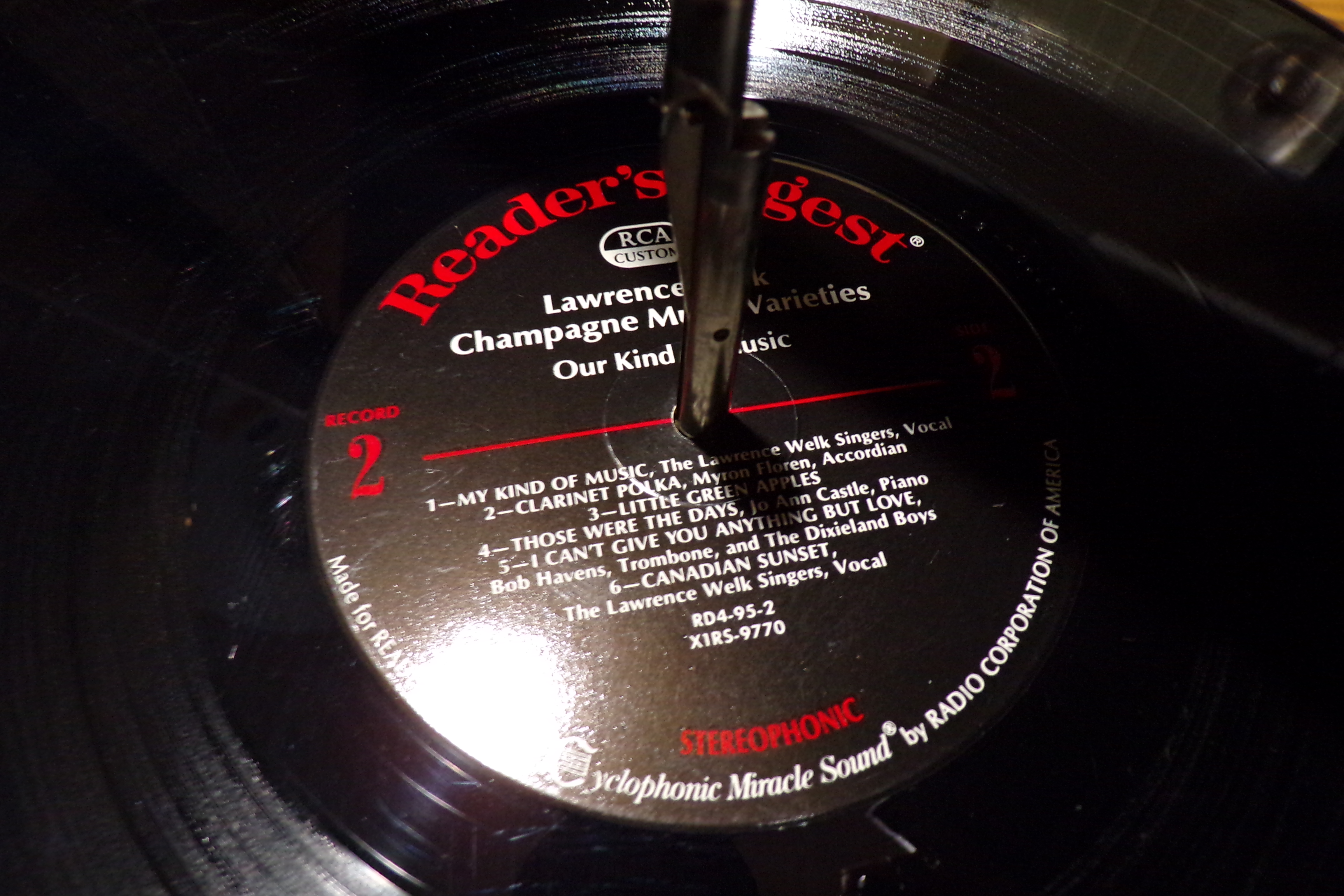

I took the VM model 1267 changer apart to clean and lube. The process went fine, no problems. I put it all back together, put on a stack of 45's. This short-spindle VM changer will drop stereo 45's for some reason. After the first record played, the changer cycled like it should. I noticed that the tone arm operated a bit too jerky for my taste, the swing back to the tone arm rest was not smooth. The next record did the same. The third record, when the tone arm came to the cycling grooves, the tone arm went in toward the spindle, moved back about a 1/4 inch, then came back about an inch and up at the same time. It bounced down and hit the record grooves. Not good.
I asked Mr. VM for his input and he said what I was thinking: I messed up.
I pulled it all back apart to check my work. All the parts were there, all in the right spot. I got to looking and found the ramp on the slide that pushes up on the tone arm shaft was dry as a popcorn fart. No grease at all. So I redid all the lube, made sure everything was free, put it all back together, put on a stack of 45's. Worked like a charm. I read that you should not over-grease. Well, that might be true, but you have to at least "somewhat" grease. Lesson learned.
I still haven't found service information for this set. I sure need some.

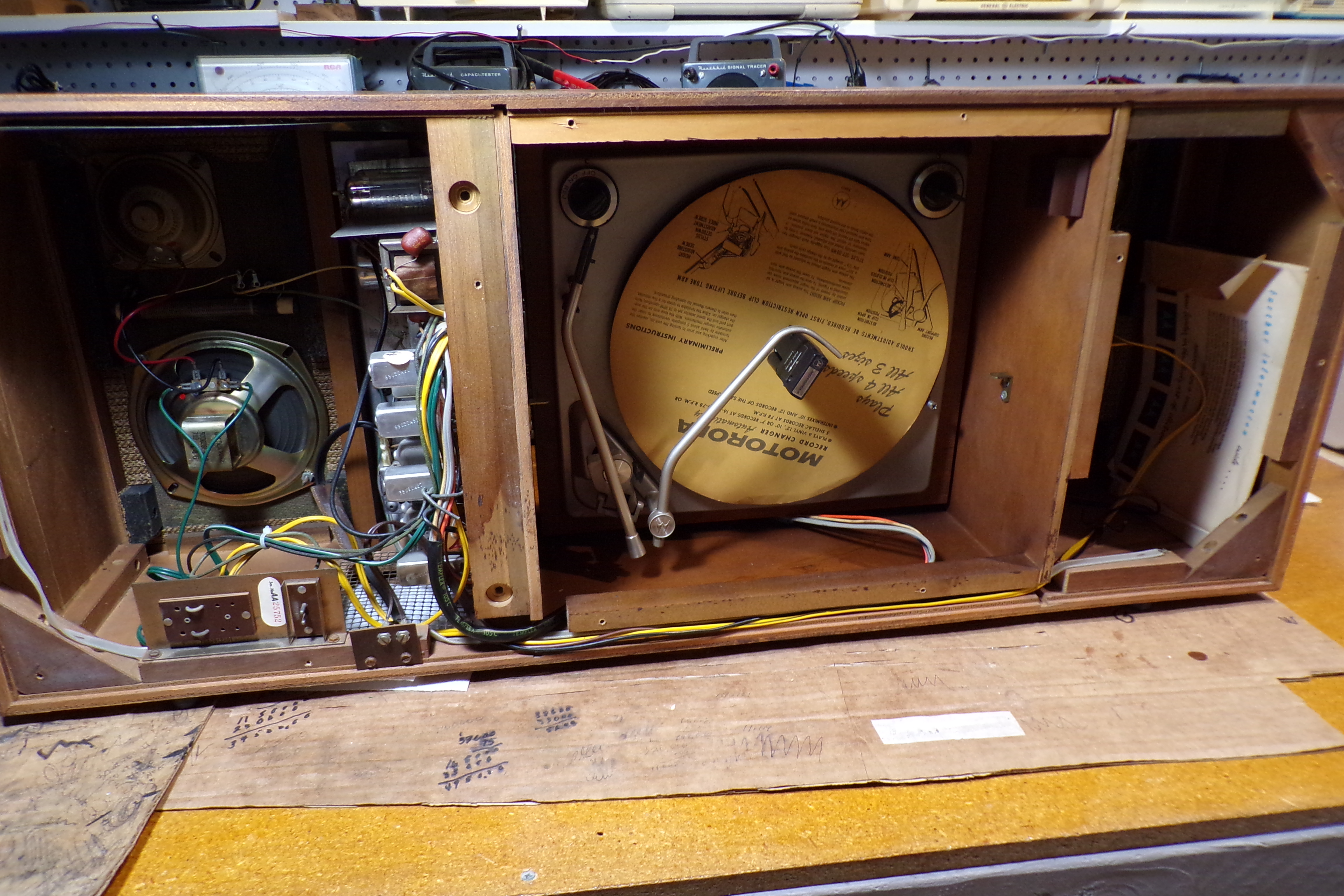

I decided to do with this chassis like I did with the Imperial. I decided to do a component by component check and restoration. The first thing I did was to run the resistance chart that Sams always provides. This chassis is a challenge to work with. The tubes are crammed in so tight among the IF cans that you can't use test sockets. The chassis is PCB, so it is hard to take resistance measurements and get a good connection. The resistances around the 17C9 socket are wildly off. If I hold the function switch just so, the readings are pretty close. Otherwise, some show infinity. Pins 1, 2, and 3 particularly. This brings me back to a wonky function switch. The 17C9 does test bad, one half essentially dead, but that is not the entire problem. Replacing that tube may help, but it won't fix it. Essentially, there is no B+ to the 17C9, which is an RF amp and FM oscillator. I've sprayed enough sauce on this function switch, I don't see how it could still be dirty. I'm beginning to wonder if it is not burnt, or defective in some way. I'll continue with resistance tests. That may give me more evidence on the function switch.

The function switch is oriented so that with the function switch on FM or FM AFC, B+ is killed to the AM-only tubes, mainly the 12BE6. On AM, B+ is killed to the FM only tubes, the 17C9, 12AU6 and the 12BA6. The 12BA6 IF amp tube is shared by both AM and FM. So no B+ to the 12BA6 will kill both bands. When the function switch is in Phono, B+ is killed to the entire front end. This might be nice for the Energy Star rating, but I have been dancing around the trouble by concentrating on AM, since it is the band that is dying. I believe the reason FM is not dying is because the function switch is shorting on AM and puts B+ on FM when it shouldn't. There is a shield over the front (FM and Phono) half of the function switch that is soldered on. That shield will have to be removed so I can get to the function switch better. Most of the resistance readings not concerned with the B+ rail is pretty close. The B+ rail shows infinity on almost every tube in the front end. At least I know what the issue is. Now to figure out a way to remedy it.
