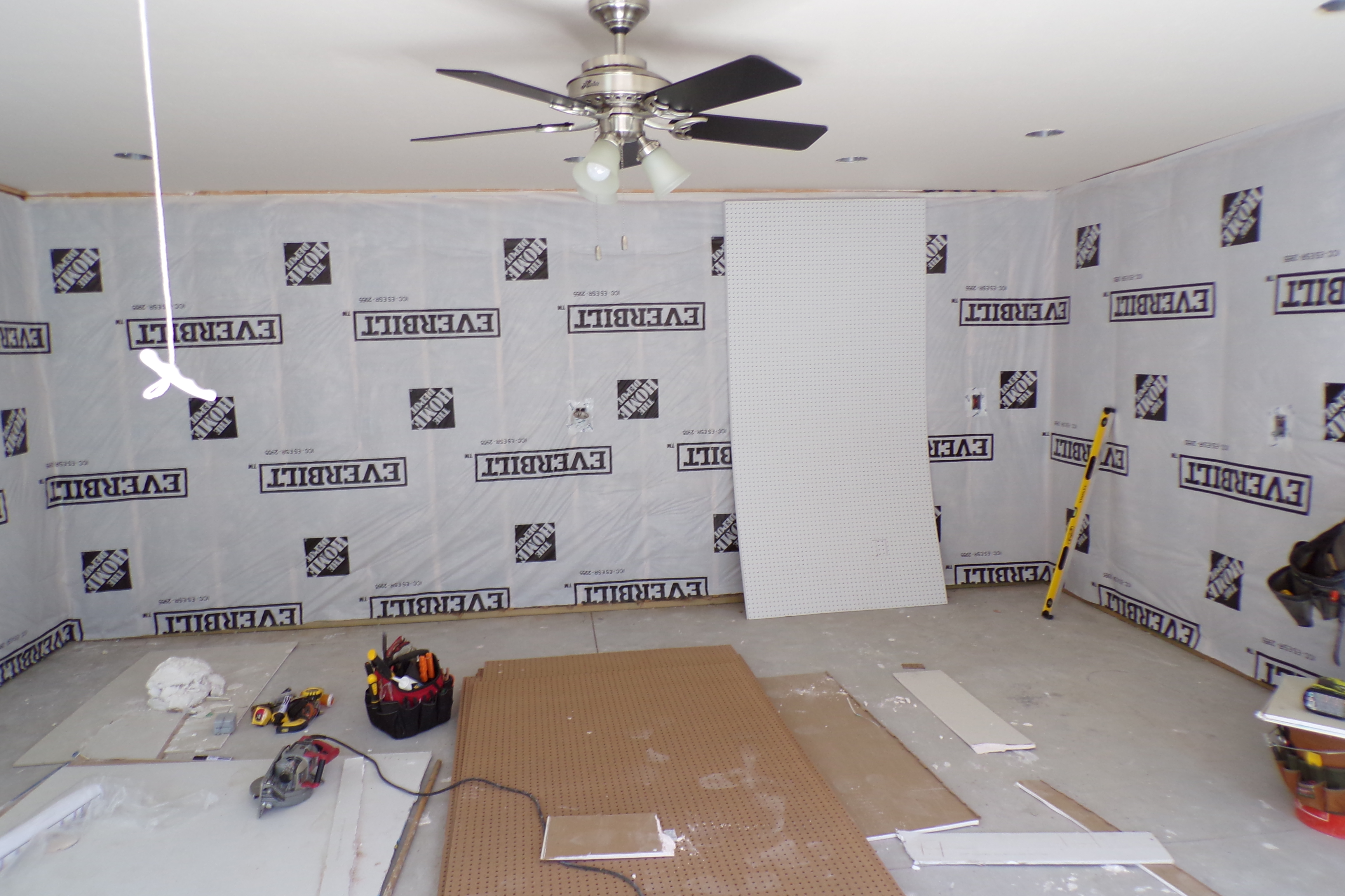

Around here during the housing boom, it has been the Wild West out here with contractors. They could care less about customer service. Our contractor is overworked and largely incompetent, but we are luckier than many out here. At least, so far, they haven't totally obsconded with the money and left us high and dry. We have beat on these guys almost every day to hold their feet to the fire to get this thing done. They told us how they don't use Home Depot or Lowes material because of its low quality. Notice the name on the Tyvek.

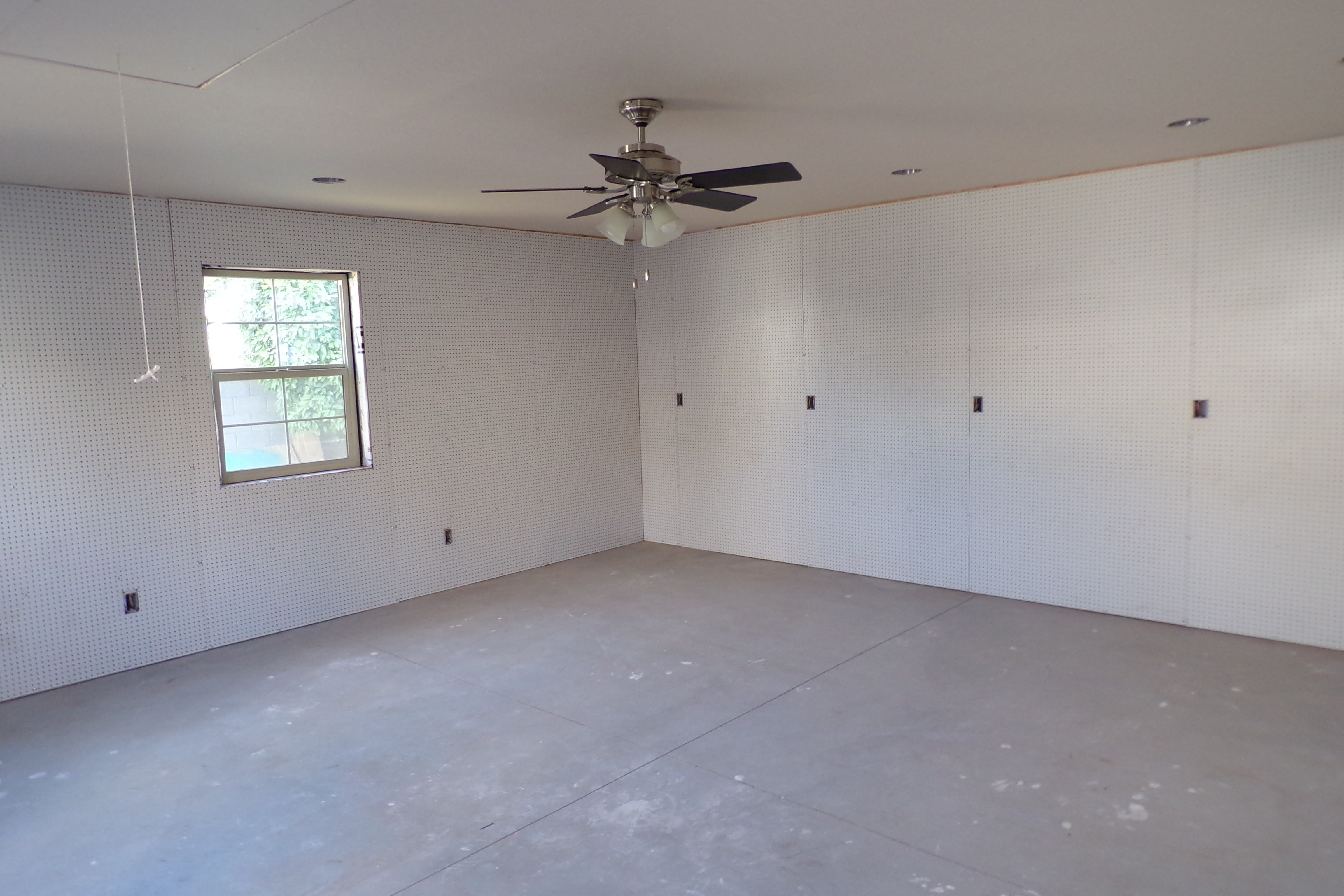

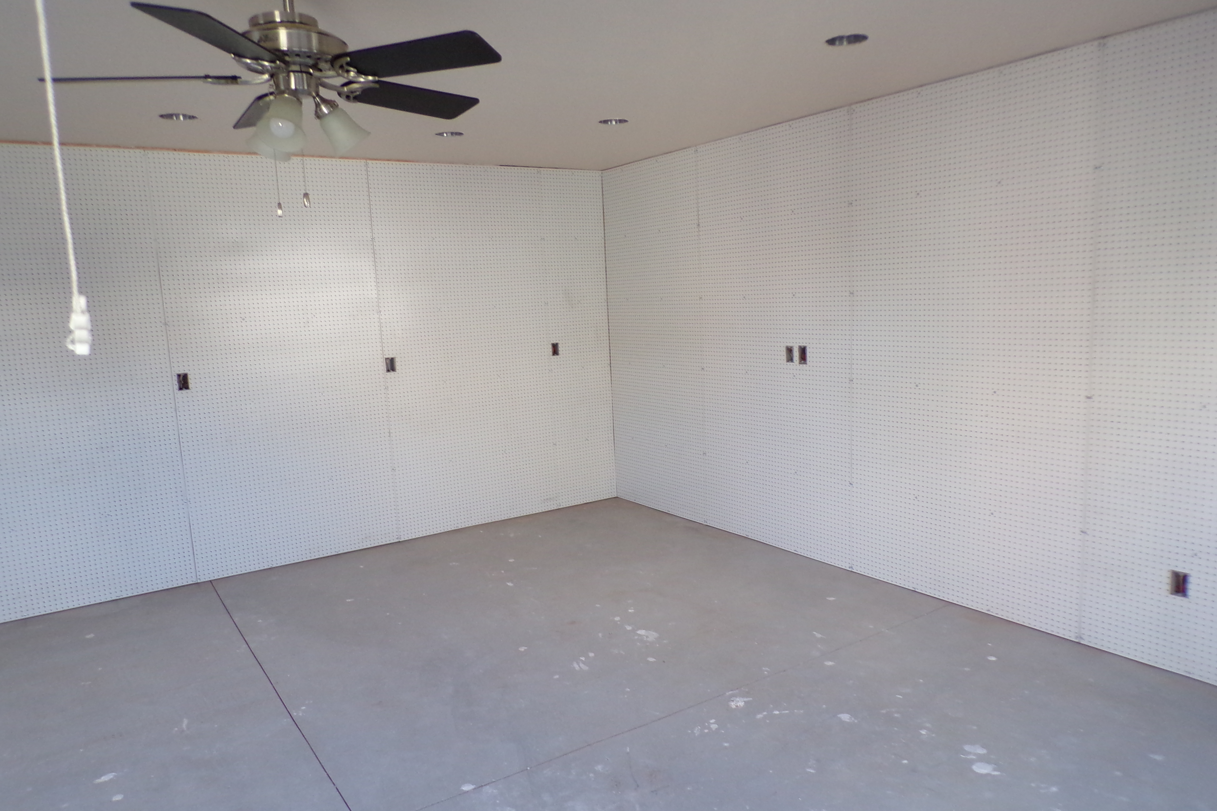

Pegboard on the walls. It still needs to be trimmed, but it's up. They are going to run a cove molding on the top, four inch baseboard on the bottom, then put trim on each seam, screws every 16" on every stud, and corner molding.
- Posts: 5466
And it's on upside down!
Do you have more photos?

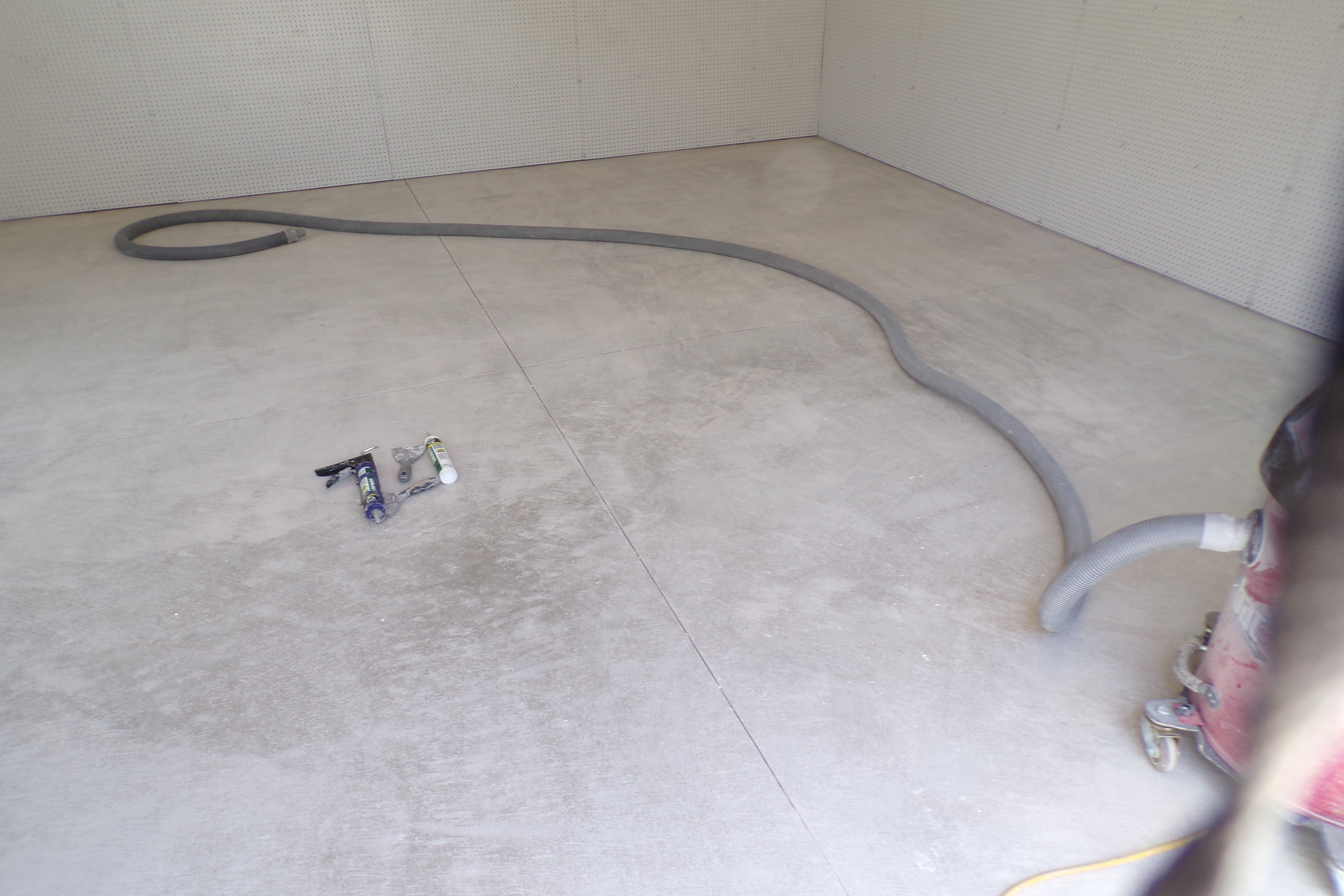

The flooring guys in the process of installing the epoxy floor treatment. First they sanded the concrete floor so the material would bond. The sanding equipment had a dust collection system that allowed for zero dust emissions, per the Arizona Department of Environmental Quality. I was impressed.
You can see the method they used to fill the places where the concrete guys cut in the floor to control the cracks. The stuff they used is flexible.

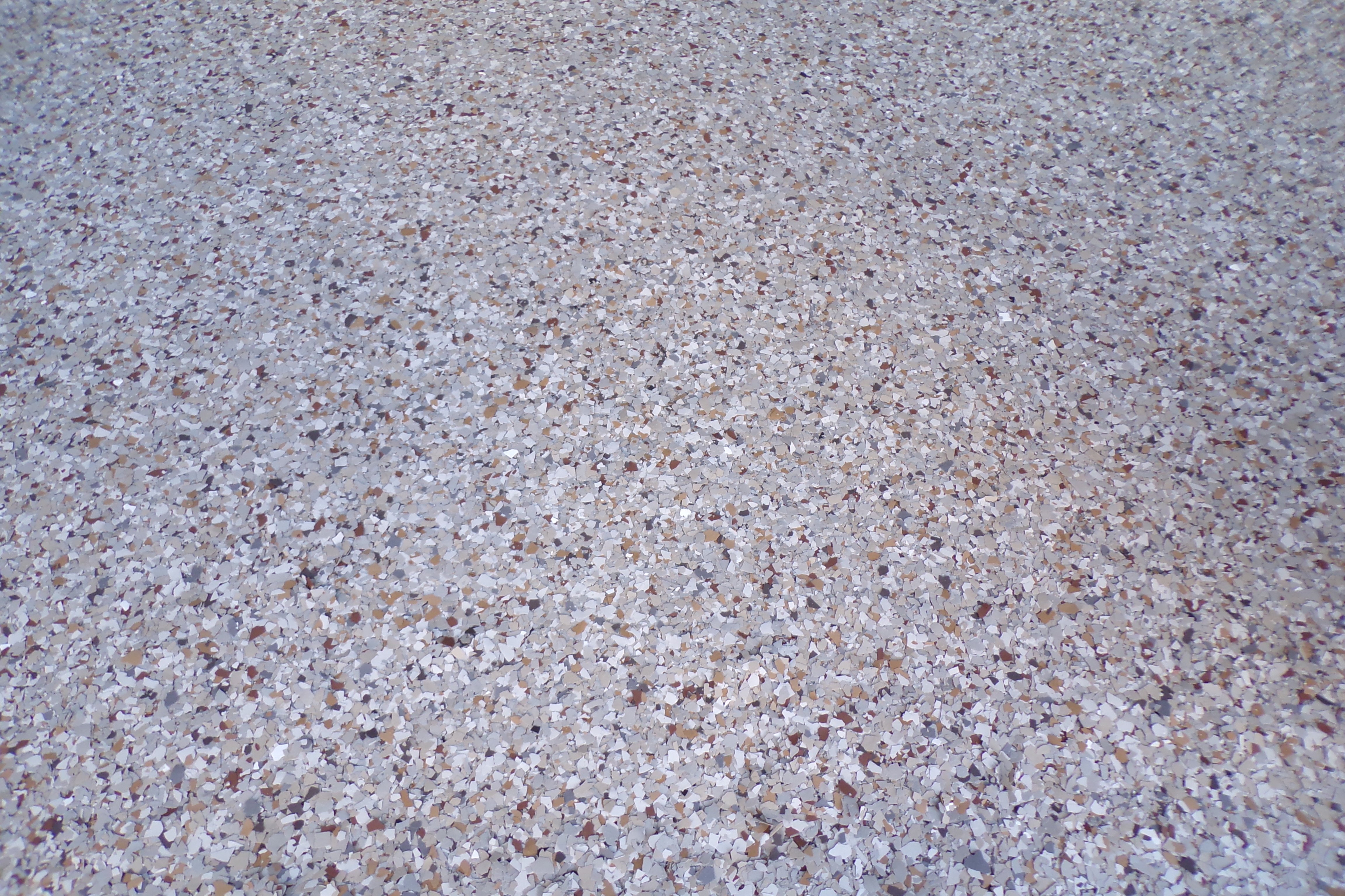

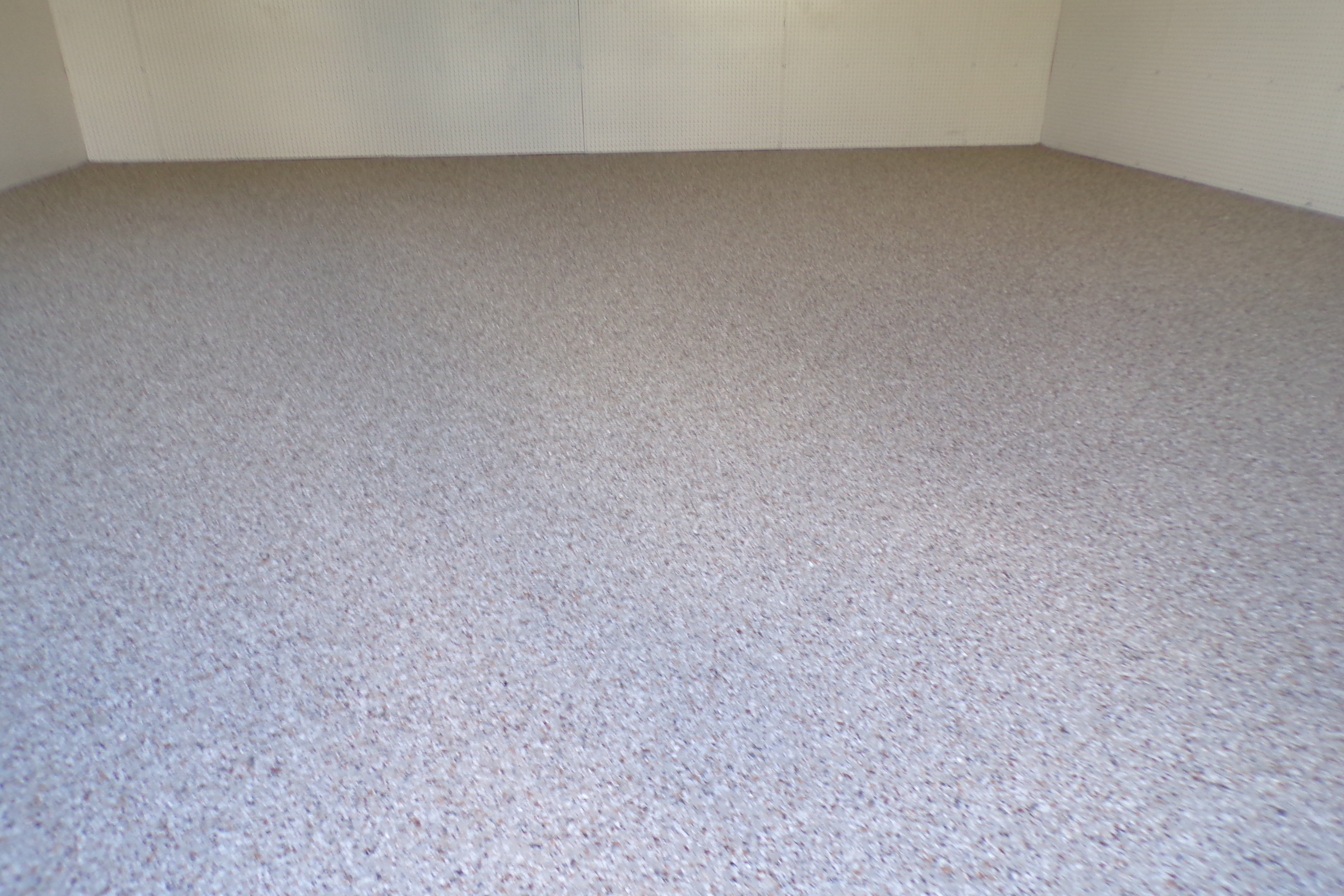

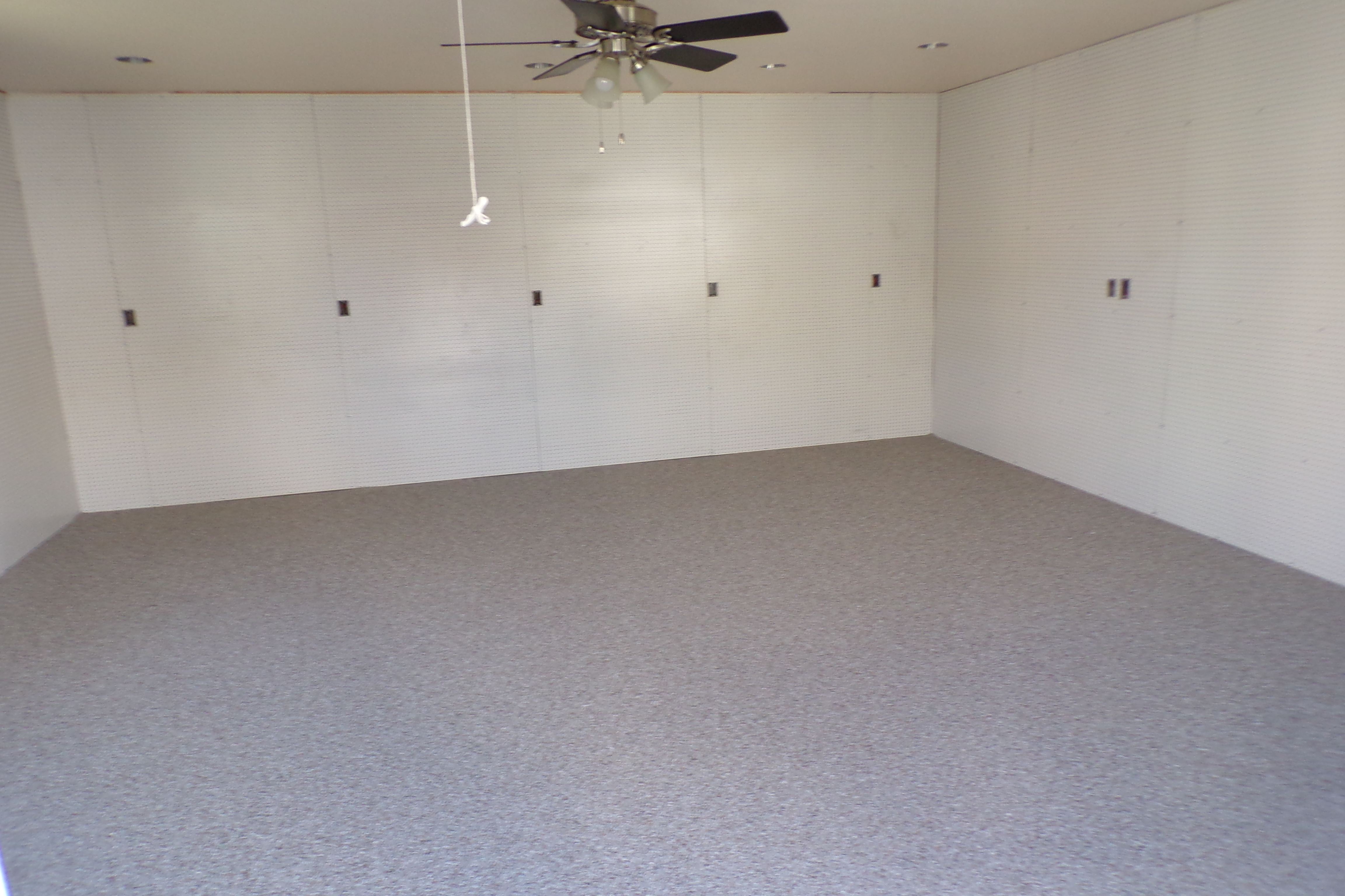

Now for the first layer of the floor. They put on a gray epoxy type material then tossed the little color beads all over, almost 100 pounds of them. Tomorrow, they put on the clear.
Bill, they tell me it doesn't matter if the Tyvek is on upside down or not. Nobody will ever see it, right?
I'm beyond thrilled that it is there!
My wife chose the color so it wouldn't clash with Magnavox mahogany or cherry. So if it does, don't blame me. My wife has never chosen a bad color in her life. She is the best at color selection I have ever seen.

Maybe they thought you could not read upside down so you would not notice it came from Home Depot.
I'm just glad to see that it is on, and the peg is up. Now the floor. What's next on the list for them to do?
