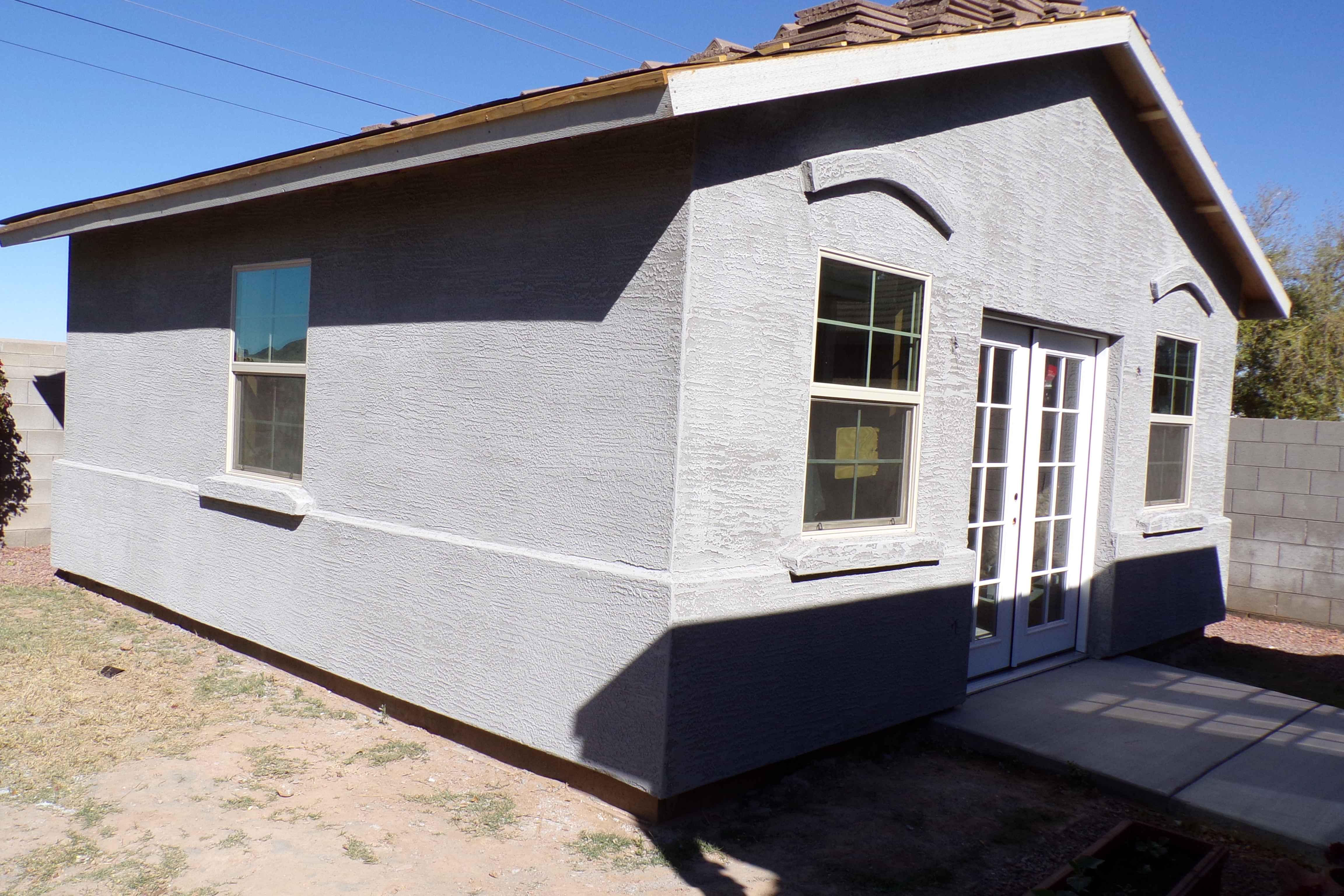

The stucco crew was here today and applied the stucco to the outside of the "consola". Yep, true story. There equipment and their mess is still here, but I'm not griping about the mess. The most heavenly mess I have ever seen!
The stucco doesn't stick to the sidewalks or anything like that. My understanding is that tomorrow they will come back and texture the stucco. Now it just looks like concrete on the side of a building. I love the look of stucco. Very southwestern and clean. They have to let the stucco breathe for a few days after it's textured. They will paint the facia and under the eaves, then do the roof, then paint the bottom, three colors, per the HOA. They have to dig the ditch for the electrical, run the TV and phone cables, then install the AC system and we will be real close. I need to put another coat of paint on the ceiling and hang the fan. We are for sure getting closer.....

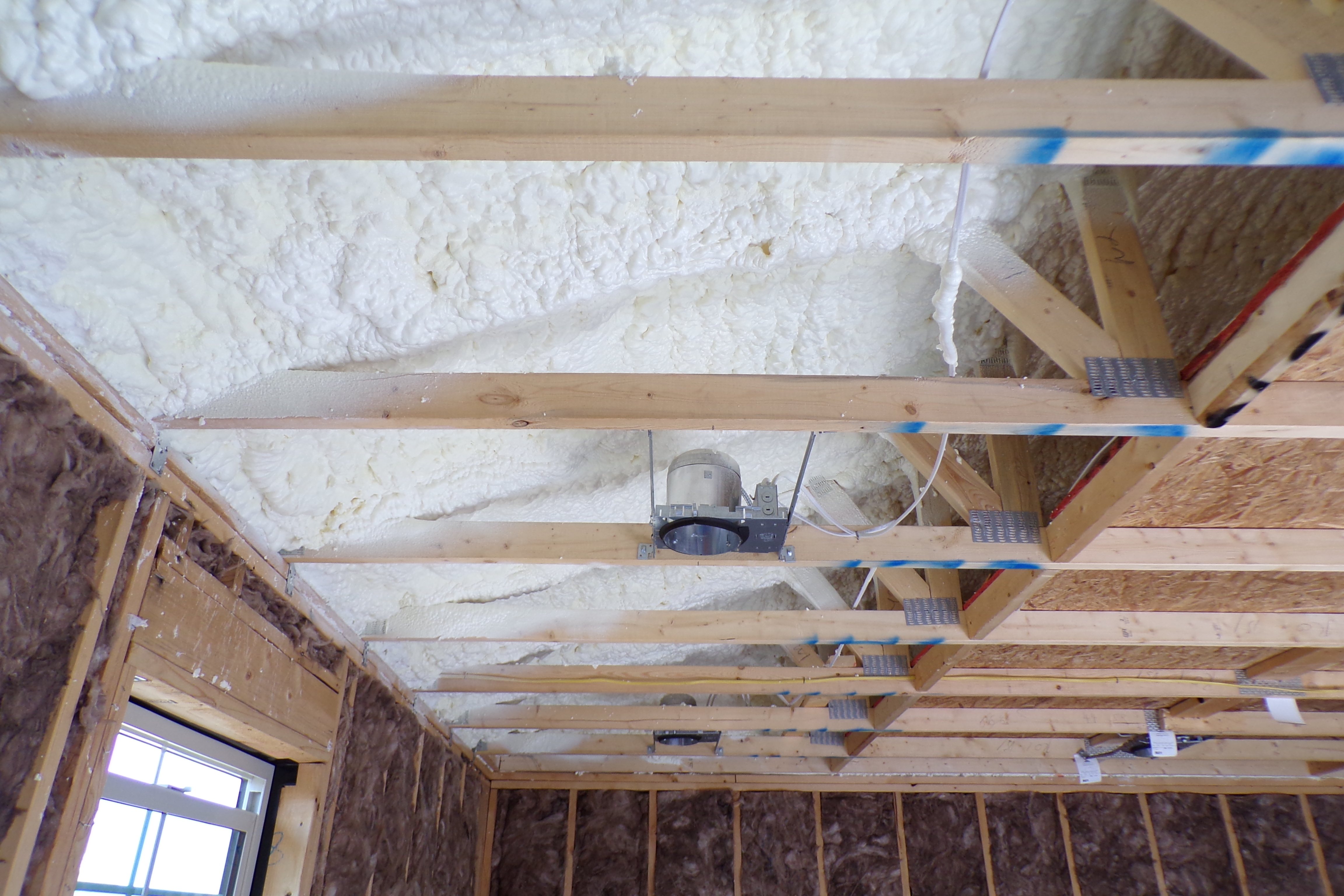

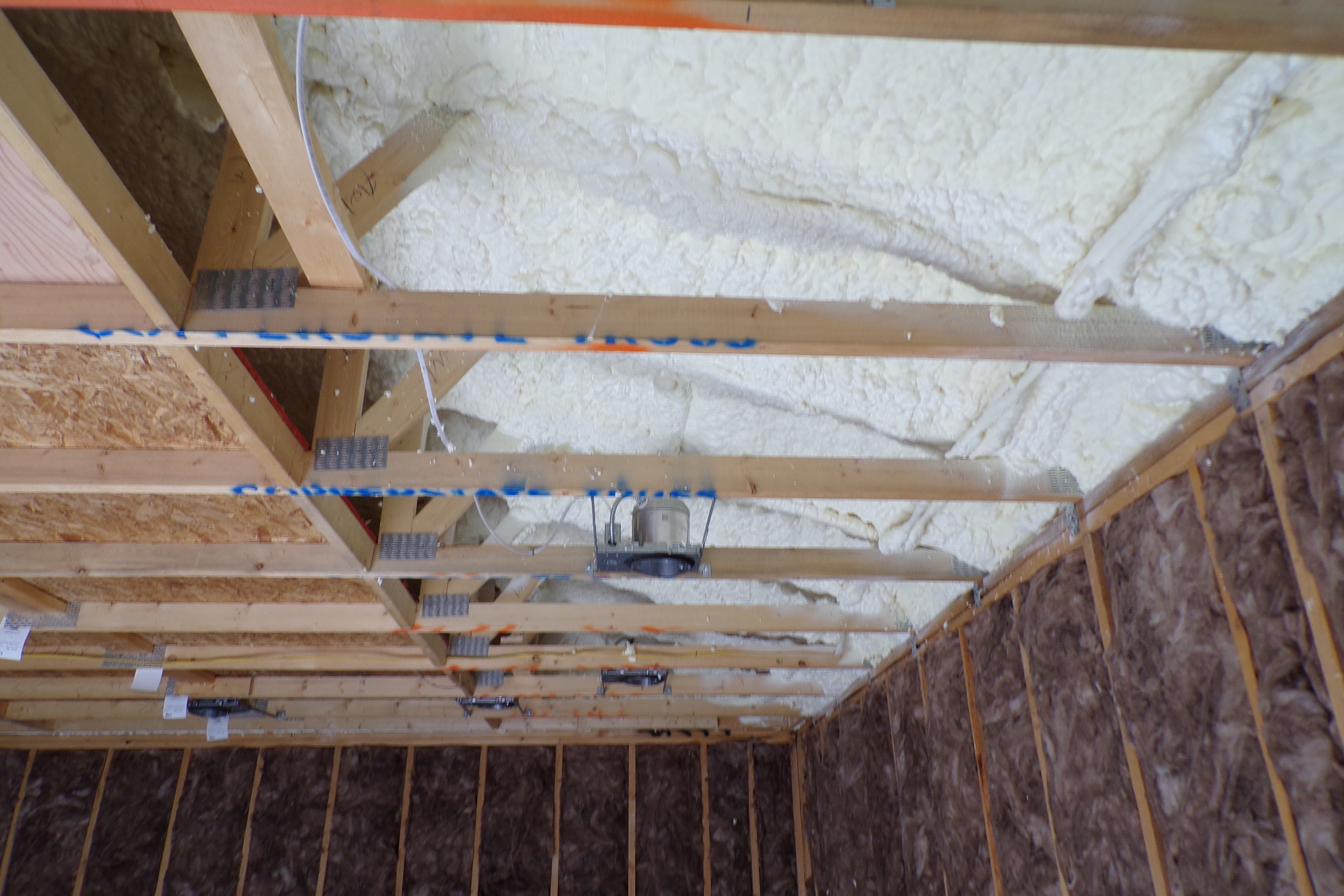

I'm a little behind on my pictures. We'll start with attic insulation. It is sprayed in deep enough to completely bury the 2X6 trusses. I'm surprised it didn't make a bigger mess than it did.

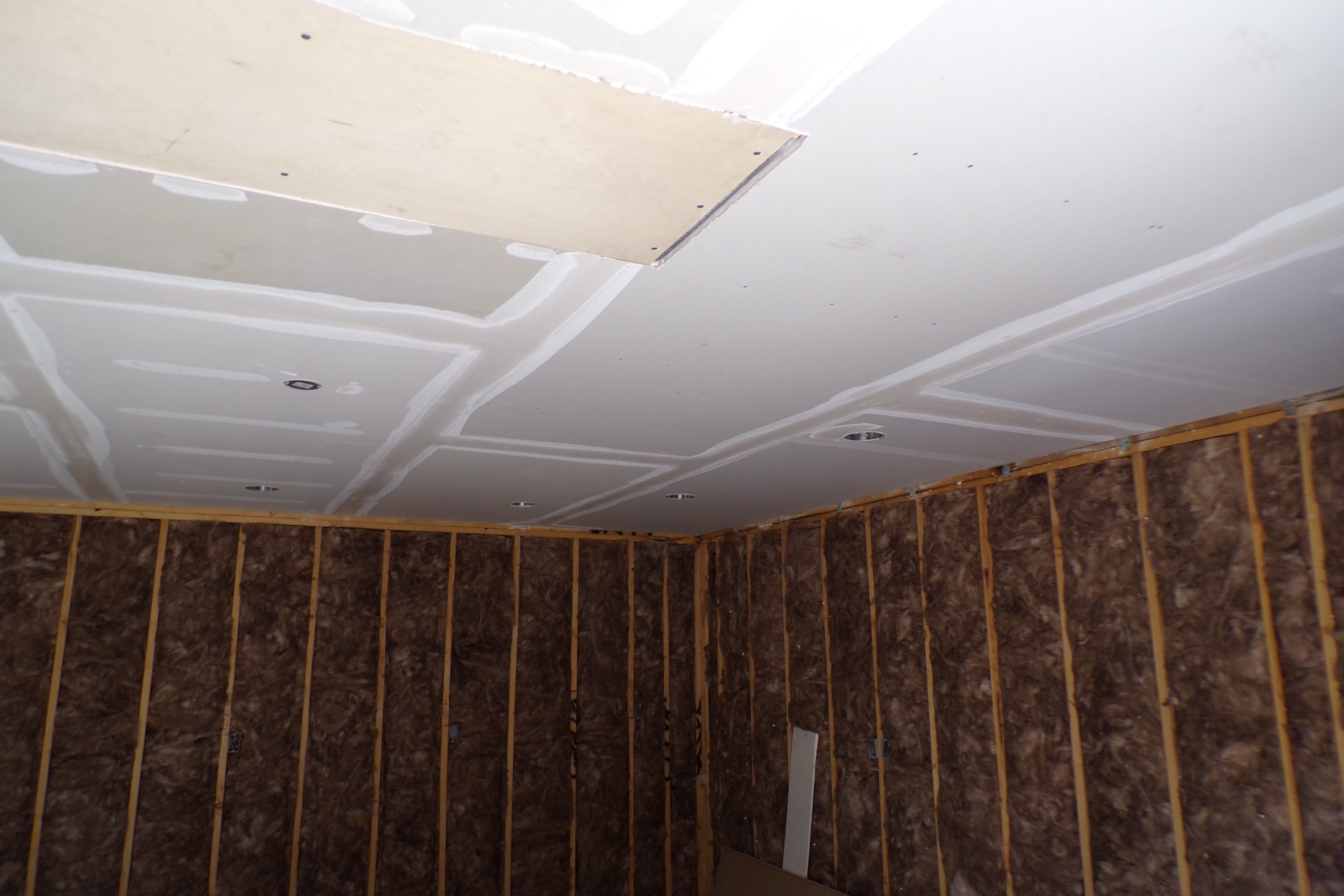

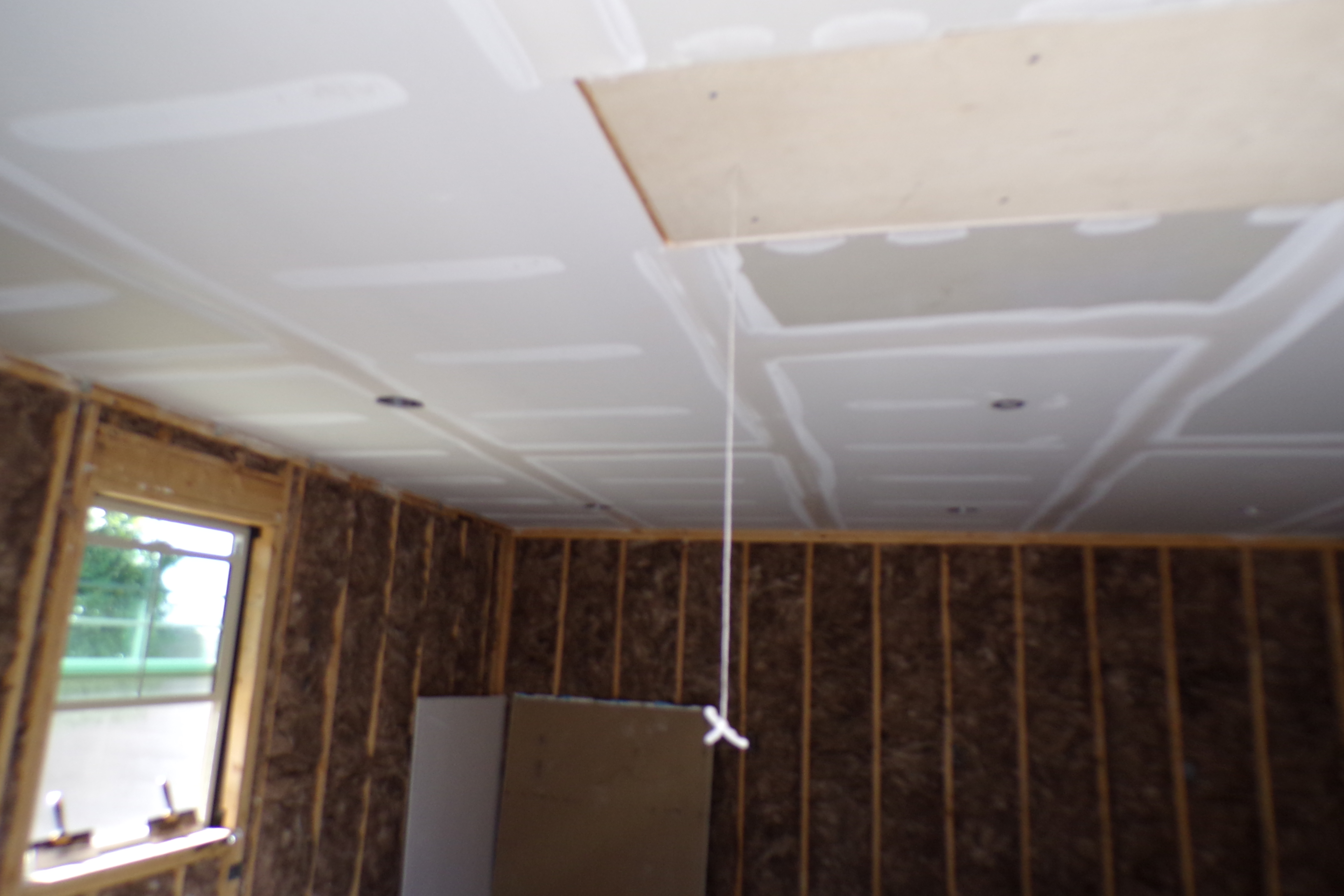

Then the ceiling. Everybody has seen drywall before, but this is to document progress.

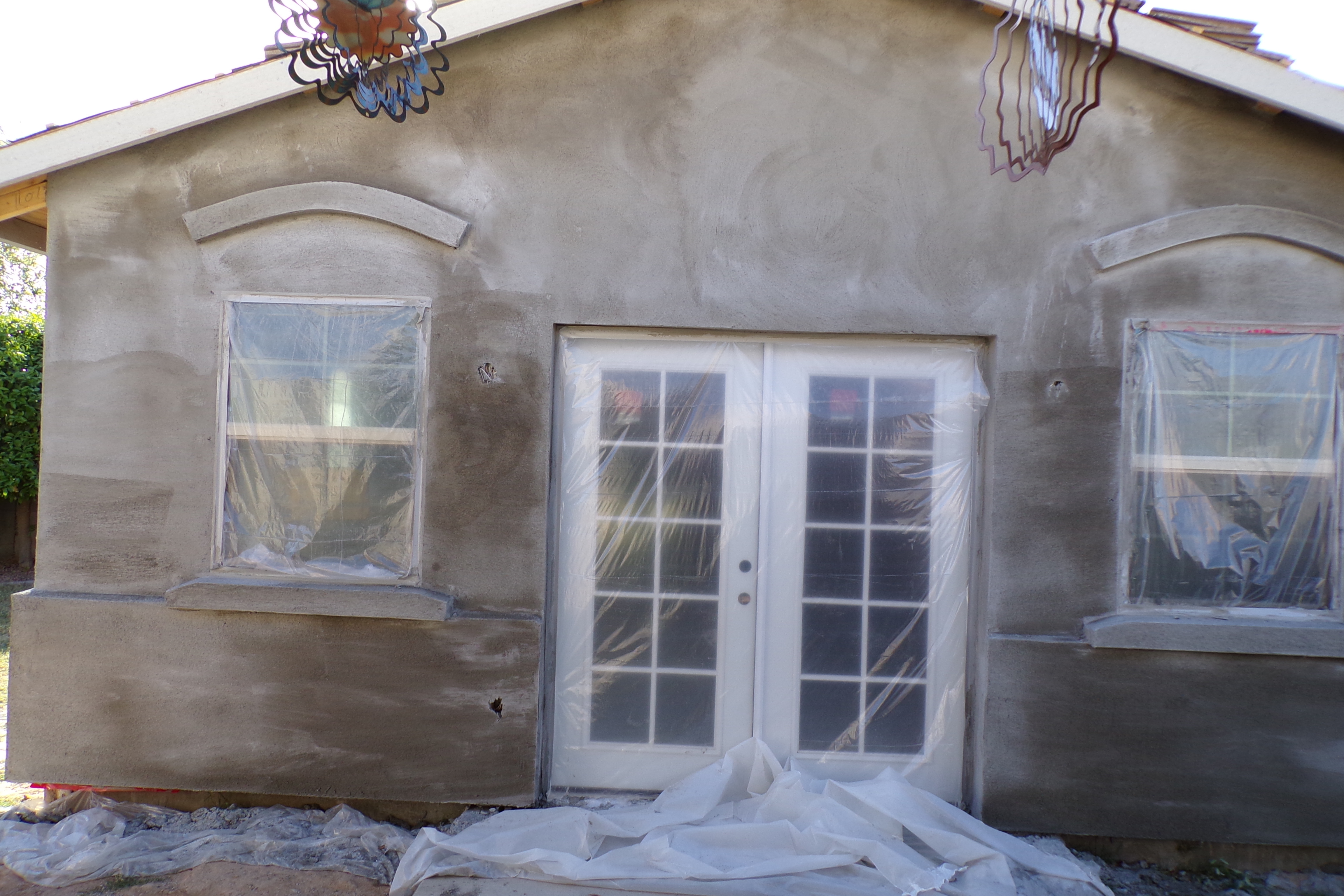

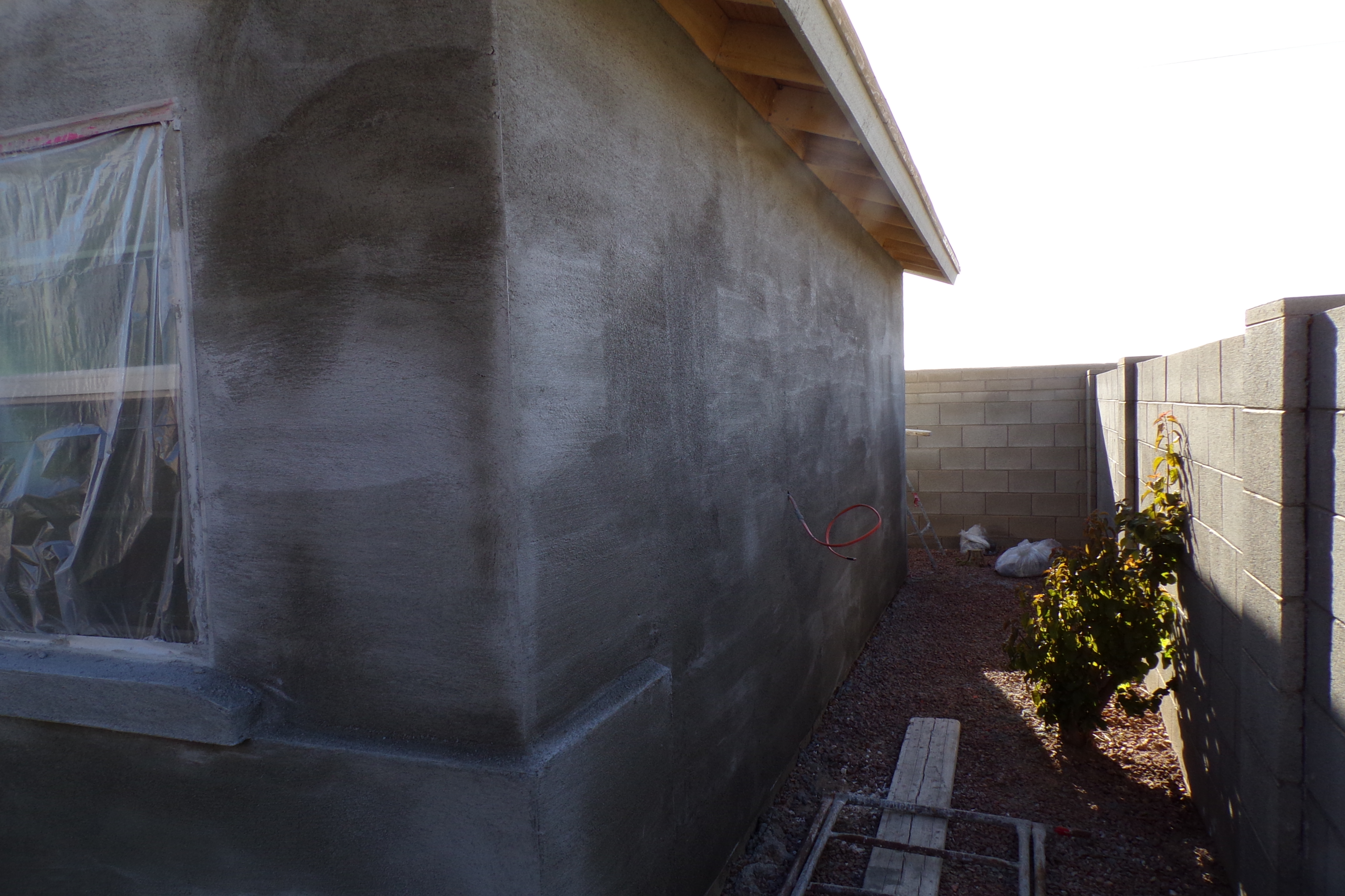

Now the stucco. The first picture (hopefully !) will be of the first layer of stucco. Not much to it, really. Looks like somebody covered the building with mortar. I'm not sure how they do big jobs, but my understanding is they have a machine that blows it on the sides, then they trowel it down. In this small job, they hauled the "mud" in with a wheelbarrow, then used big bats to smoosh it on, then troweled it down.

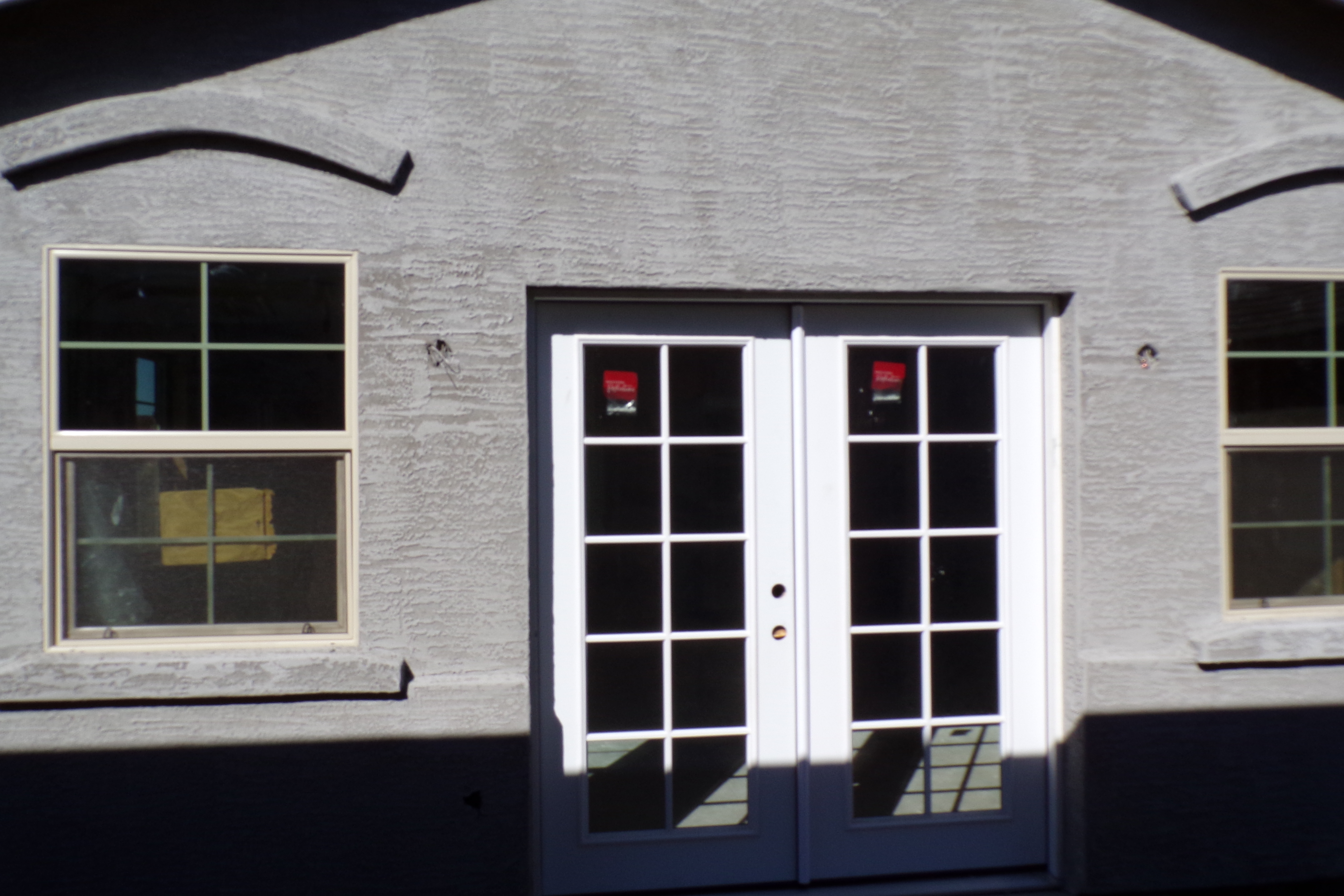

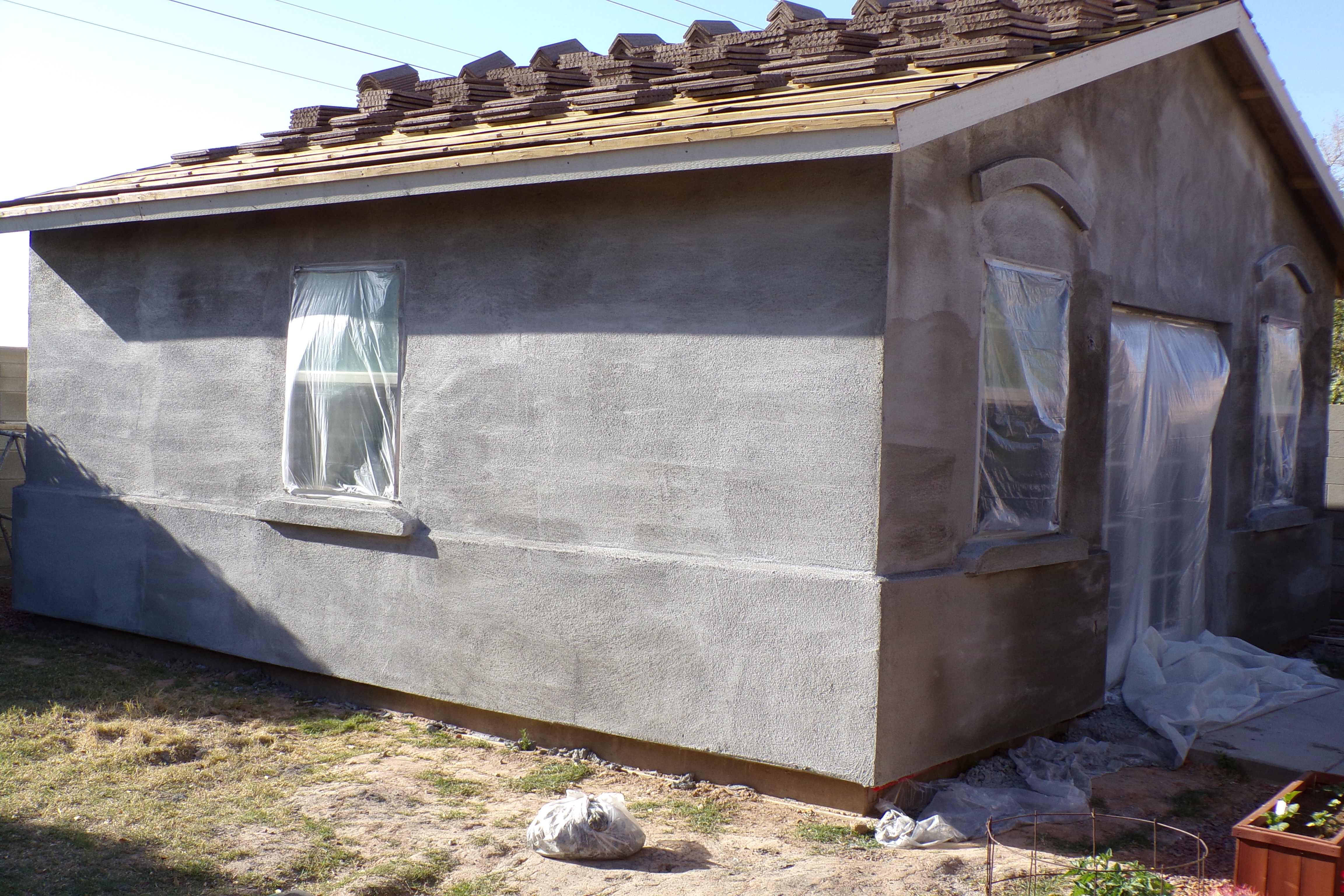

Now the textured stucco. They kinda splooshed it on like they were having a mud fight, then troweled it down. This is an amazing process that doesn't look like it should work. They people who do this are artists.

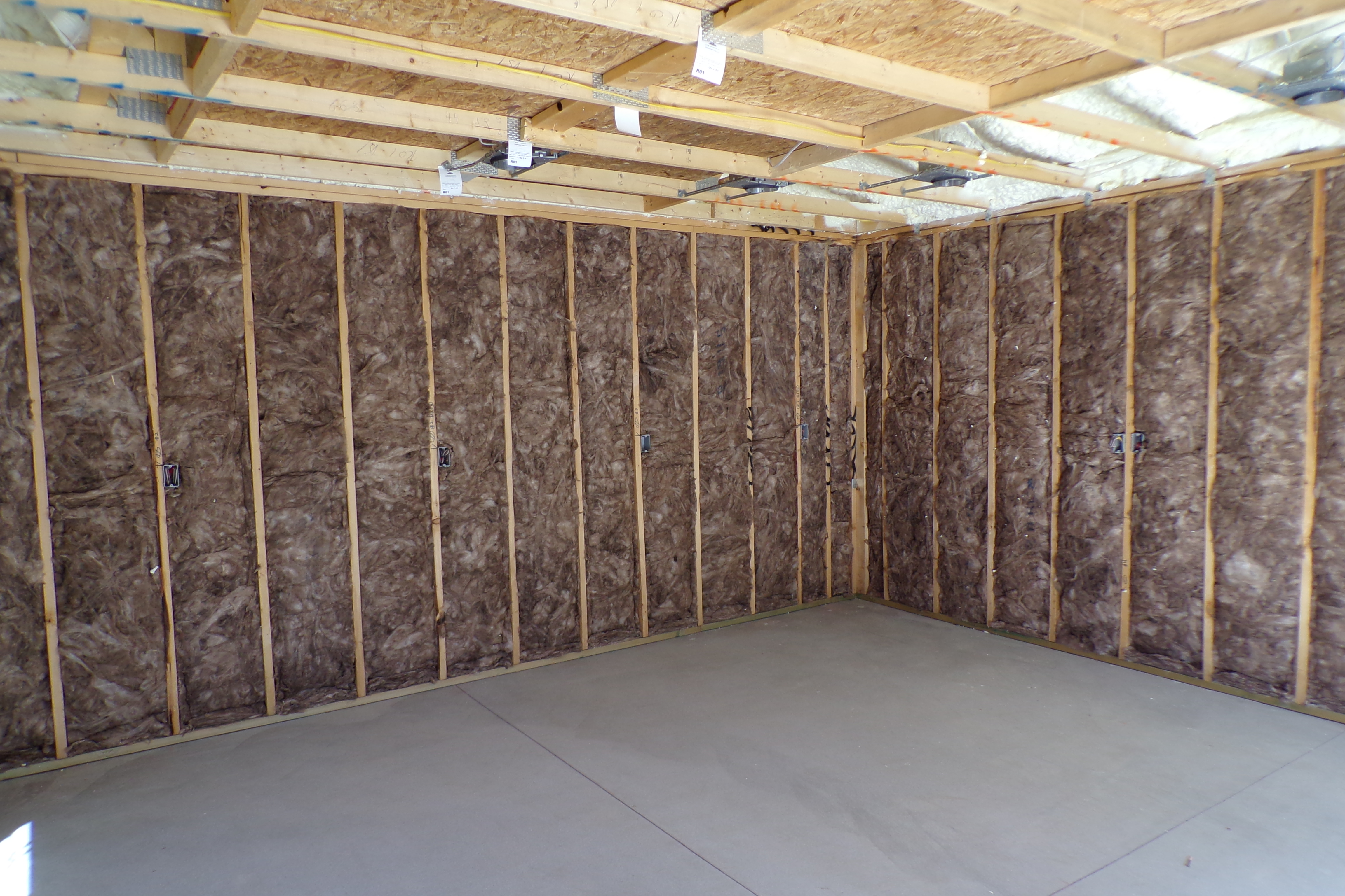

You may also notice that the insulation on the room is unfaced. There will be a layer of Tyvek over the unfaced insulation, followed by a layer of plastic. The plastic is there to protect the Tyvek from perforation by peg hooks. I'm not sure this is a code requirement, but it's a good idea. The walls will have pegboard all the way around. You may also notice they filled the electrical boxes with stucco. This is commonly done. I reckon it takes two seconds too long to fill the box with a chunk of paper before you apply the stucco. God forbid we not amortize our $300 an hour salary.......
But, to be frightfully honest, these guys work hard. Two guys did the stucco, one guy hauling and mixing stucco, the other guy putting it on. They get more done in an hour than I get done in eight hours. In fairness, they are 50 years younger than I am.
The guy who sprayed the insulation wore a face mask. One of those industrial ones that scares the dog. He should wear a fresh-air device of some kind. He was coughing and not feeling very good when he got done spraying this little job. He says he wears a fresh-air setup on big jobs. Breathing the fumes or debris from that stuff can't be good for you. He has as much insulation on him when he got done as he left on the shop. The insulation, once set up and dry, does not slough off particles or anything that can cause breathing issues.
