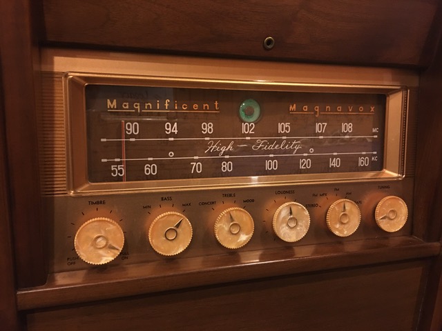

Hello Guys, life with the CG has been great. Still am impressed with its sound. I had received a part from Ebay the gold swing arm for the record changer. I installed it and it works. I then went through the process for plugging it into the system. I turned on the phono and tried it out. It plays at 33 rpm but very slowly. Thing is the the magic eye tube turned on and so did the light for the dial. So that part only works on the phono switch. I love this thing it truly sounds great. But I am realizing that there are things I would like to do. I would like a bare bones unit. where only the minimum stuff its running while in Tape /bluetooth mode.
I never turn on the remote system. There is no battery in the hand controller I don't think it has ever had one. Also I never turn on the FM on either FM or MPX I want to just unplug the MPX unit. I can't yet though I will get to that later. The FM did play some stations so it is working its clearly not very good fidelity like when its playing the bluetooth system and I could hear the difference with the mpx in stereo. On Am, I heard stations but not well. Could be antenna but listening to it I think it internal
I would like to get the record player going again. Even though it was playing slowly I could hear the Stereo. I would like the dial light to be on. I am not so sure about the magic eye though. Its not on when its in the tape position. At least it wasn't when I went back to try it. It's very intermittent and dim.
Only on Tape/ bluetooth does it play like a CG should every other knob position it sound poor. so I think the amps are in great shape. Its the preamp that needs the work. just a report no need to reply. Hydro
