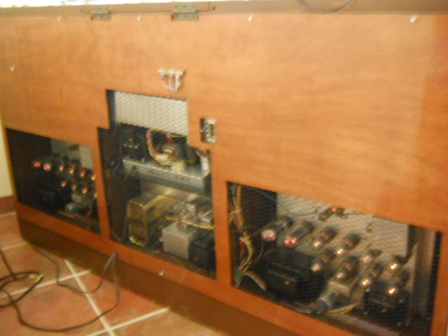

Hydro, if I can get the picture to load, I found a picture of the new, improved back I built for my CG so it would ventilate better. It works well and also lets me watch all those tubes glowing. YOu will see the MPX mounted above the tuner power supply chassis. The bottom of the MPX is facing out. I still have the pattern if anybody is interested. All the materials came from Home Depot. The wood is stained and shellacked Lauan, and the metal mesh came from HD and was spray bombed flat black.

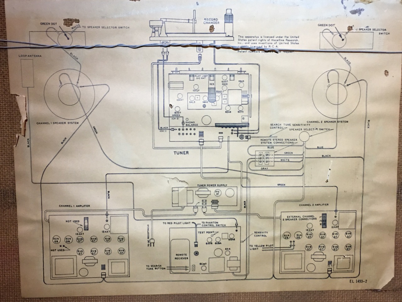

Here is another thing I found. The changer wiring in a Concert Grand with remote control. I hope this helps Hydro figure out his changer.
Edit...Guys, I may have messed up. This picture was in my collection, marked as a Concert Grand. I'm beginning to believe this may not be correct. It may be the diagram for a more rare Imperial with wired remote control. The 12AX7's in the tuner would be typical of a CG. An Imperial would have 6EU7's. Look over at the amp chassis. A CG chassis would not have Channel 1 and Channel 2 controls for the treble amps. And the singular 6V6 shown in the edge of that diagram is typical of the single 6V6 in the treble amp on the 81 series amp on an Imperial. No matter as far as how the changer is wired to the remote. I just wanted to clarify lest there be mis-information bandied about.....

Greg, The back on yours is a super good idea!
- Posts: 3749
Re: New addition to the family, 60 CG
Second the motion. I remember that project from the old list. Heat is the enemy of electronics, especially tube-variety heat. The manufacturers didn't always worry enough about it, since these devices were not intended to last forever. If we can improve the ventilation we're also improving longevity and durability.

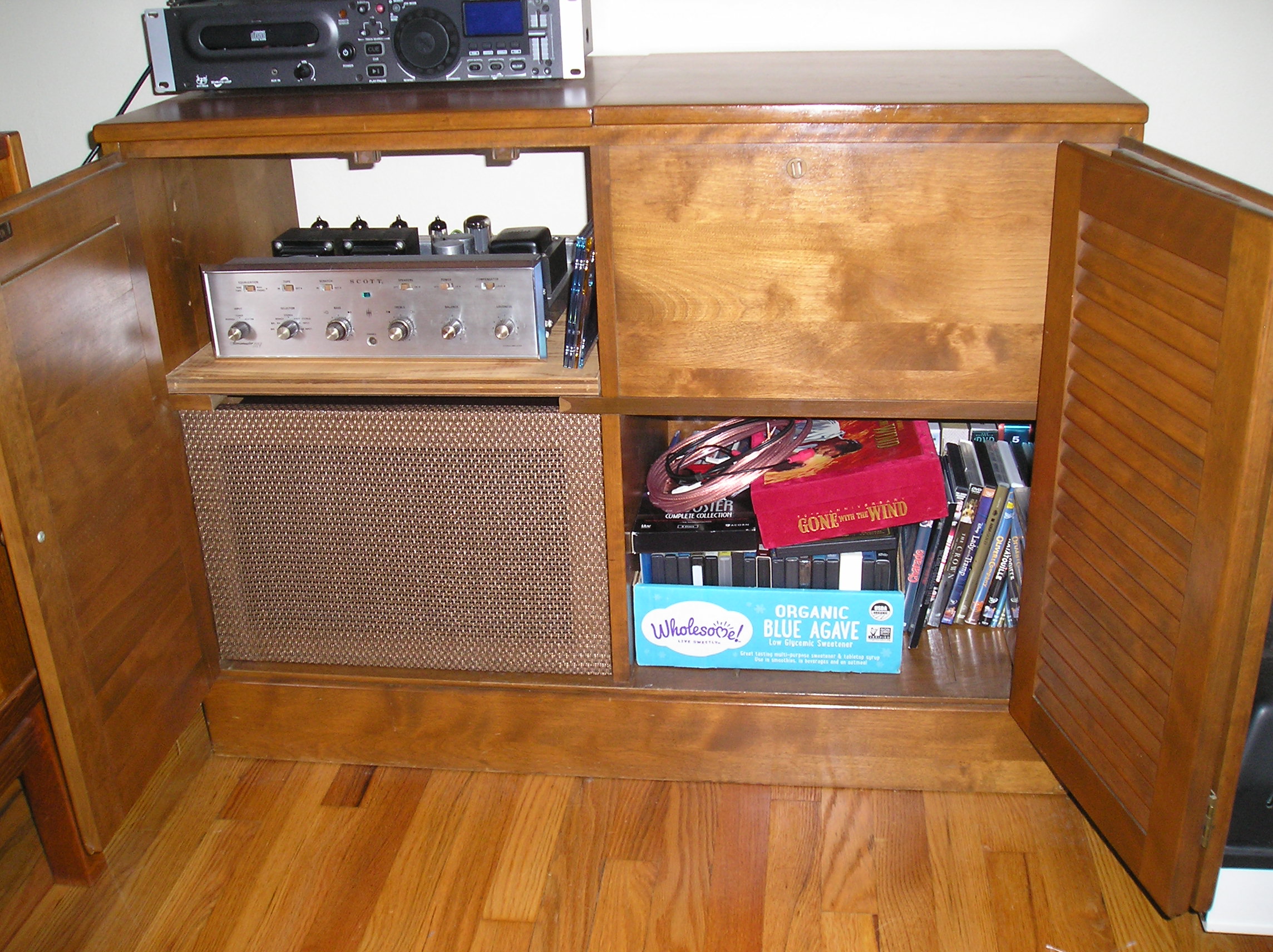

Good idea to add a back that will allow more circulation. Lot of heat generating tubes & trannies there! These had to be expensive things to build. I wonder if a couple of "muffin" fans would be a good idea to add with so much heat in a small space.
I've thought about mounting a fan behind the Scott tube amp in my smallish home-brew console; the space it's in is so small (pic) that it doesn't have room for the matching tuner and the amp needs to breathe, so the tuner will have to go on a shelf I'll eventually add where the dvds are now. There's no back on this cabinet and won't add one. There's a small Klipsch KSB behind the grille sitting on a foam pad for isolation, the other is remote for separation and placement flexibility. The TT is in the lift-lid compartment.

Okay, guys, here's the deal. If a parts Concert Grand is worth $2100, the pattern of my new improved back should be worth what.......$500? I could get rich.....
Seriously, making the pattern is 90% of the work. The pattern is in storage, in good shape the last I saw it. Anybody who would want a copy and can give me some time to make it, can have one. I believe it can be folded and put in an envelope for shipping. You could then unfold it, weight it for a couple days, then use it. You won't believe how much heat you'll get out of a CG if it can breathe a bit. I made my pattern out of the cardboard from a refrigerator box, but the next one will be from construction cardboard in more than one piece. I also have patterns for new backs for a big Imperial and a 400-series Stereo Theater.

I want to make new backs for all my Magnavox stereos. The Symphony is the only one with close to adequate cabinet ventilation. With one of my backs, not only will the cabinet ventilate better, but I can see the tubes sparkle.

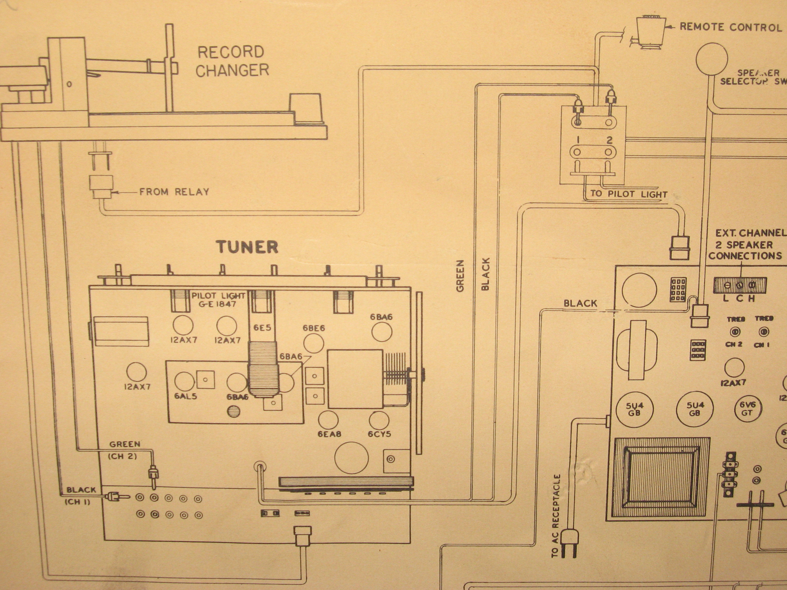

Hello Guy's, It could be a project for when i get the rest of the consoles running. None of the consoles currently have the backs on them. On that note the 60 had this paper on it. Hydro

That will show you what you need to know about how to connect the changer. IF you want a pattern of the back I made, let me know.

Concert Grand and certain models of Imperial had a faux wood grain back that really sets the cabinet off. My personal taste is that the cabinet is "missing something" if the back is gone, but that is just me. I used lauan in the effort to have the correct thickness as the original back, plus the wood graining. I used wire mesh from HD because it was convenient. And it keeps the cats honest. I had a cat that lost the fur off the tip of his tail for life by waving it too closely to the high voltage section of a TV I was tinkering with.
