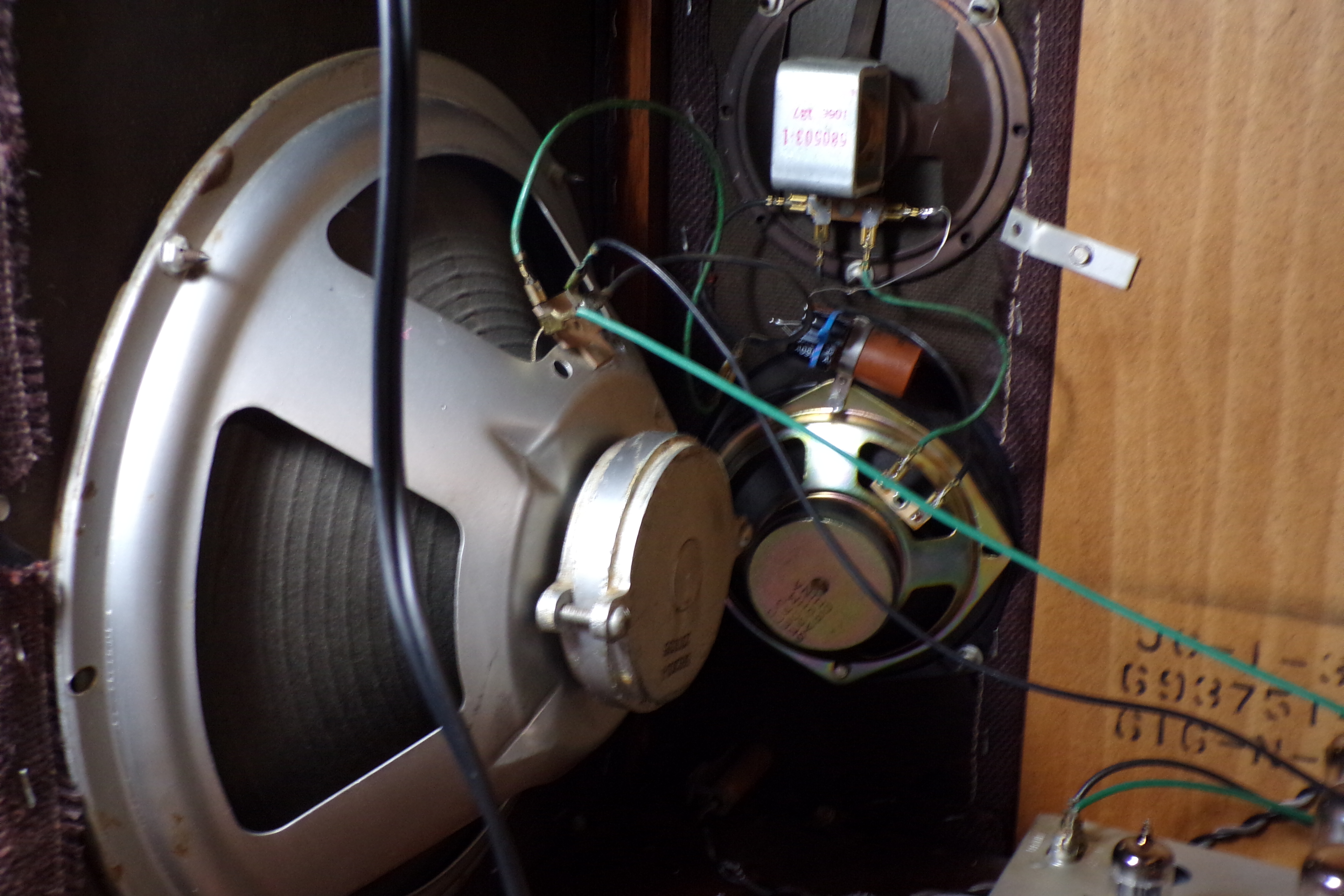

I managed to monkey with this stereo enough so that I could listen to the front side. At lower volume, I would essentially lose the small speakers on the right side of the cabinet. Turn the volume up, the speakers would come back in, but really didn't still sound right. I removed the bottom speaker on that side and found something I hadn't encountered before. The speaker works, but it sounds really tinny and totally quits at low volume. The pole piece appears to be frozen solid. When I push in on the cone, it won't move. I think this is why it would sound good at times, not so good at other times. I have a speaker I can sub for test. The small speakers on the other channel appear to work okay. I don't believe I have ever run across a frozen speaker cone before.

The cone-type tweeters have very stiff suspensions and very little cone motion, even when manually pushed.

The other three aren't like that. You can move the cones on all of them. I want to check the resistance on the voice coil on the speaker with the stiff cone. I had to get supper ready which interrupted my testing....

I have a set of nice pincushion-frame speakers that were in set I had one time with nasty cabinets. I replaced the speaker in question with this one. This has restored the audio quality to the channel. Now, what did I find out and what did I learn?
What I learned was that, when the original speaker was in circuit, it essentially shorted the audio to ground. At higher volume, really higher than one could comfortably listen, the signal would pass intermittently. Apparently, the pole piece is dragging on the voice coil. I have never ran across a condition like that, and would probably never have figured out what was going on had I not been listening closely to that specific speaker. I don't know whether I should replace the other mating speaker or not, so that both channels sound the same. The audio is somewhat brighter than before, but I still need to run the control fully advanced. I need to experiment with the value of crossover caps. If I had my way, I'd just wire them full-range and do away with the crossover. I like how it sounds that way, but I don't know if the original speakers that are left will handle that kind of volume.

Seems to me that you want to keep a series cap in place so as not to burn up the tweeters. You can probably find some fancier crossover networks online (Parts Express?) that may let you do some sound shaping.
I have a device that came with a speaker that would operate fine for about 5 min.and then lose audio output. I tried to figure out what electronic component was going intermittent, with no luck. Then I plugged a remote speaker into the headphone jack and had audio. Unplug, no audio. Turns out the speaker was the intermittent device. I found a suitable Radio Shack replacement. This is the old RDF I keep on the local sailboat for its FM band. The remote speaker sits in the cockpit and is in use 99% of the time.

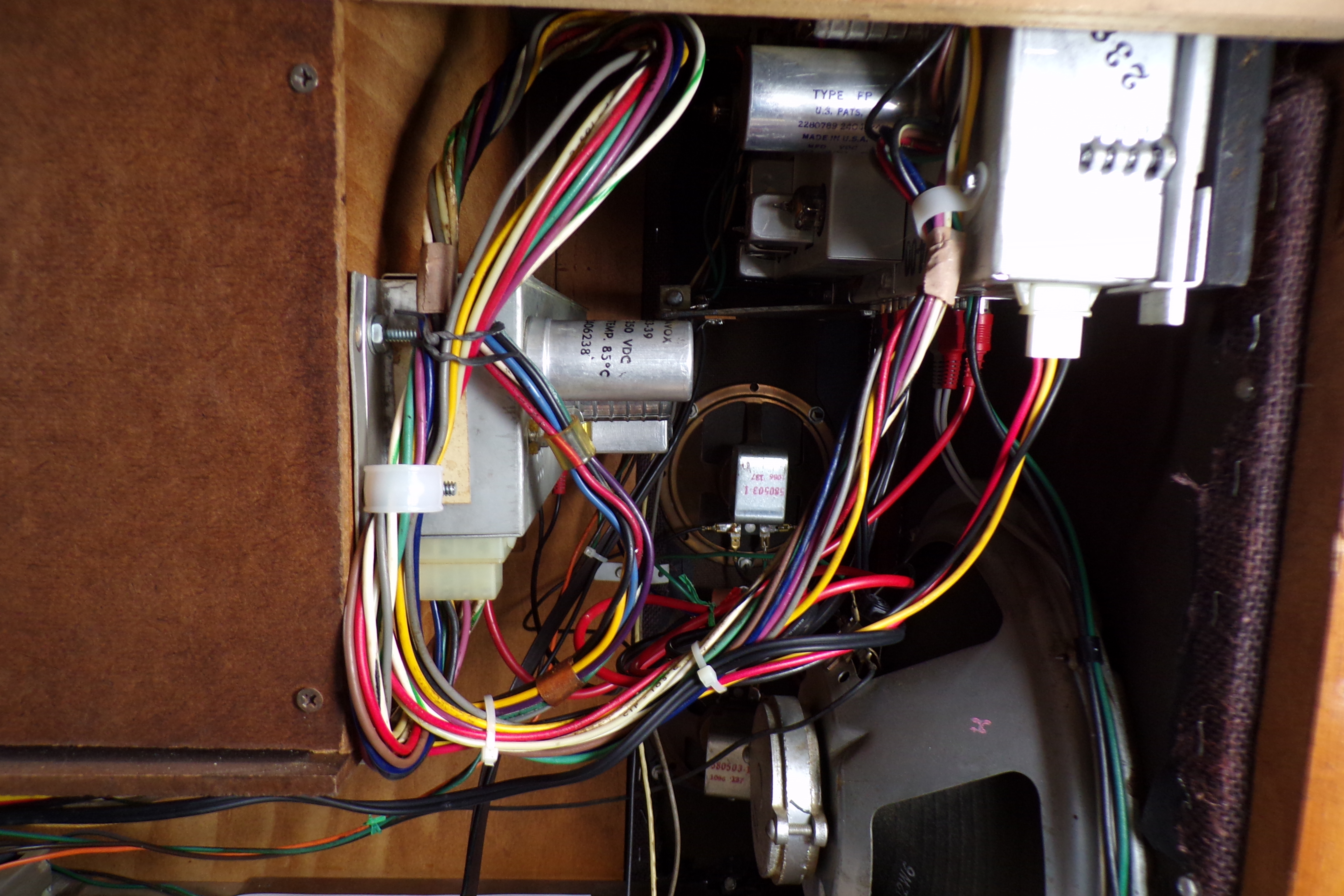

I have some photos of my speaker kluge, which is working pretty well. I've decided to replace the other lower speaker so they will both be the same. I found a wiring harness from an MPX, so I'm going to splice those remaining dangling wires and run them in a more organized manner. As it is now, the speaker wires are all suspended by the external speaker switch, which seems like poor workmanship to me. I have been playing the collection of cassette tapes I got at an auction in Missouri in 2007. Somebody went to a lot of effort making this collection of tapes. They are not all numbered in order, no idea why there would be missing numbers. I have several dozen of these. All neatly typed. Fairly good fidelity for the most part. No noise reduction, there are a few skips. The only gripe I would have is that they put instrumentals on the end of the tape, between the last full song and the end of the tape. I would prefer the dead tape. They also used TDK tape, the brand Walmart sold. Typically not very good tape, this stuff has weathered the years well. Most were recorded in the 1991 to 1995 era. The person who had the sale was a lady who had gone to a nursing home. Somebody had a huge record collection to share. The songs are all by different artists. 99% country music.

I've been procrastinating on ordering parts. I finally got that done. Drive tire and needle are on their way. I have the midrange speakers changed, have the rats nest of wiring somewhat, actually considerably, neater. The two wires on the front of the cabinet are the input wires from the tuner to the amp. The two light-colored wires on the right hand side hanging down are the external speaker wires. I'll put the service literature I have in a manilla envelope and leave it in the cabinet. We'll get the changer sorted after the parts come and we'll see what we have.

I put about a foot of wire in the orange, brown, and black wires going to the right hand speakers. That is all the extra wire needed to be able to run those wires so they don't dangle on hot tubes. This stereo has the only factory authorized installation of the Multiplex adapter so it isn't in the hottest part of the cabinet. I used white wire ties to separate the wires by component and so they would be better supported.
