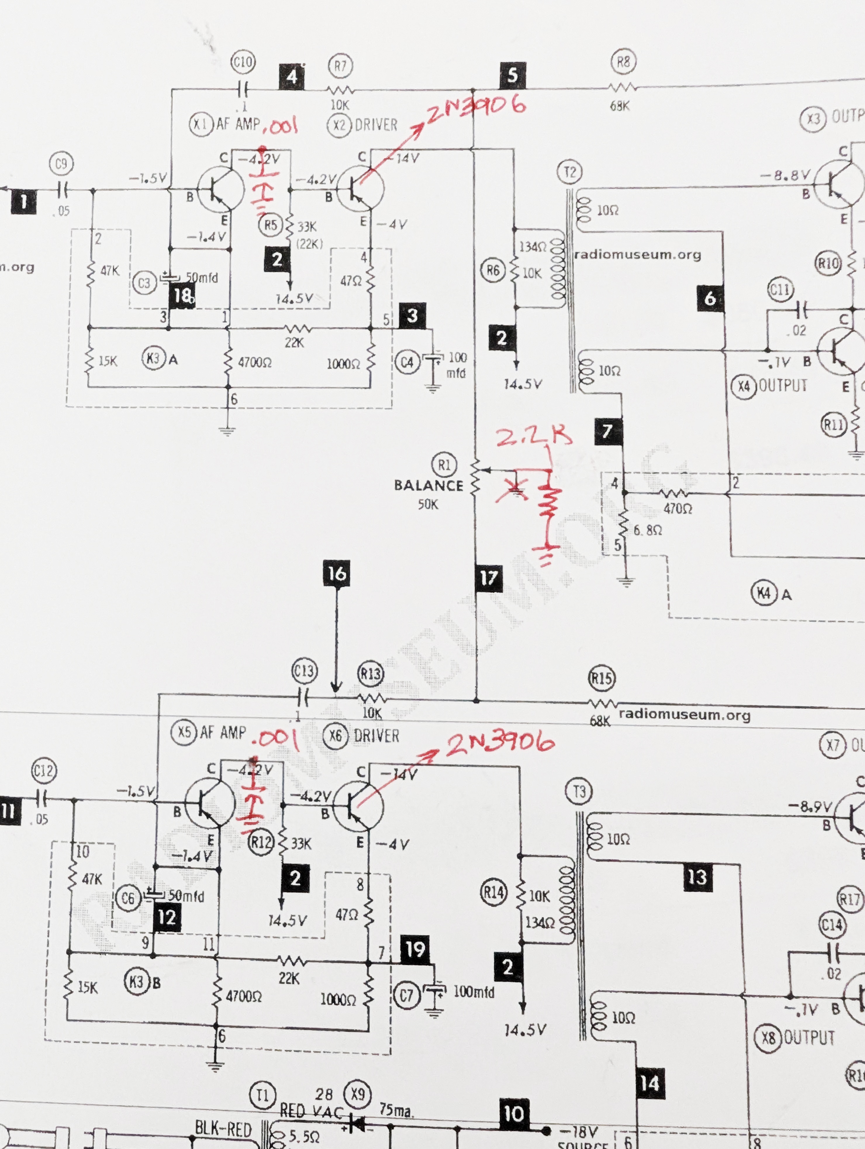

For the benefit of those of us who know zipkus about solid state circuits, Chris, would you share your thoughts on the suggestions you just posted? My guess is those caps are used for coupling caps. Am I even close?
- Posts: 3690
Re: $5 Riviera Deluxe
I know minus zipkus, but I looked at the schematic and saw two caps, one probably paper/wax and the other electrolytic, series with the misbehaving balance control. Caps are a principal mode of failure, and the resistors in the circuit don't look to be heavily loaded, so I'm just guessing.

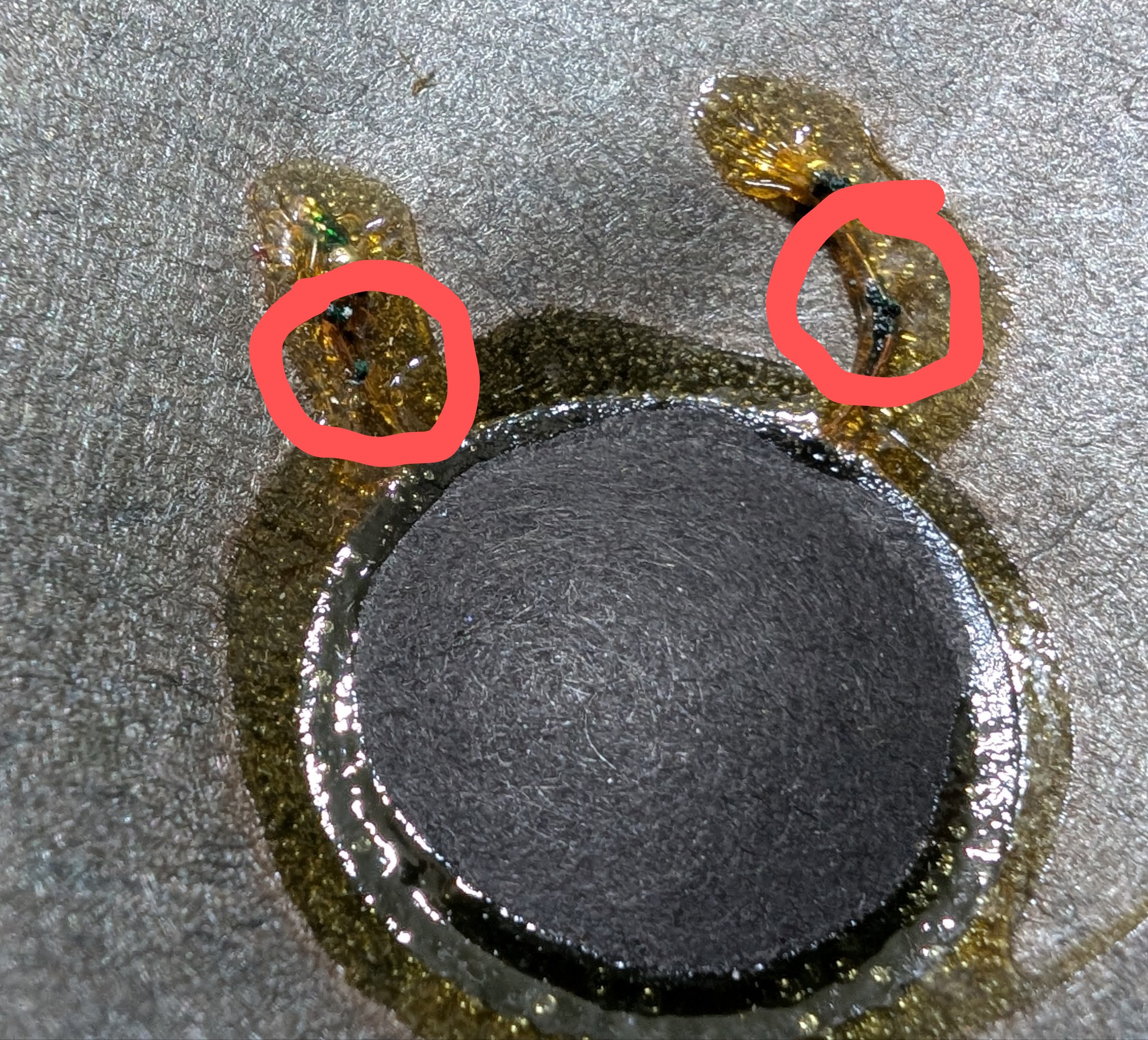

After being inspired by a restoration video on ARF, I decided to take another look at the speakers. It turns out that three of the speakers being open is due to corrosion on the voice coil wire as it exits the voice coil and attaches to the feed-through. I took a close-up of one of the tweeters, which happens to still be good, so you can see the green corrosion on the leads. When that stuff is cleaned off, the wire is broken at that point underneath the corrosion. I suppose it's just a matter of time before that one also opens up, too.
I managed to repair the woofer that was not seized by replacing the wires from the voice coil to the feed throughs, and patching up the holes with Post-it paper and Elmer's glue. The other woofer was seized because the pole piece had shifted off center. The only thing holding everything together was glue between the flat magnet, the pole plate and the frame of the speaker. The glue apparently failed, allowing the pole piece to sag out of alignment. Prior to discovering that, in my attempts to free up the voice coil, I damaged it beyond repair.

I'll be sure to replace the crossover caps, but the corrosion issue was present on all 4 speakers. That, plus the glue issue on the woofer, makes me wonder if there was some kind of quality control issue. Or perhaps the moisture exposure that this unit obviously experienced could have contributed. Anyway, after fixing/patching the original speakers I now have 2 functional tweeters and one functional woofer. But I'll probably end up replacing everything with the "new" ones from eBay, assuming they are all OK, they should arrive day after tomorrow..

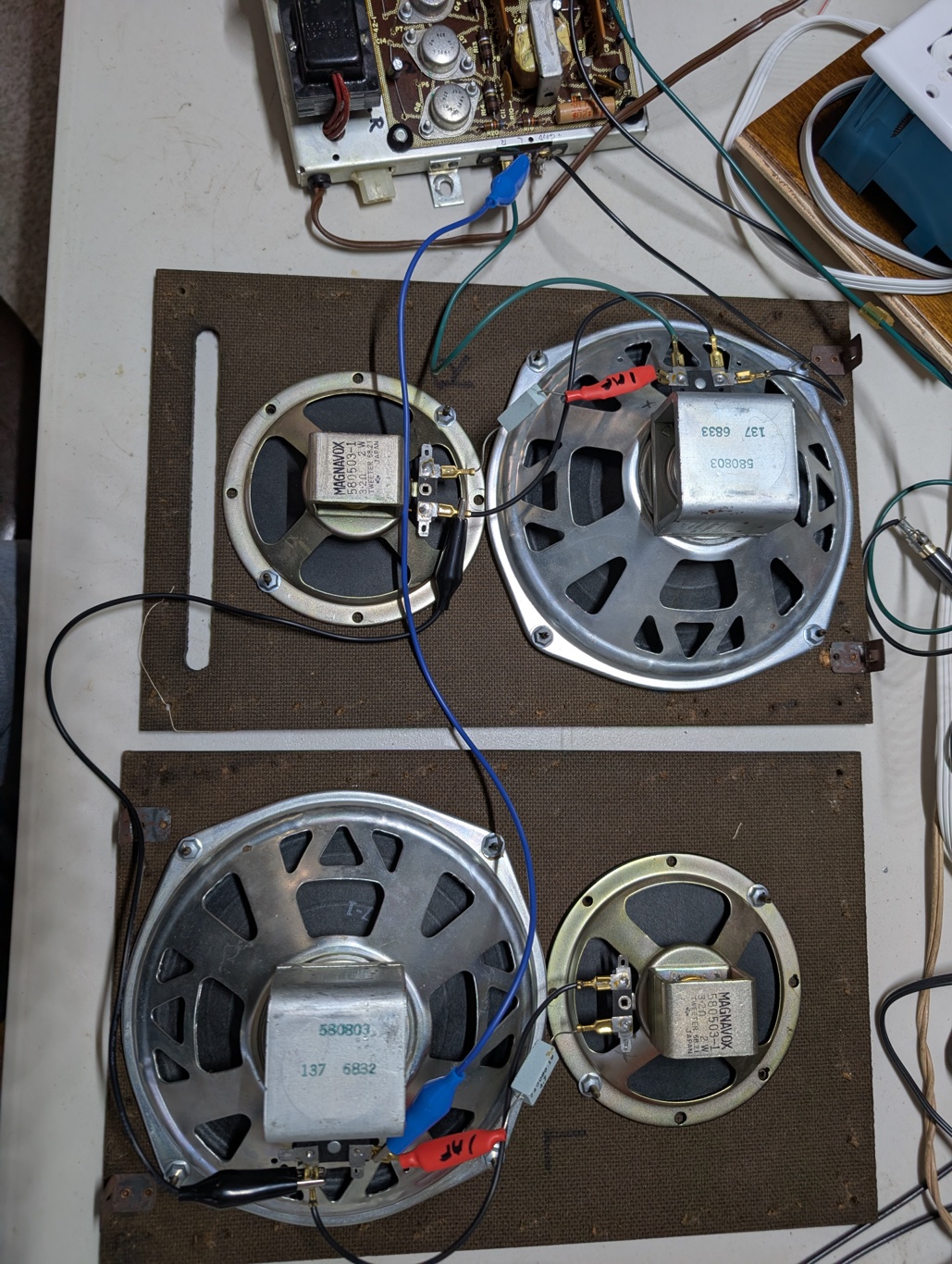

Removed the old grill cloth from the speaker baffles and temporarily attached the "new" speakers (which all have the same impedances as the original speakers). Even though the tweeters were 5 in, they fit the two 4-in mounting studs. The woofers are deeper than the originals, that makes the woofer on the left side not quite able to fit in the enclosure. I'll either just use the original working woofer, or cut a hole in the enclosure. Since there is already a hole there, it can just be expanded a little. The hole doesn't show when the turntable changer is folded down.
After hooking up all the speakers to the little amp, everything works great! The feedback oscillation that I was getting on my test speakers does not occur with the factory spec speakers and crossovers. So, the amp must have been sensitive to the crossover components in my test speakers and/or the difference in speaker impedance. The crossover capacitor is one microfarad with a series 4 ohm resistor to feed the tweeter.

The schematic doesn't show the speakers that I can see. It shows a terminal strip or plug of some kind that the speakers connect to. My guess is that the impedence of the speakers are a part of the feedback loop. IIRC, there are two caps in series with the feedback loop that may need to be increased/decreased in value to eliminate the squeal.

I've replaced the feedback caps, but didn't try different values. However, I have since confirmed that cooling one of the second transistors, X2/X6, will stop the oscillation. Cooling the one in the other channel also has an effect, though less so. Leakage is over 2ma when the transistor is tested on my little Chinese component tester, goes down when cooled. So I'm guessing maybe these are the cause of the oscillation, though I don't understand why. One of them is noisy also.
Part number replacement is given as Delco DS-26, or GE-2, or RCA 2N614 (2N2614). Anybody have an idea on a cheap replacement for these? Germanium of course.

After doing some Googling research, and posting some questions on ARF, and experimenting, I've made a few circuit changes. I added .001uF mylars to the base of each driver which killed the oscillation without affecting the frequency response. Ended up replacing both driver transistors, one was noisy, with 2N3906's which are PNP silicon, worked without any circuit modifications!
The strange balance control, which is somehow tied in to the feedback circuit, performed poorly. On either extreme, that channel became very loud, overall volume was much lower in the center. After some experimentation, I ended up putting a 2.2K resistor on the wiper to ground, vs the original directly grounded wiper. Volume is now consistent across its range. So, here are all the changes I made:

So was the germanium to silicon substitution made just by finding a silicon with similar characteristics to the old one, or just good luck? Maybe stated otherwise, was this a rare instance in which the switch could be made?stbasil wrote: ↑Wed Mar 18, 2026 7:20 pm After doing some Googling research, and posting some questions on ARF, and experimenting, I've made a few circuit changes. I added .001uF mylars to the base of each driver which killed the oscillation without affecting the frequency response. Ended up replacing both driver transistors, one was noisy, with 2N3906's which are PNP silicon, worked without any circuit modifications!
And was the oscillation a result of aging components and drifting values, or just bad design?
