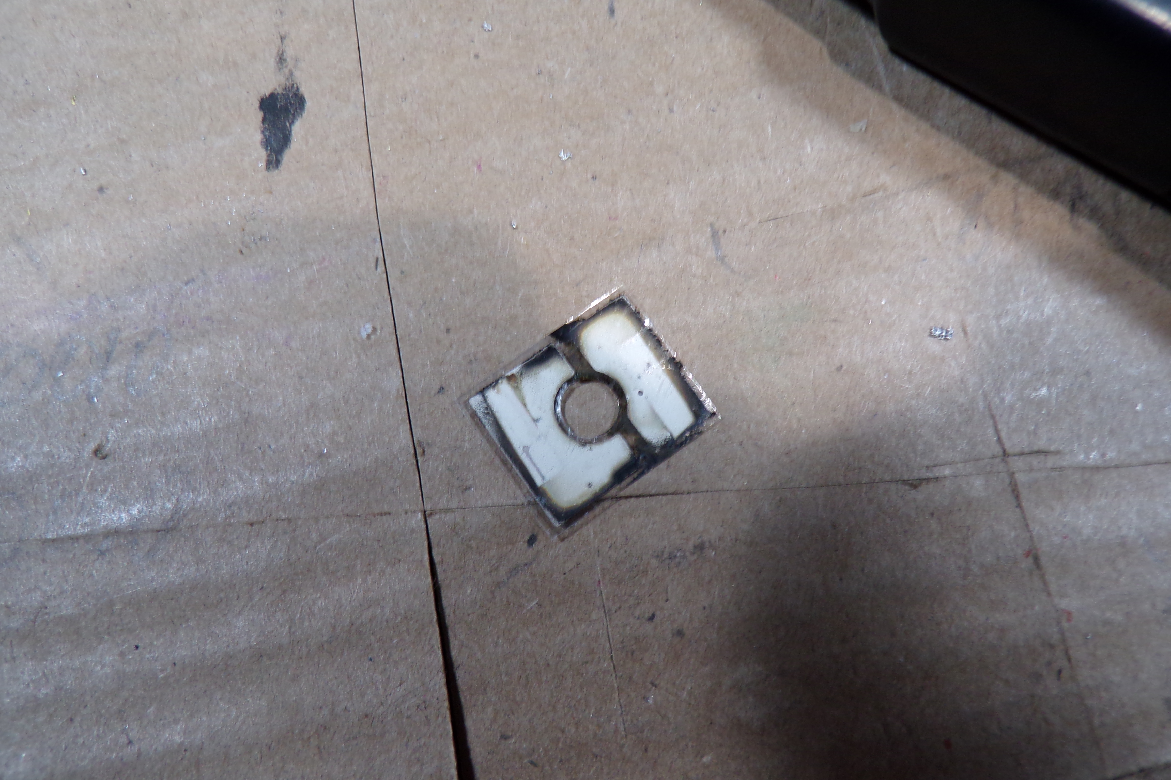

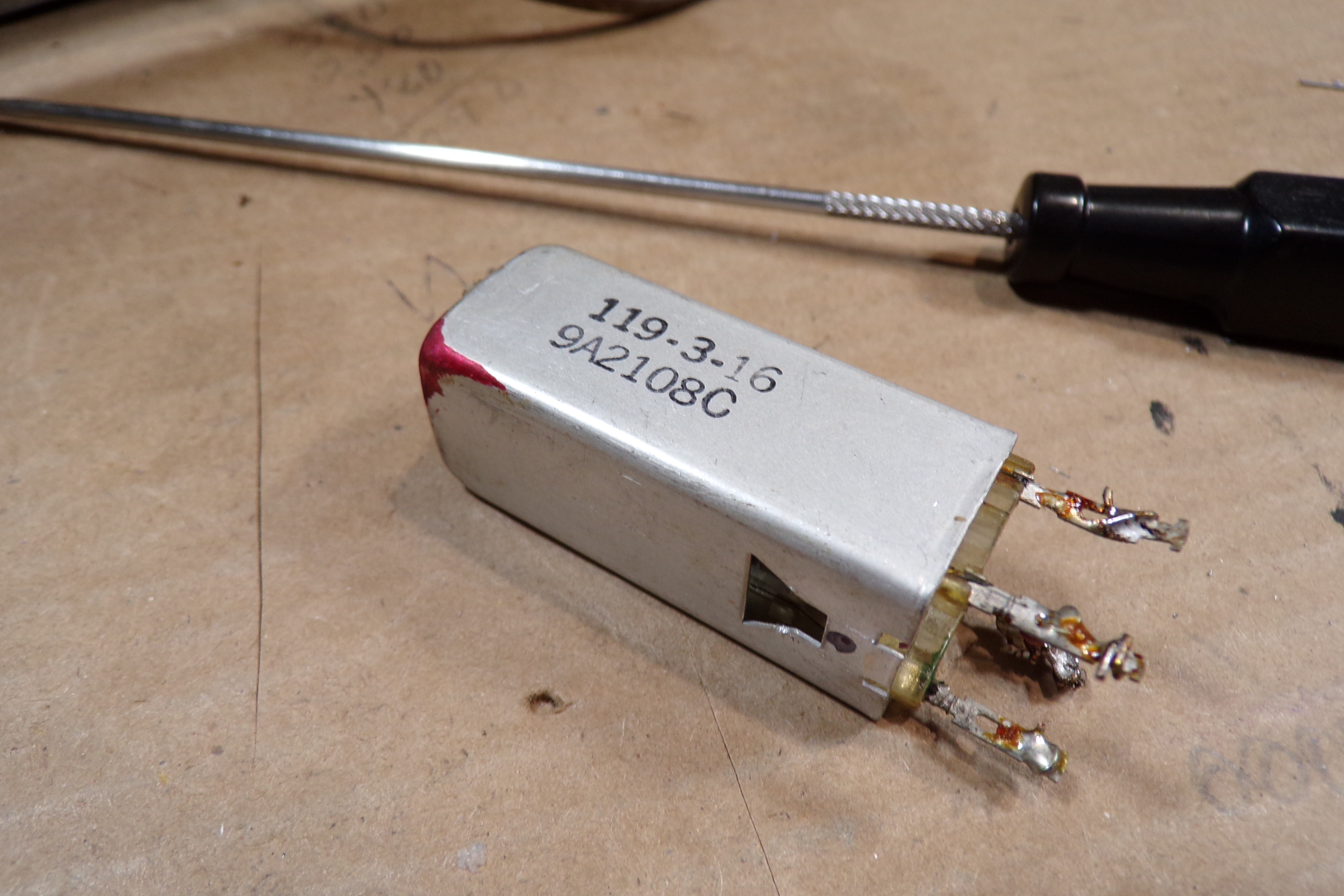

SMD in the first IF transformer

I may not need new IF transformers. I had really three issues yet with this radio that I needed to get sorted. The first one is that it needs a good alignment. I haven't found instructions yet, so I'll order a Sams from the Schematic man. Next, I couldn't get either IF transformer to peak. The adjustment essentially did nothing. I got desperate and a little annoyed that nothing I did seemed to work. I started pulling tubes and running them thru the tester yet again. One of the 12BA6 tubes, used as the IF amp, was actually a 12AD6. This is a converter tube used in those 12-volt hybrid car radios in the late 1950's. The plate is made to run on 12 volts. The pinout on the 12BA6 and the 12AD6 is really similar, the difference being that pins 2 and 7 are reversed, That tube was the reason the IF transformers wouldn't peak. The only way for that tube to be there was that I put it there. When and why, still unknown. The other issue I had was an intermittent scratchy, hashy, irritating noise in the audio. When I put the tubes back in after testing them, I put a spritz of PB Blaster on each tube pin, then wiggled them around real well. This seems to have taken care of the mystery noise. Time will tell on this one. It would appear after the set ran for a couple hours. I think after I do a good alignment, this old set will be back to normal.
