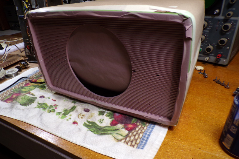

I have the RCA cabinet two toned. I can't take the tape off until the paint gets dry, but, from what I can see, it turned out okay. I have some assembly and detailing yet, and will share those activities.

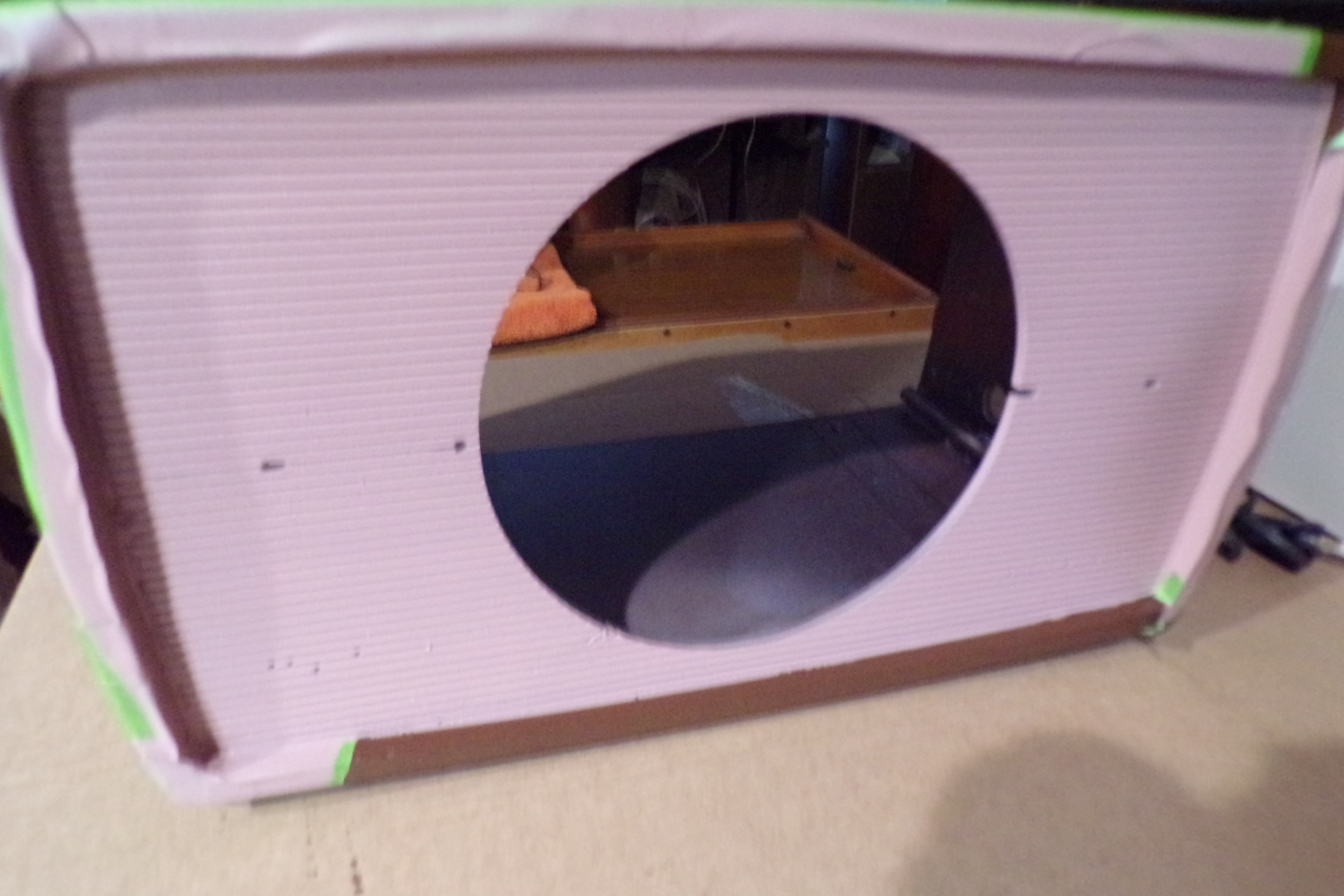

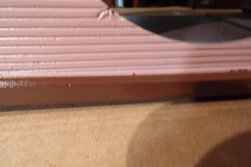

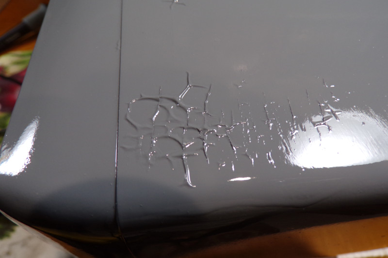

The second coat of paint looked nice on the Truetone cabinet until this happened.. RCA in progress. Paint is too "green" to let me remove the tape. RCA paint detail
- Posts: 5318
Re: More broken bakelite radio cabinets
I am glad you got your camera up and running. What caused the paint problem?
- Conelrad
- Posts: 282
- Location: Hidden Valley, AZ
That looks a bit like Lacquer vs. Enamel to me.
DG
DG
- Posts: 8899
I was using Rustoleum spray bomb. That was the second coat of the same material. What the instructions say to do is to spray a medium coat, then, 15 minutes later, recoat as necessary, or wait 48 hours, then recoat after a light sanding. I used Rustoleum primer, by the way, so that shouldn't have been an issue. The first coat was light, like I always do it. I let it "tack up", then shot the second coat. It only lifted on top. I think now that I'll mask the front panel, then primer and paint the top again. This risks having a paint line, but that is better than lifting. The only theory I have is that something I wiped the top with was contaminated. The first coat was thin, so nothing happened with it.
For the record, the RCA radio looks way better in person than it does in those photos. I'll try to get better shots and share them.
