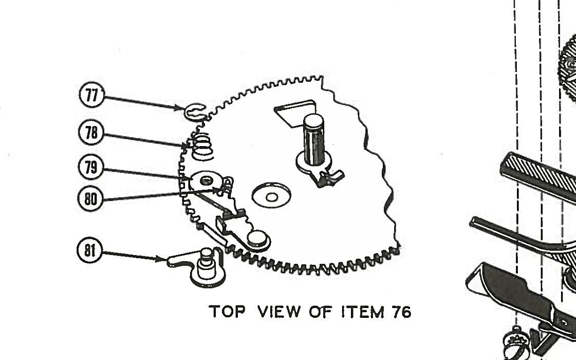

The tonearm stays in the groove at the end of the last
song on records.
It's not the records, and it's not anything obvious.
Tonearm wires are supple, no binding.
I even added a bit of weight to the arm, though
as I posted earlier, it's tracking already at 6 grams.

I was mulling over WHY there is that tonearm binding.
I remembered that once out of cycle with tonearm on
its rest post, that the tonearm moves effortlessly across
the arc of the platter.
So, I think there is binding in the trip link somewhere.

I have been thinking about your changer problem as I had a similar problem with one of my VM's. I was trying to remember what I did to fix it and if my memory is correct, I cleaned once again, the trip mechanism and that little flip thing on the slide mechanism. After that probable 5th cleaning, it worked as it should.
- Posts: 1344
Re: 1960 Sylvania Portable w/Uncommon Changer
Thanks for the input, Bill. That is my conclusion, also.William wrote: ↑Wed Aug 14, 2024 6:35 pm I have been thinking about your changer problem as I had a similar problem with one of my VM's.
I will need to remove the main gear assembly.
It's similar enough to a V-M product.
Then clean again the trip pawl, trip lever, and pawl levers.
