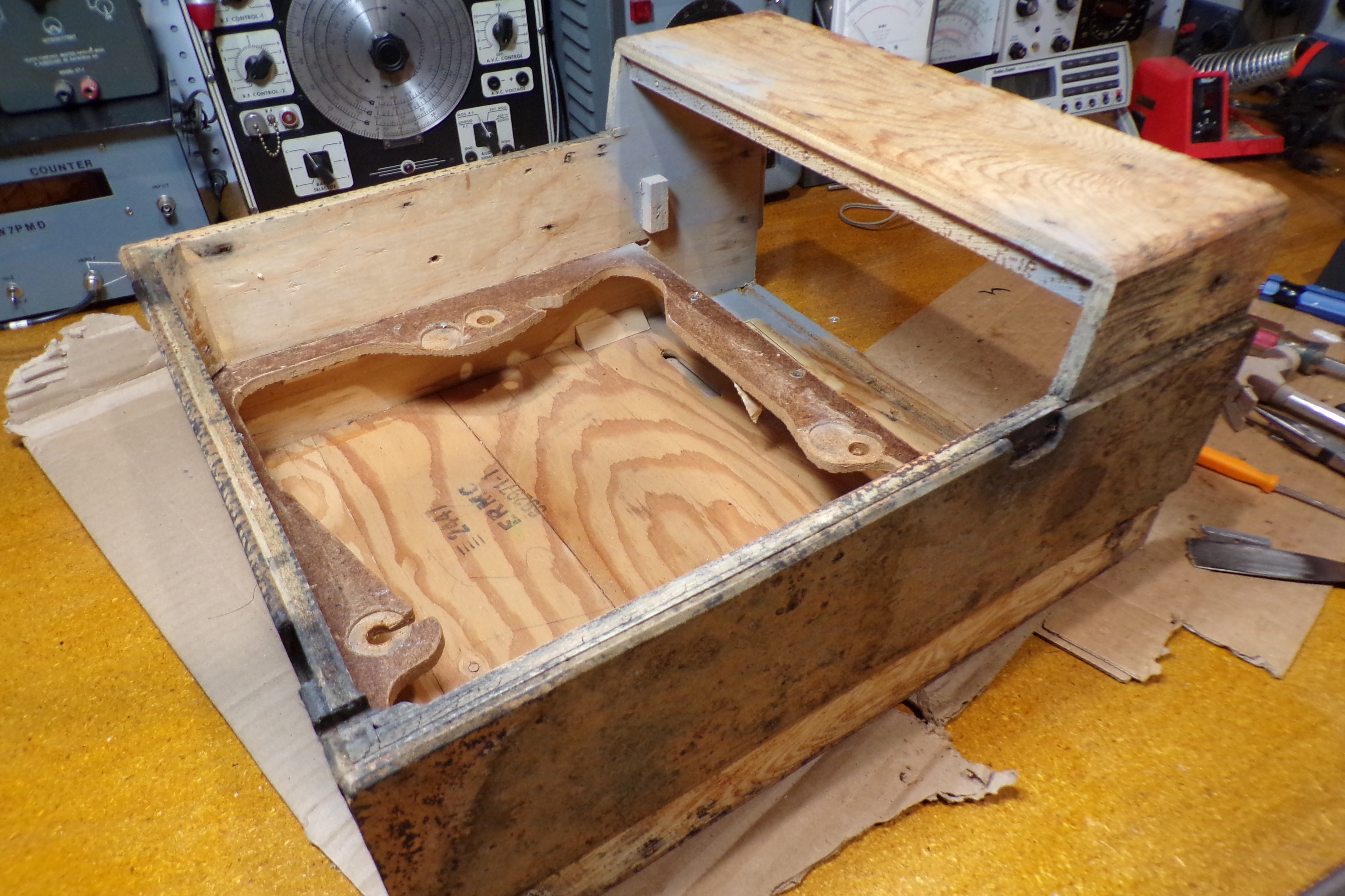

I look forward to this being done. It will be nice. This will be a "nut and bolt" restoration. I've taken it apart as far as I can. I always get a surprise when I restore something. The fasteners that hold the hardware on is the surprise in this project.
- Posts: 9028

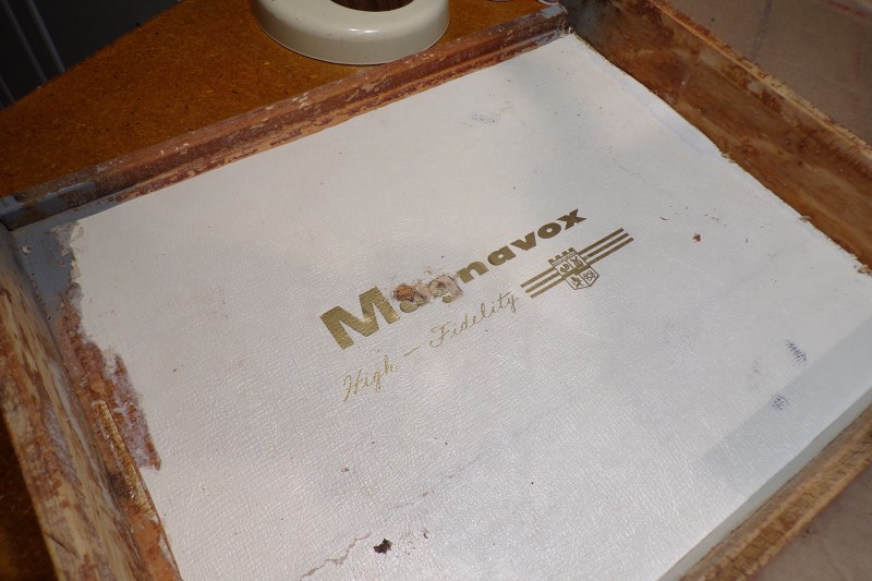

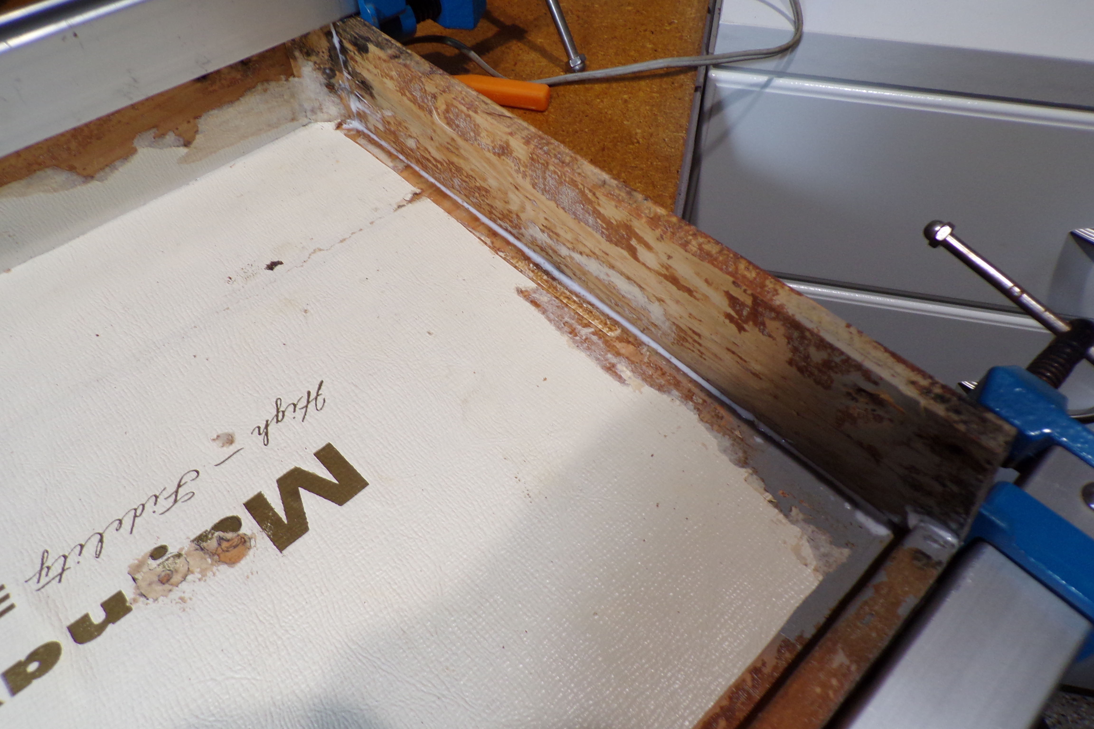

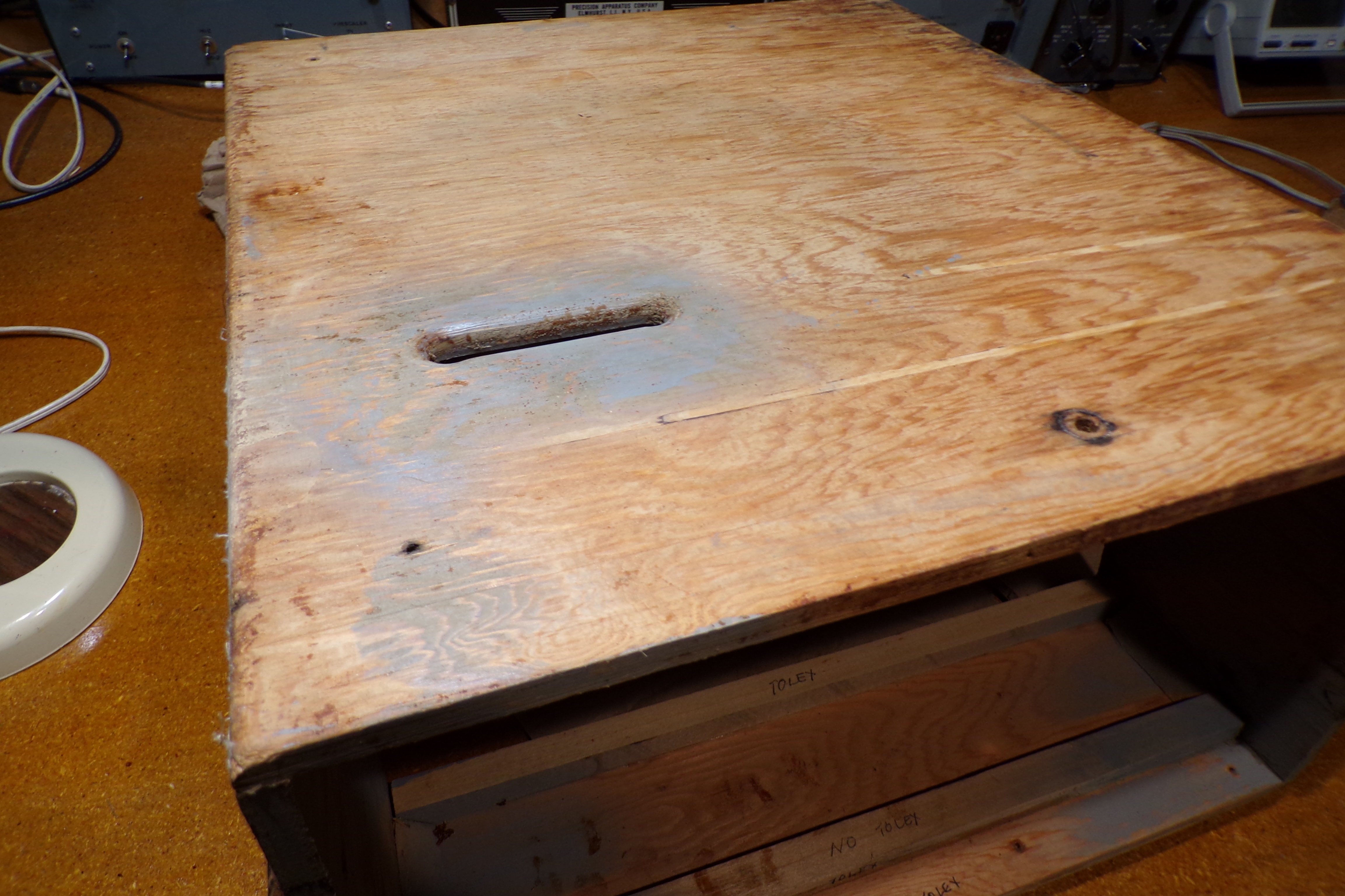

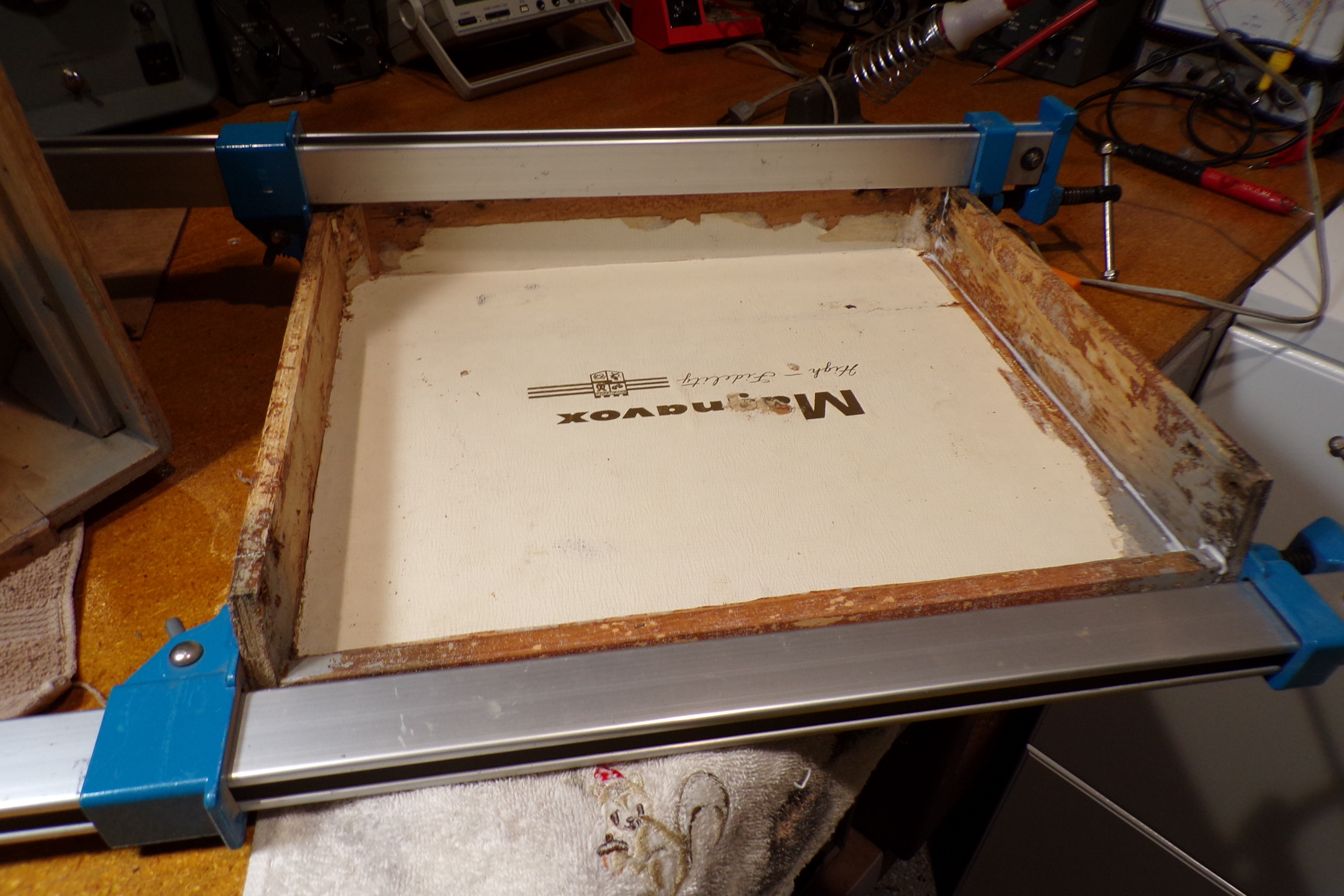

Here are pictures of the project. It doesn't look like much, but it is actually coming along nicely. I figured out what damaged the Magnavox logo in the lid. Someone did not lock down the changer that was not positioned correctly. The spindle on the changer contacted the lid and messed up the logo. It went all the way into the wood.

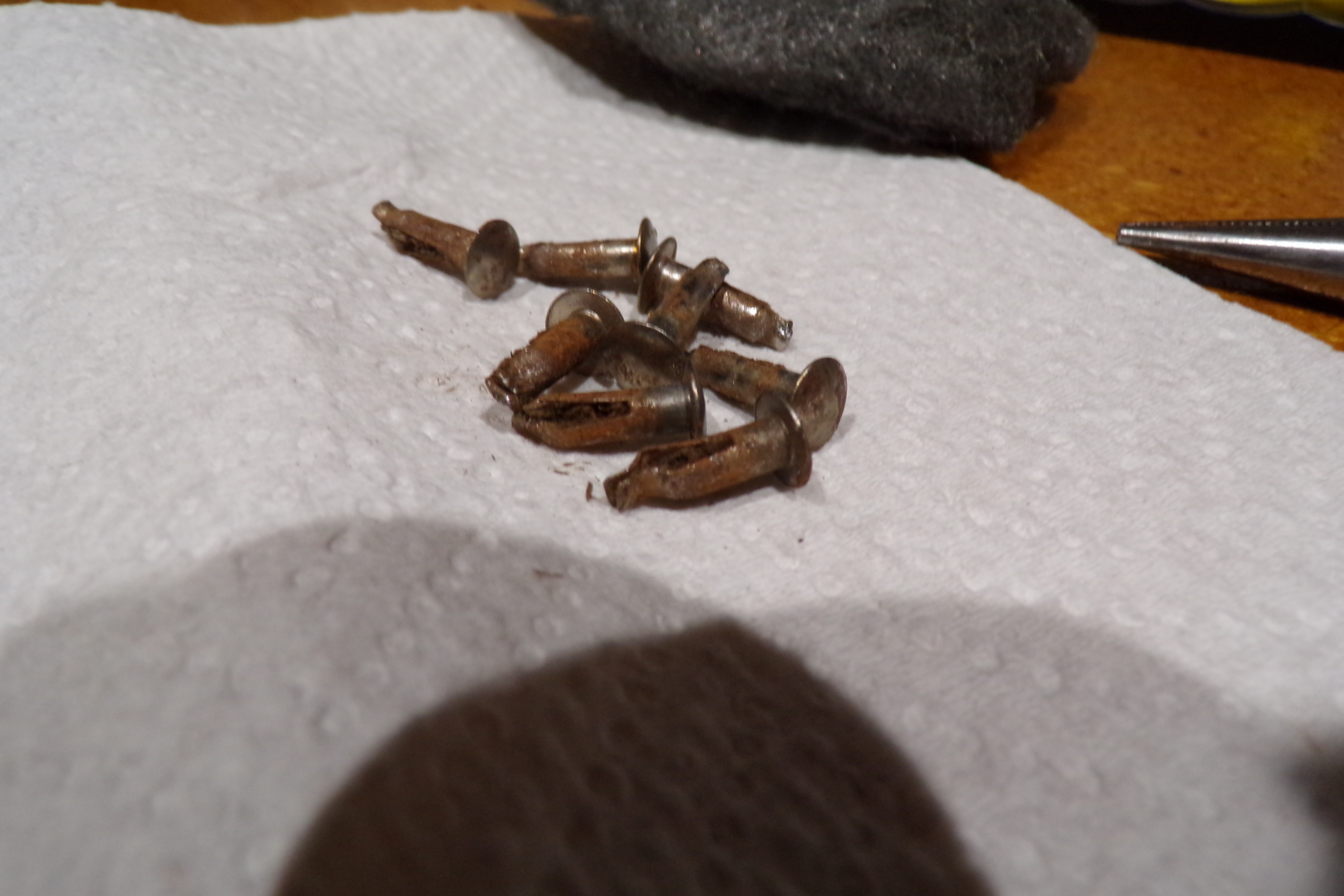

I always referred to them as blind nuts....Are you taking the legs off as well?... they are just nailed onTC Chris wrote: ↑Sat Oct 15, 2022 4:15 amThreaded inserts. I was laughing. As soon as I saw your question, I forgot the answer, Then it popped back.electra225 wrote: ↑Sat Oct 15, 2022 12:05 am those little ferrels that have barbed threads on the outside, with threads for screws on the inside. These will go into the wood case in the original holes. I forget what those things are called.
- Posts: 9028

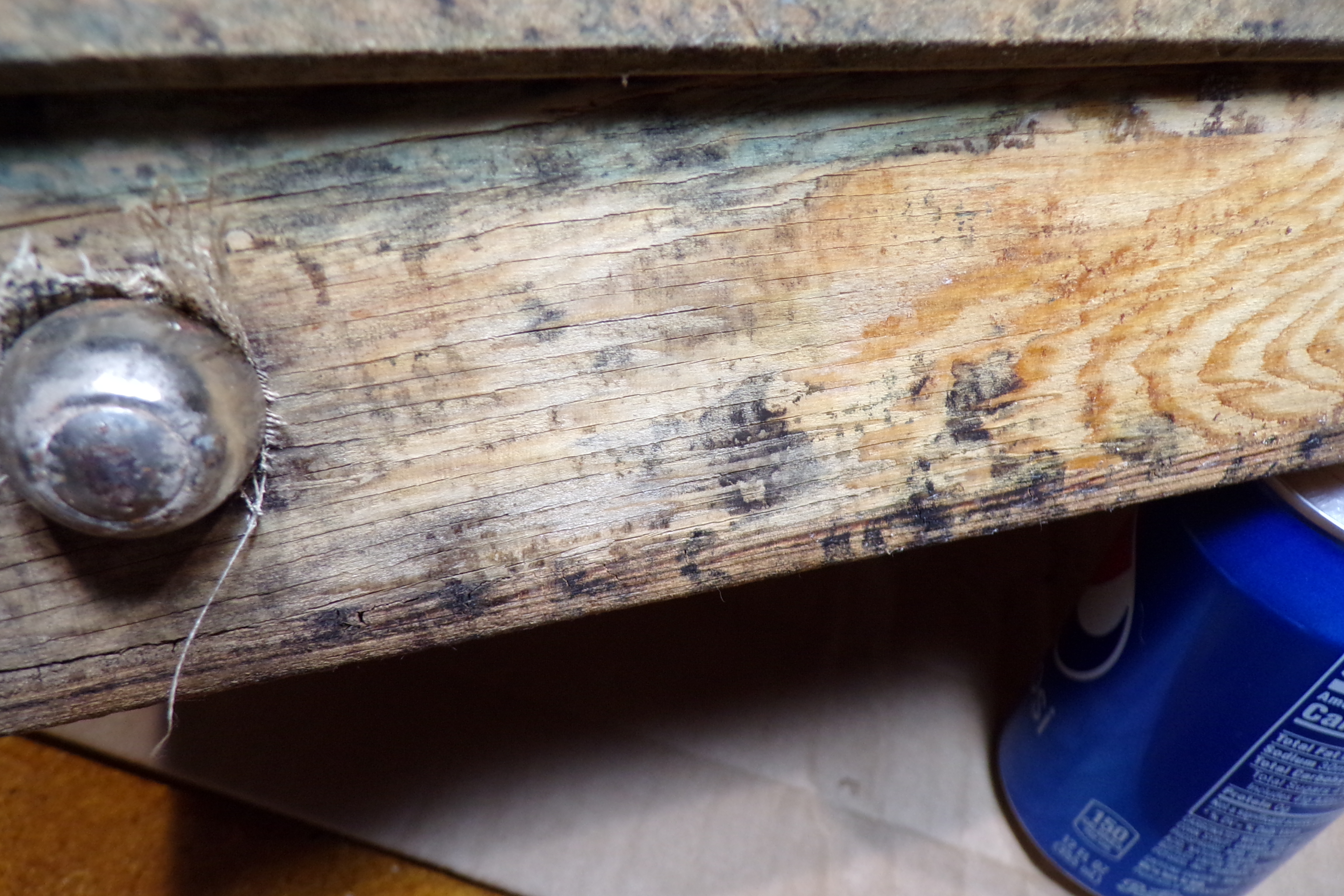

I have the chrome parking bumpers off. They use those rivet-looking.things for attachment. I plan on cutting the ends off, then glue them back on. I mooched a set of wood clamps so cabinet gluing may continue....

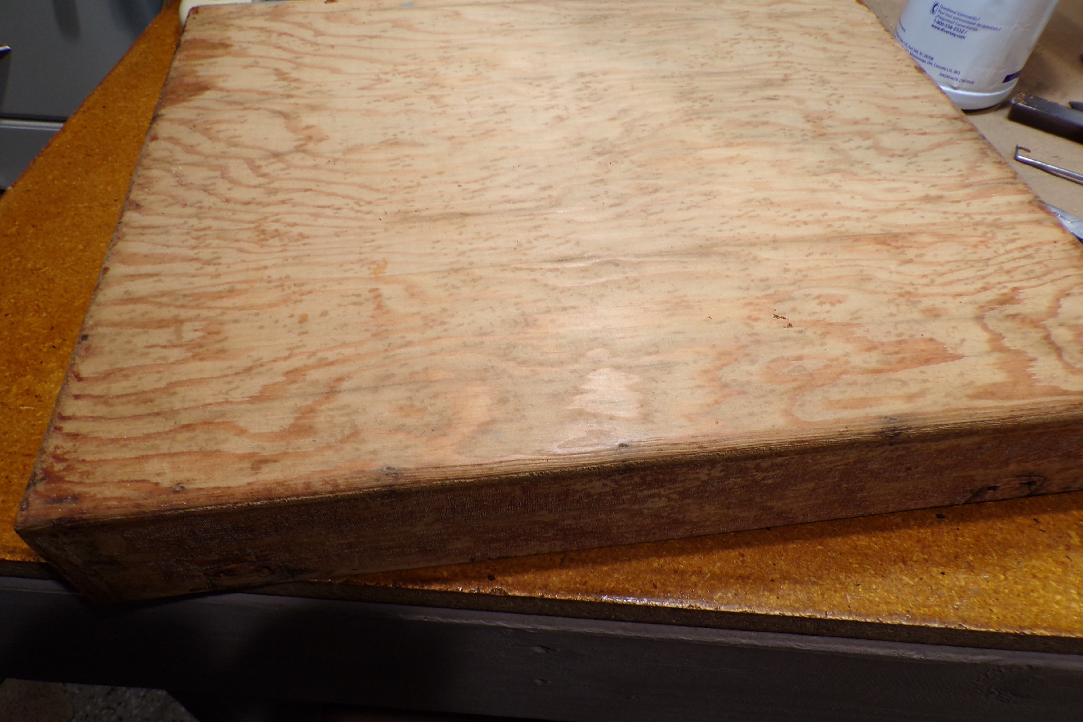

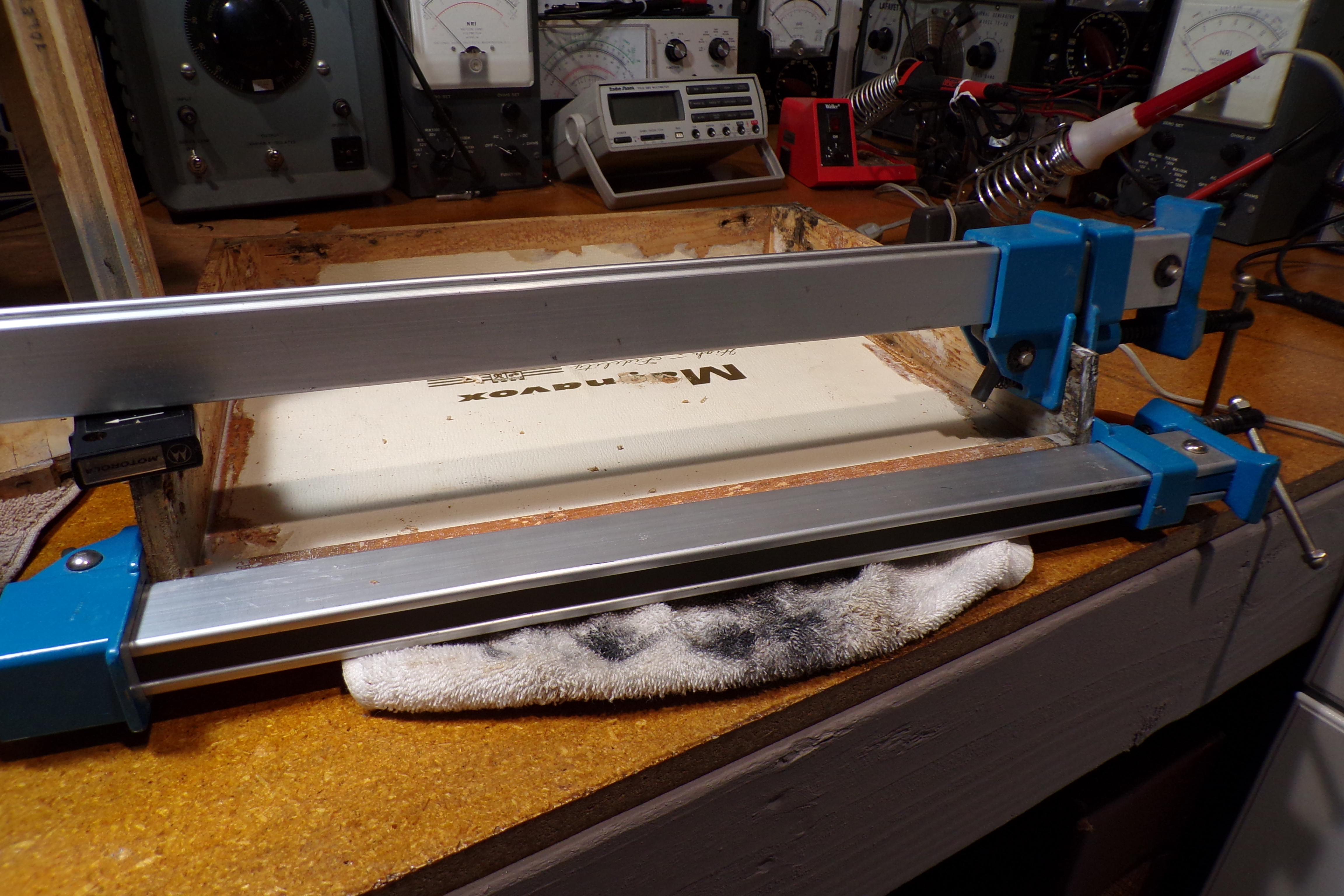

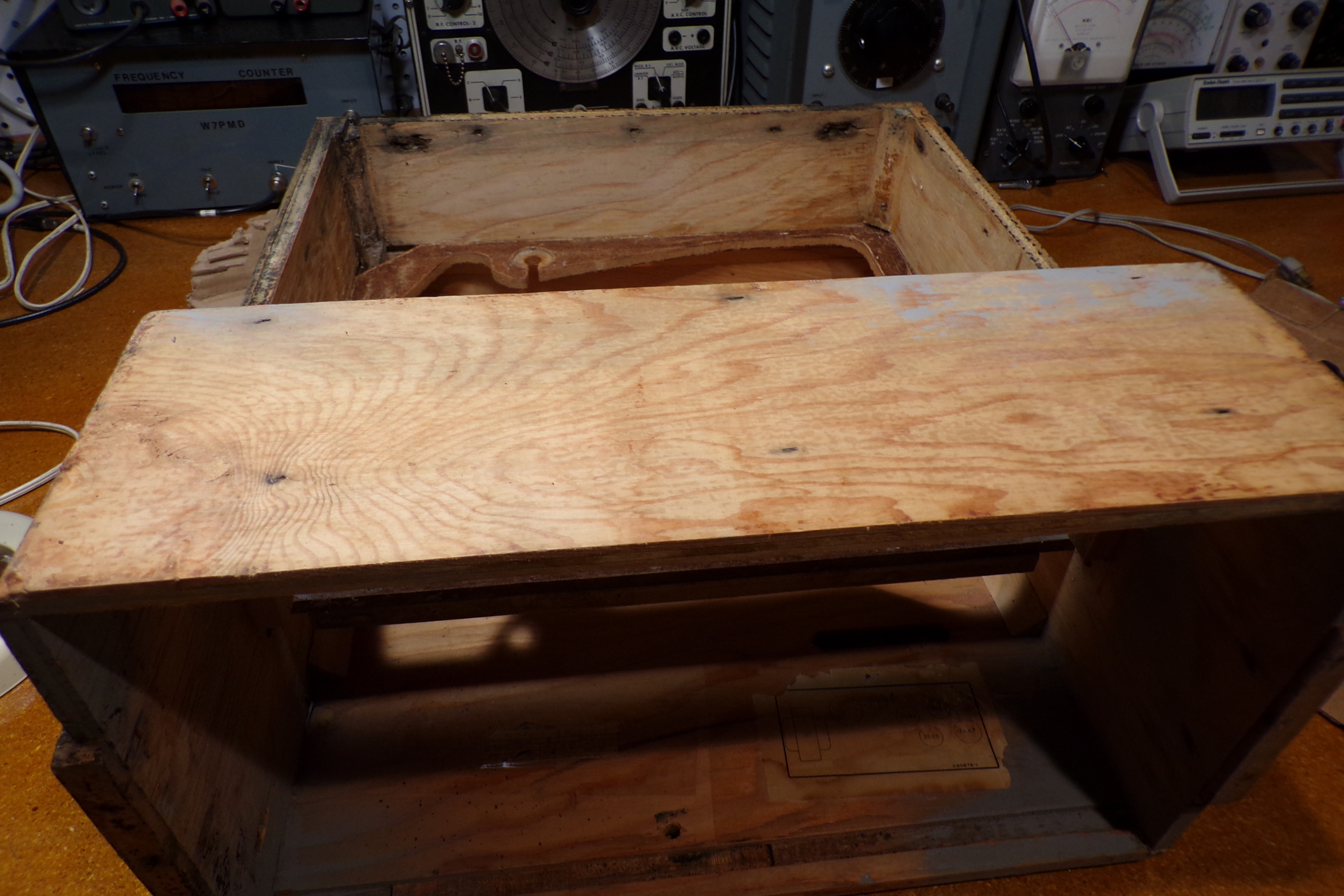

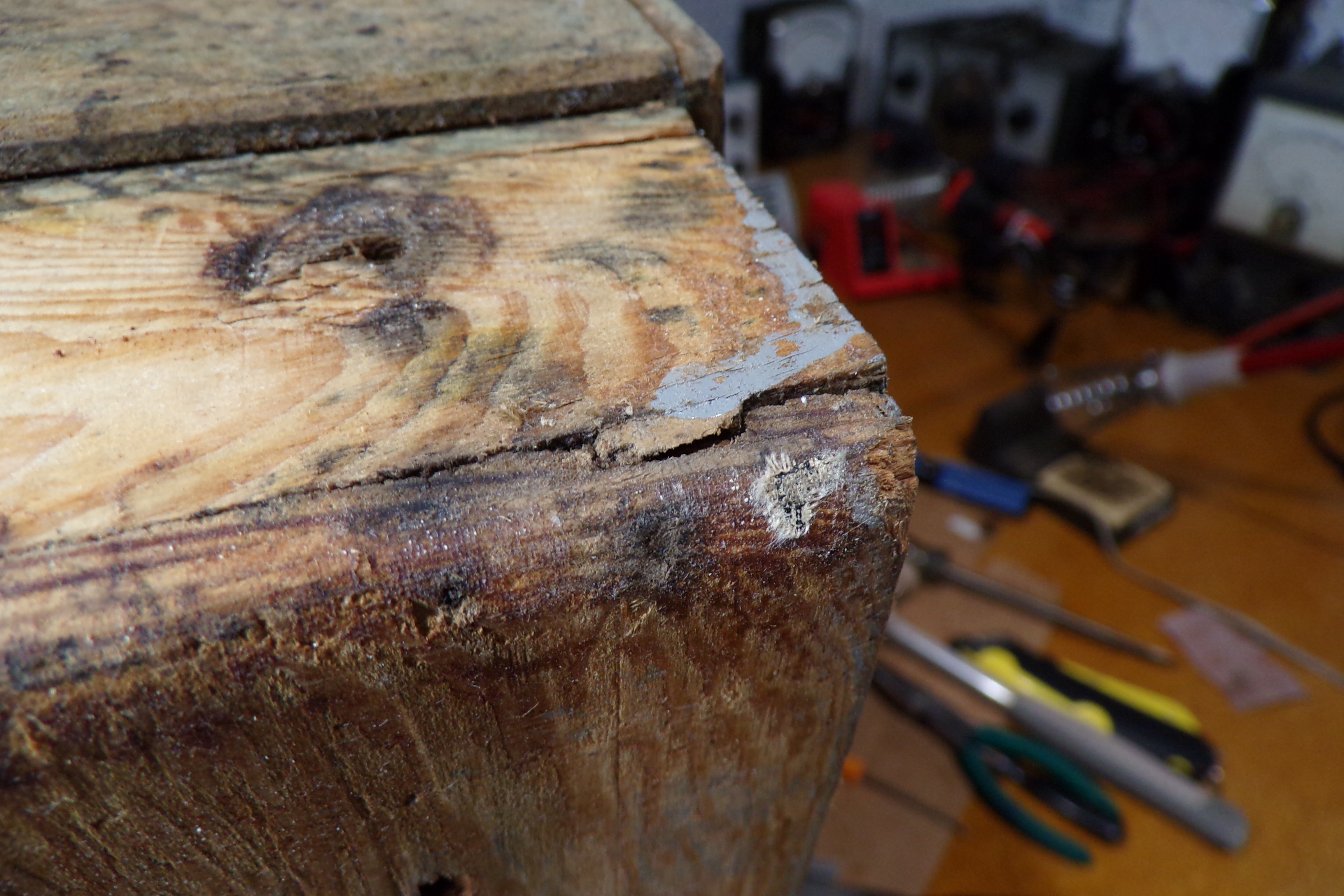

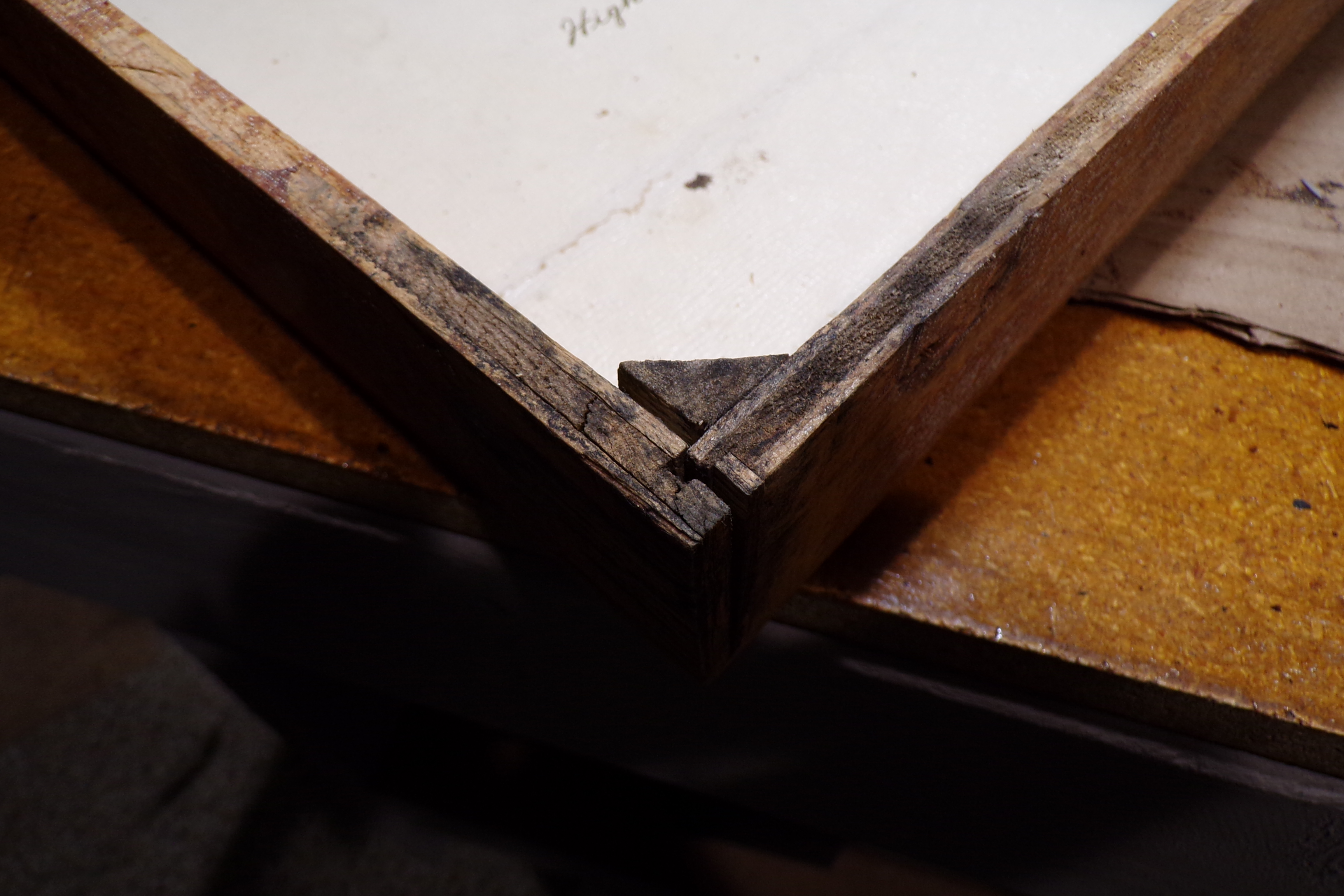

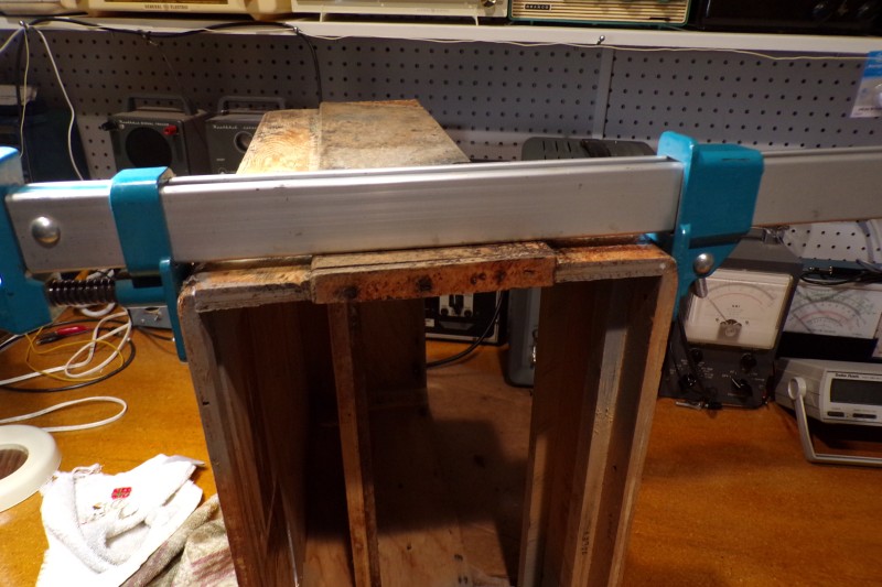

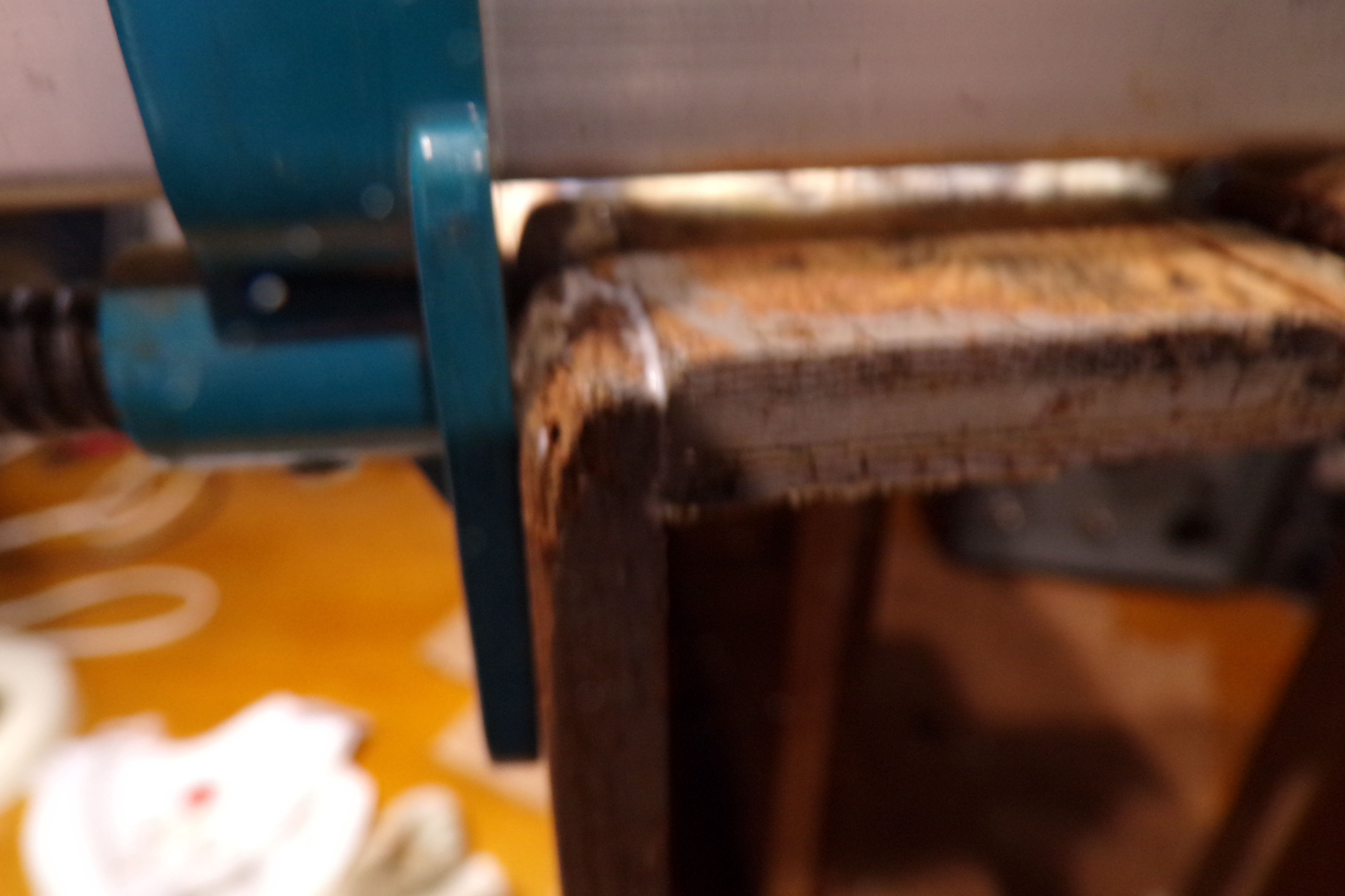

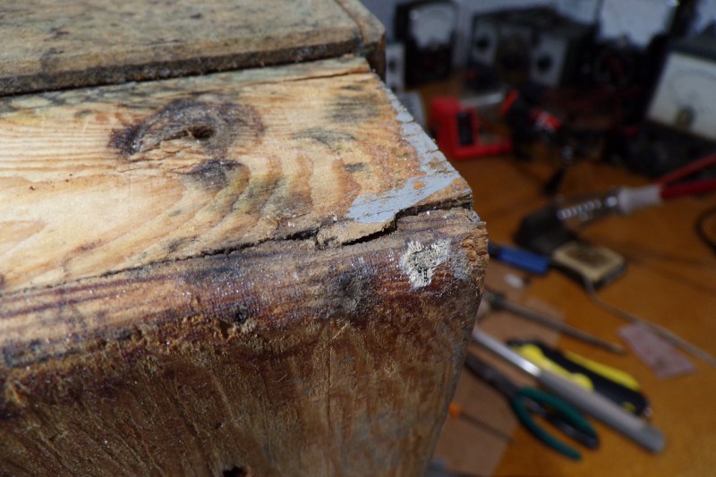

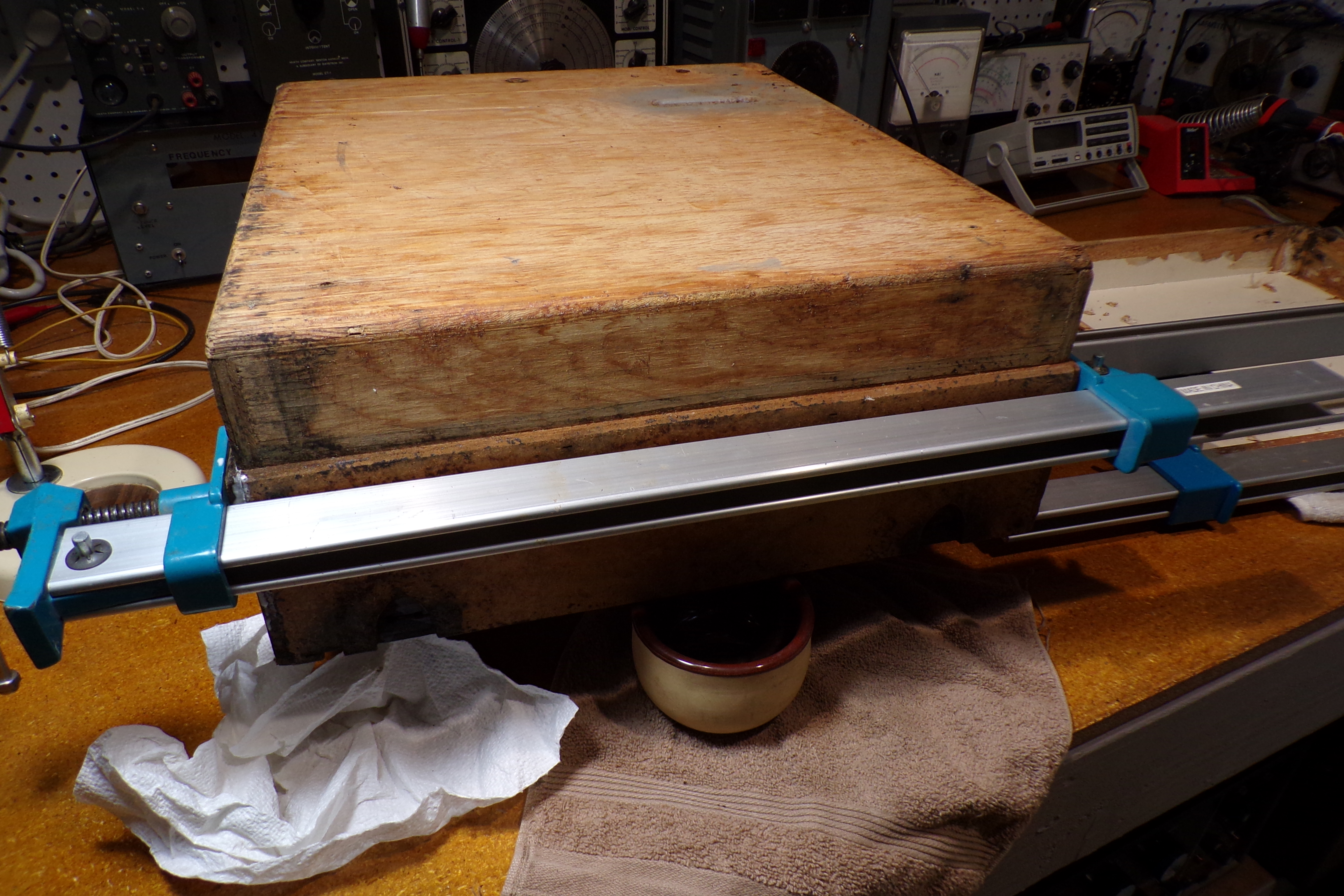

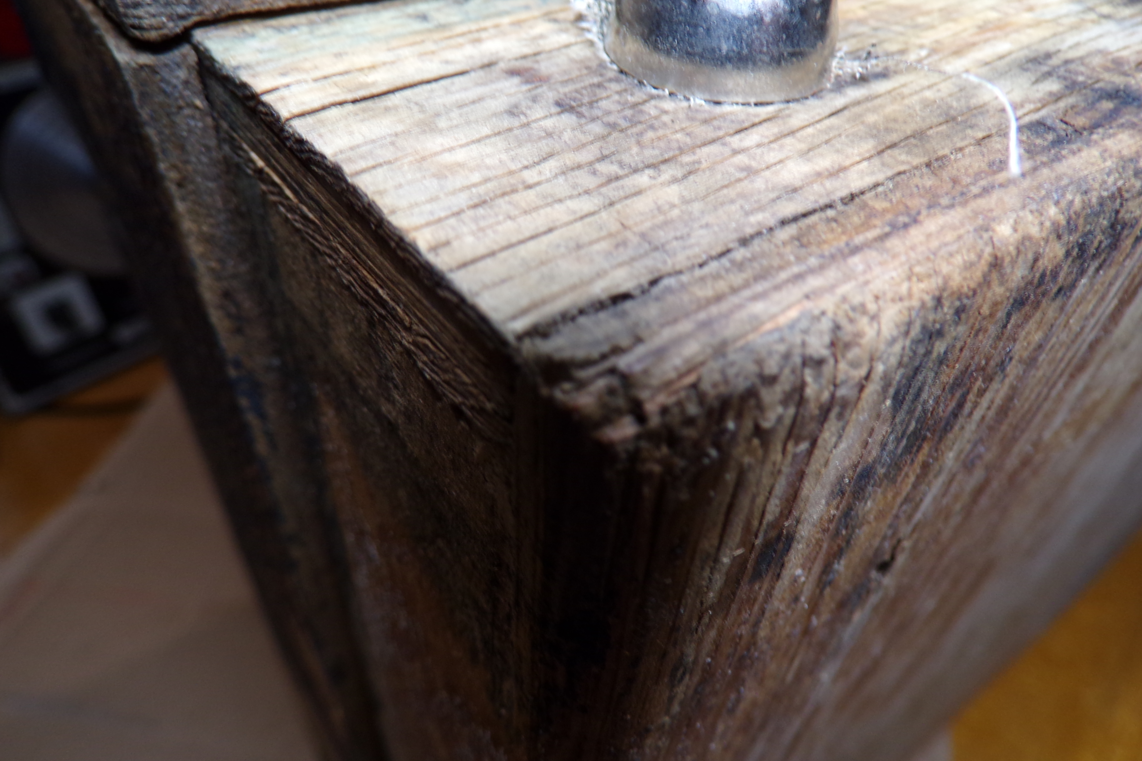

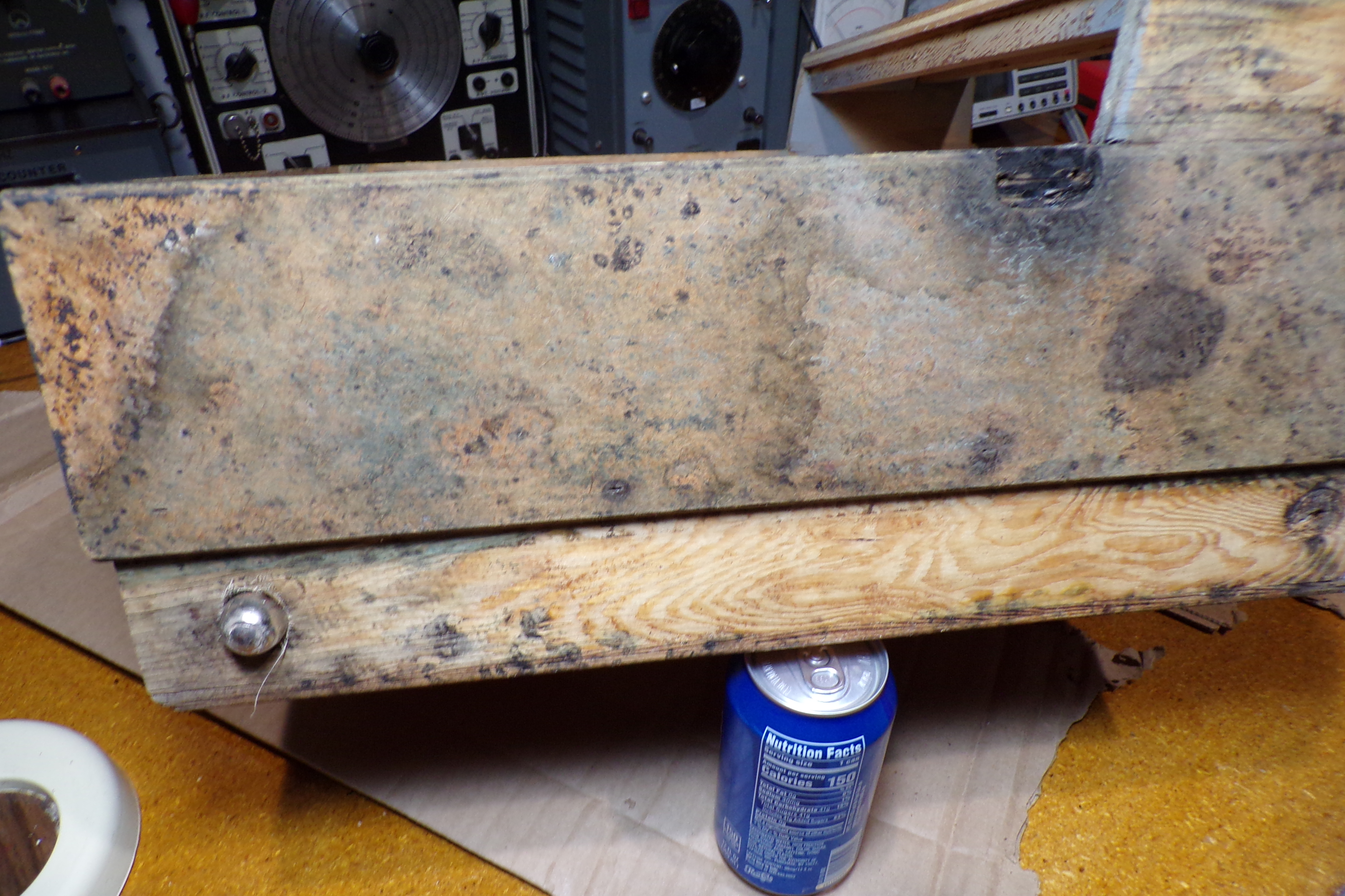

I've taken some photos of the clamping procedure. The water damage to this cabinet is more severe than I realized. There are several areas of delamination on the plywood, usually in the worst spots for structural integrity....

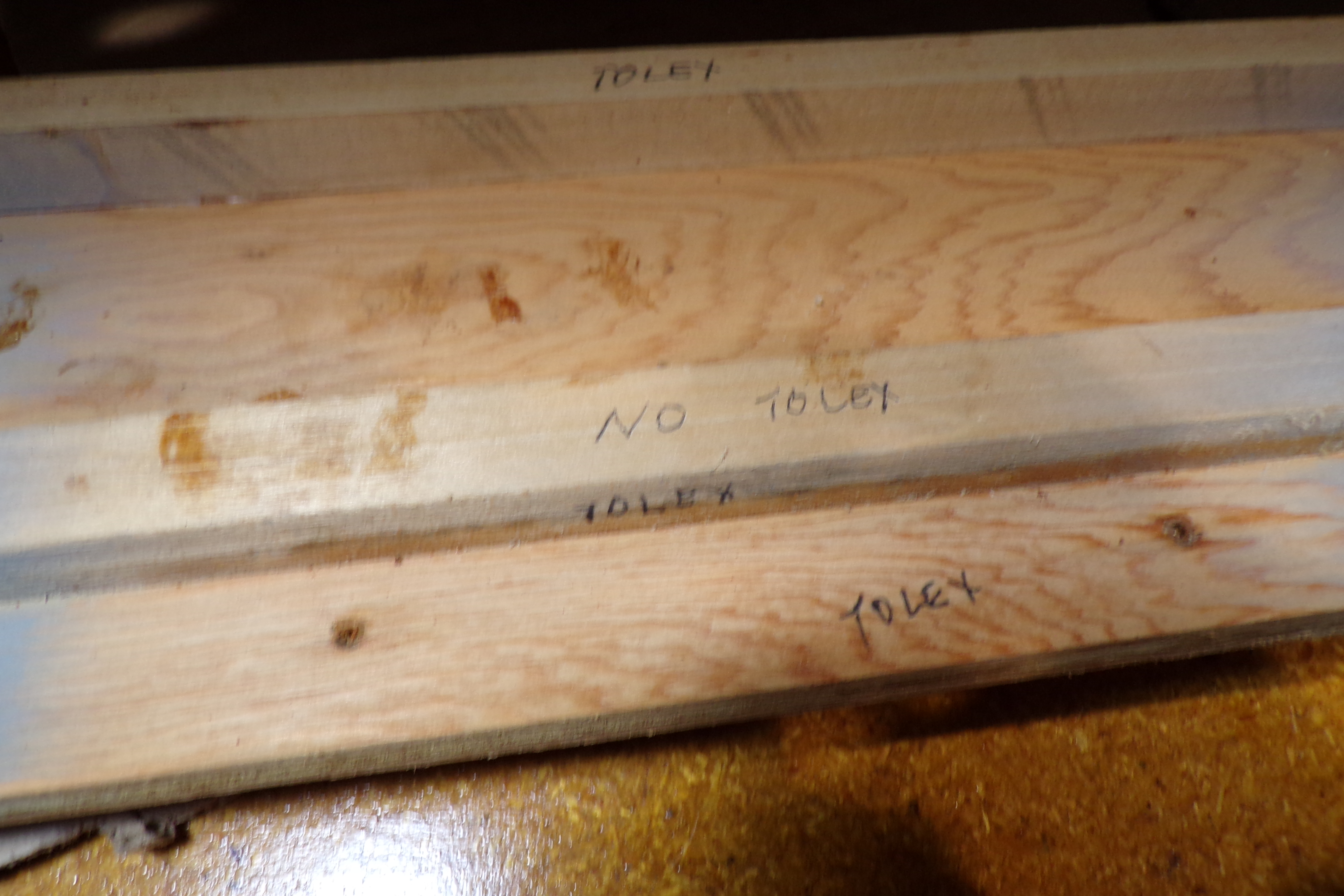

Unless I find something else after the adhesive dries overnight, the next step will be filling the imperfections in the wood that may show under the new Tolex. I will need to repair at least three of the corners on the lower cabinet. They used brads to hold the bottom of the cabinet to the sides. Moisture has removed the glue in those areas, so I'll fill them with body filler. It's a good thing they don't use horses to make glue. Animal glue which was probably used in this cabinet is extremely sensitive to moisture.

The material and the adhesive on the inside of the lid is different than that used on the outside. It is similar to wallpaper. It is really stuck well. Water loosens the glue, but it dries fast and just balls up and makes a mess. I am going to try 91% alcohol to see what it will do. I have worked all afternoon trying to get as much of the glue off as I can. I can't do the entire lid since I need have the decal repopped. The material on the outside appeared to have some fiber in it. The material on the inside of the lid is just paper. I believe I am close to being ready to sand.
- Posts: 5462
Those are fancy looking clamps you are using. I have never seen ones like that before. It's looking good Greg, keep up the good work.
- Posts: 9028
Those good-looking clamps are borrowed and are from Harbor Freight. They were exactly the perfect size for the job. I shall extend your kind words to him from whom they were mooched, er, borrowed.......

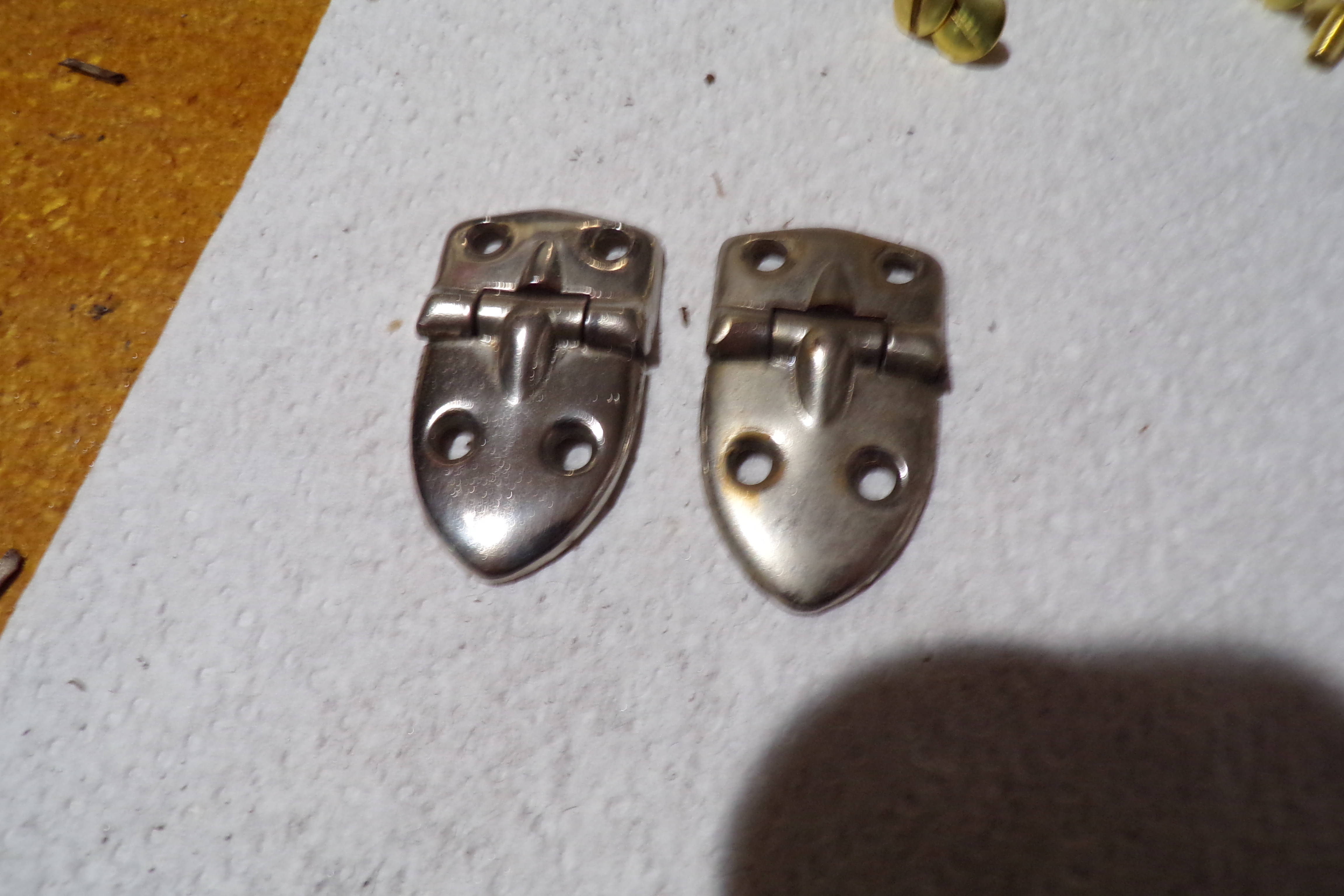

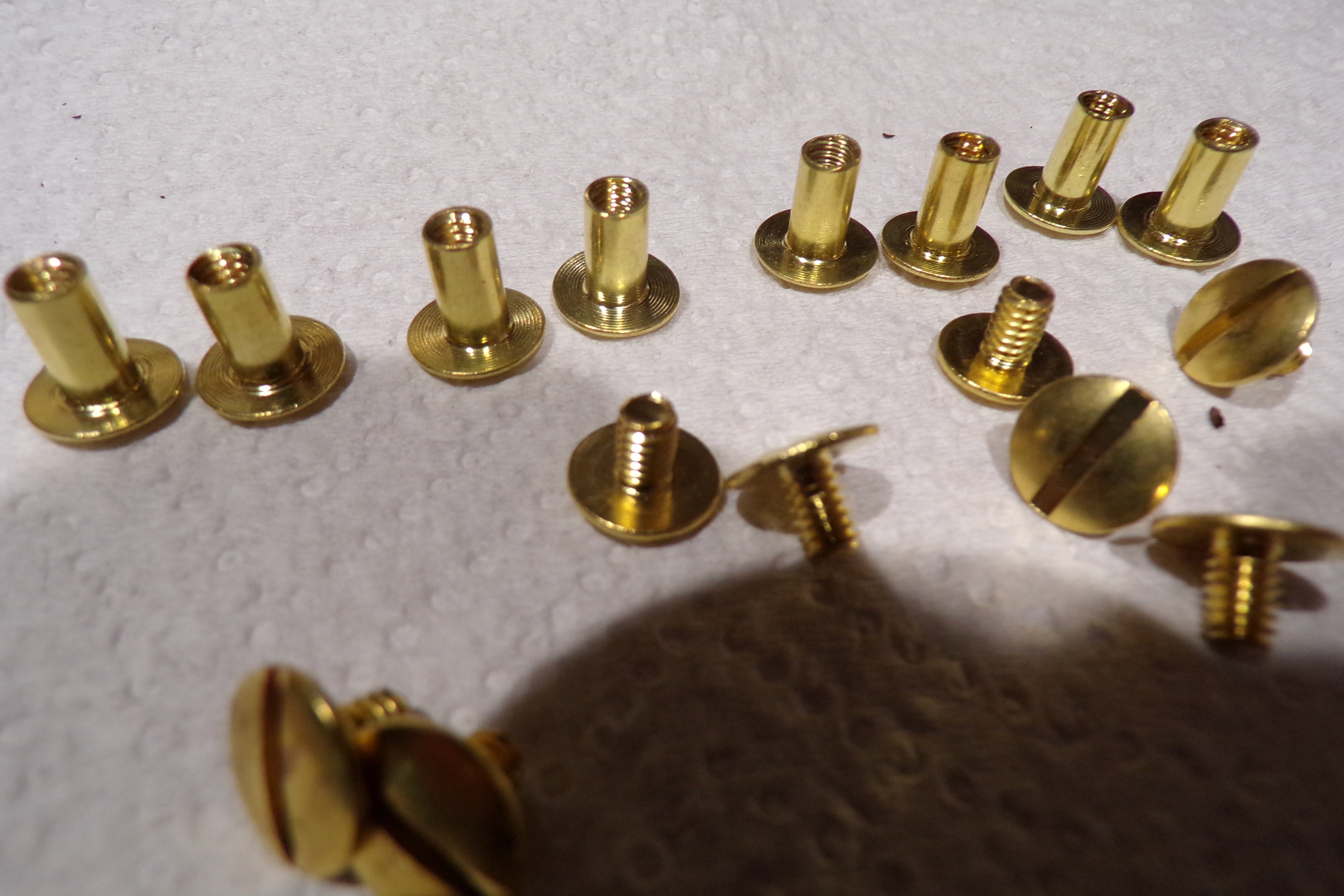

I may have found fasterners for the lid hinges. We have the best hardware store on the planet only five miles north of here. If they don't have it, you don't need it. I found some threaded ferrells that had a flat surface that will keep from pulling thru the cabinet. I could also get the original fasteners they called split rivets. Finding someone to reproduce the decal in the lid is another kettle of fish. So far, no joy. The lady in Missouri who made decals for me ran a T-shirt business. Maybe I need to find a T-shirt shop and talk to them.

That is my next job. The plan right now is to remount the hinges so the fasterners will stay in place while I fill the damage from the original rivets. When I get the damage fixed, I can remove the hinges and the bolts, then the fasteners should stay in place so I can mount the hinges when I get the Tolex on. I may use these things on the latches as well. The holes in the cabinet are just a fuzz smaller than the fasterners. I'm not sure what I want to do about that yet. I didn't want to drill the cabinet holes bigger. I will gladly share pictures with the forum. Stay tuned.......
Yesterday, I couldn't talk anybody into making a decal for the lid. Today, they are burning up my email inbox with offers to help. Stay tuned, this may work out yet.....
I have bought many a tub of Bondo for less than $5 in my lifetime. Now, the cheapest I've found it, at Walmart, is $13! My budget for the restoration of this little record player was $200. Let's double that. And that doesn't include any labor, that is just material cost. This thing is going to cost as much as a stereo console to restore and do it right. I'm doing this like I'd do a Packard, I'll admit that. I could have skipped/skimped in a couple of steps. I want this to be a nice one. I don't care if it takes all winter, I want to do my best on this.

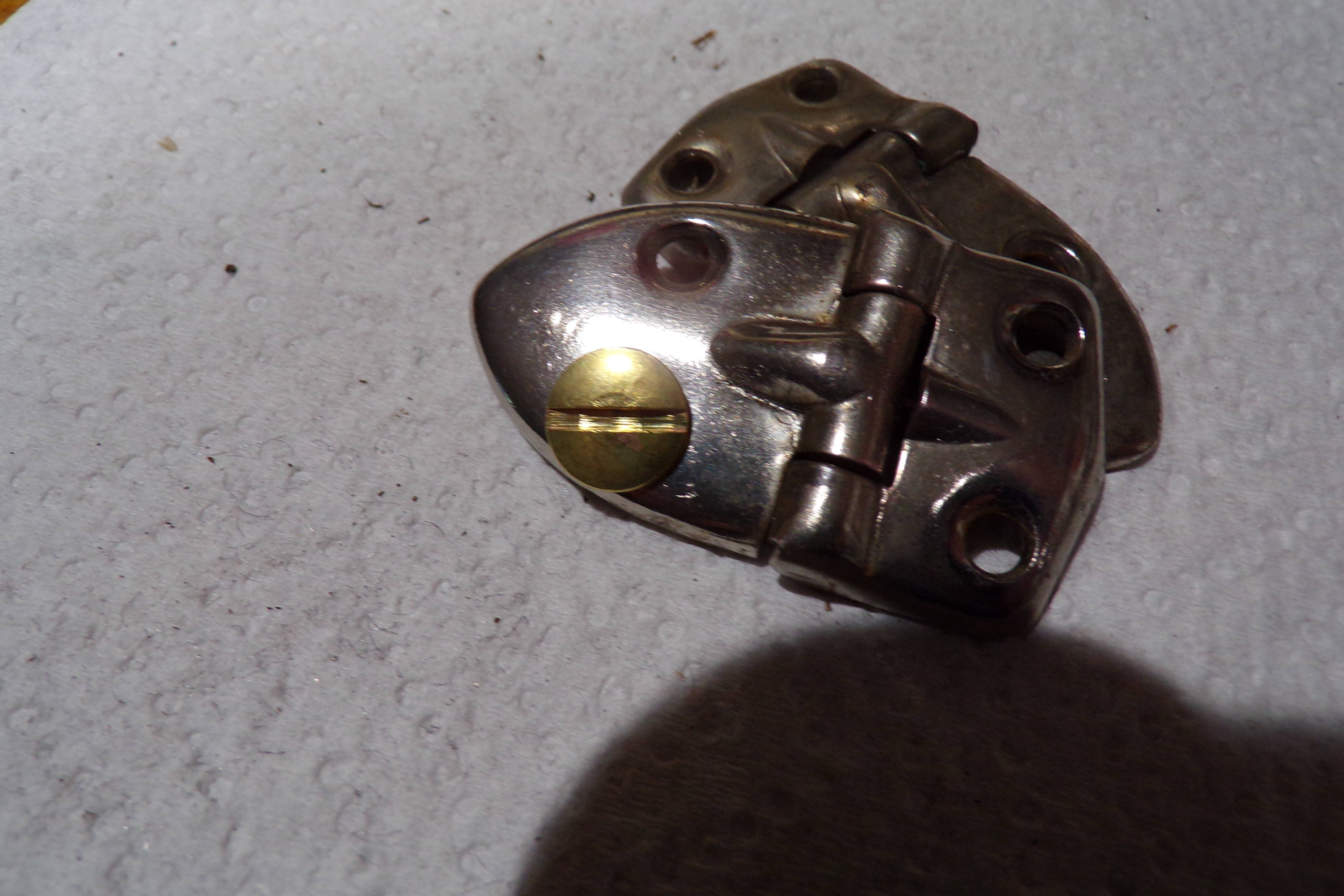

Life rather got in the way of me working on this much today. I thought I'd share these pictures. One shows the brass fasteners and the matching bolts. They came as a set, but I will use silver colored bolts during final assembly, preferably with tapered heads. They are a common size, 8-32, so I should have options. One picture shows a hinge I started polishing with Simichrome and 0000 steel wool. One pic shows the original split rivets.
