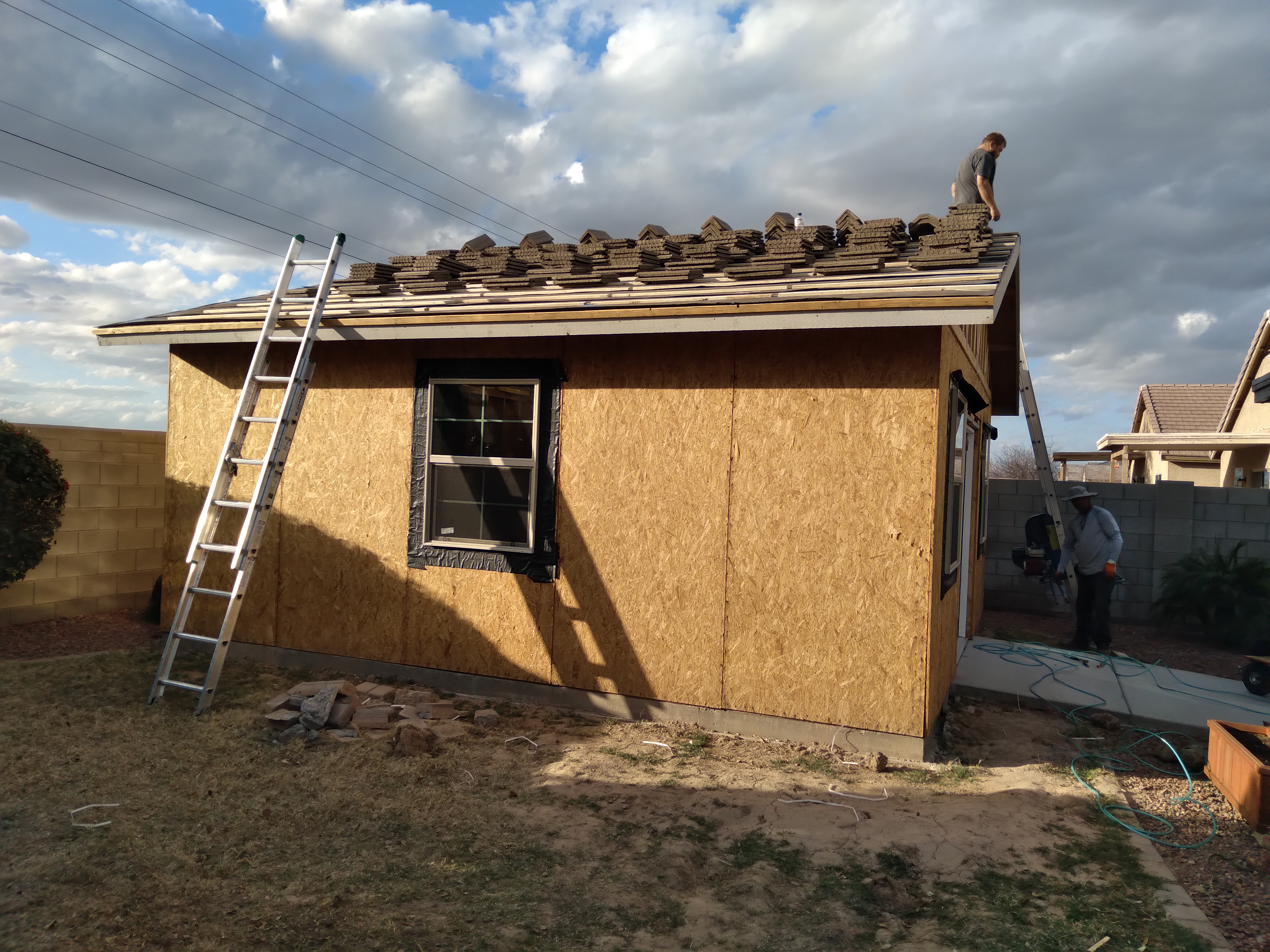

They came today to put the lath on the roof and to load the tiles. They roofer says there is a little over 7,000 pounds of concrete tiles on that little roof. He said the tiles on the house weighed over 25,000 pounds. I reckon the reason buildings with tile roofs don't blow away is the roof holds them down. It has to set like that two weeks. Then the inspector comes, notices whether the building has fallen down or not, makes appropriate notations on the permit, and away we go.....

Now we know why they used 2X6 trusses set 24" on center. These trusses are free-spanned to allow for the storage upstairs. The windows still open and close as does the door, so I reckon it hasn't caved in yet. I don't hear any creaking or noise like something isn't happy. I wonder if the concrete tiles are heavier than the red clay tiles.
Found this online:
There is a significant difference in the weight of concrete and clay tiles. Concrete tiles weigh almost 40 percent more than clay tiles. While concrete can weigh anywhere from 820 to 1,100 pounds per 100 square feet, clay only weighs about 600 to 650 pounds.

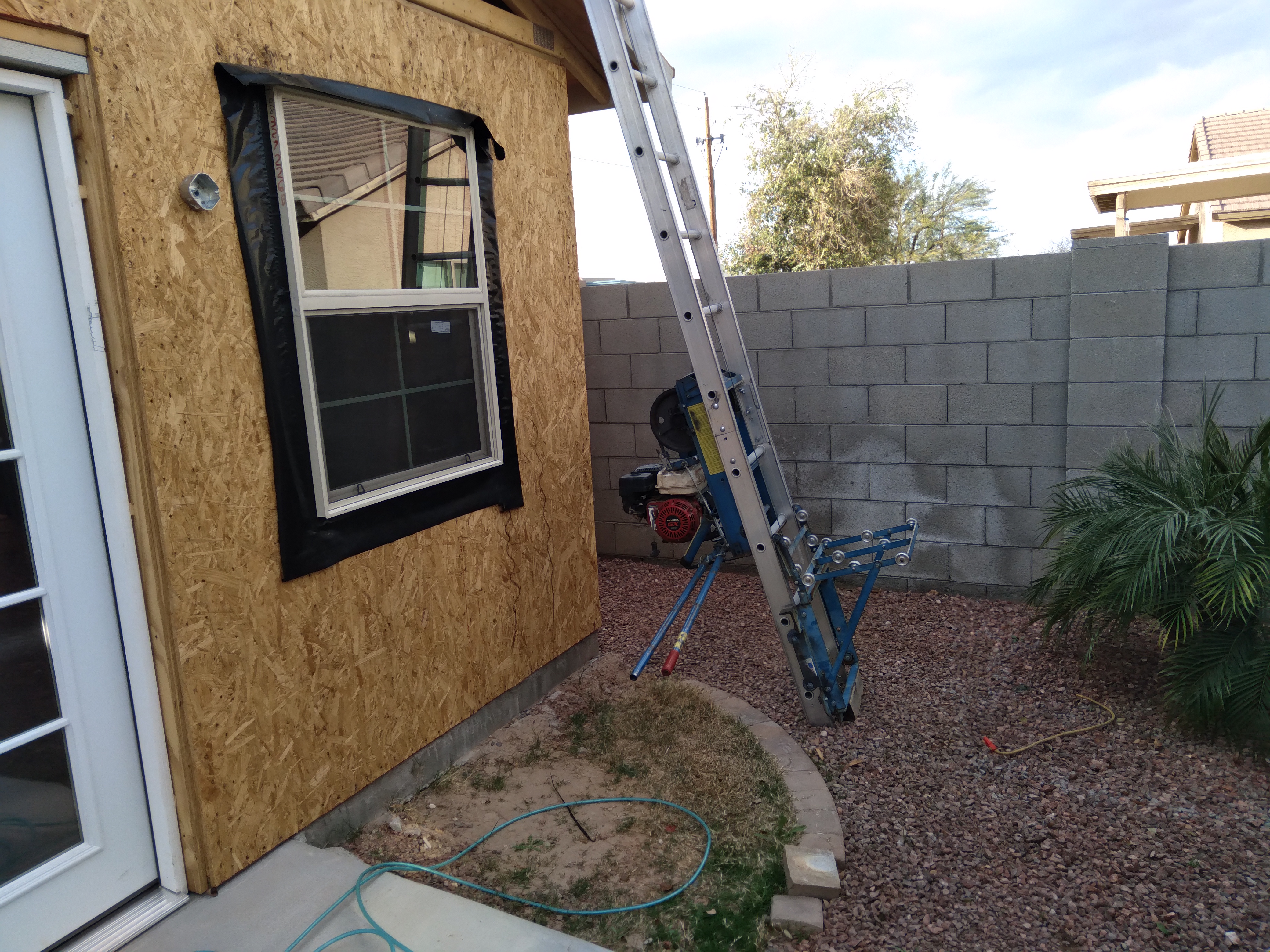

Per the request of one of our long-suffering Global Moderators, here are some current pictures of the shop project with it's 7000 pounds of roofing tiles. The second picture shows the contraption they used to load the tiles to the roof. They took the tiles out of their trailer, loaded them on a cart with inflatable rubber tires then hauled the tiles to the back yard. They used the blue contraption to raise the tiles to the roof. It is attached to a 12' extension ladder. Powered by an ill-running Honda GX 120 engine, it powers up while winding a spring. Going down, the spring and gravity return the lift contraption to the ground. I wondered how they did that, I'd never seen it done before.

Finally! This is the tile lifting contraption they used.
