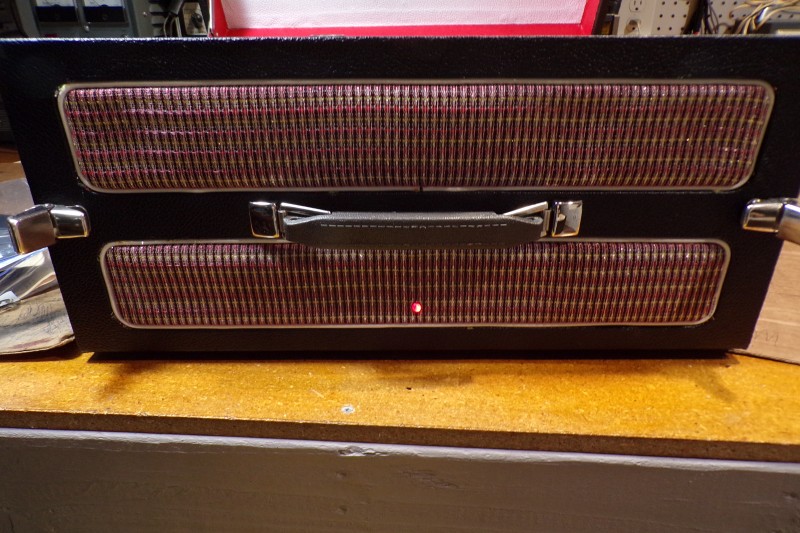

That little red indicator light is its connection to Magnavox..... ;) :roll: :lol:
How do you like the electrical wire I used for piping in the main cabinet? The wire I used housed telephone wires. I removed the wires and just used the empty jacket. It worked out really slick, easy to work with, hard to damage, lays out really nice. ;) :o

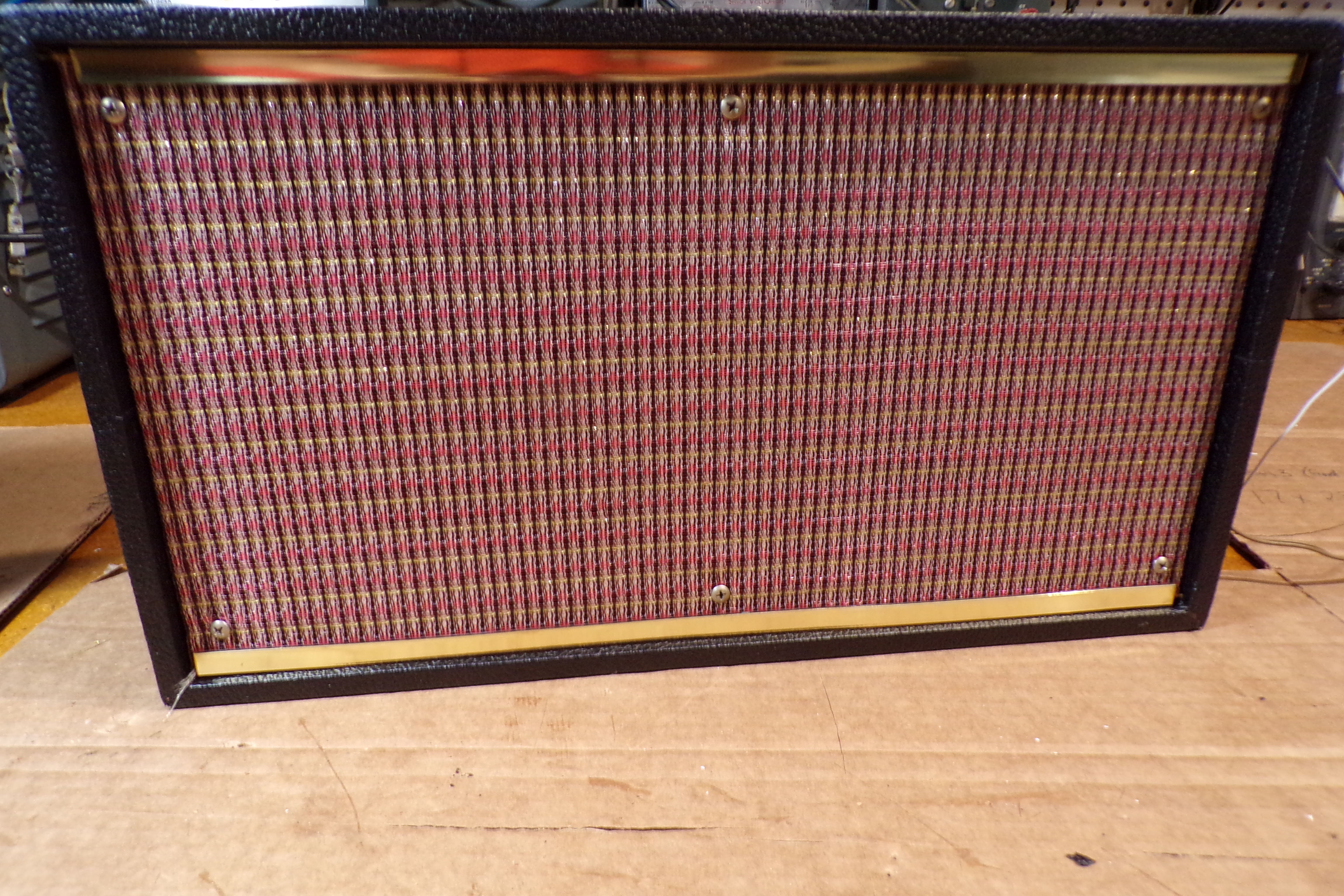

The left speaker box is almost done, just needs hardware.

Looks good, and I still really like the grille cloth.

I will let you in on a couple secrets. First, if you work with Tolex and if I work with it in the future, use contact cement rather than water-borne Tolex glue. First, it sticks better, it will stick Tolex to Tolex and the corners don't roll up. Plus, when you pull the corners up to remove the remnants, the contact cement stays on the wood, Tolex glue can lift, then you have to use Super Glue to fix that. You can use a hair dryer so it will dry faster. It is fumy, use plenty of cross ventilation. Concentrated fumes may make you high. Contact cement is cheaper than Tolex glue.
Second, the grille cloth I used is reversible. I used the back side out. The front side had too much gold and the pattern looked clunkier. The reverse side had more red and more white.

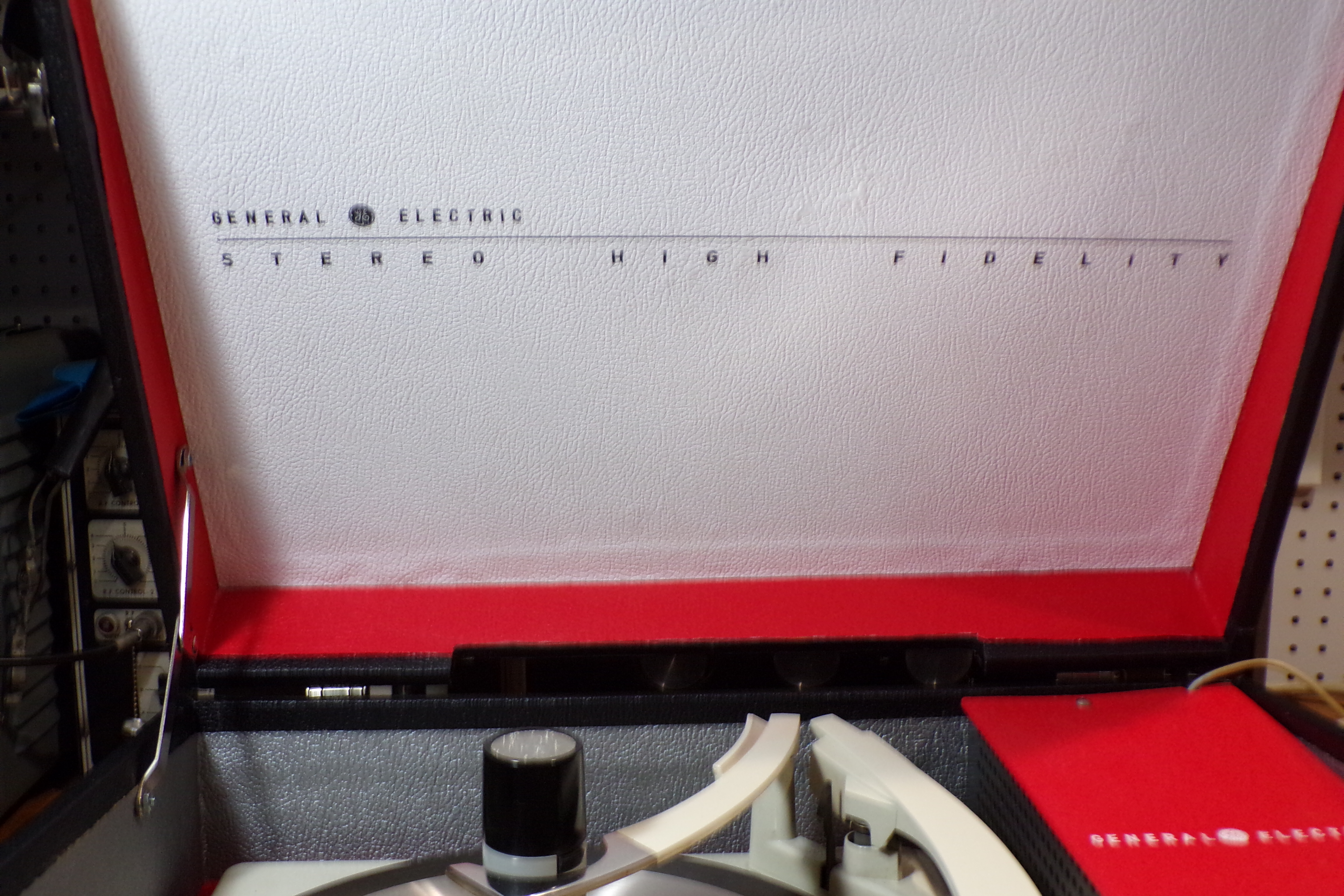

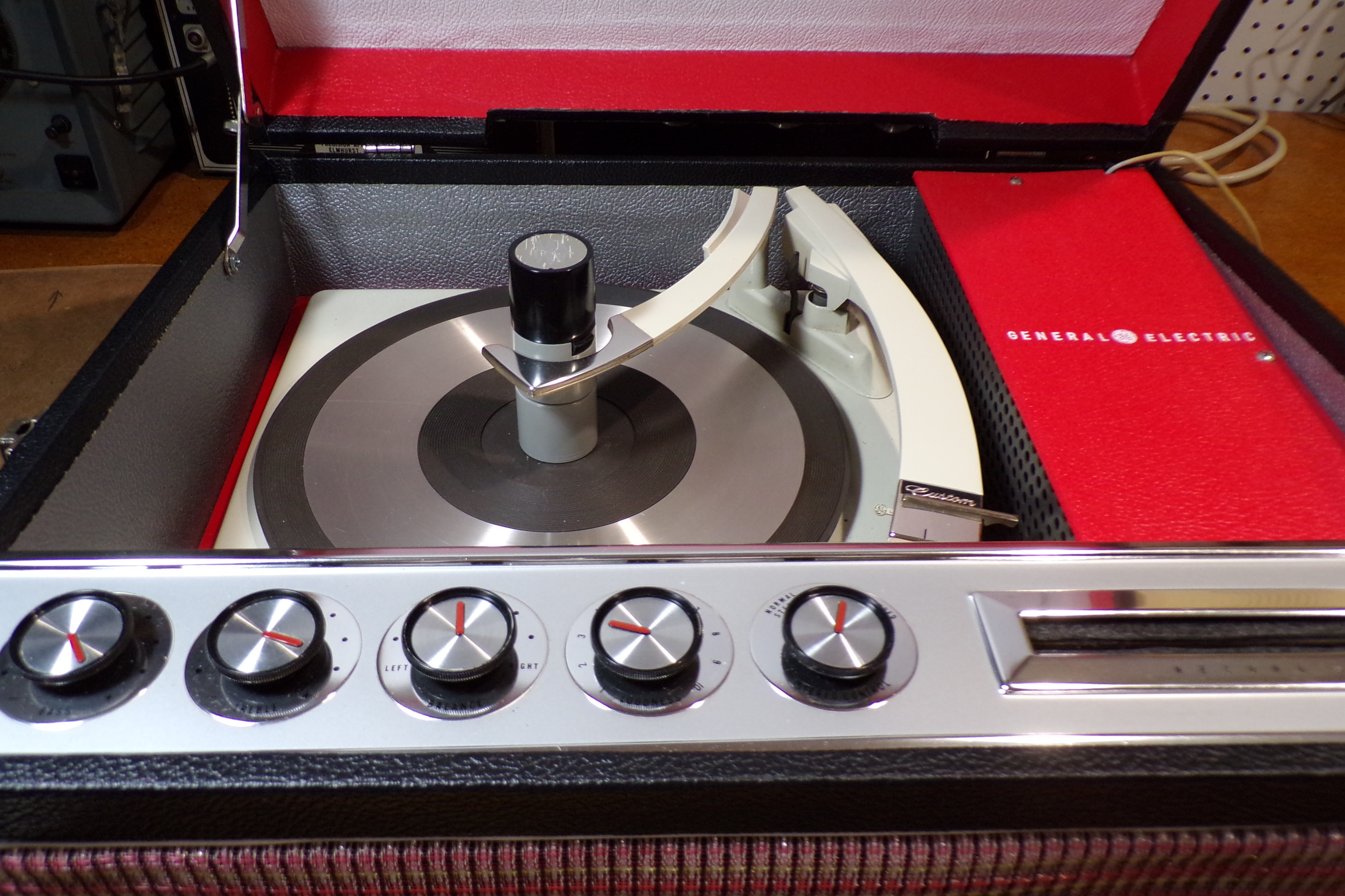

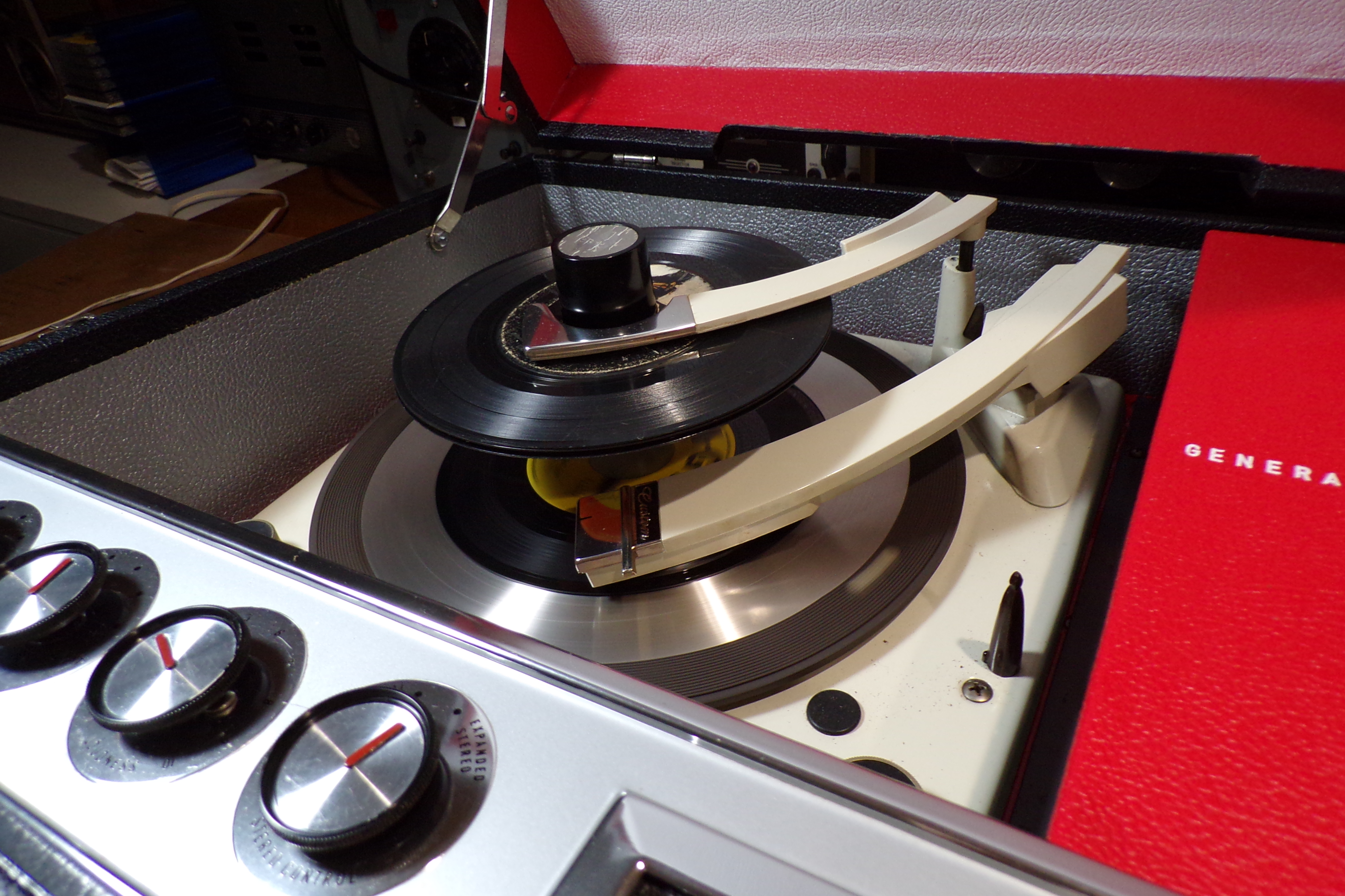

The main cabinet is done. I'm two screws shy, for some reason, so the RH lower lid latch is not on. It's not possible that I miscounted, now is it? Anyways, it is what it is. I wanted to get a picture playing a Connie Francis record. And with the little red pilot light on. This thing seriously needs a new needle. I've got a list going in to Gary that can cure the national debt....I'll give myself a couple days to get over the crud, then I'll get back on the other wing speaker.
