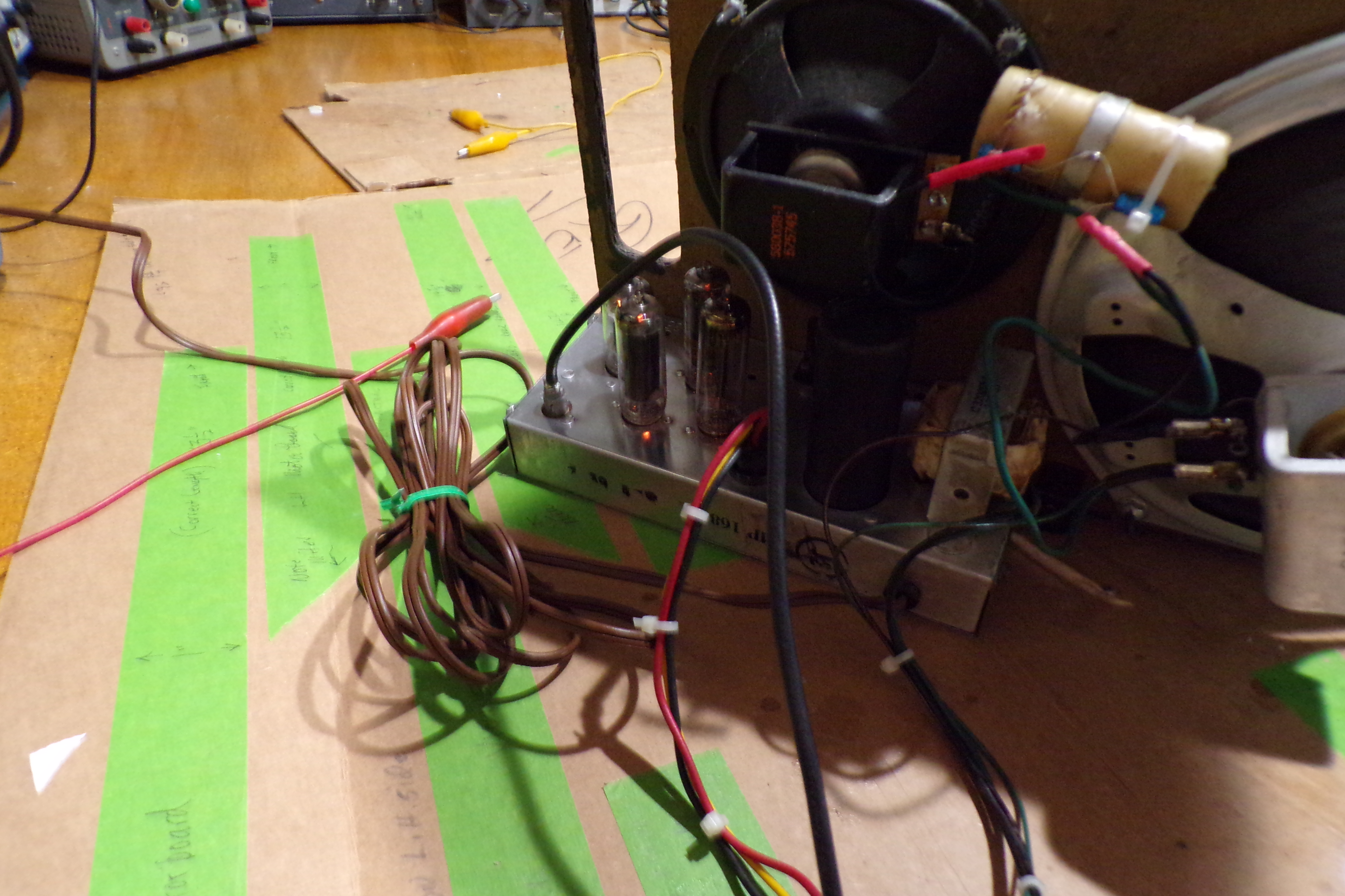

The power cord is stored in an area under the changer. If you put the whole cord in there, you have to fish it out. I'd like a bigger plug on the cord so that wouldn't happen. Also, I figured out why Magnavox didn't put grille cloth on the speaker board. The fingers from the Magnavox emblem would impact the cloth. So, if I use cloth, I'll have to put it on the grille, not the speaker board. The jury is still out on that. It would look better, but might be more trouble than it's worth.

Yes, that is about all. The speaker board is actually ported. You can see the tubes glowing thru the speaker grille. My plan is to put black grille cloth over the speaker board. The cone for the RCA radio speaker I am using shows thru the grille and looks ugly. It is dirty tan/brown. The original speaker has a black cone. I used some "gorilla snot" on the original speaker to see if I can get it to stop rattling. Better, but no joy, or not enough to put it back into the cabinet. I did it one more time. I'd sure like to have the original speaker in this record player. I played some 78's this afternoon. All I can tell you is that this little record player makes lots of good sound with P-P 35C5's. I'm impressed. The thing has bass like a 93 series, and that with an 8" speaker. I will need to remove the chassis from the speaker board, remove both speakers to put on grille cloth. I'm going to kick myself later if I don't do it. BTW, the Tolex is all done. I want to go over it well and put Super Glue on a couple spots the adhesive didn't get put on heavy enough. The next time, I'll do a couple things differently, but, over all, I'm happy with it. I need to go to the local Ace hardware and get some screws and things. They might also have paint that will work.

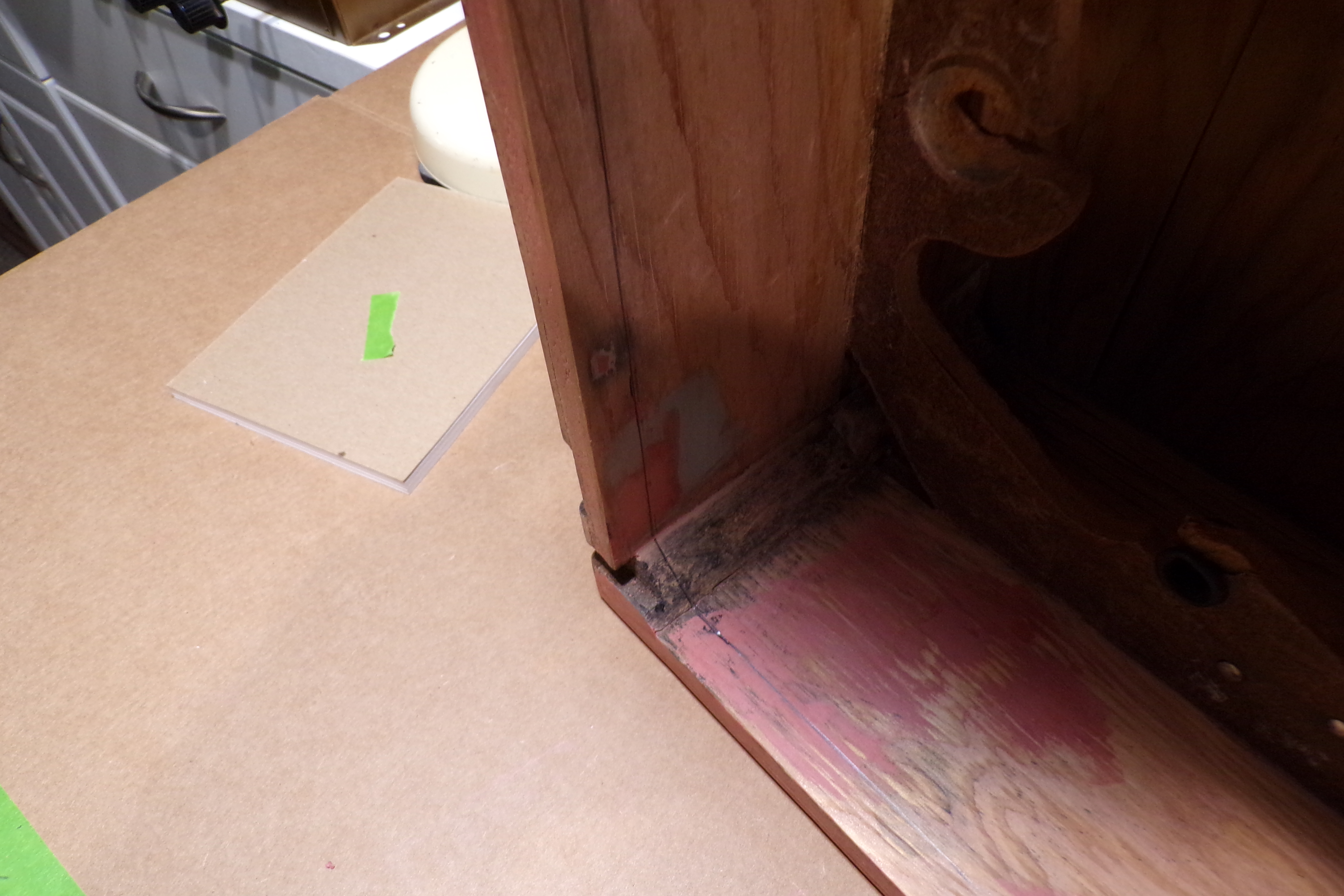

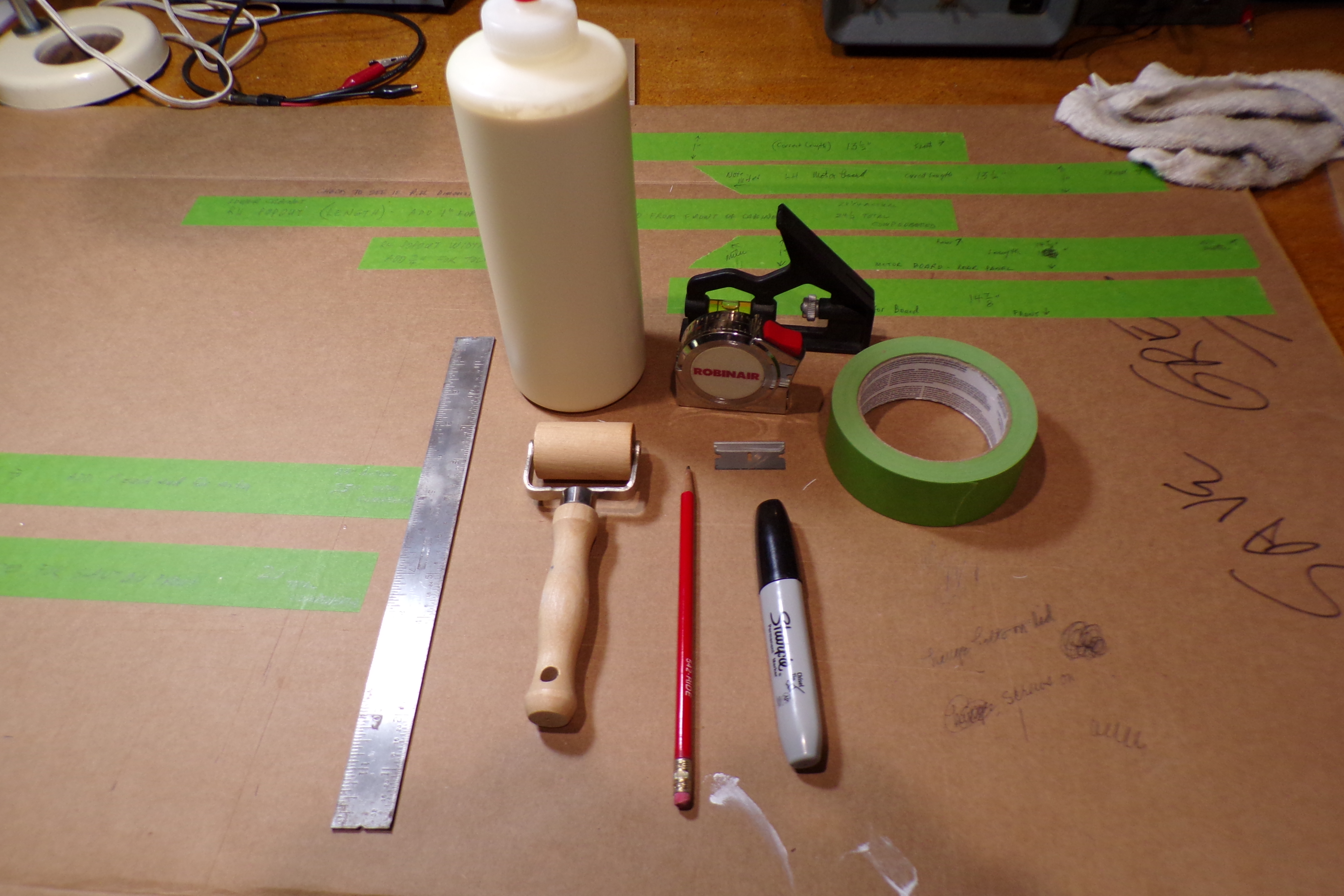

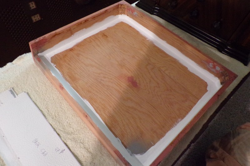

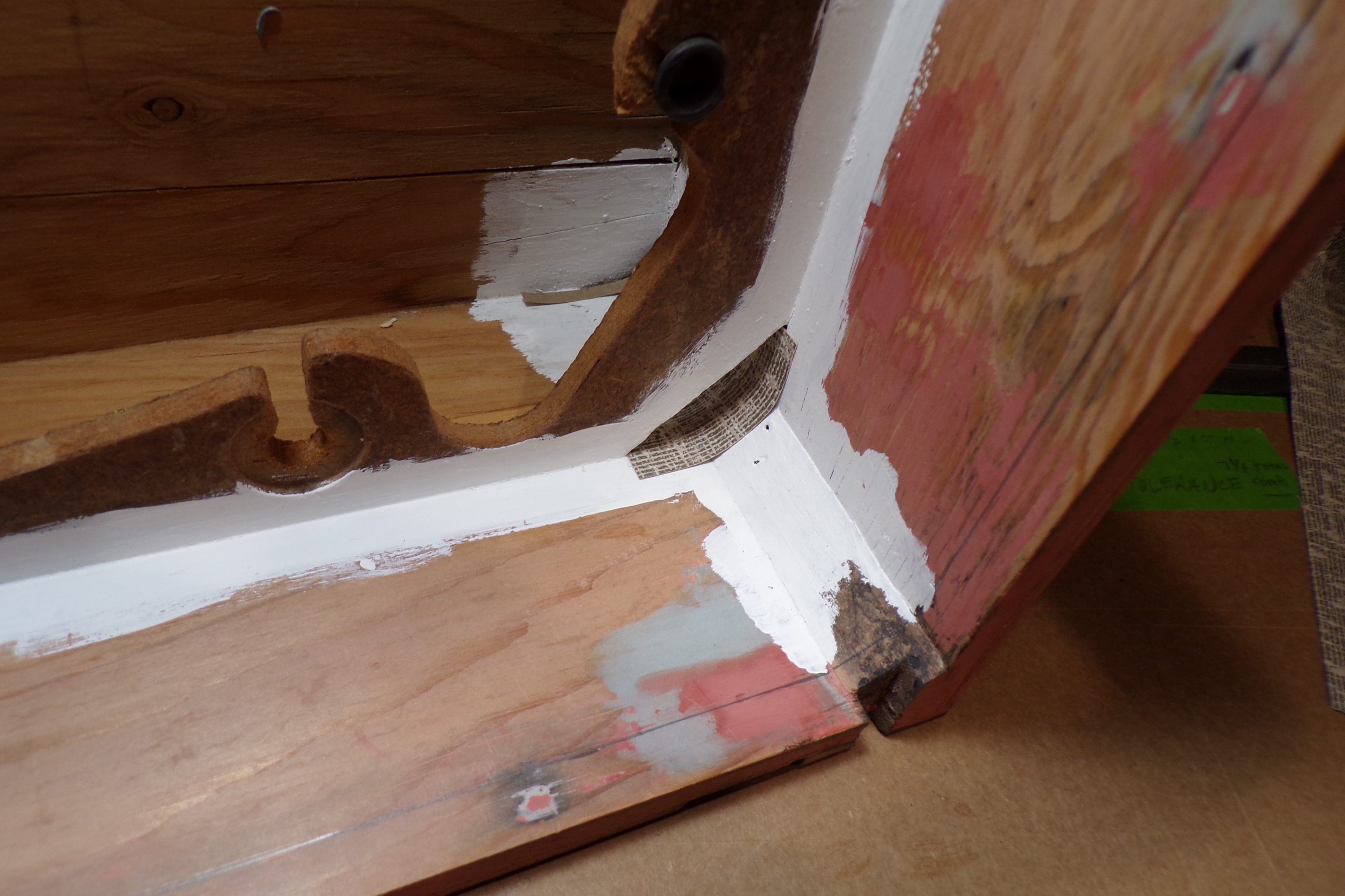

I have some pictures I thought I'd share. I don't want to give away the final product yet, but I have so many pictures, I won't be able to keep them straight unless I post some.
I'll try to get these in some semblance of order. First, I marked off the cabinet for the 1/2" overlap of the "color" over the white in the changer compartment. Then I painted in the corners anyplace that would have white Tolex. It is possible to cut the Tolex straight, cutting against a METAL straight edge. It is also possible that the wood in the cabinet is not perfectly square. So, when the Tolex is applied, bare wood may show thru. To prevent this unhappy eventuality, I painted the corners white. Then there is a picture showing the tools I used. In that picture, you may notice strips of green masking tape, stuck to the cardboard I was using to cover the workbench. I used that masking tape to measure the pieces I needed to cut. It is impossible to bend a tape measure over all the lips and dips in the cabinet, so I put masking tape from Point A to Point B, then measured the tape laying out flat. That worked really slick. Then a couple pictures playing a Les Paul 78, and the cute little four tube amp with its glittery tubes.
Naturally, I posted them backwards. Just read right to left, and stand on your head, they will then be in the right order......
Putzing with the cabinet as much as I did paid off BIG when I installed the Tolex. You need the substrate solid before you apply Tolex.
- Posts: 5461
It looks good, Greg and kind of give me confidence I might be able to recover my RCA in Tolex.
- Posts: 9026
You can do it, Bill. I really like the idea of using masking paper to practice the different cuts, particularly if they are angled or otherwise complex. Just make sure the wood on the cabinet is in pristine condition and is dry and sanded with 320 grit sandpaper before you start putting on the material. The glue will dry three times as fast on the wood as it does on the backing of the Tolex. When the glue is totally dry, it looks like it has disappeared. I've learned to apply the Tolex with the glue on the material still slightly wet. This gives a little wiggle room. If you let it dry totally, you only get one shot. A heat gun would also be a blessing. Not only would it decrease drying time of the adhesive, but you can use it on corners and edges to make them sharp. I had to do a lot of rolling to get mine like they should be.

I forgot to add this. Be sure to cover your work area with cardboard or masking paper. Cardboard is better, since you can cut on it and not gouge the bench. This process is messy.

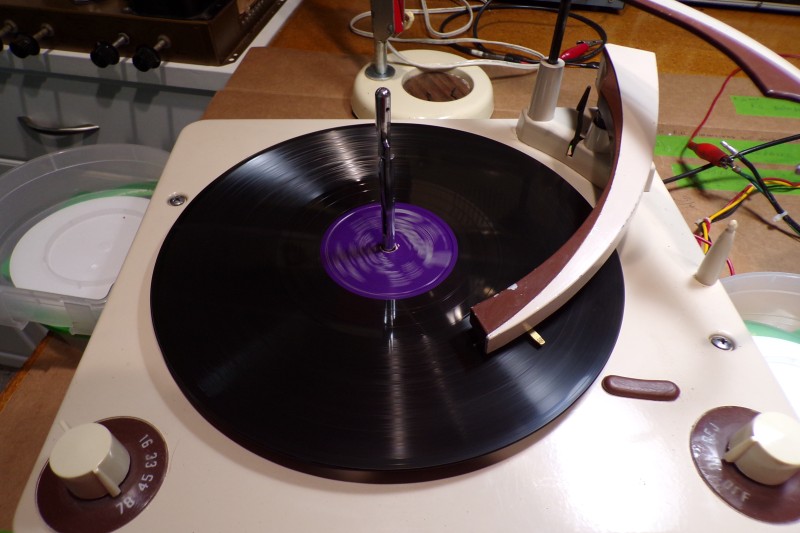

With all my blabbing about paint, I almost forgot the best part. Thanks to the guidance of Mr. VM, I actually took the tone arm off and didn't tear up anything. I putzed with the setdown adjustment thinking it was a screw that needed to come out. That will have to be reset. You guys familiar with changers may not be impressed, but, for me, this is progress.....

The colors are really close. I finally got the tone arm and overarm painted. I thought I had messed up the dark color, but it turned out okay. The factory didn't do that great of a job dividing the two-tone. The ridges in the tone arm and the overarm they used to separate the two colors is not that easy to follow, cutting masking tape when your eyes may not be 100%. I used my lighted magnifying glass to do the job. I'll put everything back together tomorrow, then reset the setdown on the changer, after I twiddled with the adjustment. I also have to use Super Glue yet to fix places that I didn't get enough glue.
