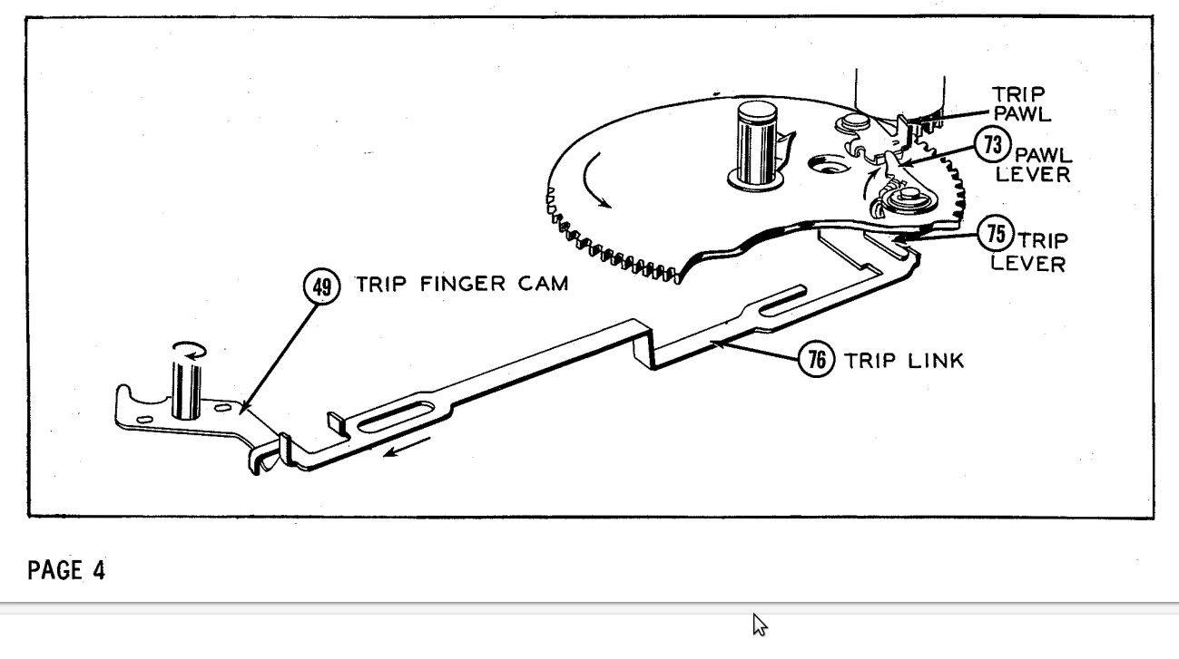

Post: # 8535Post Hi-Fi-Mogul »
Bill,
I'd look into the V-M trip link formed tab.
It might need to be bent a bit more towards
the trip finger cam.
You must be careful to stabilize that
soft aluminum trip link, so that you only bend the tab.
You don't want to bend the trip link.
I use 2 sets of sturdy needle nose pliers for the adjustment.
Or the trip pawl, pawl lever, and trip lever on
the gear assembly may need another dis-assembly
and cleaning.
I've had to do both of these sometimes after a
thorough cleaning, when I thought the changer
was working well.

Post: # 8624Post Hi-Fi-Mogul »
Bill,
I forgot one other esoteric adjustment
that sometimes is necessary.
The trip pawl must project far enough into
the gap of the toothed gear so the projection
on the turntable hub engages the trip pawl
to start the cycle.
To make it project a bit farther, the
other tab that is on the opposite side of the
trip pawl must be carefully bent.
It's difficult to explain, but I think you'll
look at it, and understand which direction
that other tab must be bent.
I have used a flat edge screwdriver to carefully
bend the tab while holding the trip pawl
piece stationary with my other hand.
