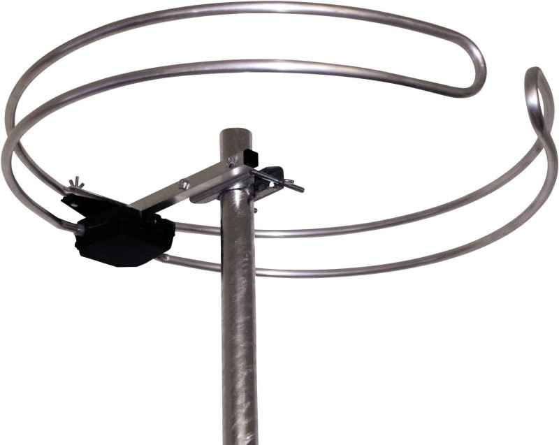

I admit to not being the brightest bulb in the lamp sometimes, but, please, 'splain this to me. How is an "Audiophile" FM stereo antenna different from a common old FM or TV antenna? How does this contraption make stereo better? Built in Mesa, so it must be good.

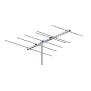

You're right. In fact, a folded dipole, properly stretched out, would likely be better in dealing with multipath because it's directional. Multipath can make for very lousy sound. That antenna looks like an omni, which will not deal with multipath gracefully. On the other hand, any antenna will reduce noise and make things sound better.

The dimension 31 inches is the dimensional compromise over the 20 MHz bandwidth of FM. Many times, rooftop TV antennas were marketed as including FM, but only 1-2 of the arrayed dipoles were about this length. These had one advantage - its directional and one disadvantage - tuned/cut not just for FM 88-108 but also VHF 54-88, 180-216 Mhz.
An outdoor, roof mounted FM-only antenna is the best because:
1. Up high, outside and unobstructed path is where the strongest signal is! Compromise: Attics are great for a poorly constructed but effective antenna, even home made ones but a metal roof and objects like spouting in the can affect it.
2. Directional means forward gain is maximized and co-channel interference is minimized.
Compromise: Omni-directional antennas often take form of folded dipoles in an S or circular shape. Mounting them on a wall may work if on the "signal side" of the wall.

Re: Audiophile FM stereo antenna
