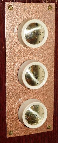

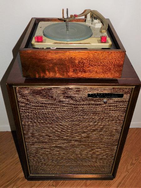

Here's the latest joint project with Hi-Fi-Mogul: We took a Motorola extension speaker, mounted a PP 6V6 Motorola amp inside and topped it off with a Motorola Turntable that I made a custom base for out of a veneered particle board plank. I moved the controls off of the chassis to the side of the cabinet, shielding the wires that extended the controls to a grounded metal panel. A decorative panel for the outside was made from leftover sheet metal
and painted with Copper Hammertone paint. The original knobs came with the amp, an eBay find.

It's at Hi-Fi-Mogul's house , looking to sell it eventually.
It sounds great, this is the 3rd one of these Motorola amps that
I've had. I have even built one from scratch to the schematic.
Here's a closeup of the turntable:

Background:
Many years ago I found the Motorola speaker cabinet,
at an estate sale. Only the speaker cabinet S14M.
It should have been paired with the SK-14M main
cabinet w/amp/changer/speakers.
I thought for $25 bucks, I'll find a use for it sometime
in the future.
Not as many years ago, I saw a CL ad for "old Motorola
record player parts".
The photos showed a 1955 blonde finish Moto
cabinet with a cool V-M custom changer.
I got excited about that, but when I arrived, I saw
the amp was gone, and the cabinet was pretty
much destroyed.
BUT, for another $25, I got the changer, and the
four speakers that were in the damaged cabinet.
I still will add some parts to the changer, so that
the idler wheel will be pulled off of the stepped
speed cam. The early V-M 1200 changers did
not yet have that design.
So, after some decades past, recently Dave1138 and I came
up with this great recombinant Motorola.
He had that nice Moto amp which is I think an
HS 442, or HS 475, or similar.
And I had the changer & speaker cab, a match !
We also have similar philosophies about enjoying
the hi-fi project, and then finding a good new home
for it. I look at it as being an ambassador of good will
for vintage hi-fi's.
He's now got the RCA 6HF4 amp for a re-cap, while I ponder how
to get that RP-198 working correctly.
