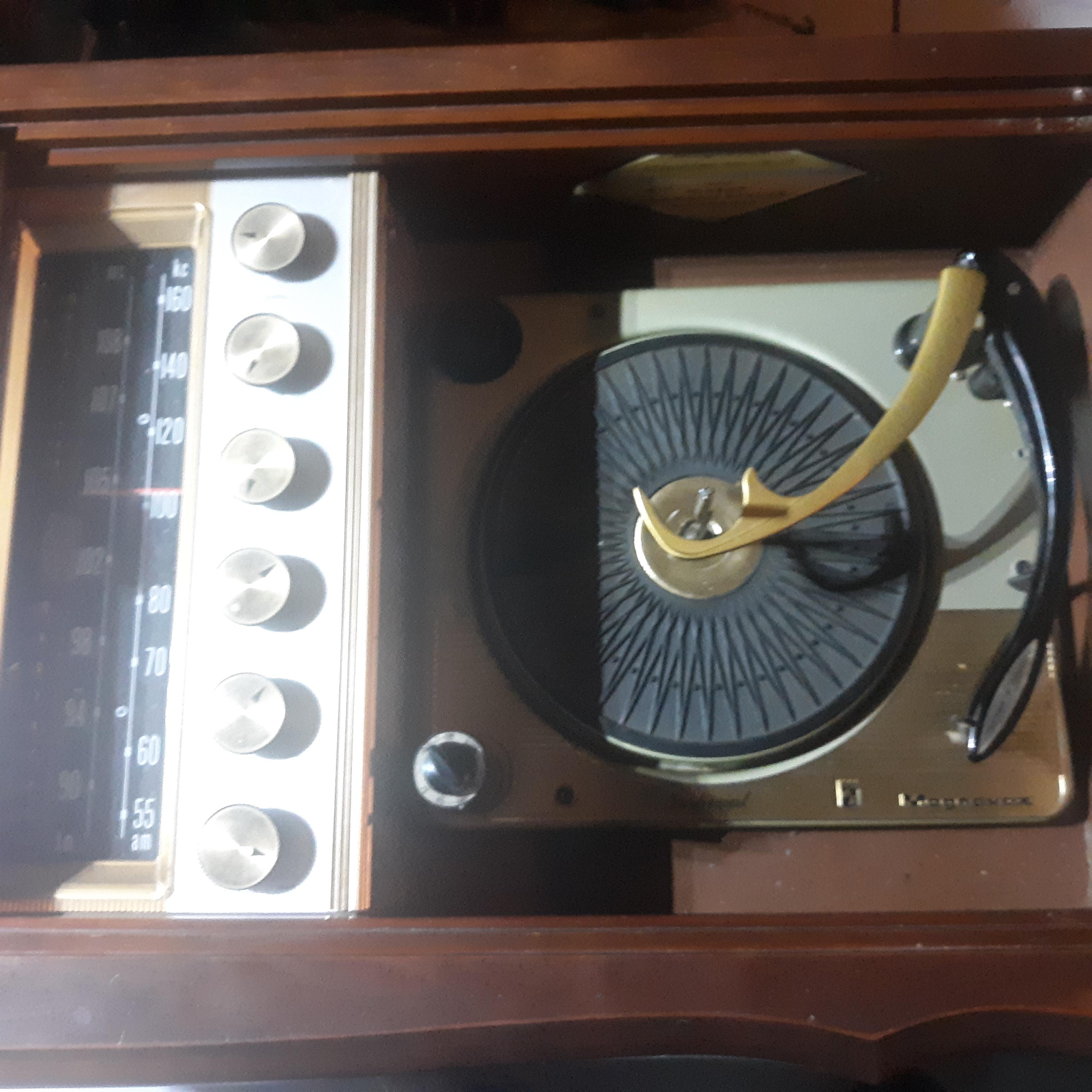

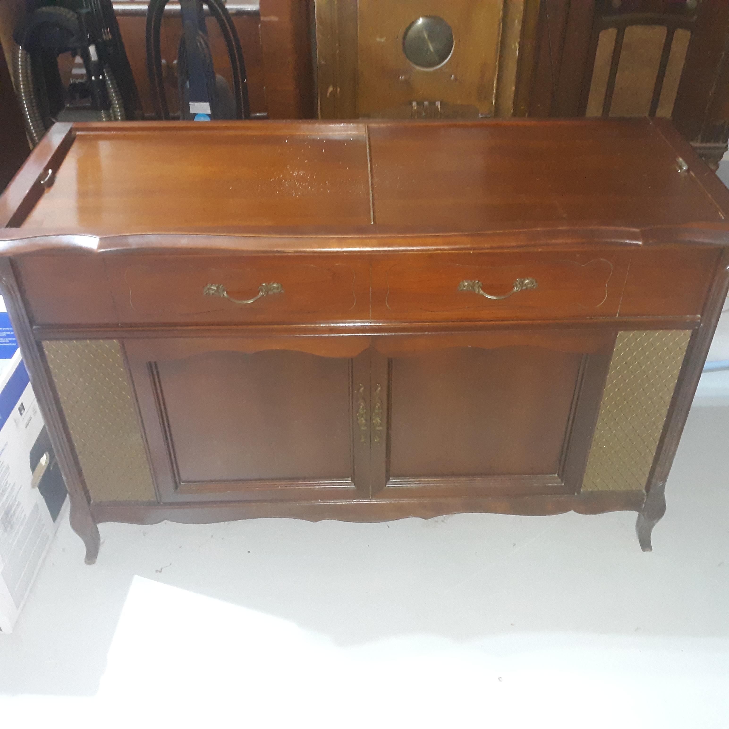

Bill mentioned I should post a picture of it.. here it is, originally paid 30 bucks for it as it did not work and the guy wanted it gone ... only thing that needs to be done is the caps in the multiplex unit ... sounds garbled when FM is in stereo ...

Thanks Elton! It look to be in nice condition, even the changer mat looks good. Ok, Greg, woofers and horns, or eight speakers in a "Little Imperial"?

That is a fantastic deal you got! The tuner is a series 200, one last holdover from earlier TOTL models.
Both of mine have the series 100 tuner and 3-tube mpx decoder, these lack a meter and have five knobs.
Both my '62s have 12" woofs and horns. My 1960 1ST208 has 8 speakers, 15" woofs and three round mid-high speakers on each side.
