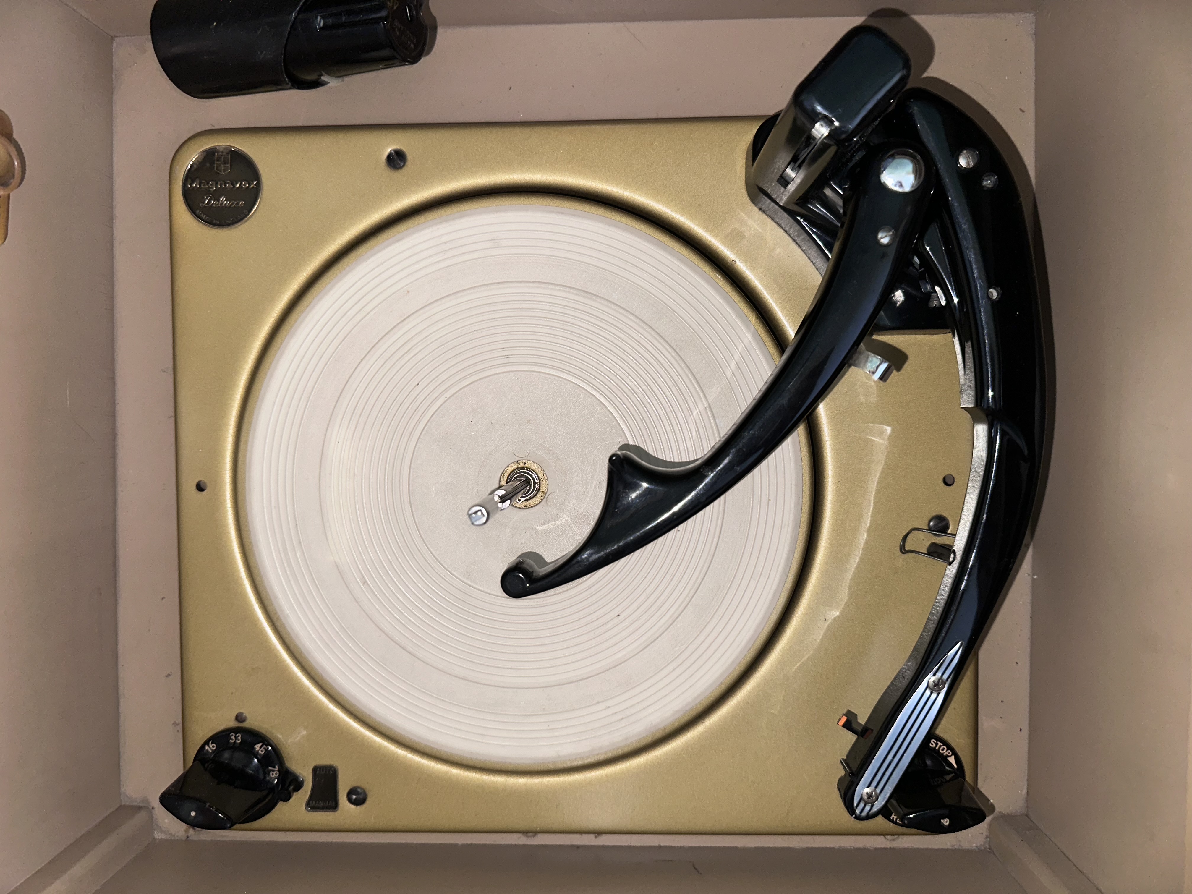

What version of the Collaro changer was used in this?

Re: AMP182BA tuning pots
When you say what version of Collaro, there are no identifying tags or marks on its underside.
On the top right corner is a round Magnavox badge. Other Collaro’s from adjacent years have a sort of triangular logo.

Doug, is there another word under Magnavox in the round badge?
Check for a model number under the rubber platter mat.
Looks like a Collaro TSC-84 or similar.
