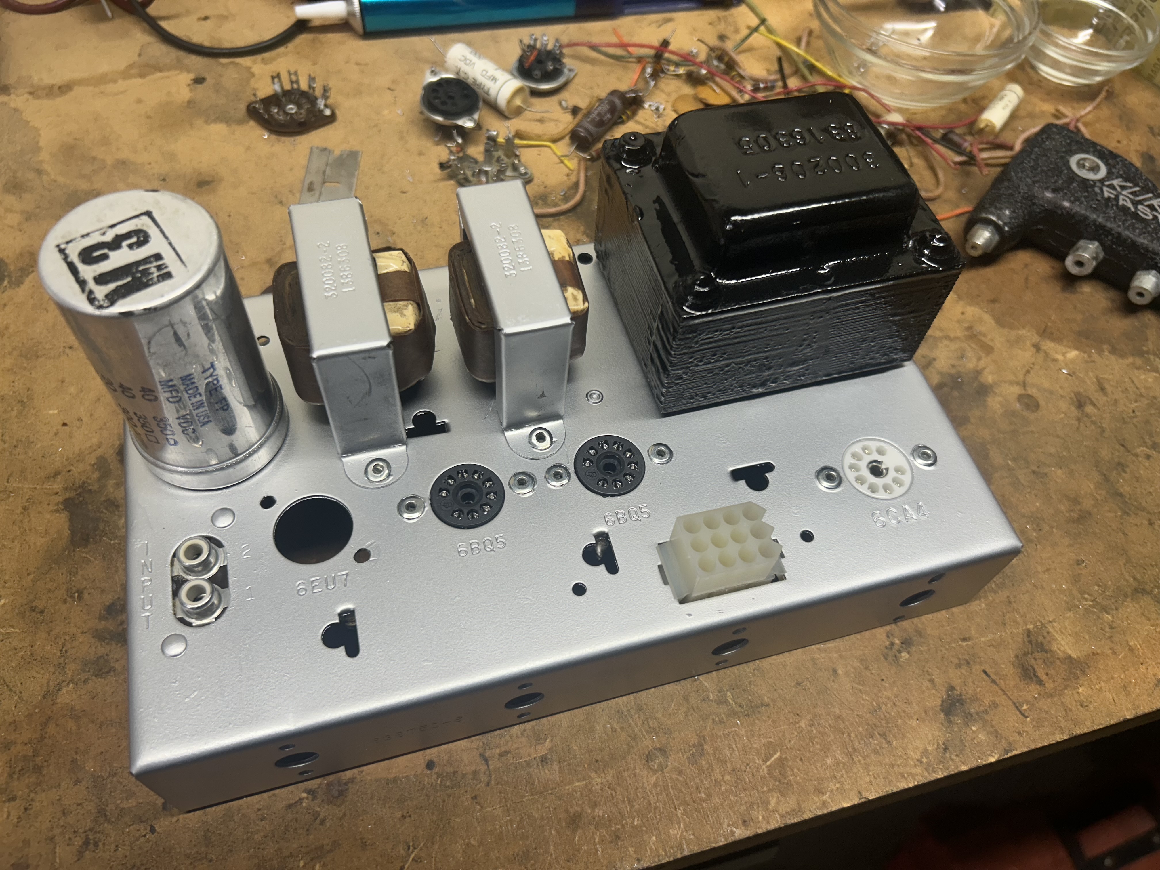

I'd be interested in knowing your cleaning methods used on the transformers. I admire that level of workmanship. I used to do things like that when I was restoring cars, but I was a lot younger then......
- Posts: 5436
Welcome back! When you say refurbished, did you do something other than clean and polish them?? The look better than new.
I don’t have any serious test equipment, so I don’t do much beyond checking continuity and resistance, and if it’s in range I just clean it up as best I can. In this case the collars were pretty yucky, so I took them off, did a little scrubbing, primed and painted with the same aluminum paint I intend to use on the chassis.
Not pictured, I also have the power x-former a shot of gloss black. I’m just about to the point with the chassis to start putting stuff back in it, but that’ll be next weekend at best since I’m traveling again. I’ve got nearly everything I need.
I’m also replacing the AMP umbilical connector with an equivalent Molex, since I broke the original getting it out of the chassis. The AMP things aren’t made anymore, and it was a good excuse to get a pin extractor and a new crimper. Never pass up an opportunity to procure a new tool or two!

Okay, looking for ideas here: I hemmed and hawed about whether or not to paint the chassis. There’s lots of pros/cons. That cad plating is slick as snot and doesn’t take paint very well. I don’t like to sand it because I don’t have a good way to manage the toxic cadmium dust. But the top surface of the amp, which catches all the dust and grime had a lot of ugly minor pitting. So I decided to do the soap and water, mild wet scuff with scotch brite that I threw away, prime, and paint.
My one regret with all that is that I obliterated the model and part number stamps. I’m weird like that, but I love the distinctive font Magnavox used for its model number stamps “8601-20” and a different stamp (smaller font) for the part number. Does anyone have any suggestions on how to re-create that on my painted chassis?
My only thought is to get my daughter, who’s into crafting, one of those little Cricut vinyl sticker makers for X-mas and see if she can make me some clear decals. Gotta love those self-serving gift ideas!
Any other suggestions?

You could try dry transfer letters, Woodland Scenic makes them for model railroad guys, I plan on using some for a control panel. They have at least two different font styles in various sizes, a sans serif type, and an older style. Here's one example on Amazon
https://www.amazon.com/Woodland-Scenics ... 000BRJCEM/
Will need a light seal coat of course.
This guy has a very helpful video with a method to apply characters in a straight line with consistent spacing.

Excellent idea with the model train lettering! I should have thought of that! Thanks.
Here’s the freshly painted chassis, before and after. I’m pretty pleased how well the stamped markings came out. They’re actually more visible than they were before painting!
Eric

That looks great, Eric. Nice job!
Before anyone asks, I will not, repeat not, be re-stuffing the electrolytic multi-cap. I did that once before on a 1940s Motorola, and it was a Royal and Ancient PITA. I’ll just be bypassing that thing altogether and running new Nichicons under the chassis.

That is ok, Eric, I bypass the original electrolytic can cap as well. I install a terminal strip and bring everything together at the strip. That method works for me, aesthetically it still has original look.
Exactly. Nobody’s pulling the chassis to criticize the location of the electrolytic caps. The only good reason to do that is when there’s really limited space under the chassis. The 8601 amp kinda falls in that category but I’m confident I can get a terminal strip and the new caps to fit neatly in there.

Laughing. Last night I opened up my RCA 9-EMP-21H tiny suitcase portable, a one-tube wonder, to squirt DeOxit in the volume control. When I replaced the filter caps, they went into a plastic film can external to the chassis because there was no room inside. Sometime you just have to improvise.BSMet94 wrote: ↑Mon Oct 05, 2026 1:06 pm Exactly. Nobody’s pulling the chassis to criticize the location of the electrolytic caps. The only good reason to do that is when there’s really limited space under the chassis. The 8601 amp kinda falls in that category but I’m confident I can get a terminal strip and the new caps to fit neatly in there.
Starting to look like an amplifier again!

Wow, that is beautiful, it looks like new. Nice job!
Thanks! I’m waiting for one more tube socket, since I accidentally ordered a top mount socket for the 6EU7. Once that hits the mailbox this week I’ll be all set to wire everything up, including my nice new Molex umbilical connector, which is definitely a step up from the old Amplok, and the molex fits perfectly in the hole!
I’m still stuck reusing the phenolic strips for the pilot light and speaker outputs. These are unavailable in .375 spacing, even if changing to screw terminals. I looked at using single row feed thru barrier blocks, but the ones that will fit are non stocked and it’s an 18 week lead time or a ridiculous minimum order. So for now I’ll re-use the obsolete size Faston connector strips. Nobody makes .205 faston connectors anymore, it’s either .187 or .250 these days.
