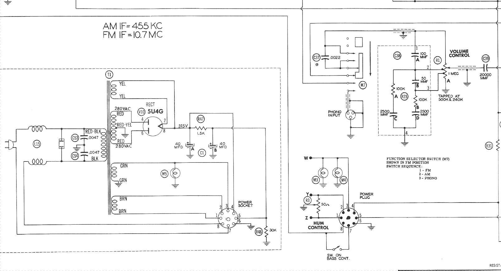

What I want to do is wire an RCA jack to the phono
input plug, so I can plug in a record changer, CD, et cetera.
I have the original 3 prong male phono plug, but the V-M
changer is missing.
Looking at the phono input diagram, I think one connection
probably went to the changer tonearm or base.
Would someone post their diagram of how to do the new wiring ?
Thanks !

RCA jack ground goes to bottom and right pins on the diagram. Signal (RCA plug center pin)goes to left pin.

Yes, I understand the diagram.
It looks like I will have to figure out how to
connect 2 pieces of shielded wire into the
holes of those 2 pins, once cleared of solder.
