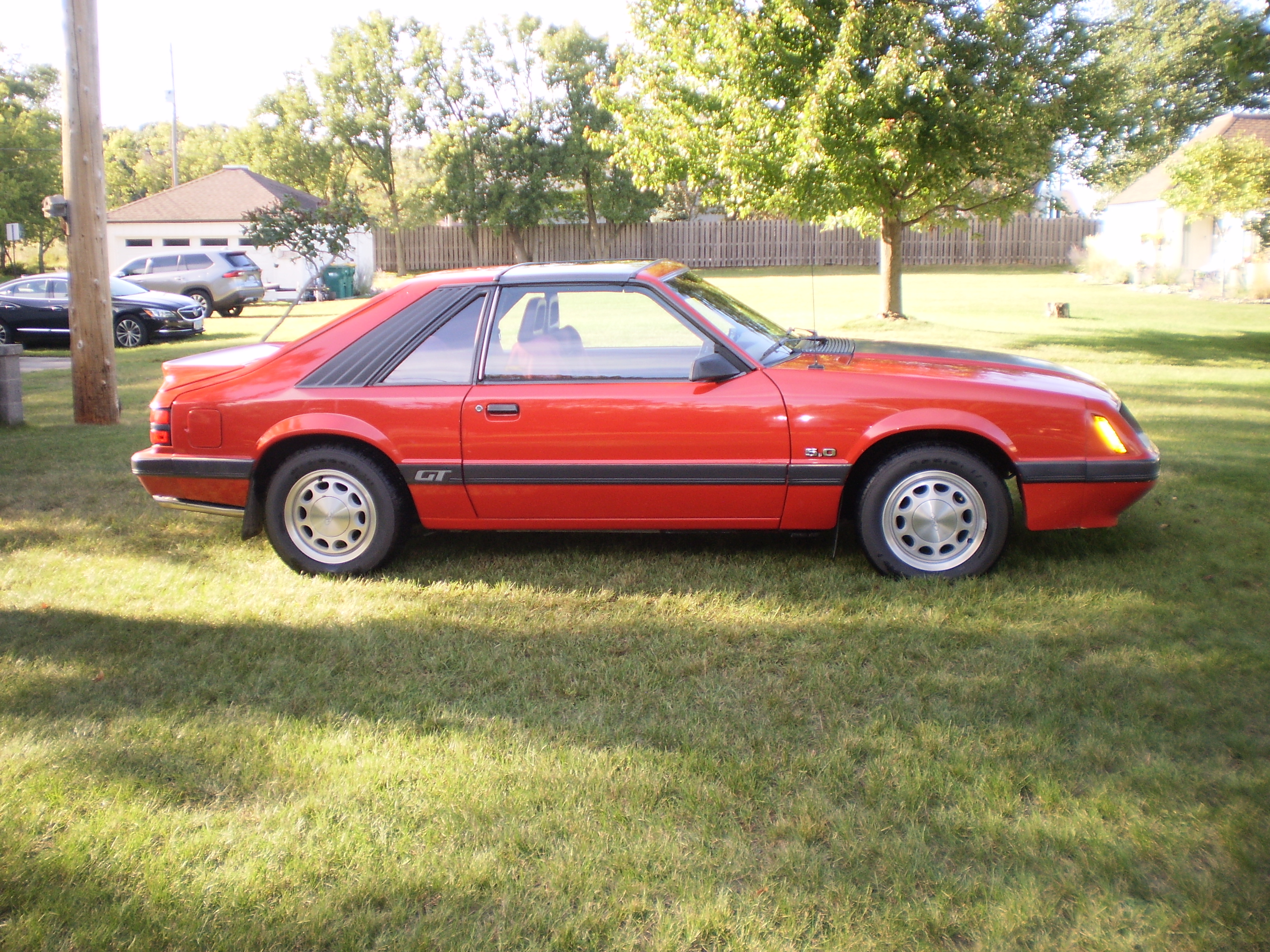

The Mustang made it around town at the other end and then home again too for a total of about 300 miles over a three-day weekend. But when I posted the photo of the TFI relocation, I realized how dirty the engine compartment was. So I washed it. In years past, I would knock on doors for local candidates. Before I left Lansing, I think I had knocked on every house in the city. Then I'd go home and clean up my front porch after observing how often they are neglected and how bad it looked to visitors. Sometimes you need perspective....

Washed the Mustang for the first time in at least 2 years. It had been raining often when I was driving it more. Now with the TFI upgrade I'm driving it more. Washed the Chevy last weekend and decided to do it to the Mustang last Sunday, after verifying that there would be no rain until I got it home.

There is nothing nicer than a clean vehicle.

A shiny one is even better!
