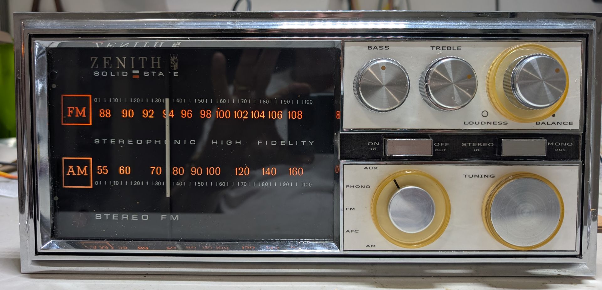

Fixing it up for my daughter and son-in-law. I've got two projects going, this one and the Motorola SK29! Garage is too hot for cabinet work right now, so I'm working on the electronics and chargers in my upstairs shop.
12"woofer, two tweeters and a midrange(?) horn per channel, 25ZT120 chassis. It's got the VM 1297 Microtouch 2G changer. Pretty much finished refurbing the changer, and it had some interesting issues which I'll describe later below.

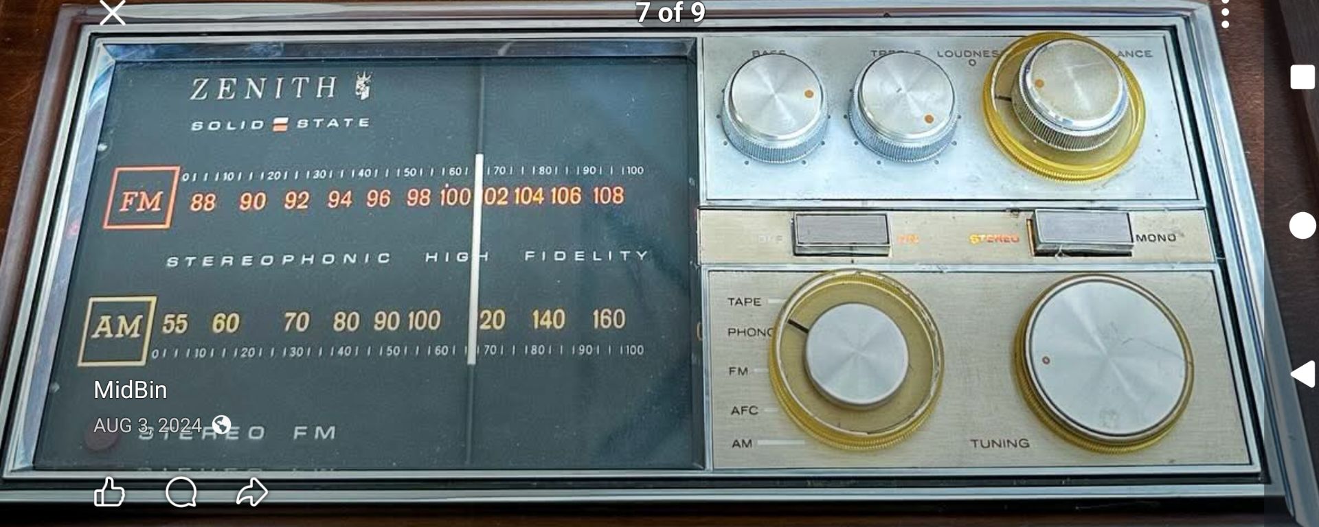

What are you doing about the faceplate trim piece? Since you're aiming for "lookin' good" and not "passing Greg's inspection at the Buick club," I would be inclined to fashion a substitute and not aim for perfect historical accuracy
Re: Zenith X940 restoration project
Chris, I agree completely! Unless I get lucky and find a parted-out panel, I'll work out something else that looks OK.

Re: Zenith X940 restoration project, front panel refurbished
Finally finished reworking the front panel. Check out how it looked when I got it in the photo a few posts above. The foil with cutout, back lit letters is completely missing from the topmost portion, damaged/missing on middle and lower portions. Here's what it's supposed to look like:
