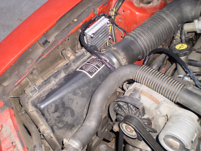

Re: Mustang TFI
The new heat sink. Yes, the engine is dirty.
The new TFI module is behind the fins. The shiny woven cable connects it to the distributor.
- Posts: 1934
Re: Mustang TFI
That's just about the same place the factory TFI was mounted in my '94 GT.
