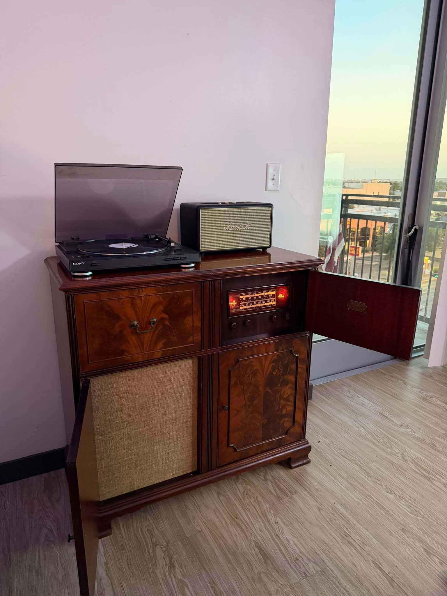

BUT, I got multiple inquiries the first day, some just compliments on it's looks. And 14 likes! One inquiry was from a 20-something student at Texas State University which is just down the road, and she wanted to come "grab" it! I made sure she understood that it would not play contemporary vinyl, but she said she had several 78's. I think the fact that it had FM and Bluetooth made it even more attractive. She ended up coming with her husband to pick it up Tuesday evening, 3 days after I listed it, paid full price in cash. Really nice kids-- said they would send me a picture after getting it home, and sure enough a couple of hours later: The nice thing about that cabinet design is that they can put all that stuff on top, and still have access to the changer. Having restored a few ol stereos now, I have come to appreciate the amazing condition of that unit, my first restoration, since it had been indoors all it's life, so the cabinet was almost perfect!

Looks like they have their source for the LP's sitting on top and some kind of a speaker sitting there too. It is a beautiful piece and from your recording of Stardust, it sounded great too.
