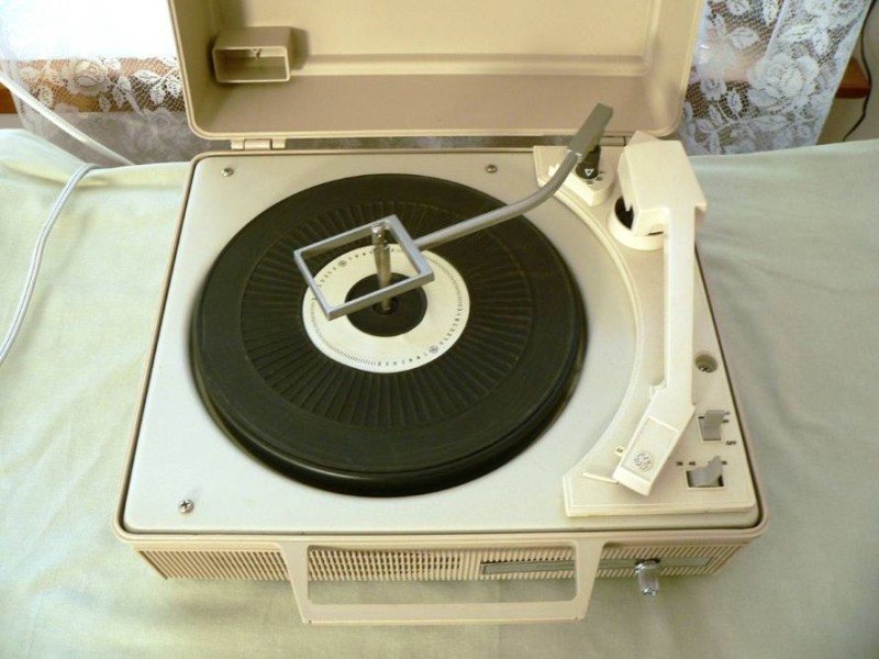

My first player was a 1973 swingmate with the almost those same (???) changers apparently.
