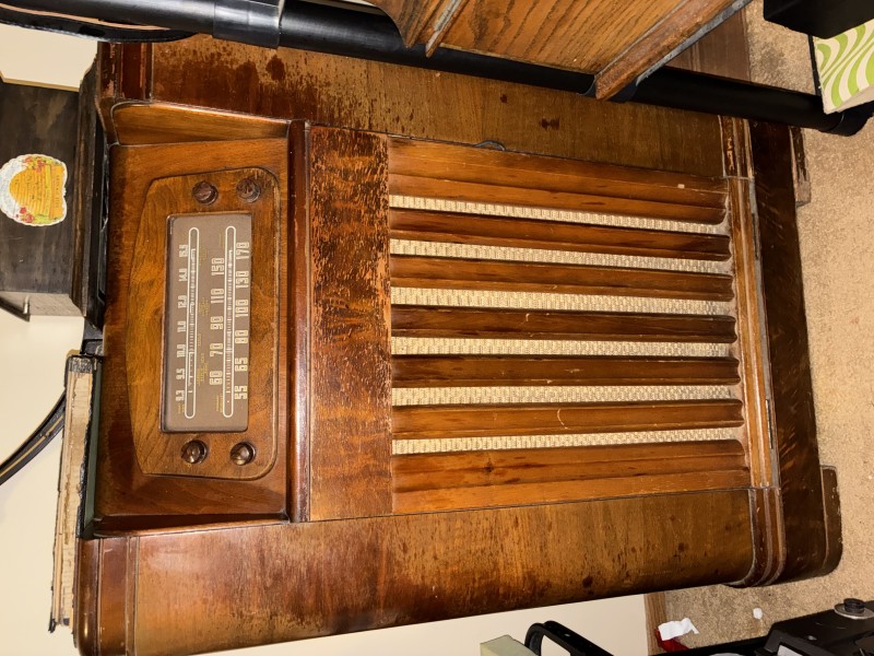

Found this guy at the local drive-in months swap. It was in good cosmetic condition and it plays 78s so I couldn't say no for $75. I know that price may be steep for something that hasn't been electronically restored yet but it's still better than paying $650 for something that doesn't even play 78s!! ;) Obviously I will not plug this one in...

Yup, I think a new cord is the first thing that needs to be done. :roll: ;) :)

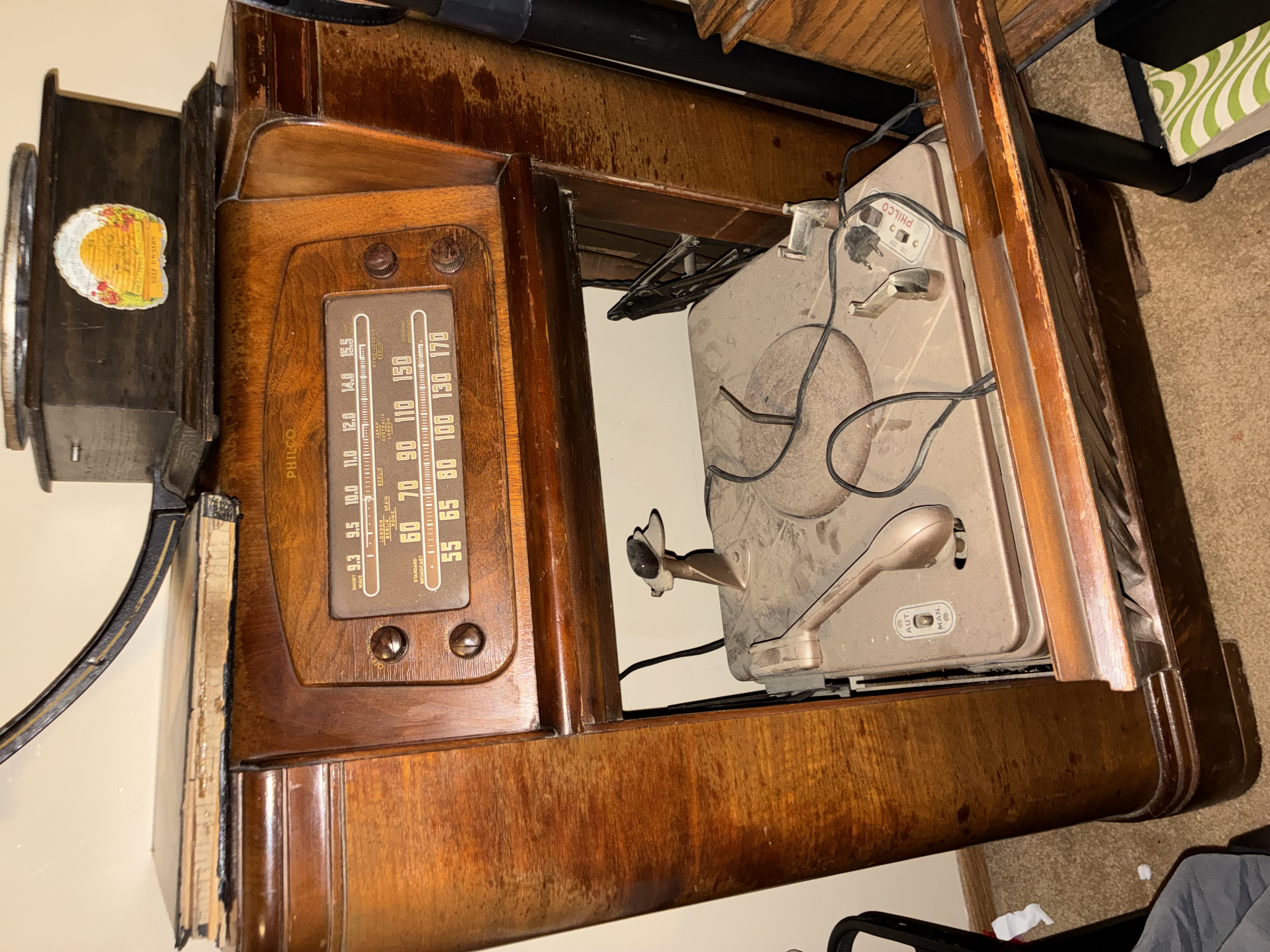

That is one of Philco's better-performing models in the 1946-ish era. The downside to those instruments is the D-10 changer. 78-only, heavy tone arm, crystal cartridge, clunky. If you can find a four-speed stereo VM or BSR changer, those make a nice transplant for the D-10. Plus, you can play stereo records without damage. You would bridge the stereo cartridge for mono, but that is straightforward and easily done. The electronics aren't too difficult on those. You will want to change the filter caps after you replace the power cord, and before you power up. You may run into some rubber wiring in the chassis, so you will need to be on the lookout for that. Old rubber wiring will disintegrate when you touch it. Good luck!
