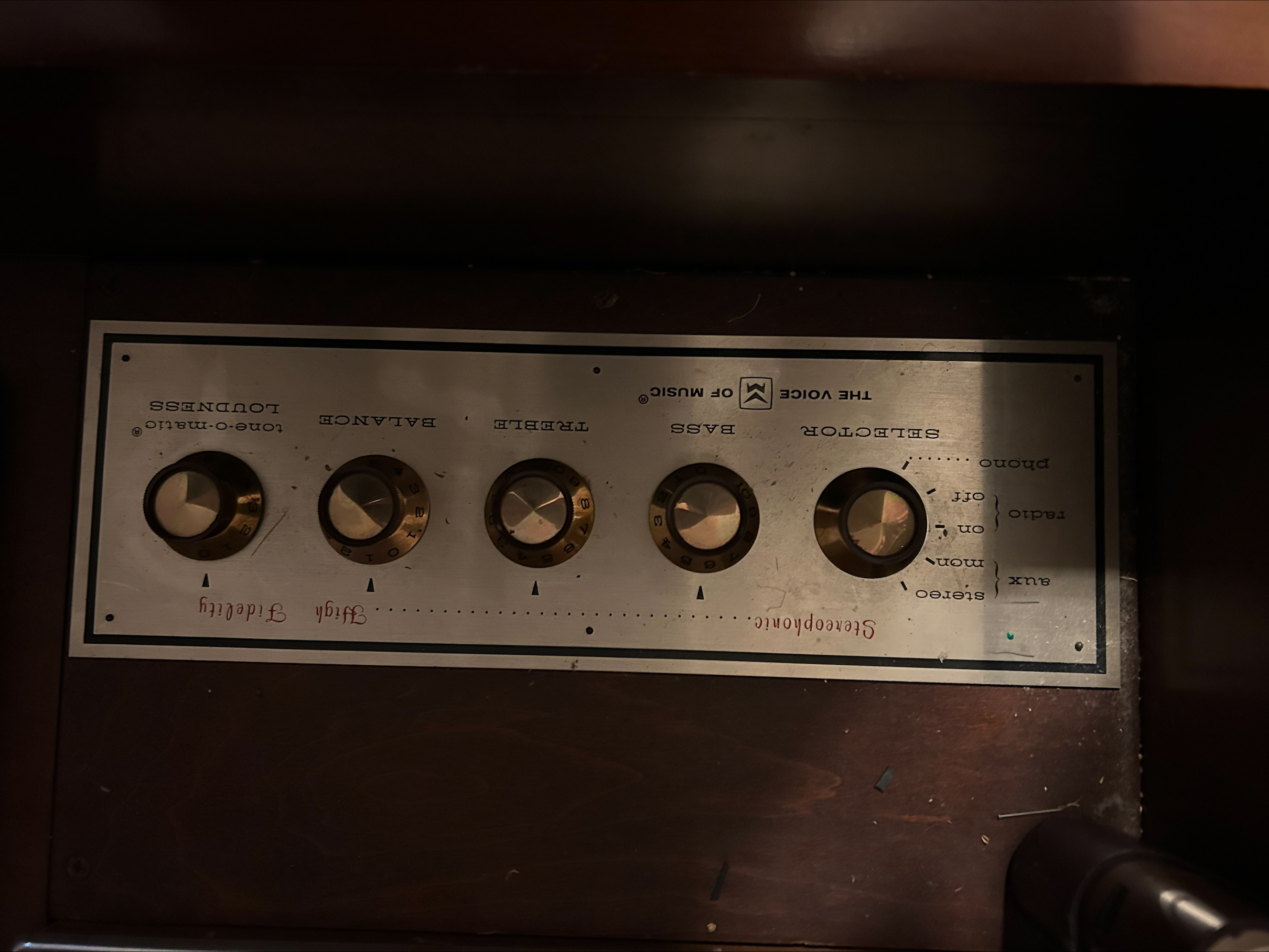

The 5 knob control panel is pretty typical for that era of VM and probably has a tube or two. The amp is located on the floor of the unit. You have something I have never seen before, rather rare I think. Your tuner has shortwave, 3 bands of it plus AM. Most VM's of that era (1962) are just AM-FM as short wave was kind of a thing of the past. I am going to reach out to Gary to see what I can learn. Speaking of Gary, he is located in Detroit and is all things VM. He is the guy that bought out VM when VM went out of business so he is your source for VM parts.

Please, when you get around to it, take the back off and shoot some photos of the amp, control panel, tuner, and speakers. And, as Chris stated, a VM changer is pretty easy to work on just take a bunch of photos as you take things apart and you will be good. I do recommend that you send a request to Gary asking for the service manual for your changer and his service recommendations on where to apply the lubricants once you have everything cleaned up. I also recommend you order motor mounts, as long as you are in there you might as well replace them. It is possible you will need the drive tire, idler, as they get hard with age so they will slip during cycling and will hear them rumble while records are playing.

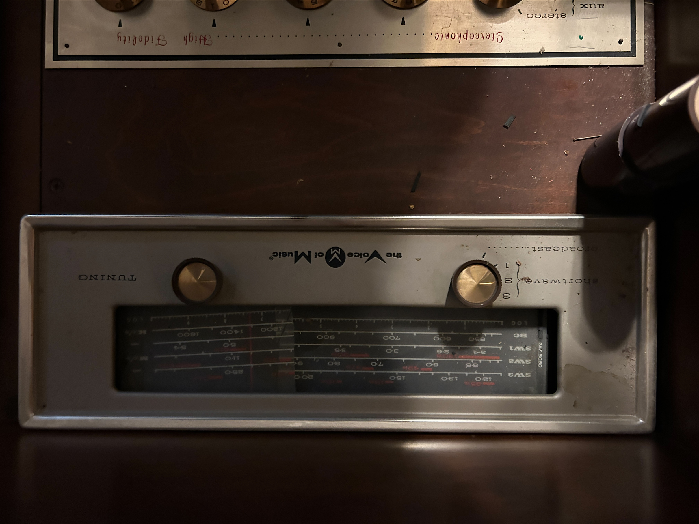

Wow, I missed those SW bands--that really is rare on devices of this vintage.
And because it's rare, it will be hard to replace a broken dial glass. My thinking is that the answer is "crazy glue." Edge glue it carefully. And them maybe have a same-size piece of glass cut at a local hardware store or glass shop. Back up the original with it for strength.

Chris's suggestion for fixing the broken dial glass is good. You can also make a decal of the dial, then transfer that to a new piece of glass. You have both pieces fairly intact, so that should be no problem.

Thanks for all the support and ideas. Very helpful. The glass broke (rather cleanly) into 3 pieces. Definitely will give a try on piecing those back together. Reached out, and already have a response from Gary with a request for some more info to get me on the right path with manuals. The original tuner manual was in the back on the unit. Amp has a label intact, haven't removed the turntable yet. Will tackle that last or find someone who is familiar. I'll grab a few pictures along the way. Thanks again for the input and quick responses.
Nice to know it's in the rare pile. Dad was an electronic whiz, avid Ham operator, maybe that's why this one caught his eye years ago.

Just from what we can see, I'm guessing that the AM (inc. SW) performance will be better than FM. I can see a 3-gang tuning capacitor, meaning that it has a tuned RF amp, but it's not clear what's in the FM section. There's an old saying that a mediocre FM tuner with a good antenna will outperform a good tuner with a poor antenna. That has been my experience.
