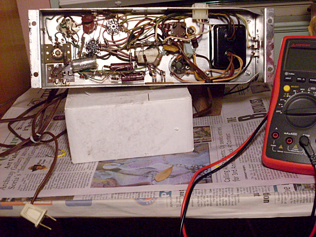

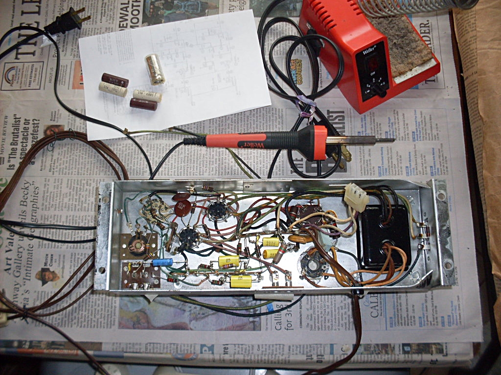

Re: Assist With AMP 197-20 Please
Last night I replaced the 5 caps in the chassis.
They were all mounted on the underside of the
terminal strips
I took my time getting the leads measured and
soldering them in carefully.
Today to start looking at the e-lytic capacitor
replacements leads' positioning and hole
drilling.
There is an open mounting lug eye from the cap
can that I can use for the new caps' negative
lead.
I will have to solder a small length of extra
wire to the caps' neg lead to reach the lug.
Nice work, Mr. Mogul. The bottom side reminds me of the amp in my Columbia/Magnavox.
Today I finished installing the new e-lytic filter caps and
the e-lytic cathode bypass cap.
Yesterday, with very low humidity and reasonable temps,
I went over the Aristocrat cabinet with 0000 steel wool and
Re-Stor-A-Finish mahogany.
Lot of flea-bites disappeared, and overall looks nice.
I'll go over the electronics work tomorrow, and if all checks
good, then I have the Collaro changer to do.

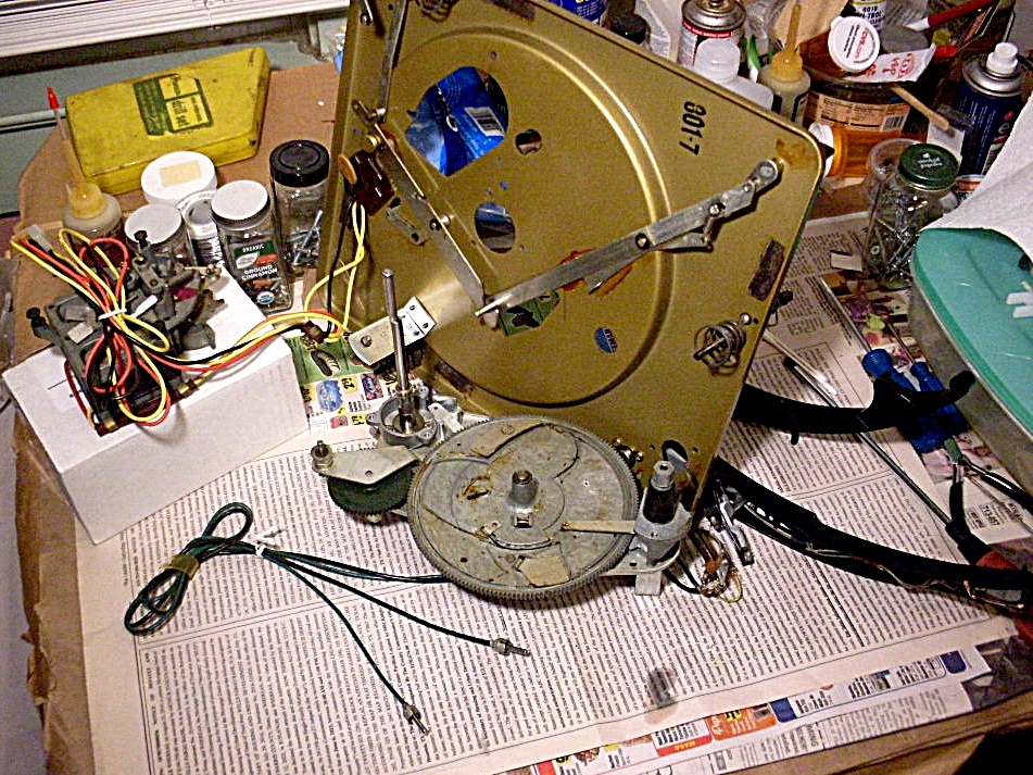

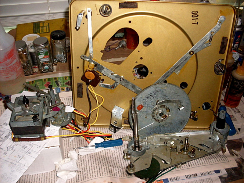

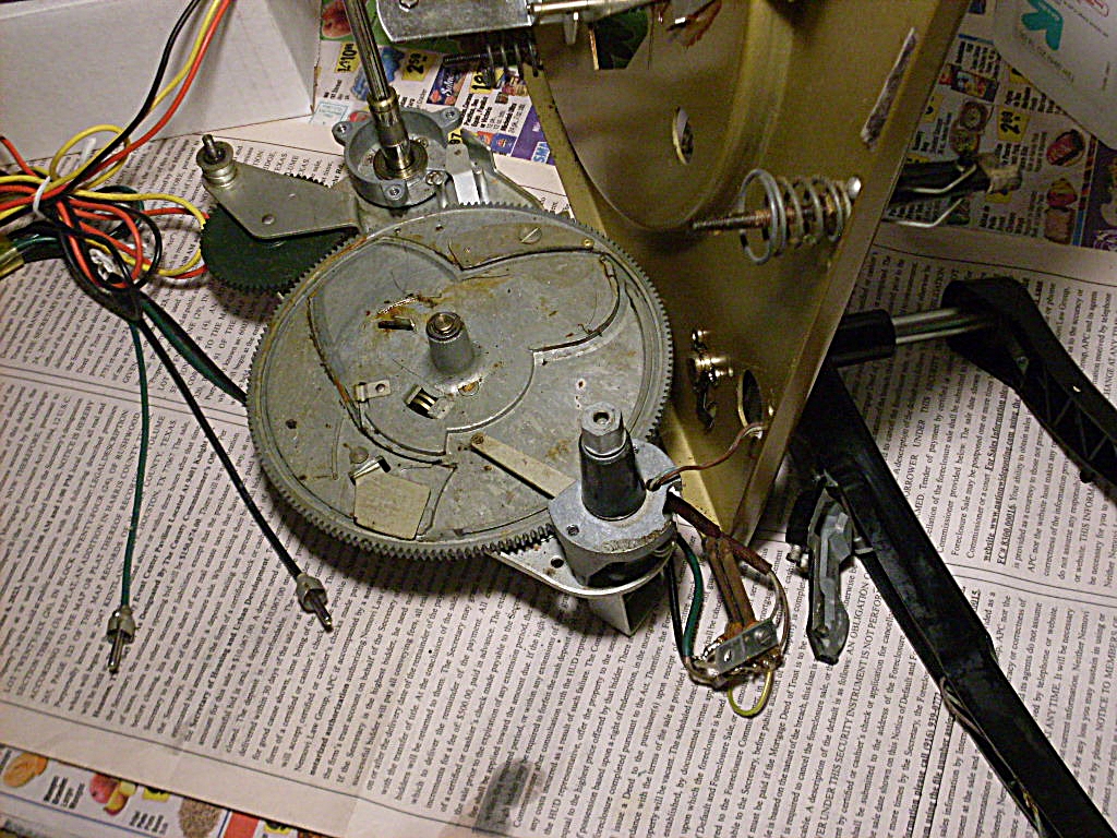

Amp re-cap was successful on testing.
Now I'm making headway in the dis-assembly and cleaning
of the F200C Collaro record changer.
One design flaw (for service at least) is that the tonearm
wires go through a hole in the sub-plate housing.
Due to the nature of the different muting system on this
changer, I did not want to unsolder the tonearm leads.
It just takes some careful moving around of the loose tonearm
and changer base/sub-plate when you start the dis-assembly.
Motor is cleaned and lubed. Rotor did not spin well prior to
service, but now spins like a top.
Controls' linkages are all cleaned.
Sub-plate assembly left to clean/lube manana.
I cleaned and re-assembled the F200C changer sub-plate
mechanism, and installed the motor.
All cycling functions are good.
The original idler and drive wheels will be
sent to Gary at V of Music for replacement.
One bump in the road is that the On/Off/REJ knob's
internal metal support is missing.
So, it will slip when engaged, and not activate cycle.
I had a 33/45/78 short height speed selector knob from
a Collaro parts unit, which will work instead.
The owners will be shown to engage the cycle by
turning that knob CCW.
Not aesthetic, but functional is good.

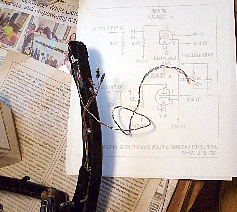

Ix-Nay on the Sonotone 8-T cartridge.
After fixing the tonearm wiring, I find the cart
has low output now.
I have a BSR-Tetrad cart with a top hole in the
cart body, that I have installed in the tonearm.
Now I'll undo the old tonearm wires and tape the end
of them to the end of the Tetrad harness wires.
Then gently pull the wires through the changer base
for soldering onto the mute switch.
